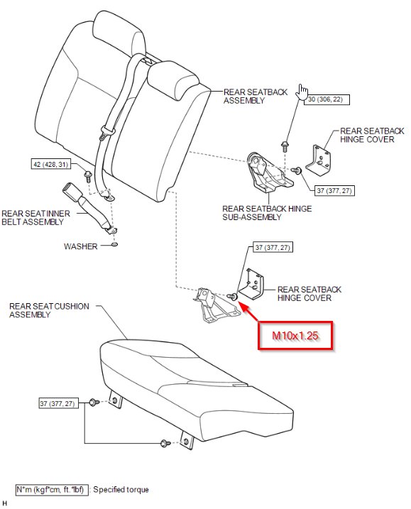

    I searched for a while online and couldn't find a reference for the size of this bolt.
    Then I remembered I had a pitch gauge and just measured it myself. I had to order a tap and die to fix a cross threaded bolt after taking the rear seat back in and out a dozen times working on my stereo.
    Anyway, it's an M10x1.25 and the tap/die is about $13 online in case anyone else has this issue.

    I had to get a tap for my front seat bolts and the bottom rear seat bolts... When I pulled my seats for running wires the threads were all trashed.

    Hey do you still have this parts diagram pulled up somewhere? I can't find it at all. I need the bolts listed 37 on the diagram. Do you know what they are?

    Thank you, I just was working on my steel and need new ones. That backseat just doesn’t want to go to its home.
