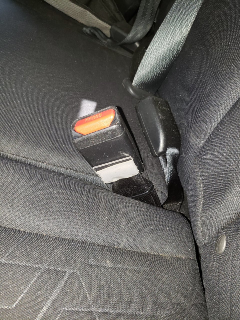

    Here is what I did and is working very well. I bought an 8" x 10" piece of clear lexan at the home improvement store. I had a plastic cutting knife so I cut two strips the width of the seat belt (about 2 inches wide) - one 8 inches long and the other six inches long.
    I then made a "sandwich" with one piece of lexan on each side of the rear seat belt with the longer piece on the non engaging side of the buckle. I then used zip ties to hold it all together and put a piece of double sided tape to hold the buckle to the lexan.
    After a couple uses the zip ties slid down so I removed the lexan and notched the sides in two places to hold the zip ties in place. The buckle is now standing proud of the rear seat and easy to find and buckle into.
    I would like to find black lexan for the final solution as it would look better and hide the double sided tape (gray in the photo).

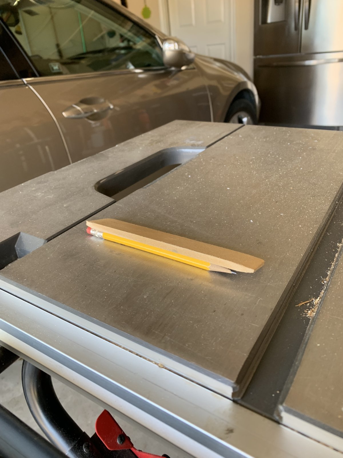

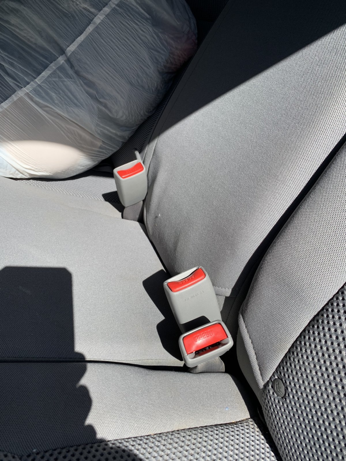

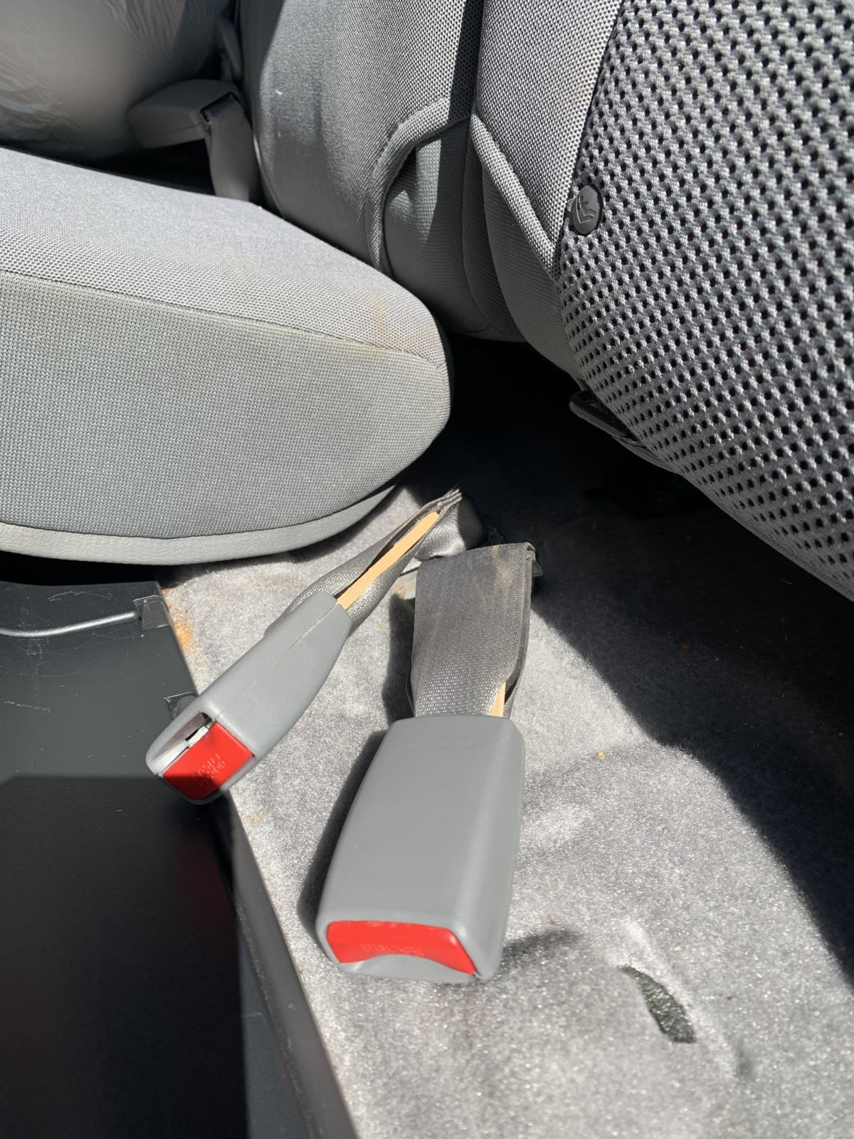

    I have looked all over the internet and Tacoma World to try and solve the problem with the rear seat belts. It would be really great if Toyota had solved the problem with molded stiffeners like they have in the front seat. Anyway here is my solution to the problem. I cut a piece of 1/8 inch hardboard and sanded the edges as shown in the first picture. Sanding the edges did two things: It helped "lock" one end into the seat belt receptacle and made it easier to slide the other end in between the sewn parts of the seat belt receptacle straps. Once in place the hardboard piece will not move and holds the receptacle up in between the seats. Now when inserting the seat belt into the seat belt receptacle it will move down slightly but stops when the hardboard piece contacts the bottom of the seat support. The end result is that you can now engage the rear seat belts with one hand. I may remove the pieces later and paint them a similar shade of grey just for aesthetics. Long story short - they work!! Seat Belt stick .jpg Seat Belt stick inserted.jpg Seat Belt stick installed ready to go.jpg
