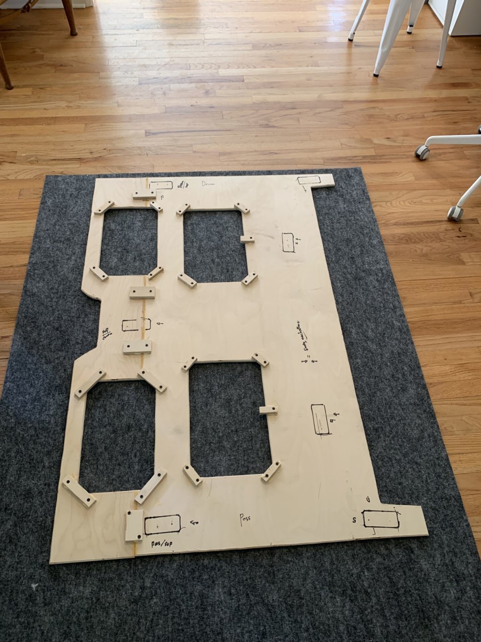

    ASSEMBLY INSTRUCTIONS FOR CNC SEAT DELETE:
    (Edit: 5/5/21- Design has been updated for easier assembly. Images have been updated)
    Before I begin I would like to apologize for the following VERY LONG post. If this post hi-jacks this thread, it is not my intention. And I apologize in advance if it does.
    I have received so much interest in my CNC Seat Delete design that I have decided to offer it for sale. While the price is less expensive than others, it is still costly due to material costs, rented cnc time, shipping, labor, etc. If you are interested in purchasing a seat delete, please feel free to DM me. This seat delete is designed to work with the factory cubbies located behind the rear seat. It is also designed to be easily installed for the weekend or permanently installed depending on your needs.
    This Rear Seat Delete is part Pro part DIY. My hope for posting assembly instructions on this thread is to help those that buy this design, while inspiring others that want to make their own.
    This Rear seat delete design must be assembled, sanded, sealed and finished by the buyer. Hardware not included.

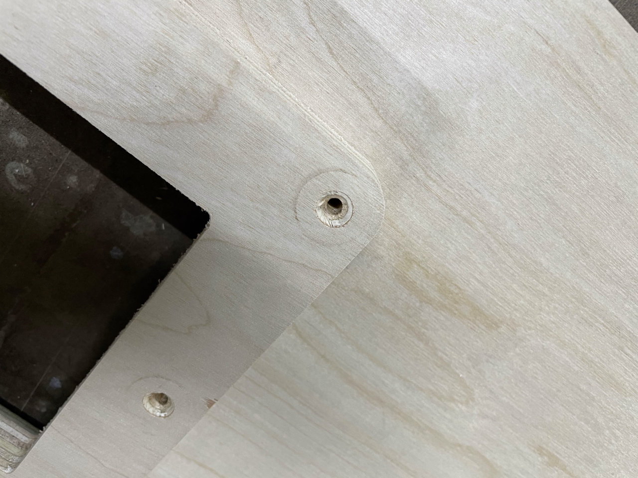

    Assembly: Holes come counter-sunk but must be pre-drilled before screwed and glued together.

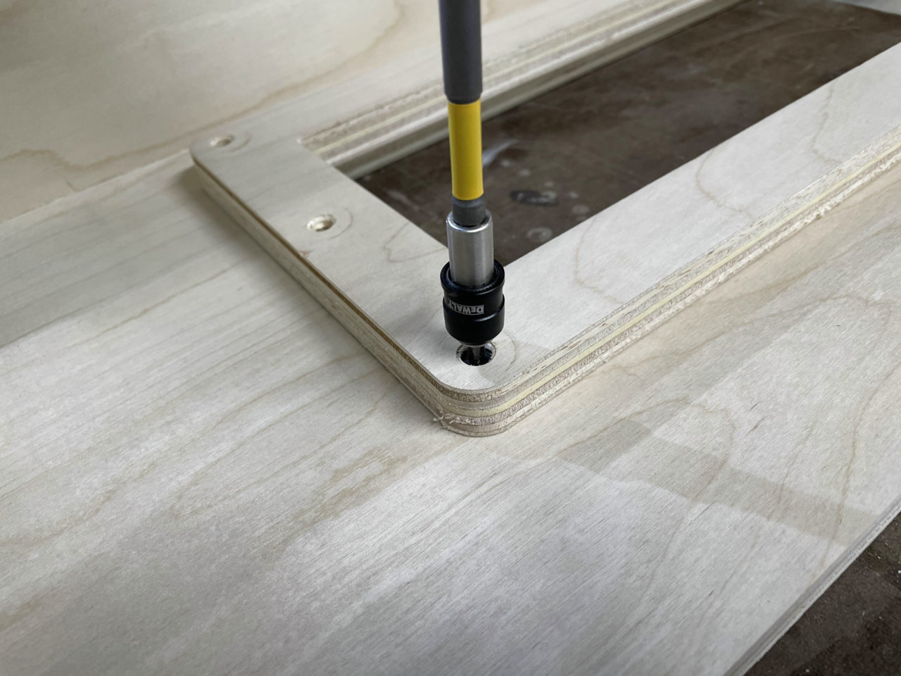

    2) a- Align Front Panel with (1) Side Panel.
    2) b-pre-drill holes using counter sunk holes as guides for placement:
    2 c- Glue and screw Front Panel to Side Panel:
    3) Repeat Steps 2a - 2c on Remaining Side Panel:

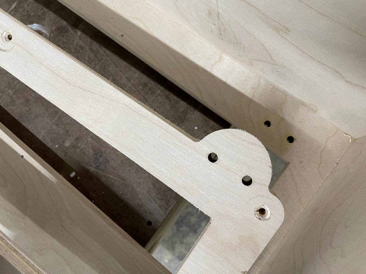

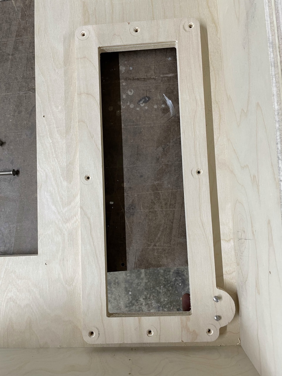

    **NOW LET'S ATTACH THE FRONT CARGO HATCH SUPPORT RINGS TO THE ASSEMBLY**
    7) a- Standing at the Rear Seat Delete Right Corner, grab the Cargo Hatch Support Ring w/ TWO Large half circle profiles on the Bottom long edge and TWO SMALL half circle profiles on short Right edge. Make sure the when looking at this Cargo Hatch Support Ring, that the counter sunk holes that the counter-sunk holes are visible. (There are a difference between the counter sunk holes meant for screws and the pre-drilled holes meant for magnets).
    7)b- Align this Cargo Hatch Support Ring by sliding the Support Ring forward so that the TWO LARGE half circles butt with the most inside front surface of the Rear Seat Delete. Once the Support Ring is as forward, make sure to slide the Support Ring RIGHT so that the TW) SMALL half circles butt with the most inside side surface of the Rear Seat Delete.
    7) c- Using bought (2) 1/4-20 x 2" Bolts and the US Cargo Control D-Ring Base, thread bolts up from underneath Assembly, through holes of Hatch Support Ring:
    7) d- Install mounting plate, washer and bolts and loosely tighten:
    8) a- The bolts of the D-Ring should be holding Cargo Hatch Support Ring in Place (Loosely). Now locate the pre-drilled divots on the underside of the Rear Seat Delete Assembly. You may need to move the Cargo Hatch Support Ring to locate the divots. Place a screw through far corner screw hole of Cargo Hatch Support Ring and locate a divot. Once divot is found with tip of screw, Screw into place:
    8) b- screw remaining screws for this Cargo Hatch Support Ring into place.
    8) c- once all screws are in place, tighten nuts and bolts of the D-ring base.
    9) Repeat Steps 7a-8c for the Left Front Hatch Support Ring

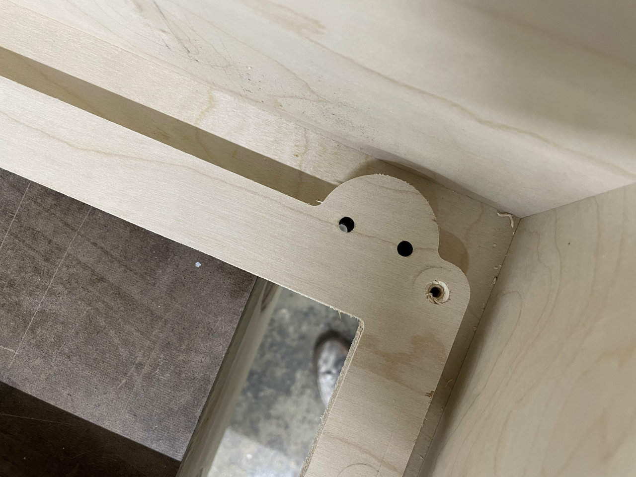

    **NOW LET'S ATTACH THE TWO REAR HATCH SUPPORT RINGS TO THE ASSEMBLY**
    10) a- Using the same technique of the front Cargo Hatch Support Rings, simply align a Rear Cargo Hatch Support Ring by sliding it forward, so that the TWO LARGE half circles mate with the cut-outs of a Front Cargo Hatch Support Ring. **MAKE SURE THAT THE COUNTER SUNK HOLES ARE VISIBLE.
    10)b- Once aligned, screw into place, by placing screws through counter sunk holes. Be sure that this Cargo Hatch Support Ring stays in place and is mated to its front Support Ring.
    11) Repeat Steps 10a-10b on last remaining Cargo Hatch Support Ring

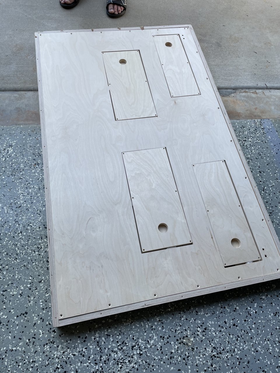

    1) Remove d-ring hardware and Using 120 grit sandpaper, sand the entire Assembly to a finish that you are happy with:
    2) a- After sanding is complete, spray off any dust. Using Bondo, mix up a batch and fill all screw holes, seams, and any other imperfections. Let Bondo filler dry:
    2) b- Once Bondo is dry, sand all Bondo Filler so that it is smooth with the surface. (Two or more coats of Bondo maybe needed in some areas).
    3) After all Bondo Filler is sanded smooth and all surfaces are to your liking, spray off any and all dust. Using Oil Based Polyurethane and a disposable brush, "seal" the entire Seat Delete Assembly. This includes the top and side surfaces, the back surfaces, the edges and the underside. (You may need to coat the top surface in one pass. Then let dry. Then flip Assembly over and "seal" underside.
    4) Once Oil Based Sealer is dry, sand Assembly again to surface quality of your liking.
    Now the Seat Delete Assembly is ready to be finished in the material of your choosing.
    Personally, I decided to use the roll on monstaliner, which has a very thick consistency.
    As a result I chose not to bed line the underside of the Cargo Hatch Doors and the Cargo Hatch Support Rings. I spray painted them black instead.
    5) Final Finish Material: If choosing to use monstaliner, follow directions, mix and apply appropriately. It is thick and messy and smelly. Manufacturer claims that it takes a full seven days for the liner to cure hard. I have noticed that it takes about as long for it to off gas and even then it has a strong aroma.
    6) Once finish material is dry, reinstall d-ring mounting hardware.

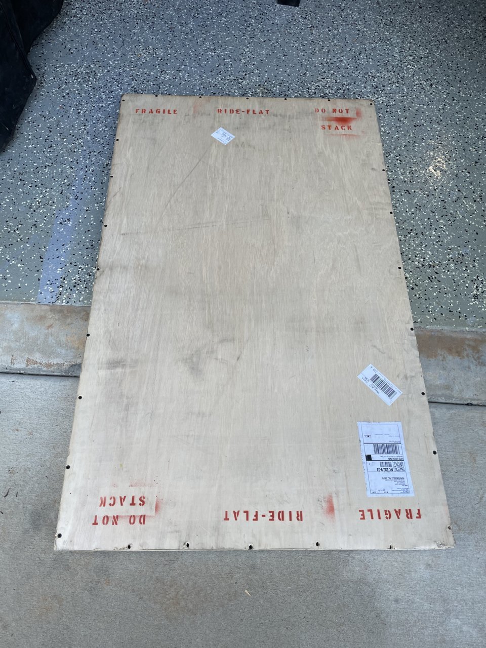

    When i saw his CNC seat delete I immediately DM’d him and within a few days we figured out the details to order one. He kept me posted on the progress every day and I received it today.
    Now I just had ankle surgery so I can assemble it quite yet, but even the shipping crate is gorgeous!
    Thanks again!

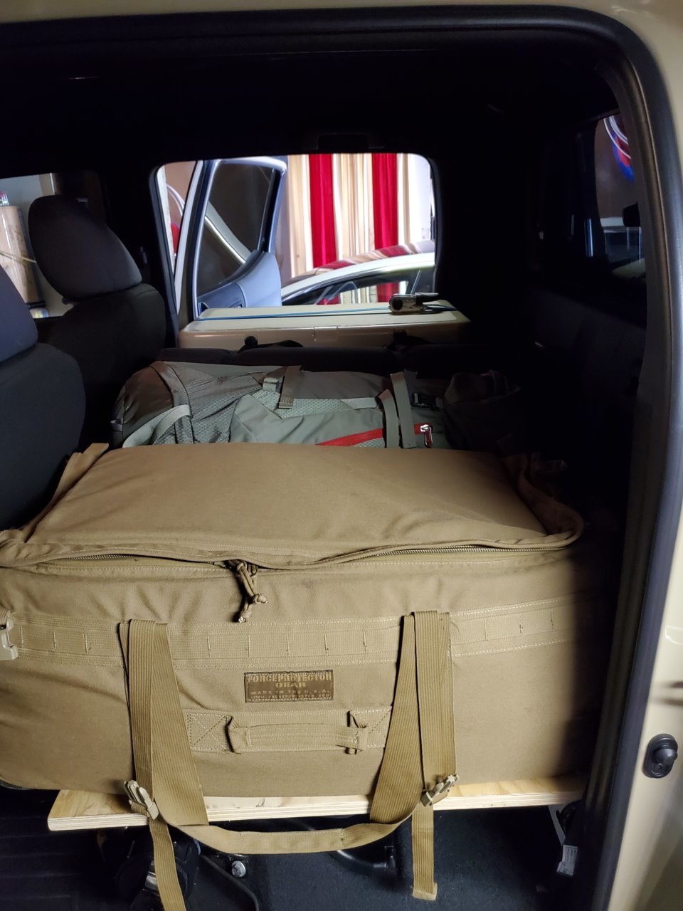

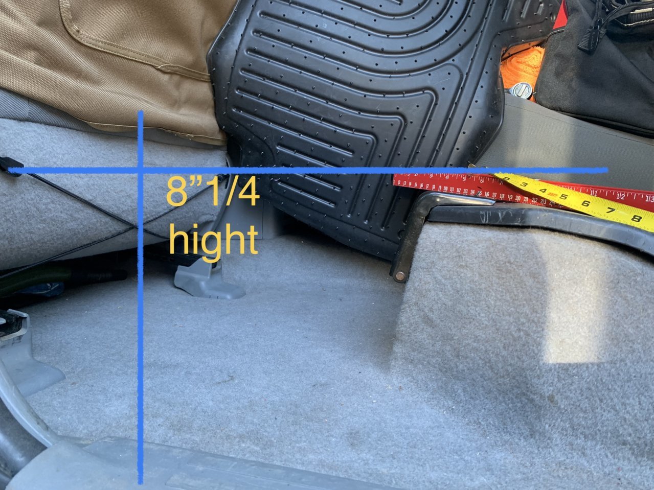

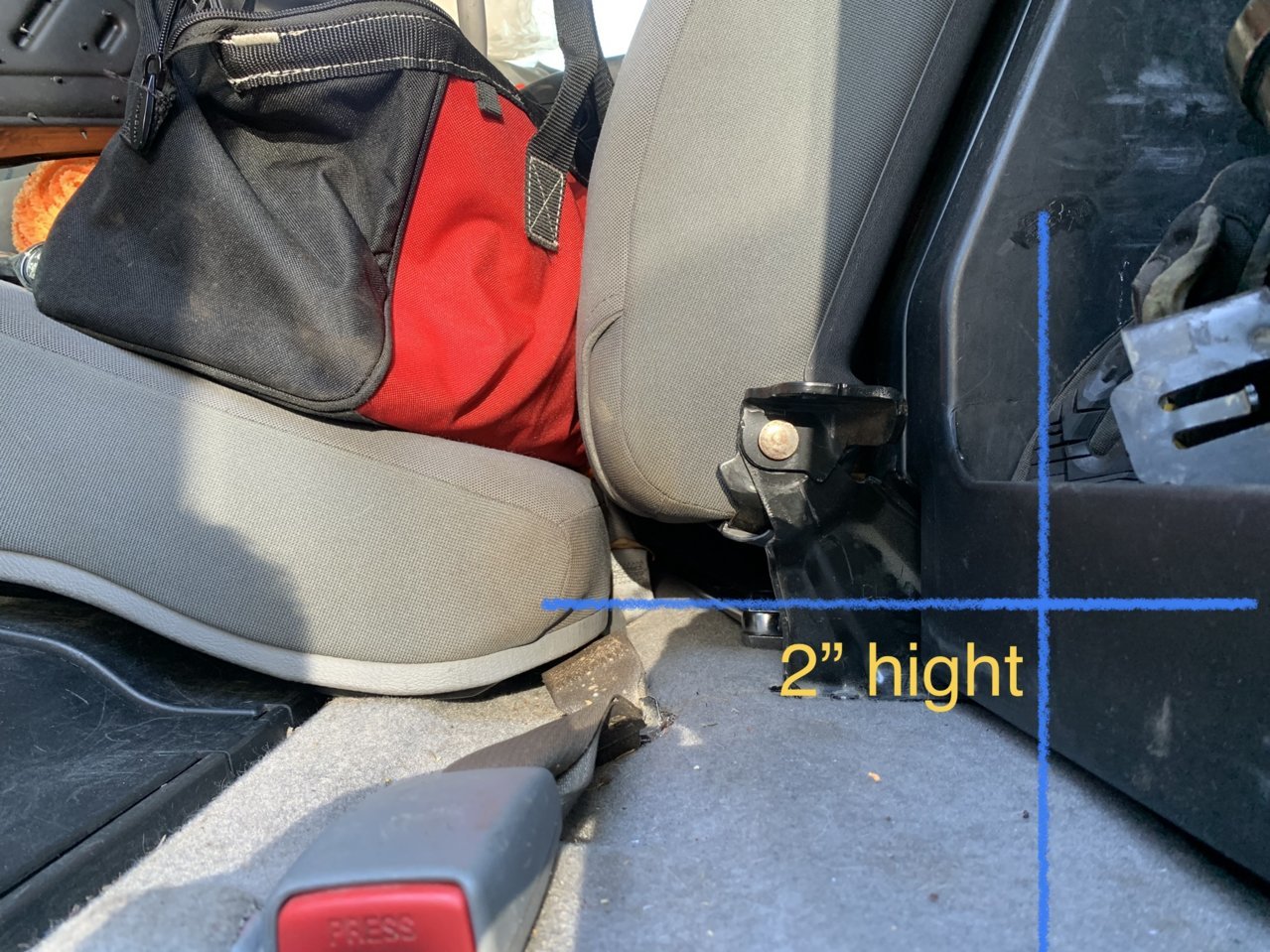

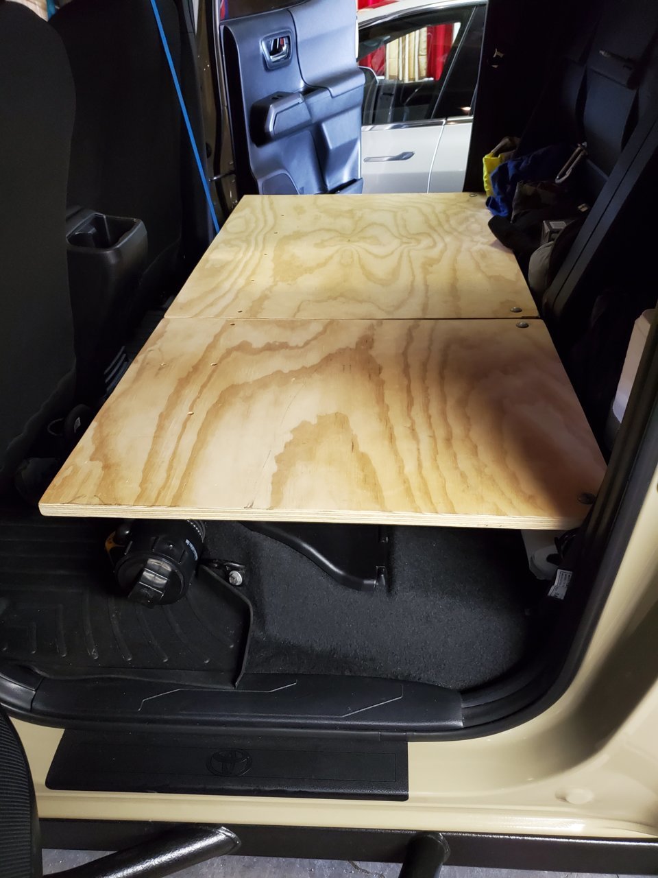

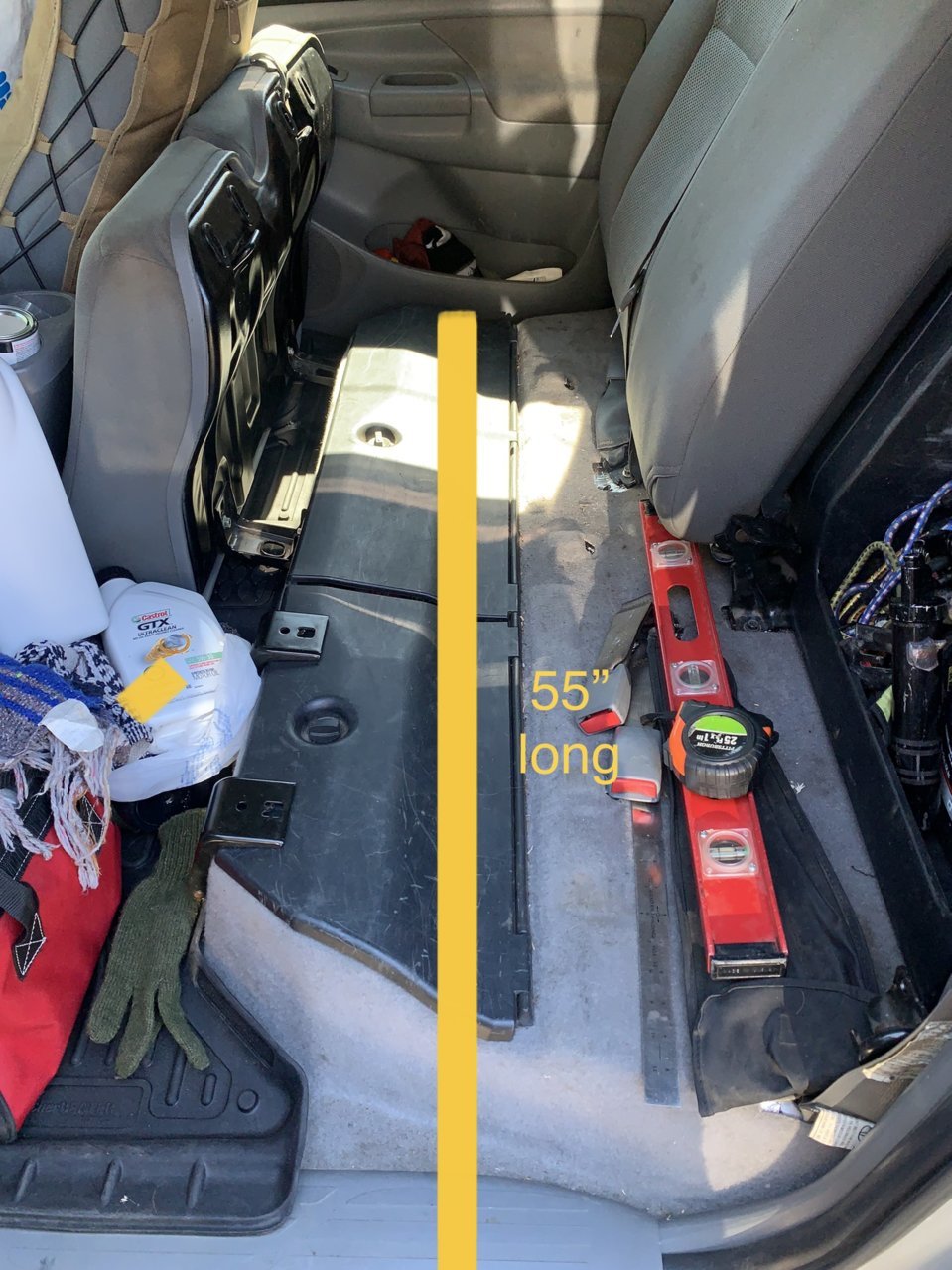

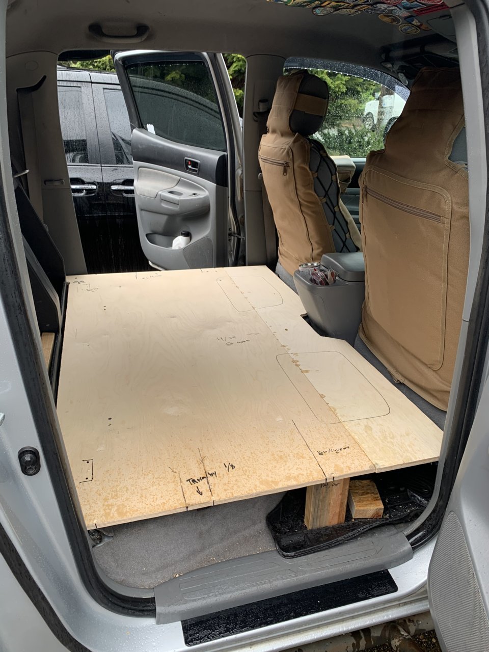

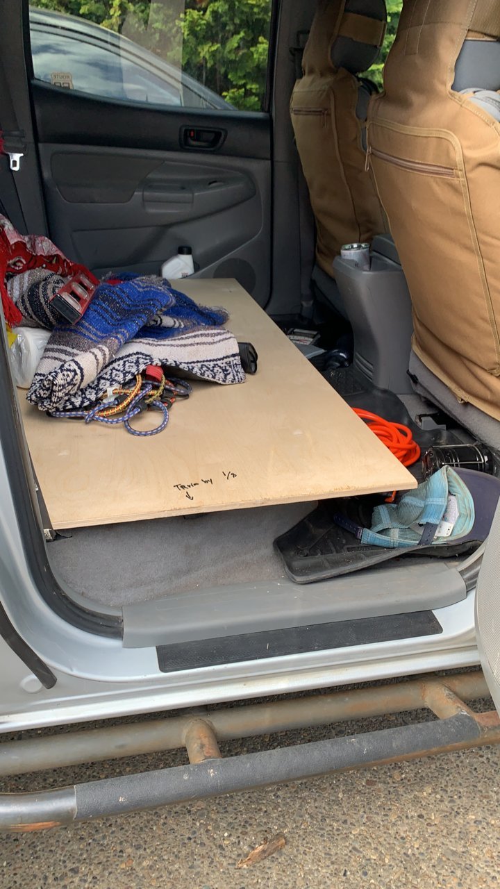

    Thanks for the inspo guys, I almost never carry anyone besides my partner and our dog, so the rear seats are mostly for sound deadening and filling the space back there. I opted for something simple and affordable. I decided to keep the rear storage and split the panel into 60/40, I plan on utilizing the 40% section for my second battery, fuse box, solar stuff (basically all my aux power). The base is beefed up with 2x4 supports and can carry my weight without any issues. below is my photo dump :D
    the following measurements is what I got using a level
    not usually this messy....:anonymous:
    and here is the final product
    I'm waiting on these to secure the back panels
    I should mention that I went on a rough and bumpy test ride, this thing is holding up well. I already sound deadened the whole cab last year, it's as quiet as it was with the seats (I'm half deaf anyway...)
