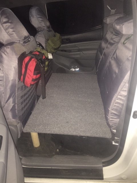

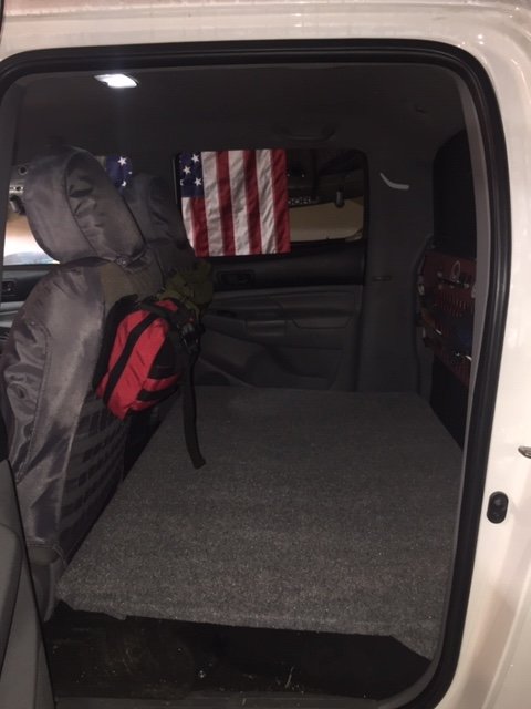

    I did use a router after making a quick template out of 1/4" ply. I used a 1/4" bit and told the Line-X peeps to add what they needed to the edges for a nice fit. I made a deck for a jeep in the past and had fitment issues because I didn't leave enough space for the Line-X... this seemed to make it easier for them and me.

    GooseGear makes a nice product and having built these from scratch, I can say to do it right with quality materials is NOT cheep. I built my own because I wanted the deck to be totally enclosed - could even be lockable with the right latches.

    Right on, my plan is to do the same. Planning on using auto carpet and figure a 1/4" bit should leave enough space for that but might need to adjust, or only fold carpet over on the hatch but not on the opening.
    I looked at the GooseGear, they are still working on the one for AC with jump seats removed. Nice looking product but I'd rather have the deck fully enclosed.

    What was trick to get the curves along rear doors, lots of trial and error?

    Foamcore templates cutting a little at a time

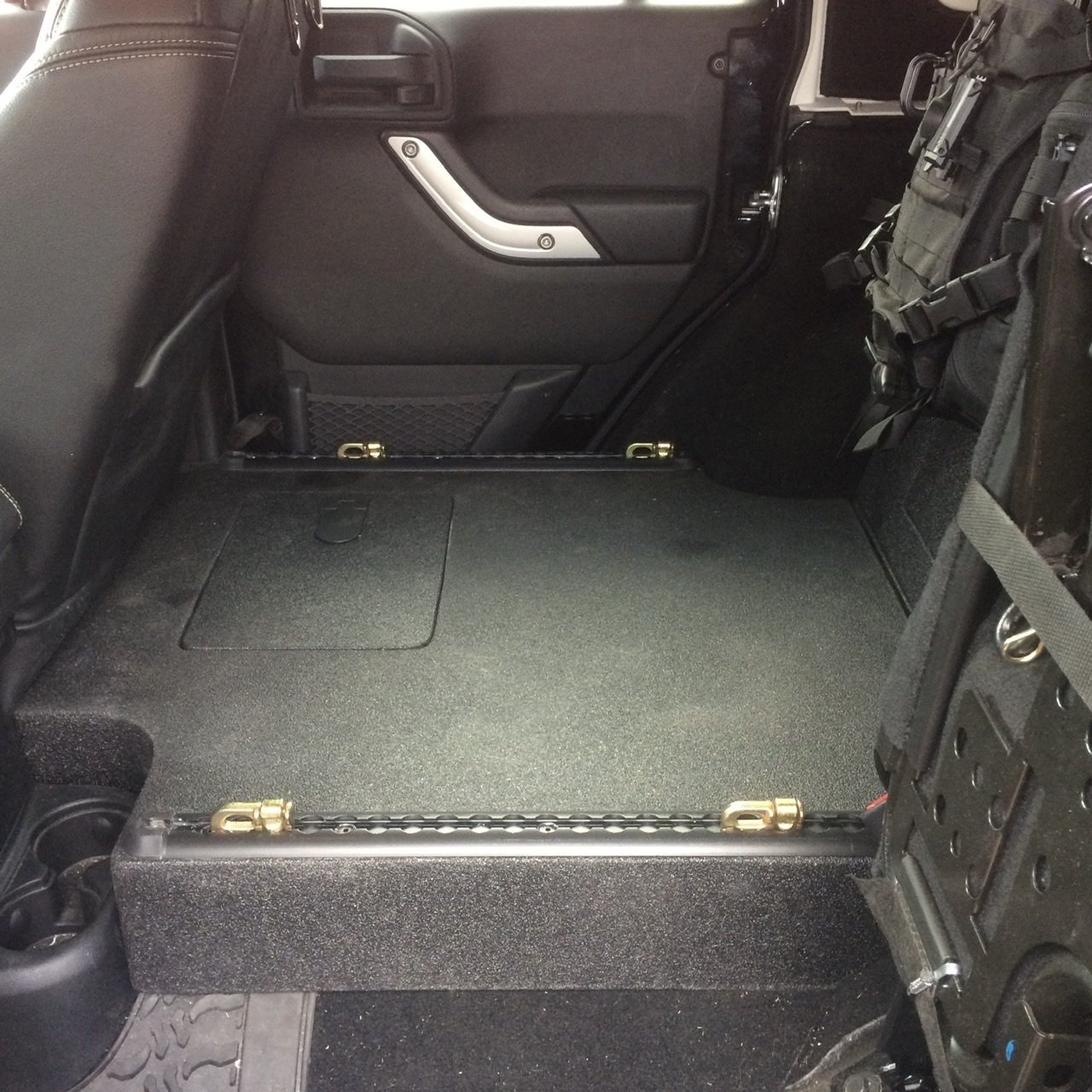

    I did a 60/40 in my Jeep JKU that worked well...
