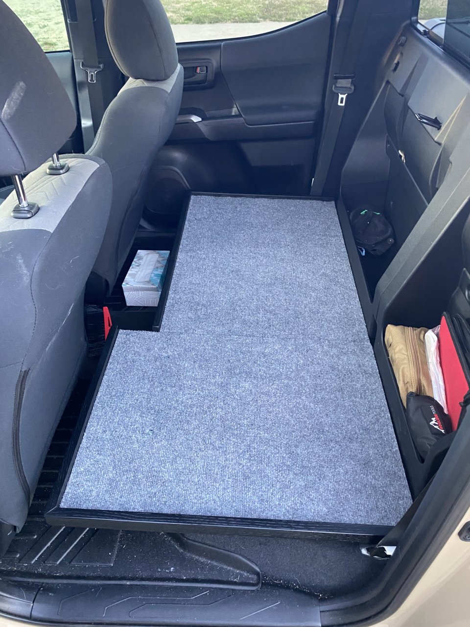

    Man these rear deck ideas are awesome! Some of you guys have some serious DIY skills. I removed the bottom seats from my truck the beginning of the summer to gain more interior storage for a long camp trip. (I'm too tall to just have them folded down.) I've yet to put them back in. Haha. This is what it currently looks like back there.
    I really like the level surface it provides and since I never really have passengers in the back seat I'm gonna have to steal some ideas from this thread.

    One thing I forgot to mention, if you do fold your seats down for any period of time, check where the seat buckles are. I failed to check and left the buckles in the little pouches on the seat and I'm afraid my cushions are permanently remolded now. :frusty:

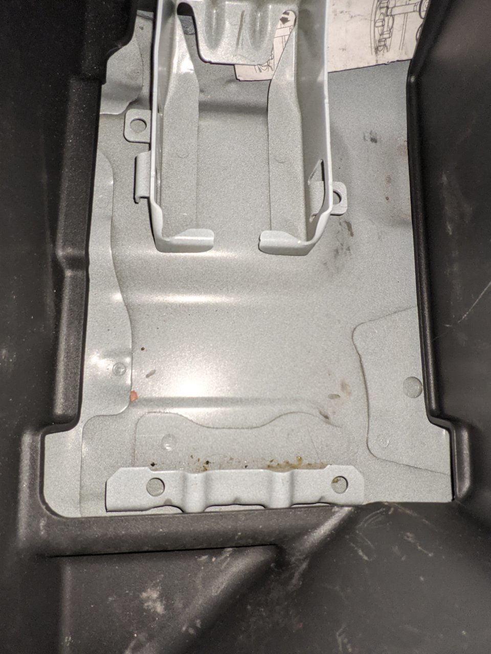

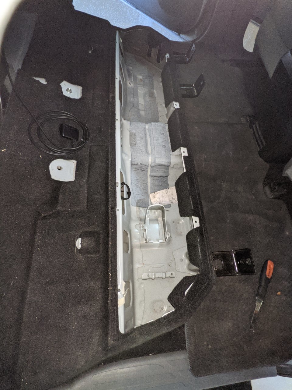

    The best way would be to get a spot weld cutter drill bit, and drill out the spot welds holding the metal box to the body. This would at least give you the option of spot welding the whole thing back in. Less permanent than saw zawing the box sides away
  6. Oct 17, 2021 at 4:04 PM
    #386
    scootter82
    scootter82 Well-Known Member
    Oct 2, 2016
    #198816
    2,026
    Aurora, CO
    I already had the deck out to clean up and that got me curious. Took out the plastic box. 10 spot welds hold the front side metal bracket to the truck floor, and 4 spot welds hold it on the side/back bracket. This is a totally plausible idea and I may do it....after a think and a drink lol

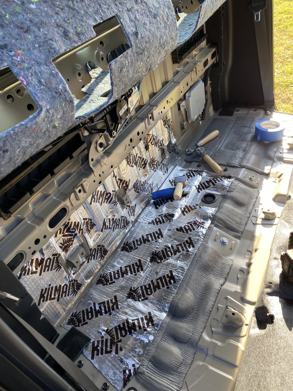

    Had leftover superlite dynamat from the E46 M3 project, so in it goes.

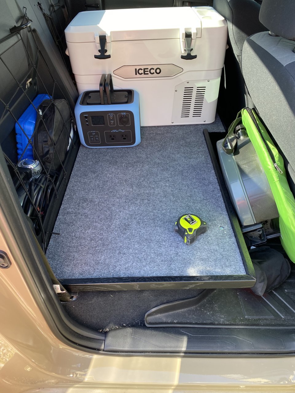

    wanted to share that for anyone looking for a rubber mat to keep on the surface of their seat delete, i found this one on Amazon.
    i bought the 3/8" thick mat as i thought 1/2" would be a bit much. the 3/8" can be trimmed to size and does a great job to keep things
    from sliding around on the surface of the seat delete. the other mats that i found either wouldn't ship to my location, were pricey, or dimensions didn't make sense.
    https://www.amazon.com/dp/B08SZ4NKHM?ref=ppx_yo2_dt_b_product_details (no affiliation)

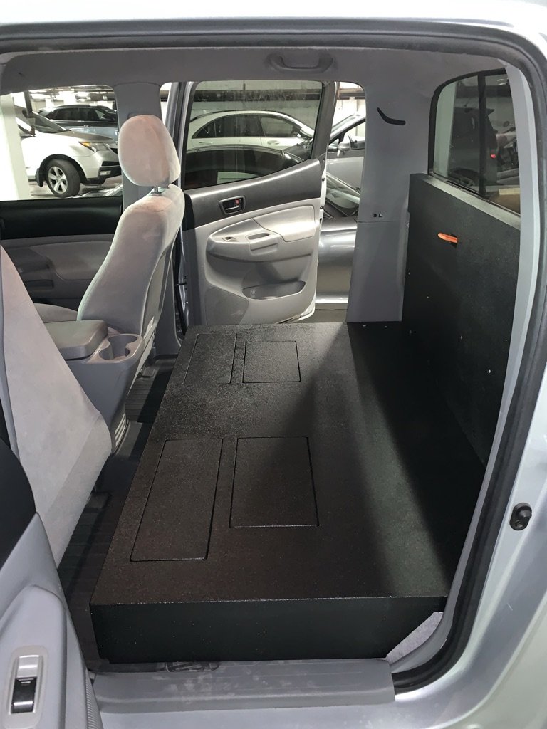

    also wanted to share a pic of the Access Cab Rear Seat Delete installed in an AC without seats from the factory:

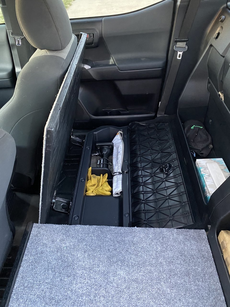

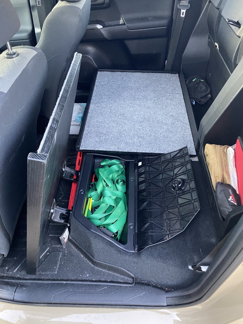

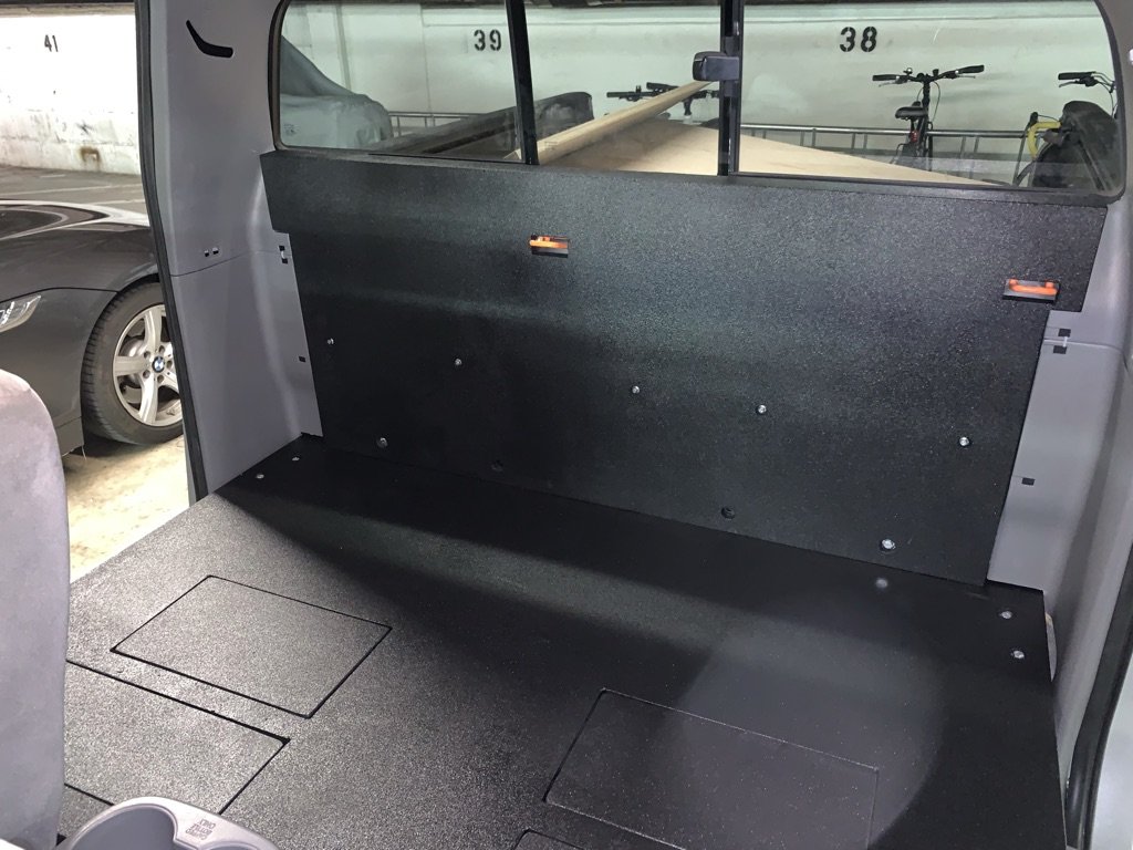

    Just about done with my 2nd gen DC rear-seat delete. I'm adding some 1.5 in. nylon webbing to the bottom / side of the storage doors so I have something to pull them up with. Will likely add a couple large Grey Man Tactical MOLLE panels to the rear wall at some point.
    Heavily inspired by OP and Goose Gear.
