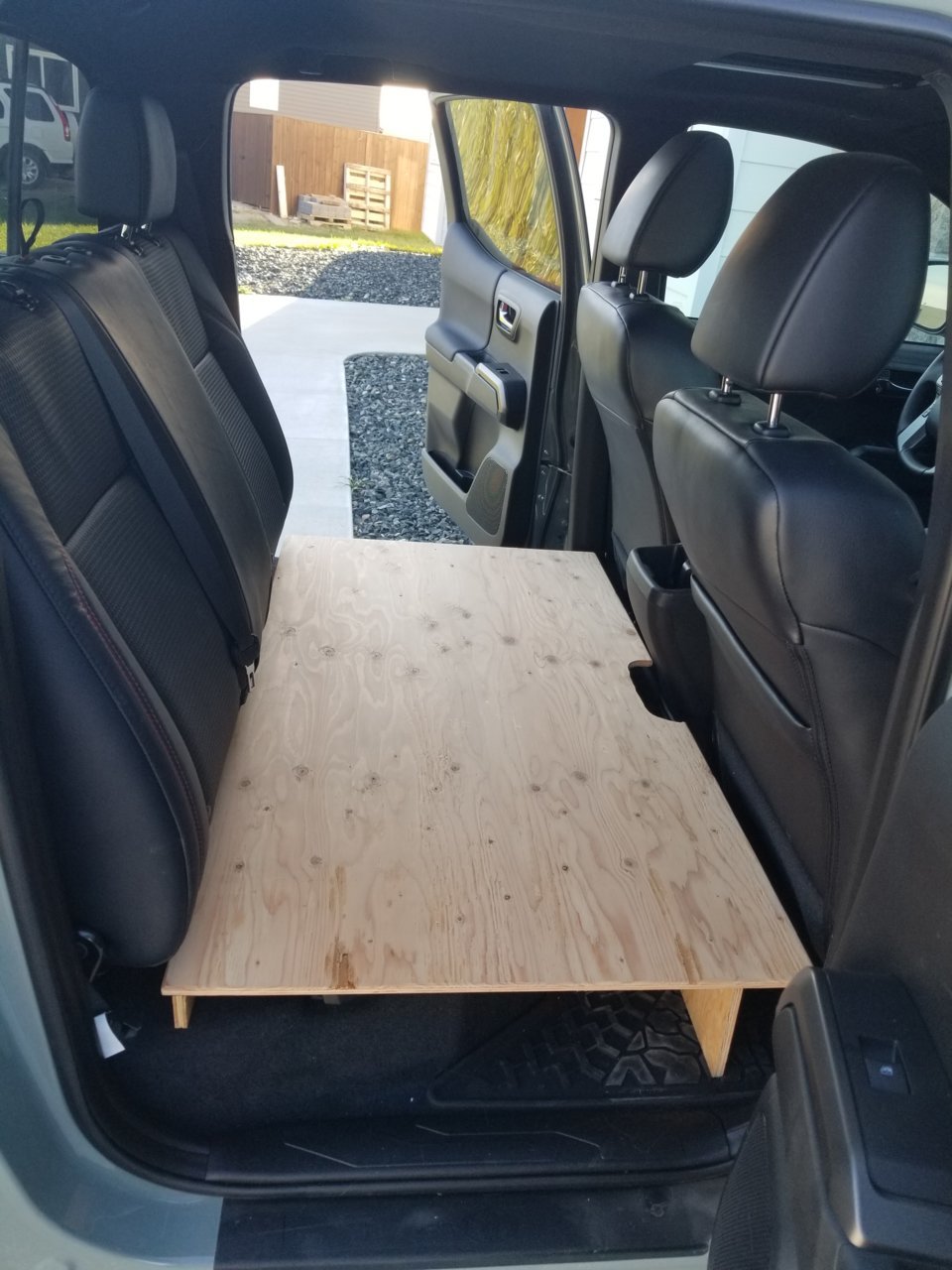

    Both the bottom deck and the rear wall are actually 3/4” 5-ply birch coated with roll on Raptor liner. I was pretty pleased (and surprised) with the quality of the Raptor Liner.

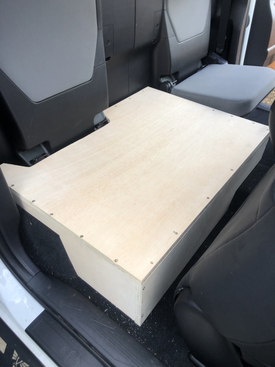

    I did some tinkering over the weekend and built a 60/40 deck for my Access Cab out of 3/4" plywood:
    I'm very far from a woodworker, so excuse some of the chicken scratch. I had to use some wood filler in a few spots :( but I think it looks clean now! I'm going to start working on my hatch that's going to be over the center of the factory storage boxes + extend to the footwell to house a second battery project. Anyone have a recommendation for the amount of relief I should account for when making this hatch? I was thinking 1/4" all around as I'm going to carpet and add a hidden hinge + a push button latch. I've got a 60 lb puppy right now that's on track to be around 90 lbs when he's done growing, so the hatch will be framed-in by stainless steel hatch trim. Any advice is helpful; I've built hatches before on a few boats but that was about 10 years ago.

    Awesome! And it doesn't look like chicken scratch. You did a very nice job! Did you put the passenger seat all the way back for your measurement? And are you thinking you'll frame around the seatbelt latches?

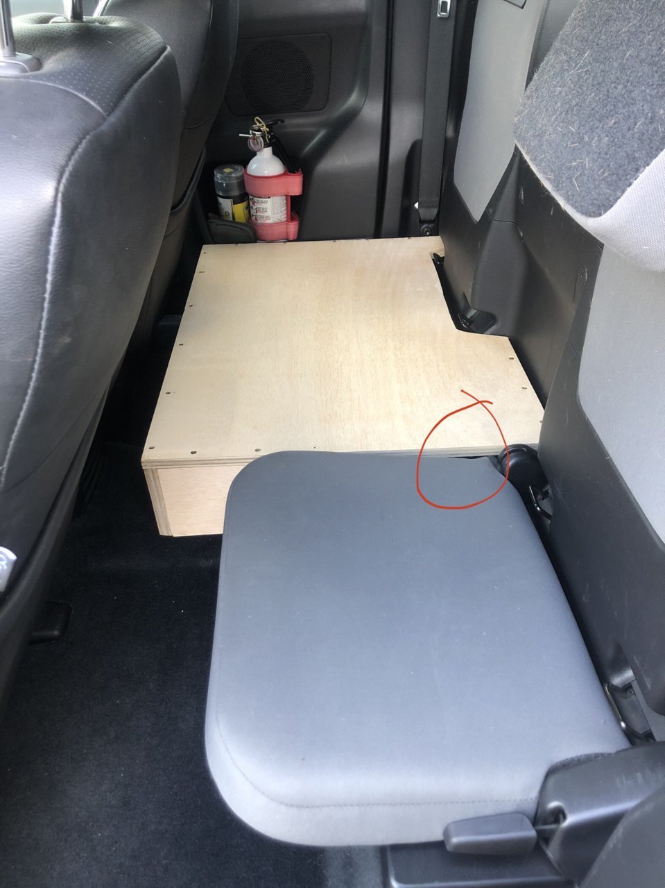

    Thanks a lot! Yes I put the passenger seat all the way back so I know it reclines nicely. I think the depth at the deepest part (touching the back wall) is about 23” front to back if you need that measurement. I put a small piece of plywood along the back where the seatbelt latches are just to level it out, but I won’t frame it all. I left part of it exposed so the passenger can grab the seatbelt latch from underneath the platform and click in. You can kind of see the open spot here:
    I completely removed the other seatbelt latch.
    1/2” overhang sounds good. How much relief did you use on your hatch? Like did you cut your hatch door about 1/4” smaller than the actual hole? I’m waiting on carpet but still contemplating how much I want to cut off of there.

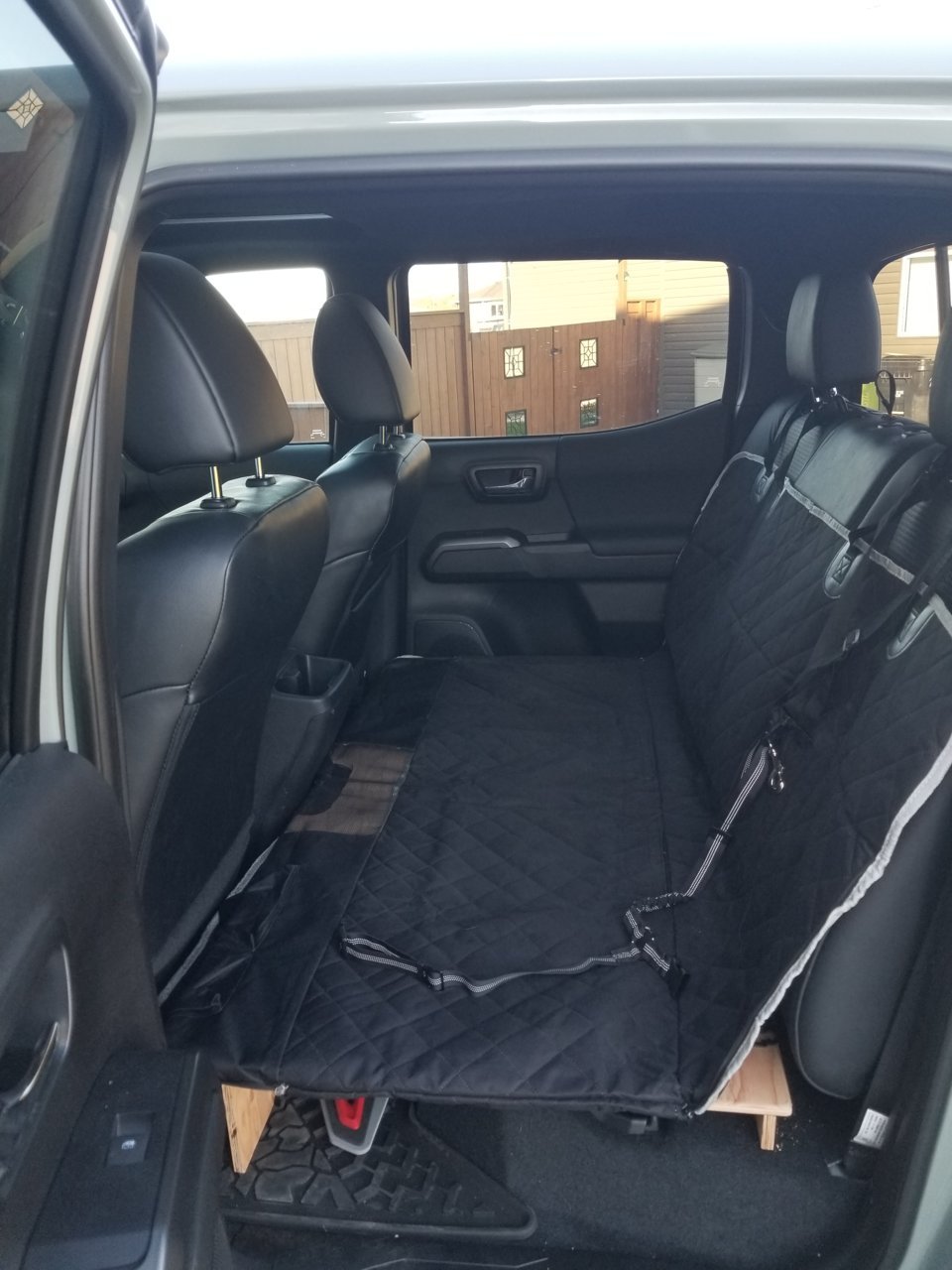

    Did a quick and dirty today.
    Had some 1/2" sheathing lying around. Wanted to make something that can easily go in for the dogs to lay on but easily revert back to seats.
    Nothing fancy but it was free and I can pull it out have someone sitting in the back seat in five minutes.

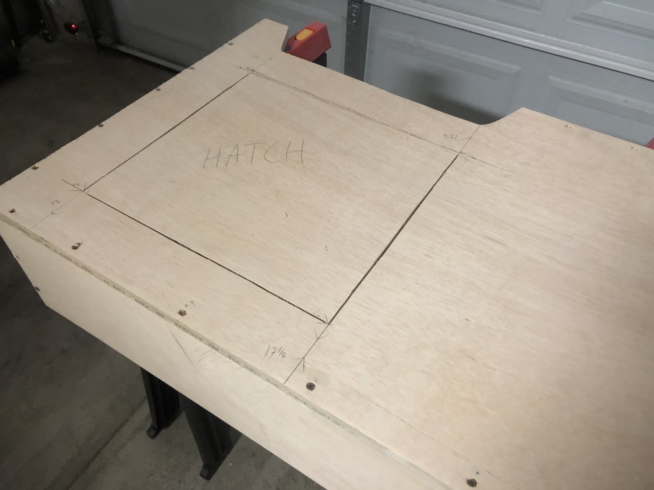

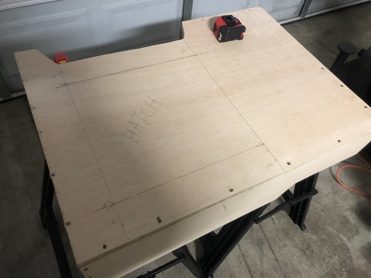

    Figured something out today, I think. So mock up your hatch:
    Then use a circular saw to plunge cut as straight of a line as possible. This will help avoid the nasty crap you get when using a jigsaw for straight lines.

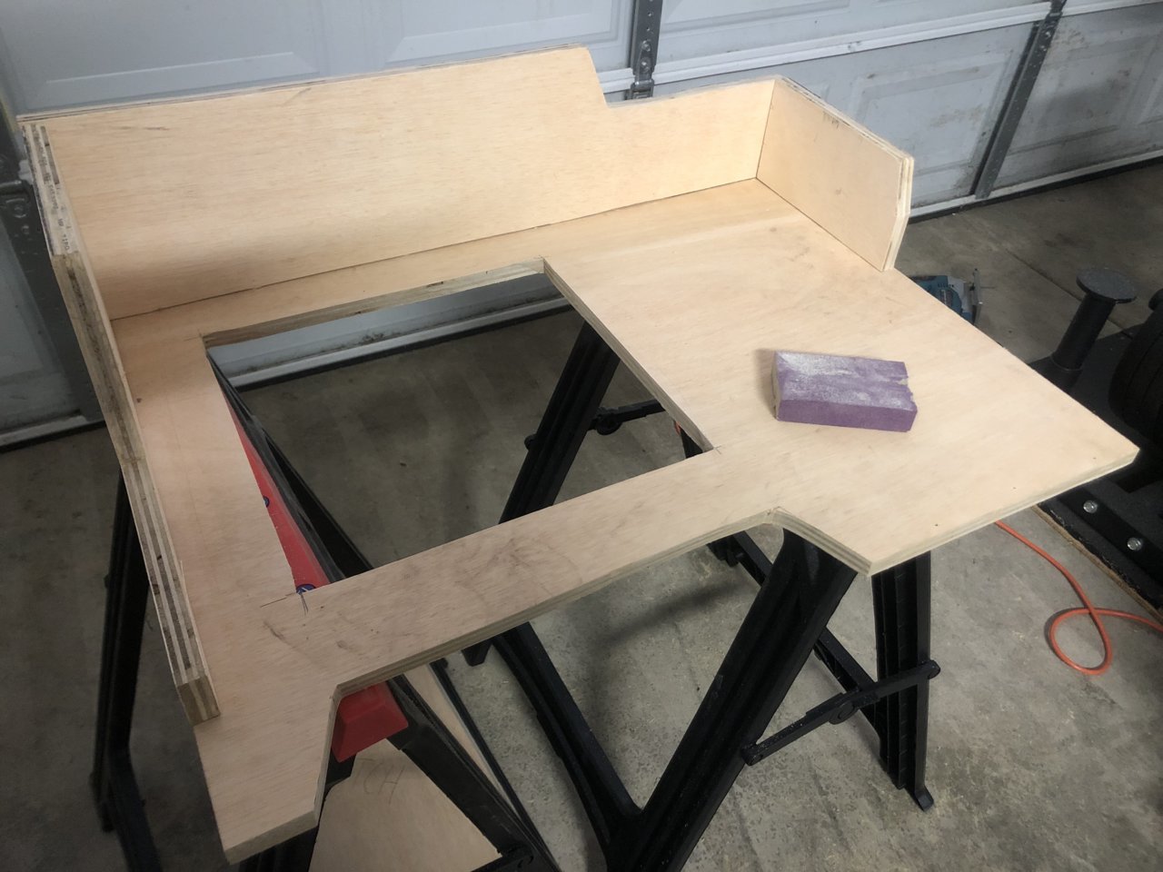

    Flip it over so the finish side is facing down and just end the cut with a jigsaw.
    Muuuuch more square than I’d ever get with just a jigsaw. Now onto bracing and carpet!
