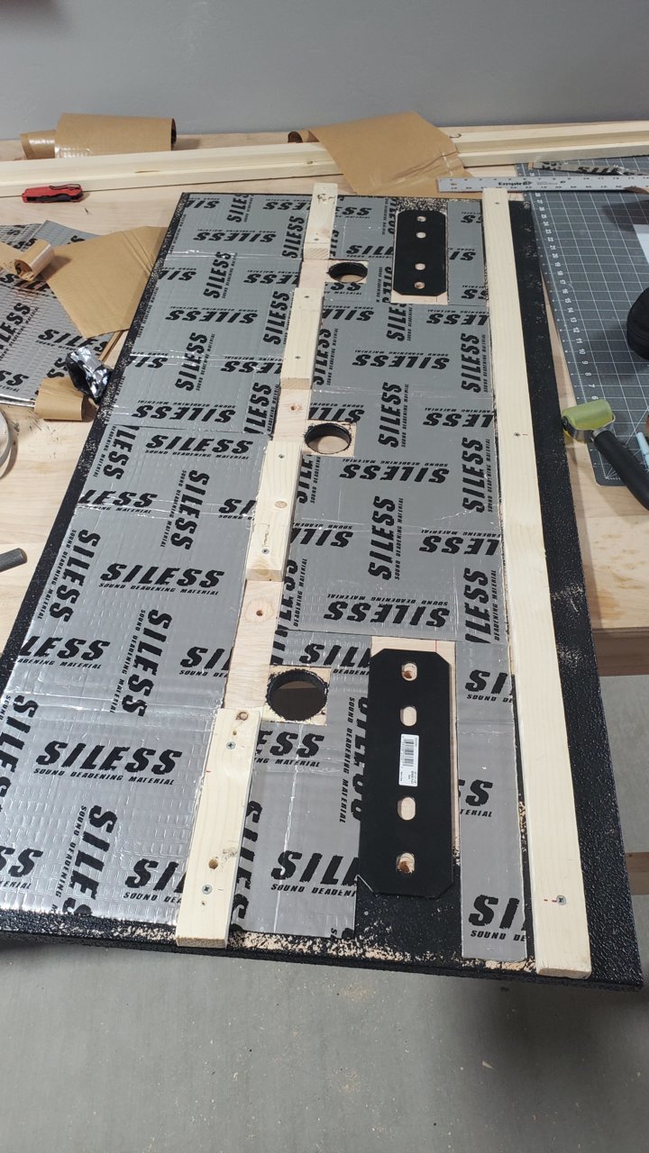

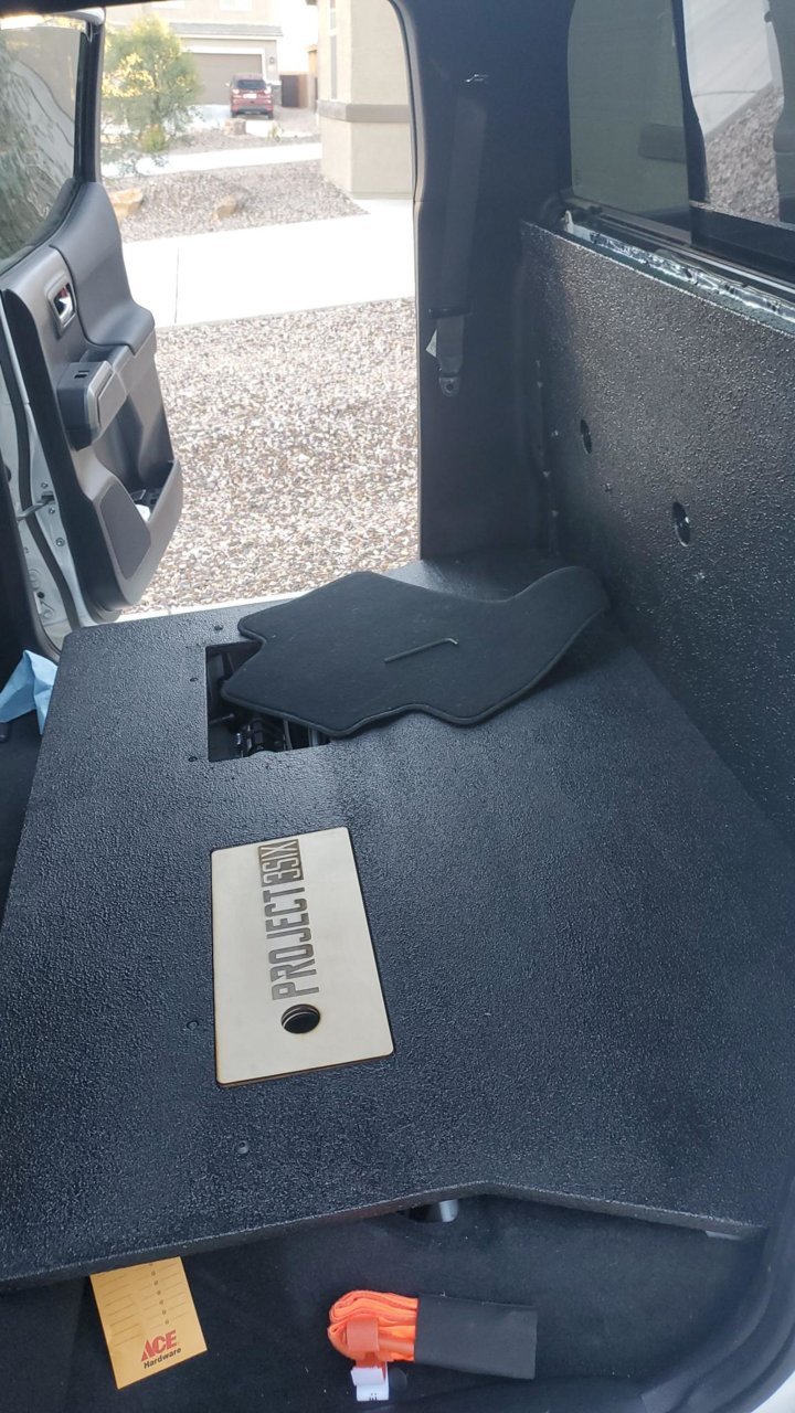

    Icon Stage 4, Method NV 305, 285/75/16 Wildpeaks, C4 armor, CMC, CaliRaised Sliders
    It's coming along. I need to figure out how Goose does their rear. The window mechanism sticks out too much to mount the panel flush and at 90* of the platform. Gonna throw in a plate underneath then mount some drings through it. A cargo net is planned as well. Need to laser up the other door too. Was going to look at mounting foam or another insulator around the vents to cut the road noise. Going to mount more sound dampening to the backside and underside when I get some more free time. Thought about running plasti dip in the cargo space to make it look good but also so shit doesn't roll around on metal.

    2017 DCSB TRD-OR
    I used 15 series 80/20. That 1.5" seems to be a good amount of spacing to clear the mechanism.
    Working on the back piece. Need a 1/2" bit to finish drilling the back plates. Gonna order a bolt in dring and mount it through the bracket. Figured that would stop the flex if I have to ratchet something down.
