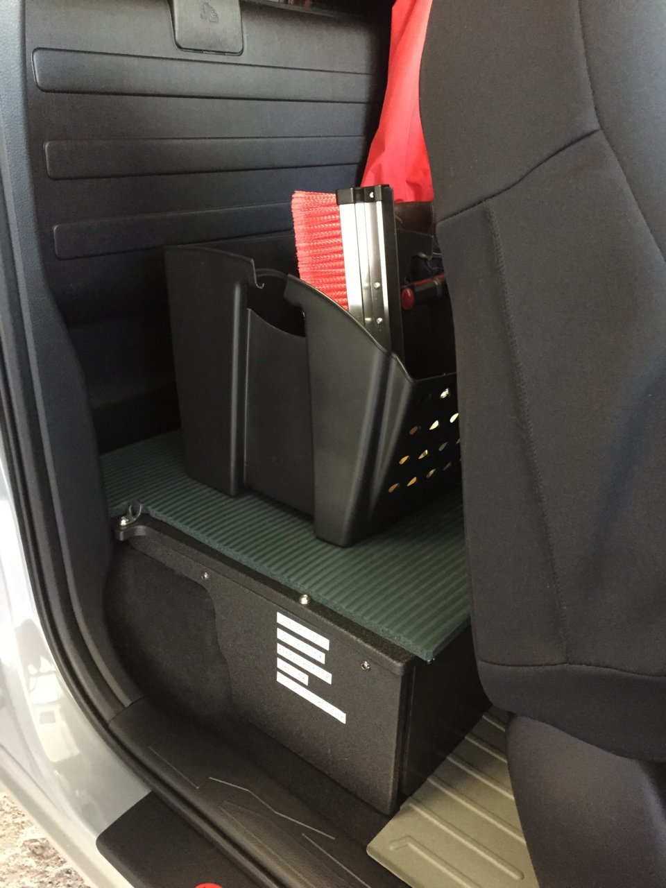

    Gonna have to get smaller flusher bolts to bolt her down with

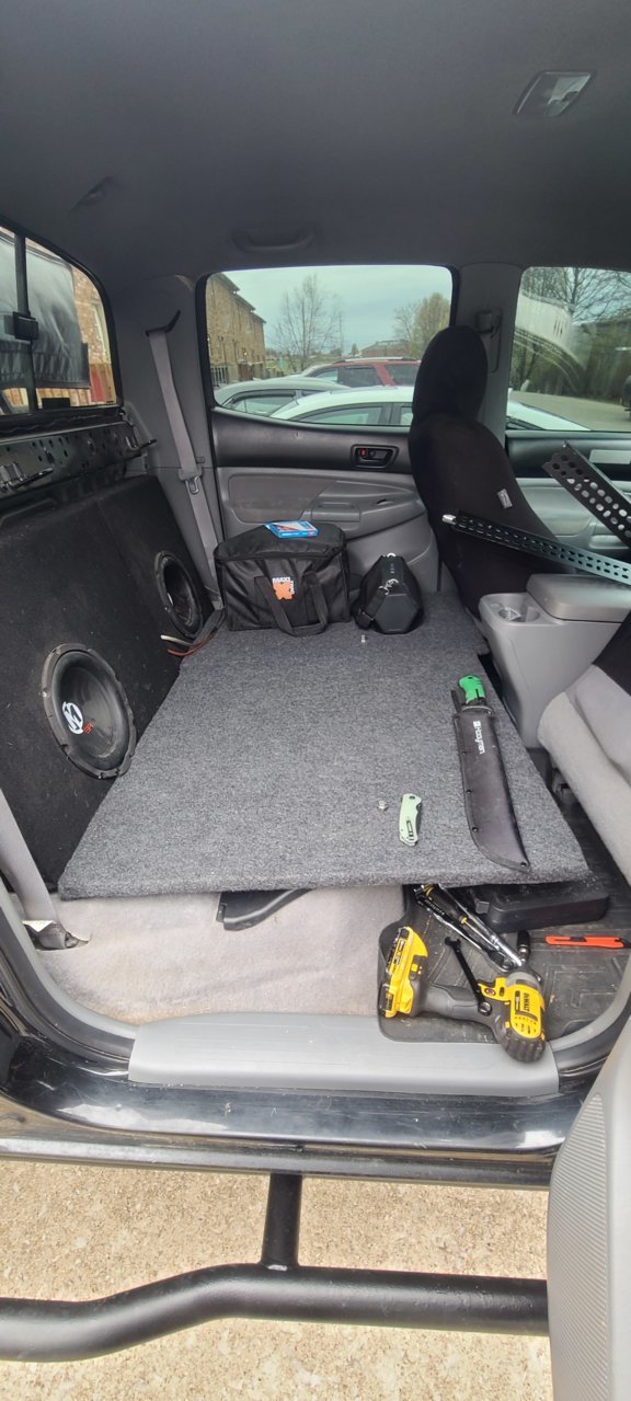

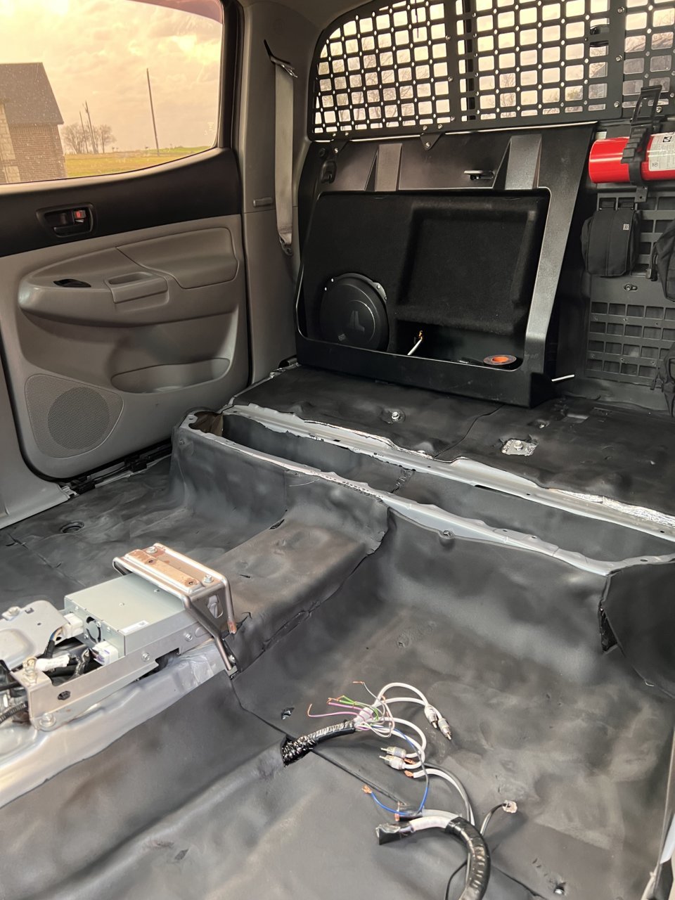

    JL audios sub box for the tacoma seat bin

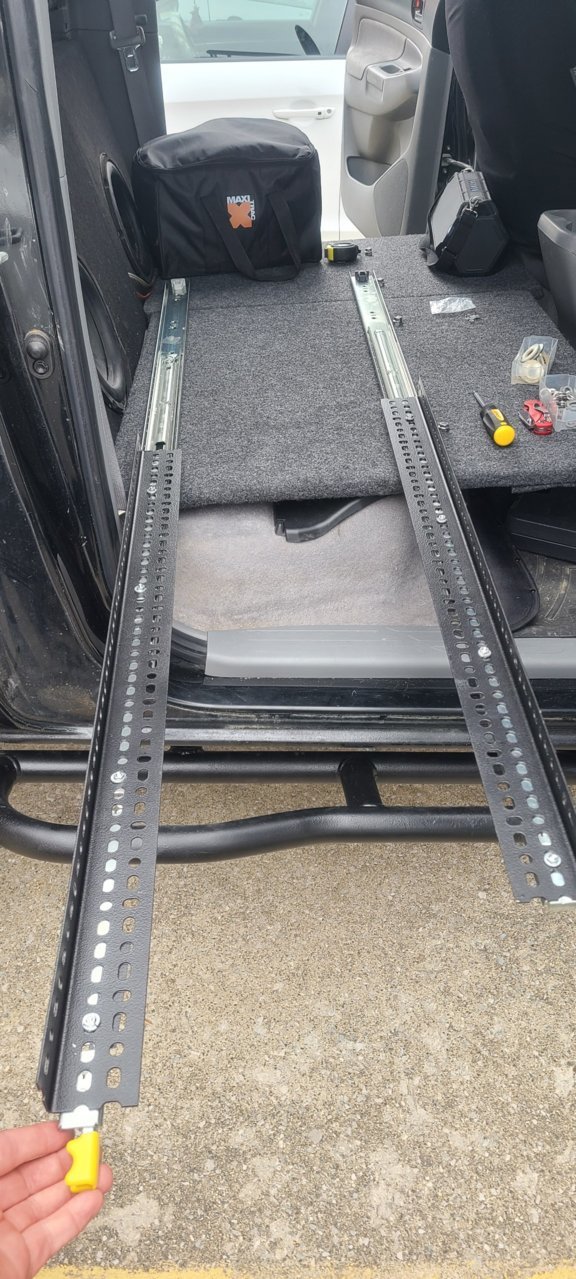

    Fridge slides

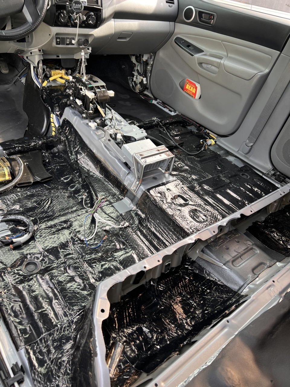

    It is if you don't lay deadener down. I did the back wall as well as the cubby area under where the seats were and it's real quiet now. Still hear those squeaky ass leaf springs squealing if I have my windows down though.

    Mine quieted down, but I'm soundproofed the hell out of it with Kilmat and layers of dense foam. As well as being covered with a solid surface. It's still loud and squeeky though.
