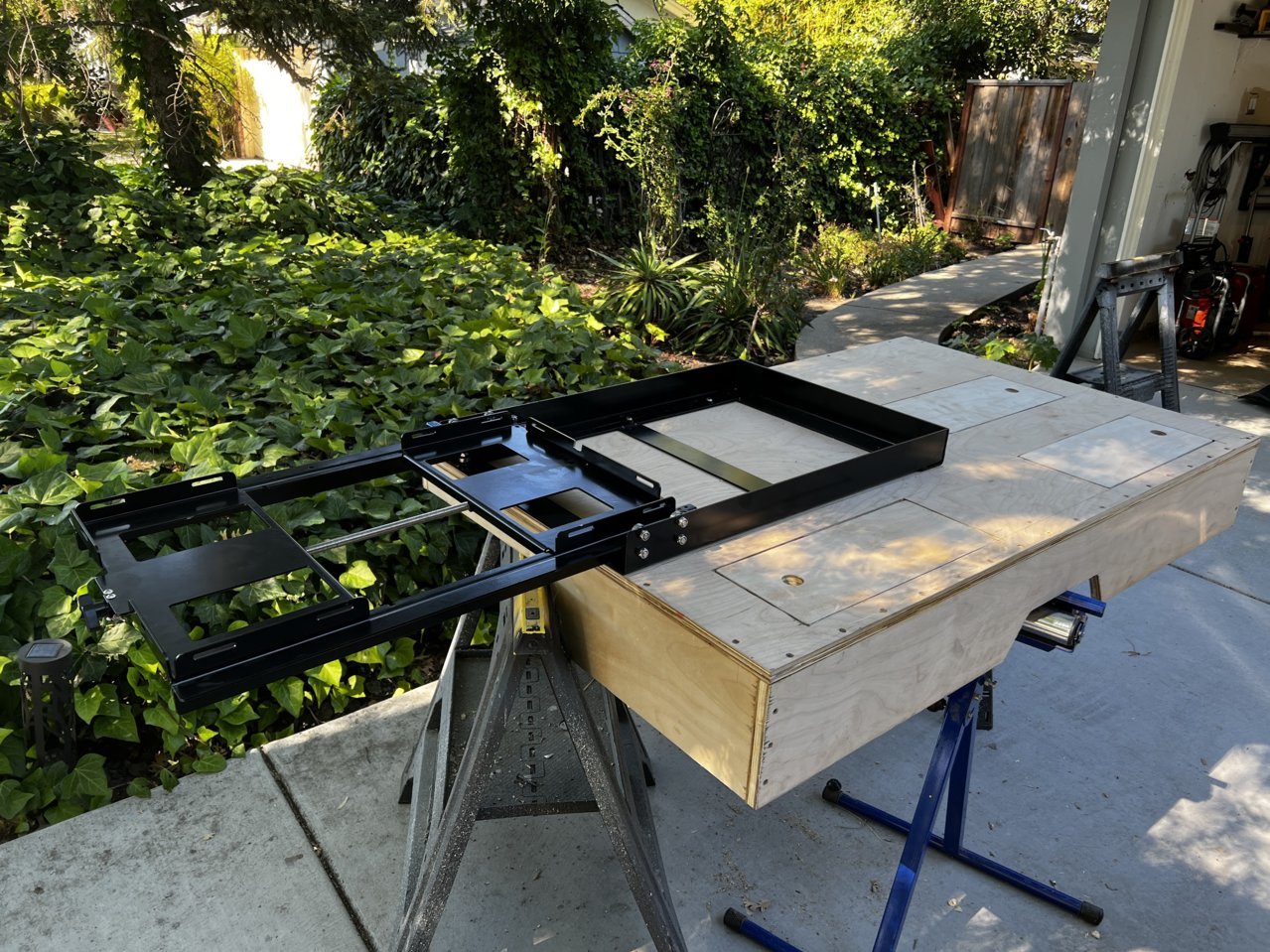

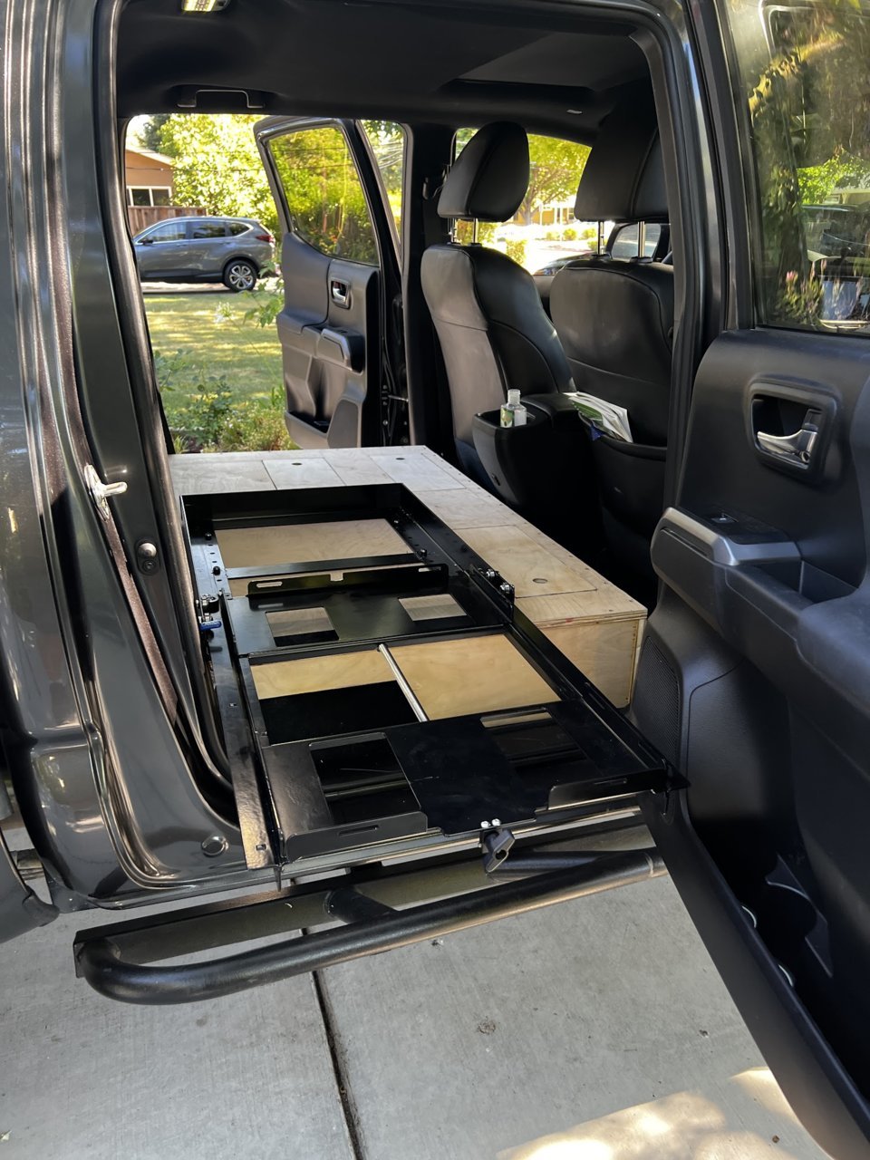

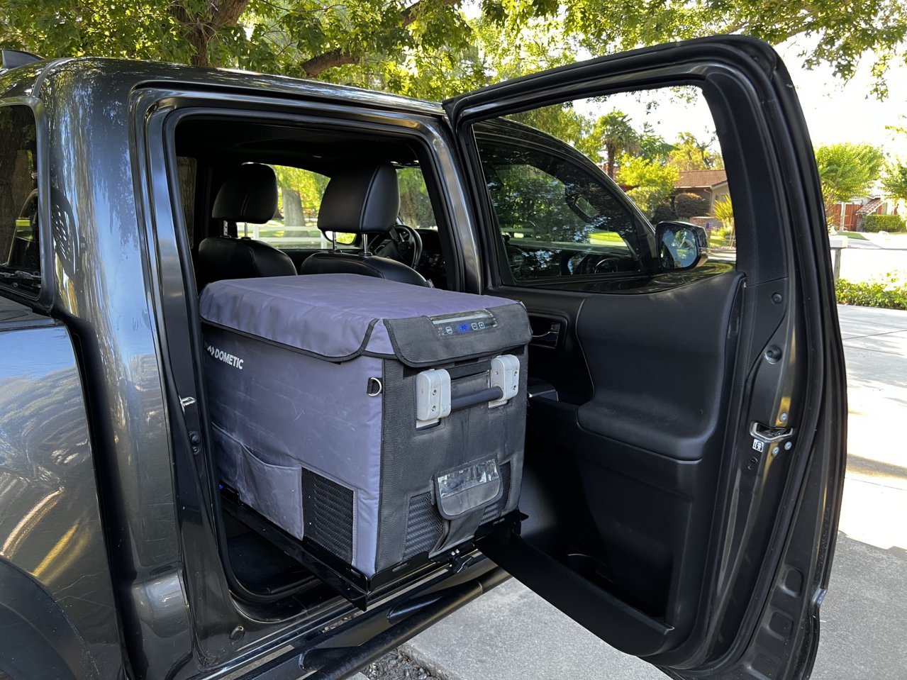

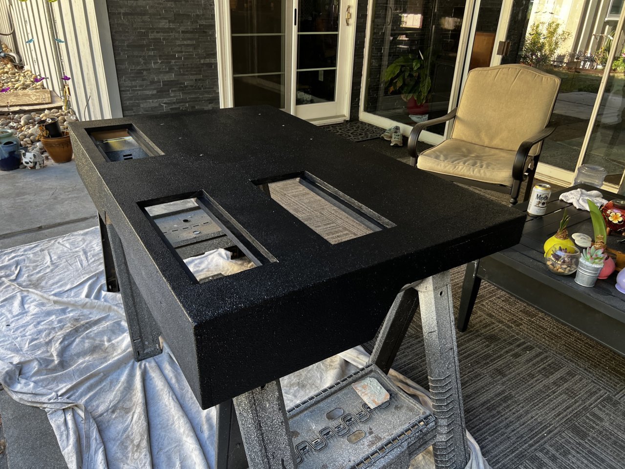

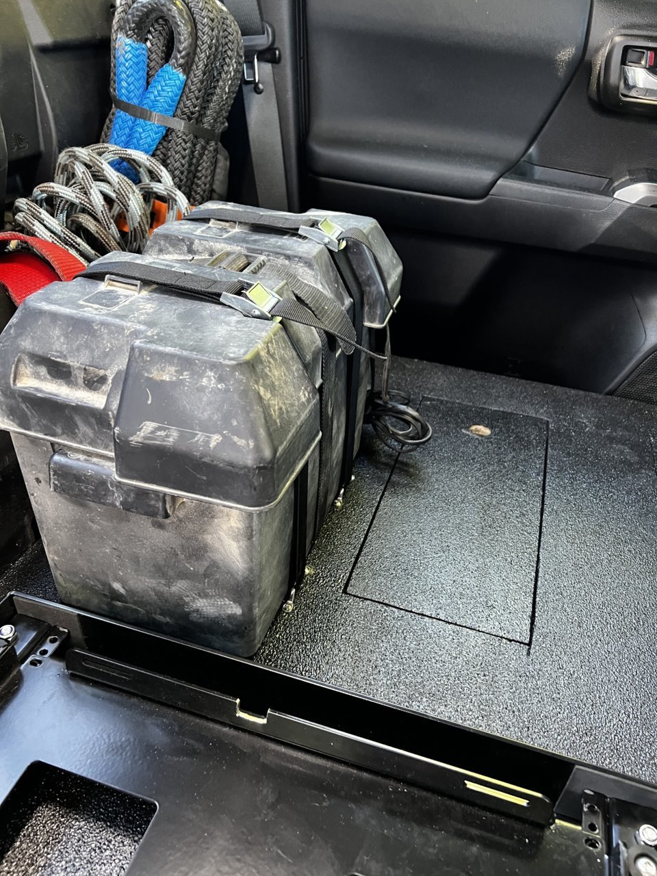

    I borrowed @RippNSh!t 's design and cobbled together a deck. Not pretty but the end result come out well enough. Used 3/4" Baltic Birch shop grade plywood and roll on Raptor coating to finish it off.

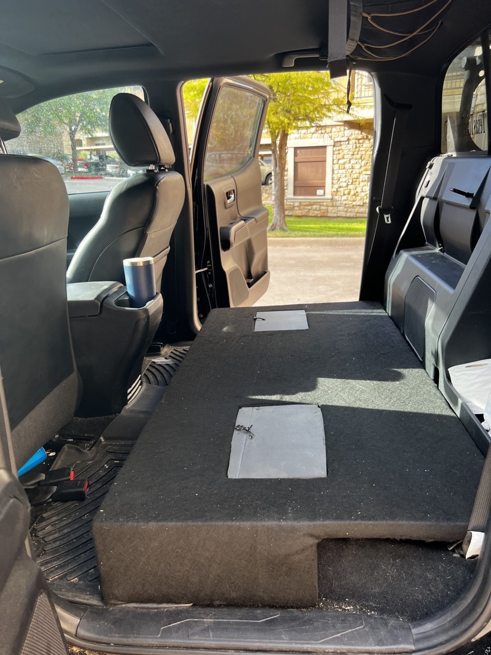

    8DA36BE1-7CB4-48BC-A6BA-4159D27E30EE.jpg 50B8FFAD-791E-4D92-9CC4-97D44EE36702.jpg B4BA8646-6C5B-42F3-AB78-2E99C688845F.jpg 73E43ADC-A61D-40C9-9C53-4486E5FFCFA2.jpg

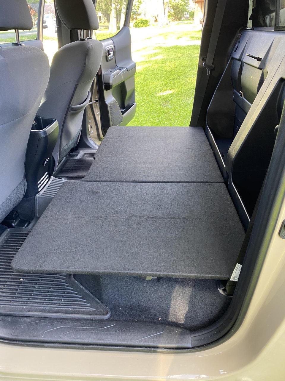

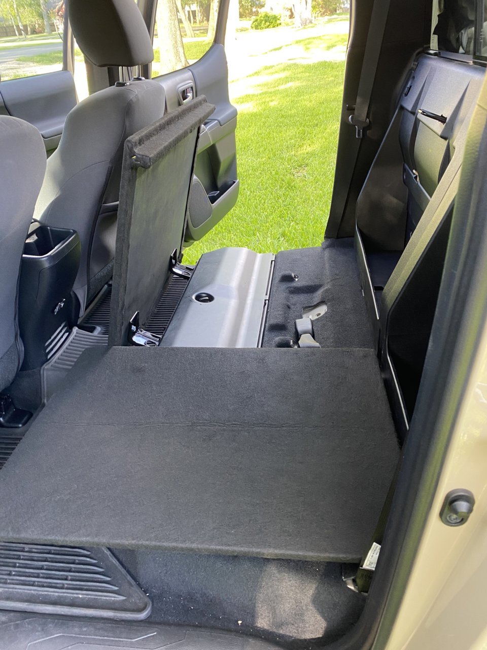

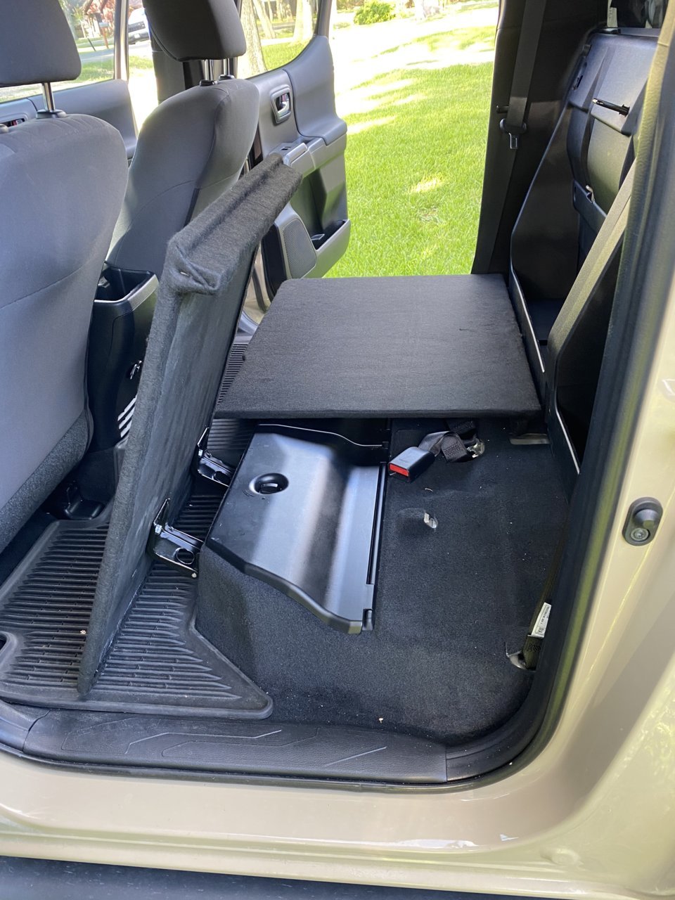

    It’s easy and simple about 4 hour build. 1/2” plywood and for the hinge attachment 5/16-18 x 3/8 T-nuts and 5/16 x 1 bolt (I believe that is correct) I cut the bolts down so not to extend through. 1x2 for rear foot glued and screwed, a coat of flat black paint and then glued and stapled on carpet. I used cardboard to make my template. I cut down the passenger side a little more to fit some of my wife’s camera boxes or what ever I need to put there. My original template has both sides the same length. I think for me the most stressful part was finding the hole location for the T-nut hinge attachment.

    Kept it simple i like that. details on the build?

    What a wonderful way to create a rear platform. What appeals to me is it's simplicity, use of OEM mounting points (so that you can return to stock form with the spin of a ratchet) and weight savings over other designs.

    Exterior: Diode Dynamic LEDs w/ Baja squadron fogs, Prinsu roof rack, 265 Nitto Ridge Grapplers, Apex Sliders, CBI Aluminum Overland Bed Rack, Total Chaos Bed Stiffeners. Interior: Diode Dynamic LED Interior lights. Accessories: Mountain Hatch Tailgate Insert, Roofnest Condor RTT (stays on 24/7), RotoPax extra gas container, Maxtrax, Waterport hose, bottle opener Suspension: Front Bilstein 6112 (set 6/5) 600lbs springs, SPC UCAs. Rear Bilstein 5160 and Icon RXT Leaf springs.
    3 day after work project. Going to add som anchor points but definitely used this thread for ideas.

    i'd love to hear how well this stuff holds up longer term. i would expect the 2k formulation would make for slightly better hardness.
    been using this lately on a number of projects, i'm really happy with the texture and finish quality, though a buddy has tried it as actual bed liner, and it doesn't hold up for very long
    https://www.homedepot.com/p/Rust-Ol...lack-Truck-Bed-Coating-Spray-248914/202097787

    It’s solid. Super hard and durable

    I recently used this stuff on my hardshell rooftop tent and it turned out pretty good, but I decided to try the Herculiner spray over the top of it and honestly it's even better. They are really similar, but I like the Herculiner a bit more.
    Also, I used the roll on Herculiner for my seat delete and have been really happy with it. The trick is to get the right roller type.

    The herculiner spray lays down a little bit thicker than the Rust-Oleum one does, so it covers up imperfections better and has a slightly rougher texture. It's also easier to get an even finish. I tried raptor liner as well and it's just not as good as the herculiner.
    And for roll on, get a roller like this if you can find one in stock. The ones you get at the hardware store are not porous enough and you won't get enough texture to the finish.
