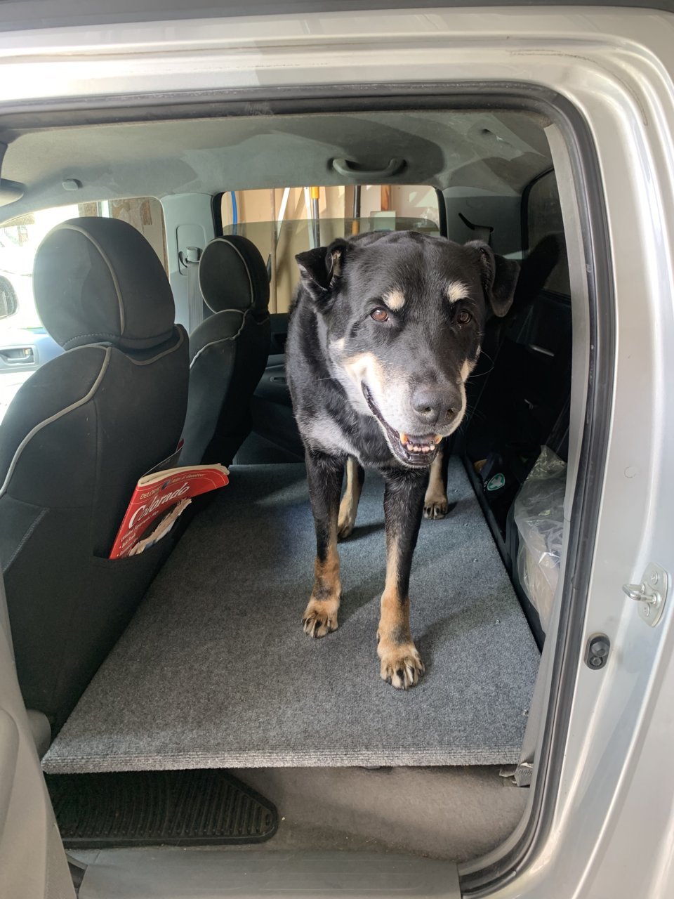

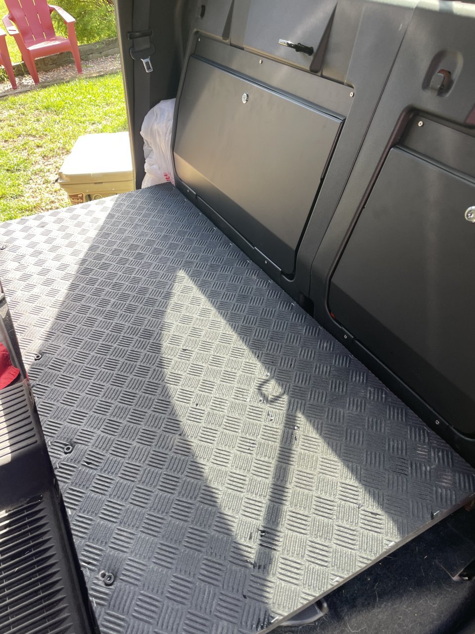

    24x48 MDF, cut to 22” deep and glued 2” piece to the back so board sits level. Board attached to factory seat hinges. Stapled rubber scraper mat to the board while Loctite construction adhesive dries.
    Storage covers are Hooke brand from Amazon. Keep an eye on price and you’ll catch them for 50% off occasionally.

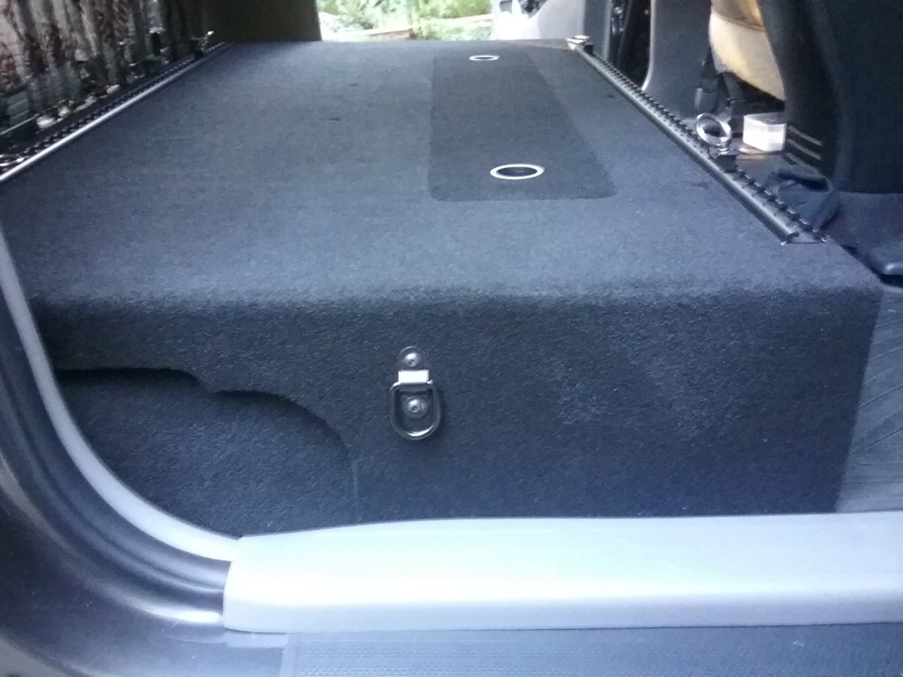

    Did this today but kept the storage compartments. Made a ramp that fits underneath the deck with extra plywood and carpet. Pup approved. C57A451F-1CE3-4A99-ACDB-7D824DE57DE9.jpg

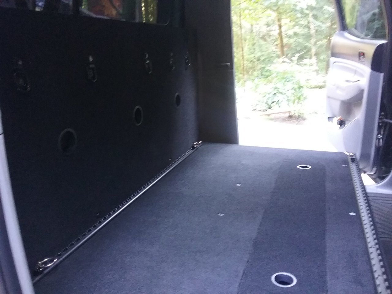

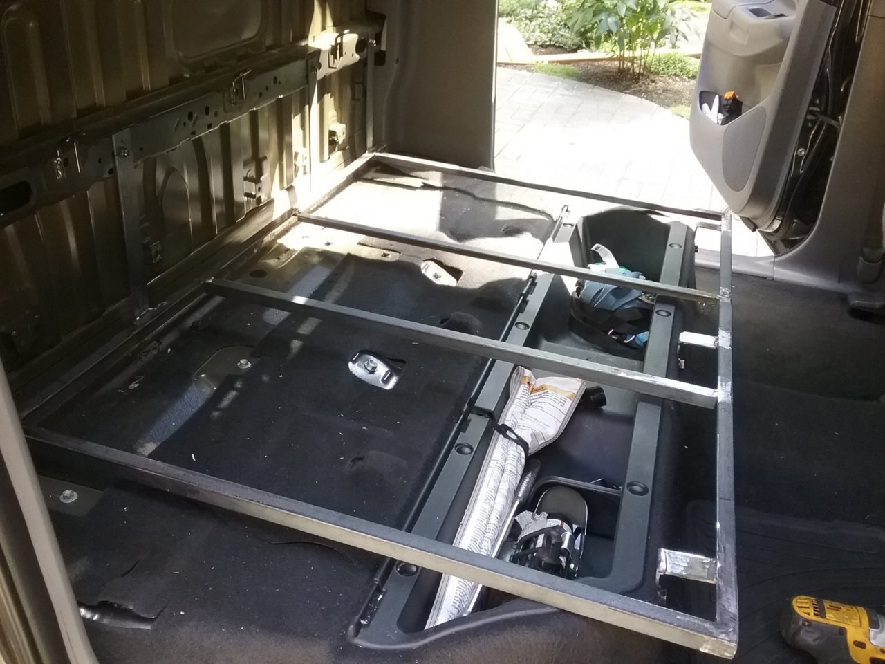

  13. Oct 16, 2022 at 1:20 AM
    #593
    G2G
    G2G Well-Known Member
    Oct 12, 2022
    #407830
    100
    Bellingham, WA
    2015 DCLB TRD Sport
    Suspension, Bed Slide, RedArc BC-DC Charger, ARB Twin AC, Onboard Water Tank w/ pump, Rear Seat Delete, Front Bumper and winch, Roof Top Tent w/annex.
    Thanks to TW and all the good information shared by others. I'm very happy with my energies.

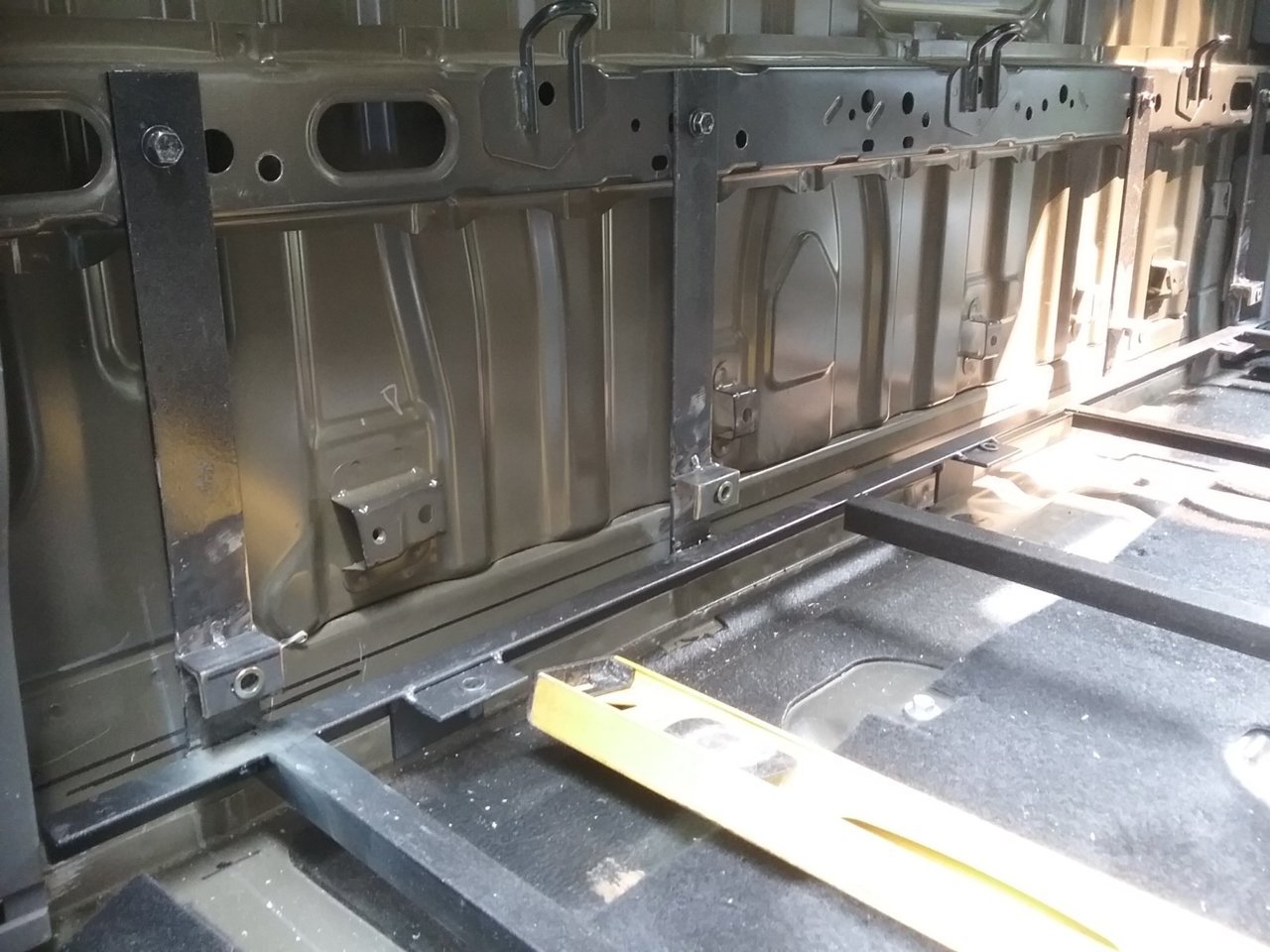

    In my efforts I wanted no harm to " G2G"
    (Good2Go). My base frame bolts into factory bolt holes and is secure. My deck bolts to the frame via nutserts.

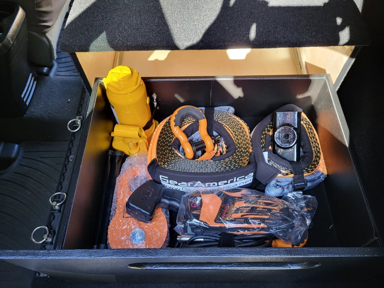

  14. Oct 16, 2022 at 3:39 AM
    #594
    G2G
    Oct 12, 2022
    #407830
    100
    Bellingham, WA
    2015 DCLB TRD Sport
    JW, thanks for the like.

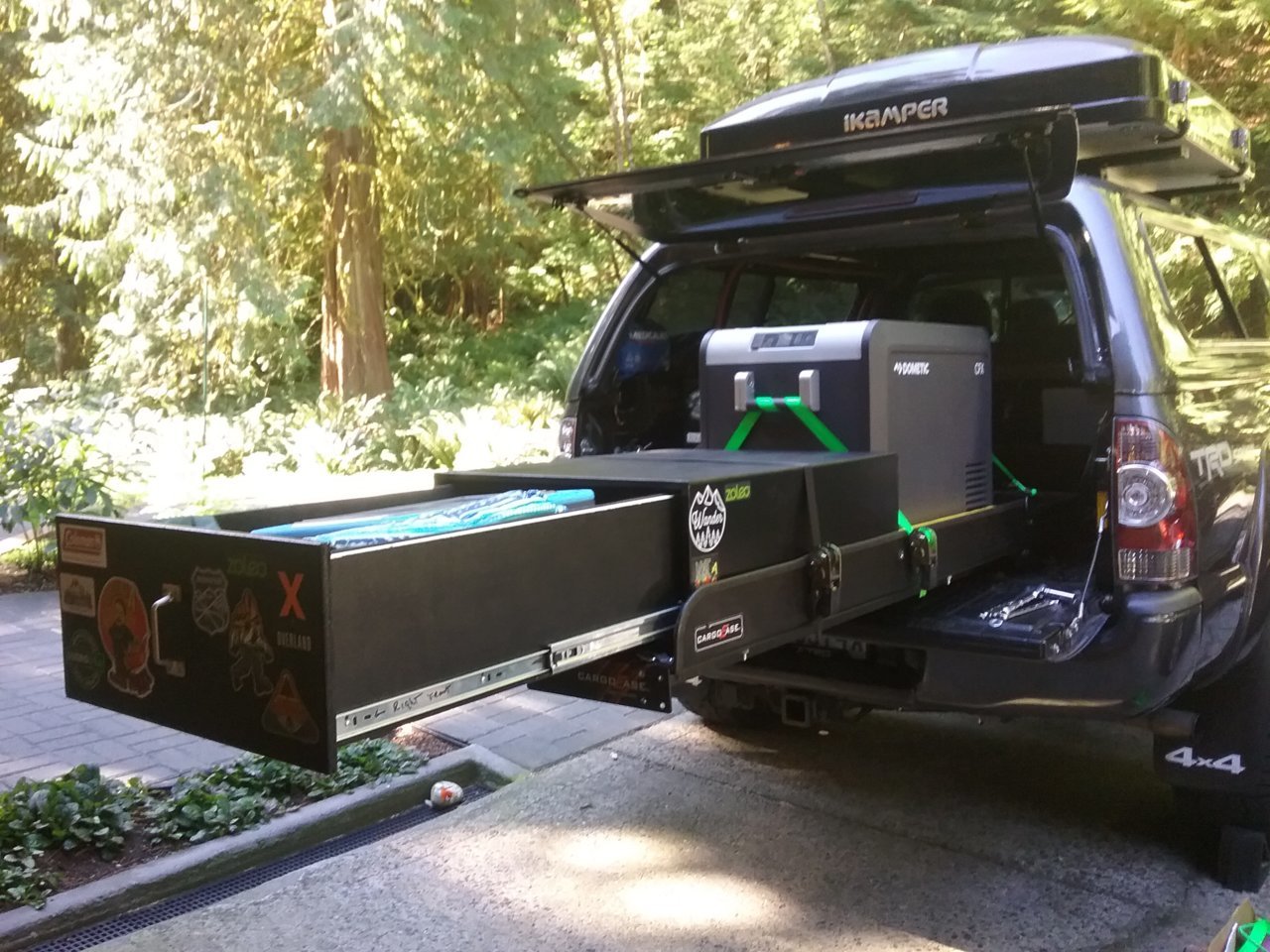

    We all have different needs for our rear seat delete. Personally, I understand my needs and desire to build in flexibility.
    My rear seat delete obviously serves it's purpose as the foundation of more to come, or the be all end all.
    I am working on 2 more drawers. The modules will be removable - even stackable, and secure to the deck.
    This is not a post of boast... But encouragement to all to perhaps the of the end game.

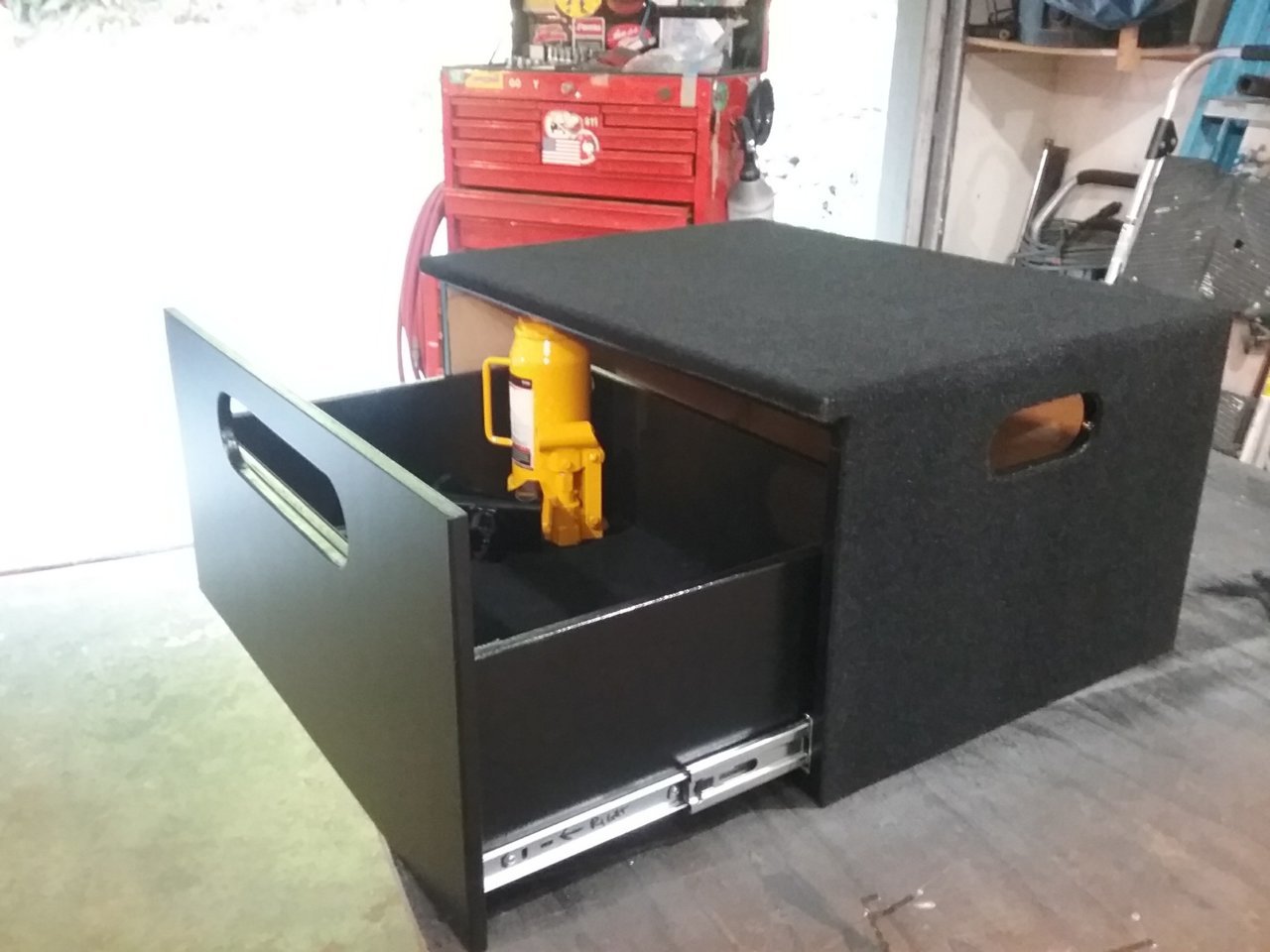

    I had some scrap materials. I created one drawer out of considerations. It's a great drawer, it may get used, but I'll post the next drawers. For my needs I feel it will be the end game.
    TW has been very rich in information on rear seat deletes. It really encompasses a lot. From sound deadener, to T nuts, cargo rails, Raptor of carpet.
    If you embark on this project - think the end game. Make it nice or do it twice.
    Two more drawers to post in the weeks ahead.
    PS. I love my FrontRunner boxes. But I HATE DIGGING FOR SHIT. I refined my needs to a minimum and built drawers to accomodate those needs.

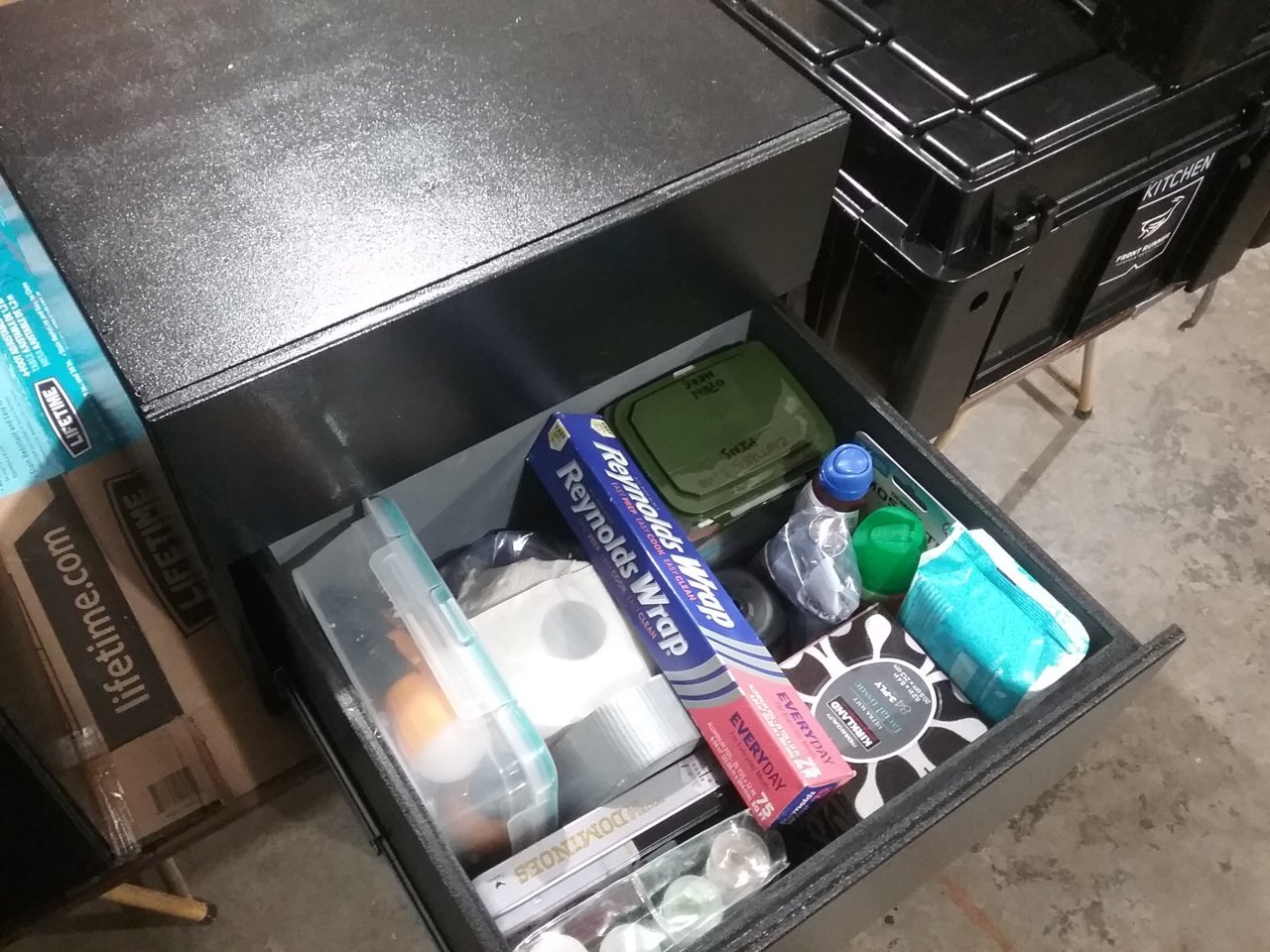

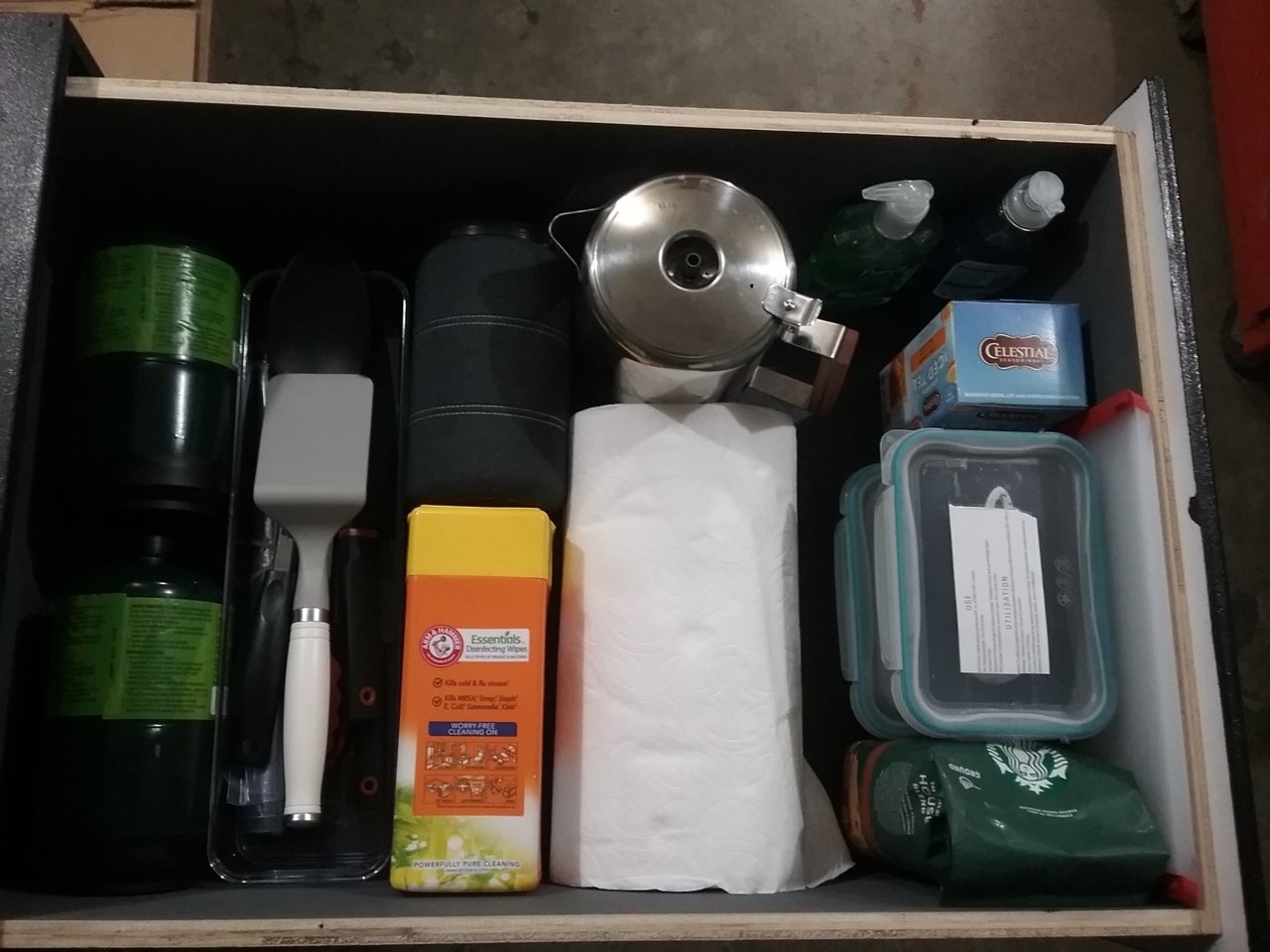

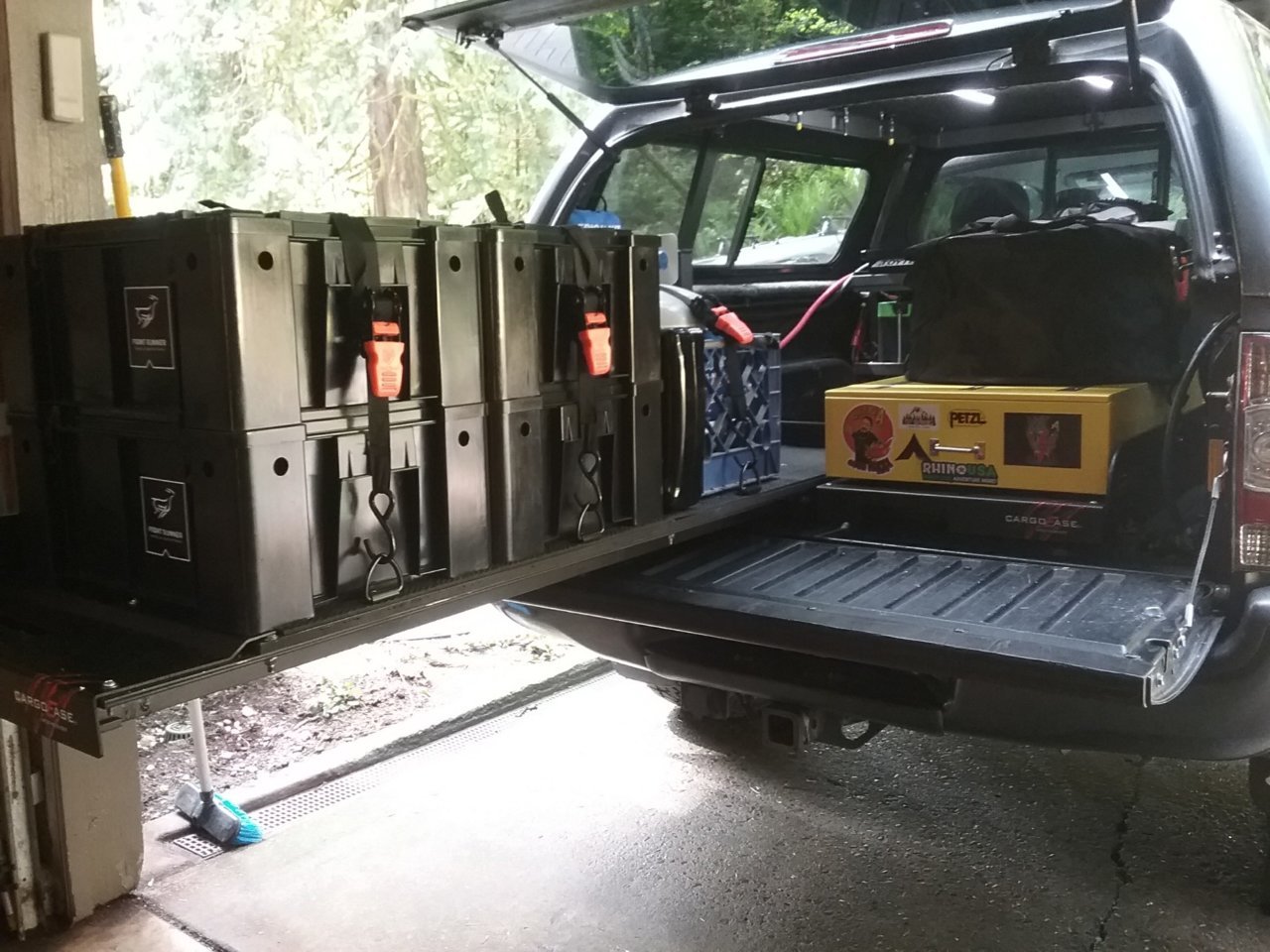

  15. Oct 16, 2022 at 3:50 AM
    #595
    G2G
    Oct 12, 2022
    #407830
    100
    Bellingham, WA
    2015 DCLB TRD Sport

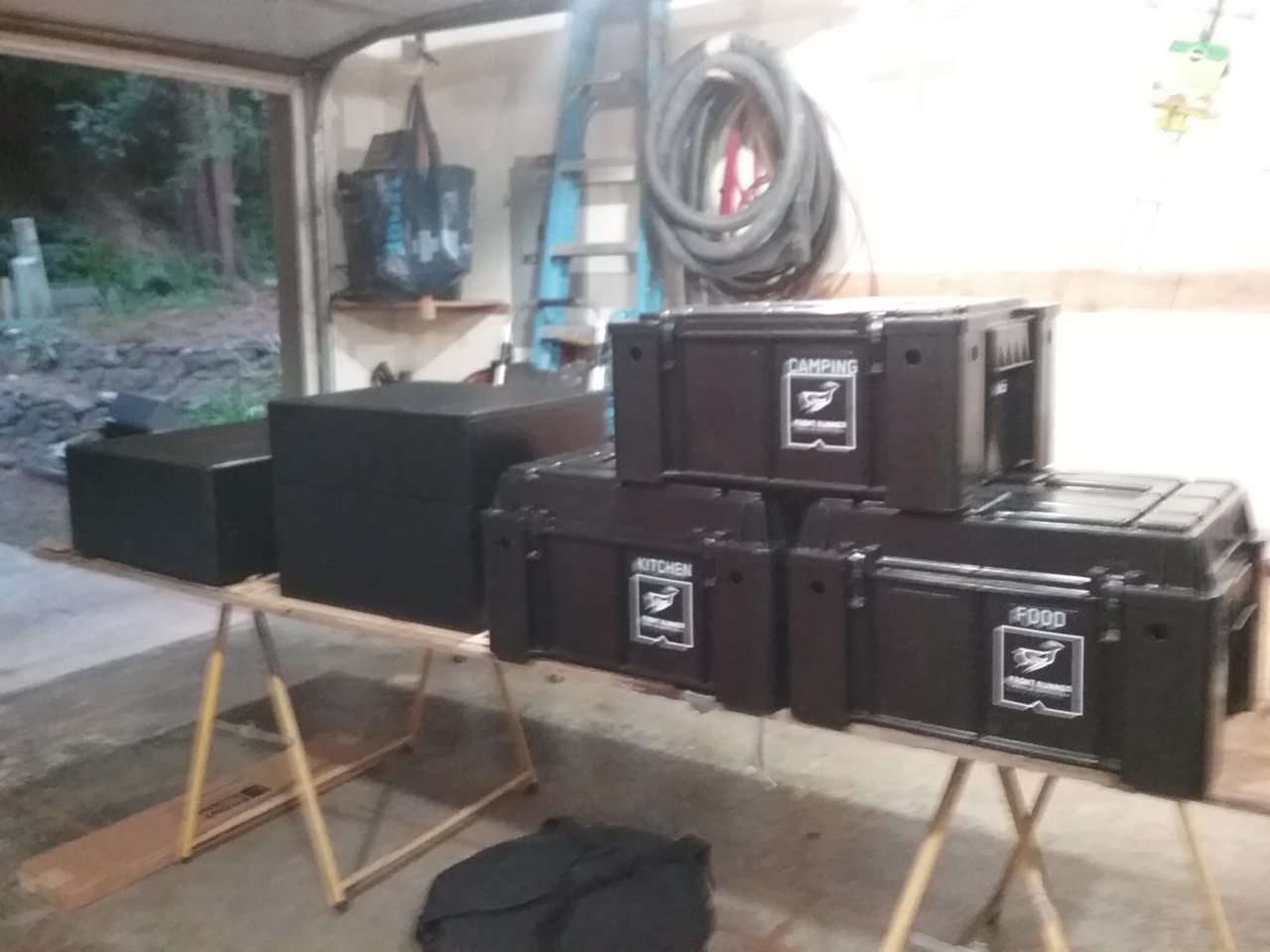

    If you think about it.... Assess you gear.
    I eliminated 3 FrontRunner boxes (which I love) and eliminating digging through boxes buy building drawers.
    In this pic the smaller drawers repla e 3 FrontRunner boxes.
    Sorry this morphed from the rear seat delete.
