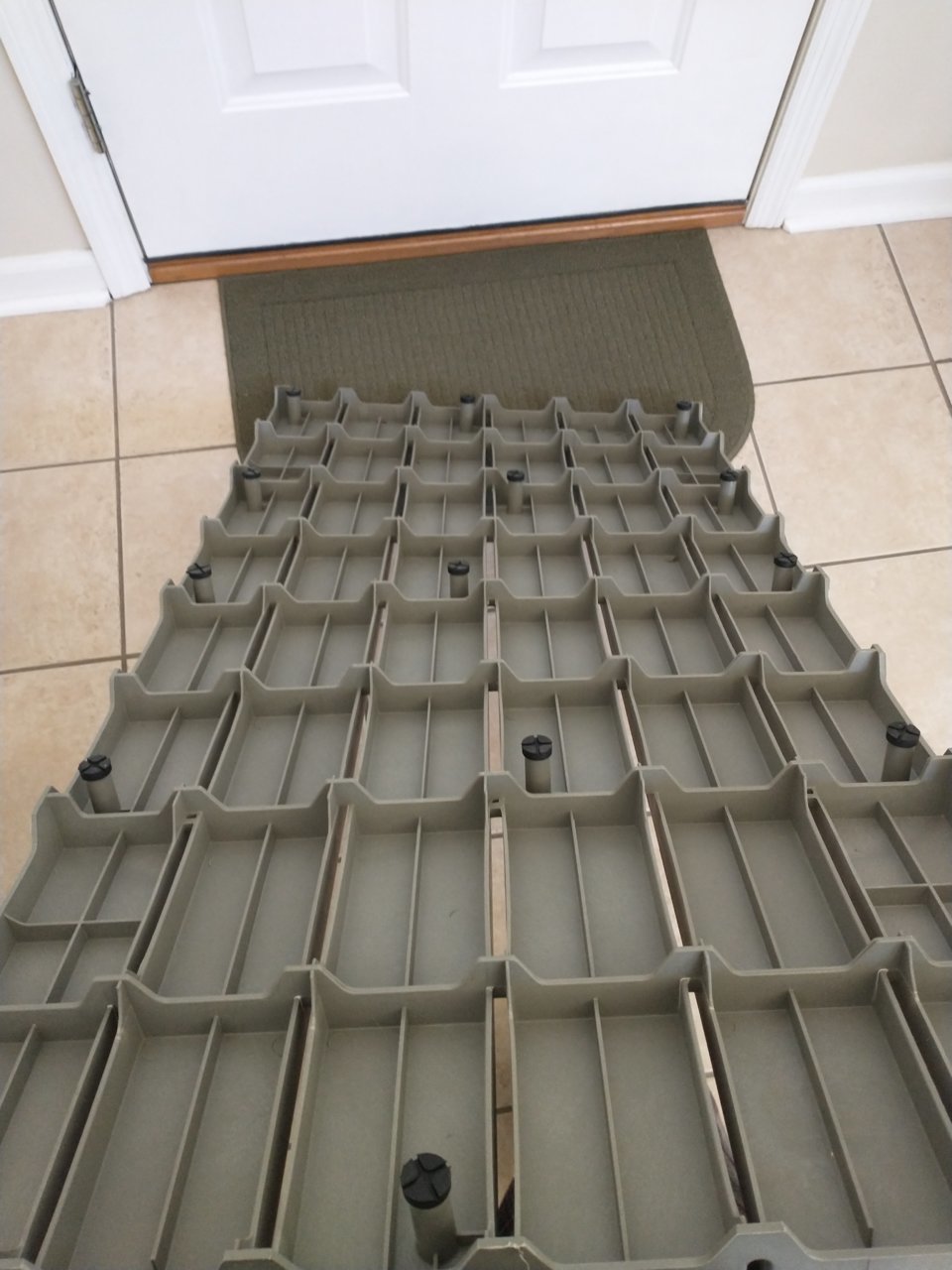

  13. Oct 21, 2022 at 5:26 PM
    #613
    Seth's Shadow
    Seth's Shadow Well-Known Member
    Dec 1, 2019
    #312222
    164
    2014 Spruce TRD Offroad

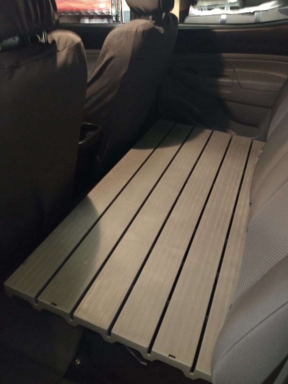

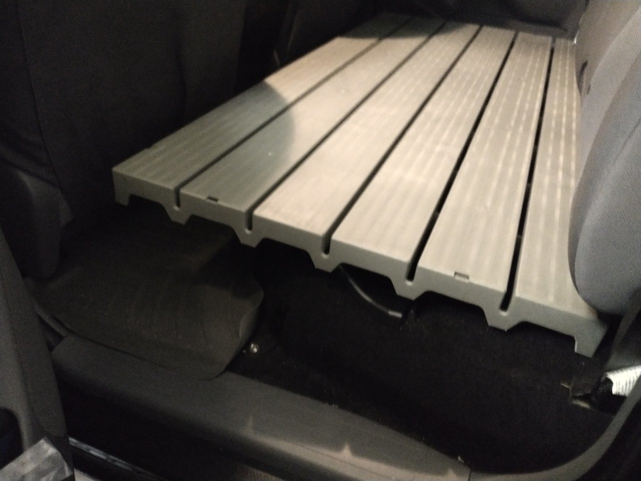

    I just removed the rear seat bottoms and bought this pet deck, which seems heavy duty and is 24"x48". It is a cheap alternative and matches my gray interior well enough (it is gray, but looks a little beige in the photo) I have ordered a rug the same size to go over it to keep things in place. I just needed it mostly to haul my kayak gear.

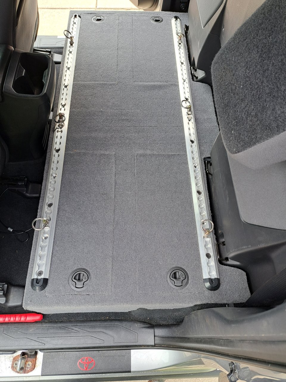

  14. Oct 21, 2022 at 7:52 PM
    #614
    OldSchlPunk
    OldSchlPunk I'm not sick, but I'm not well
    Feb 13, 2022
    #390091
    5,893
    Rich
    East Central Wisco
    '17 AC OffRoad Silver Sky Metallic
    Small lift, slightly oversized tires, well...

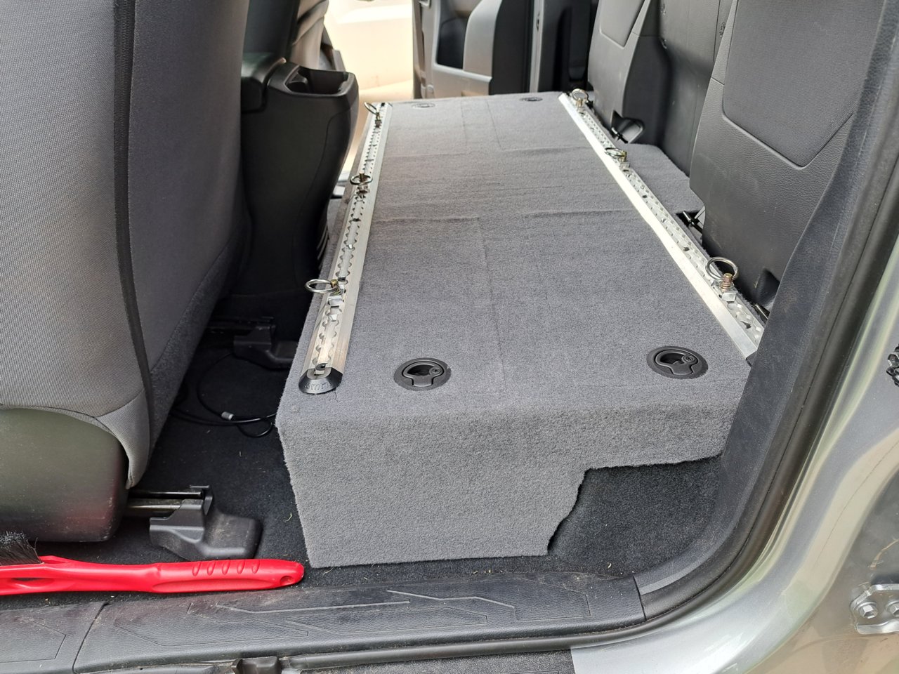

    Built one late this summer. Got under $300 in it. Metal frame with HDPE riveted to that and automotive carpet glued over the top. Access doors to get underneath w/lockable doors. Bolts to the stock seat location.
    Stock seats bolt back in in a matter of minutes if the need were to arise.
    Zerksees, NickAdams2112, HeyB and 8 others like this.
