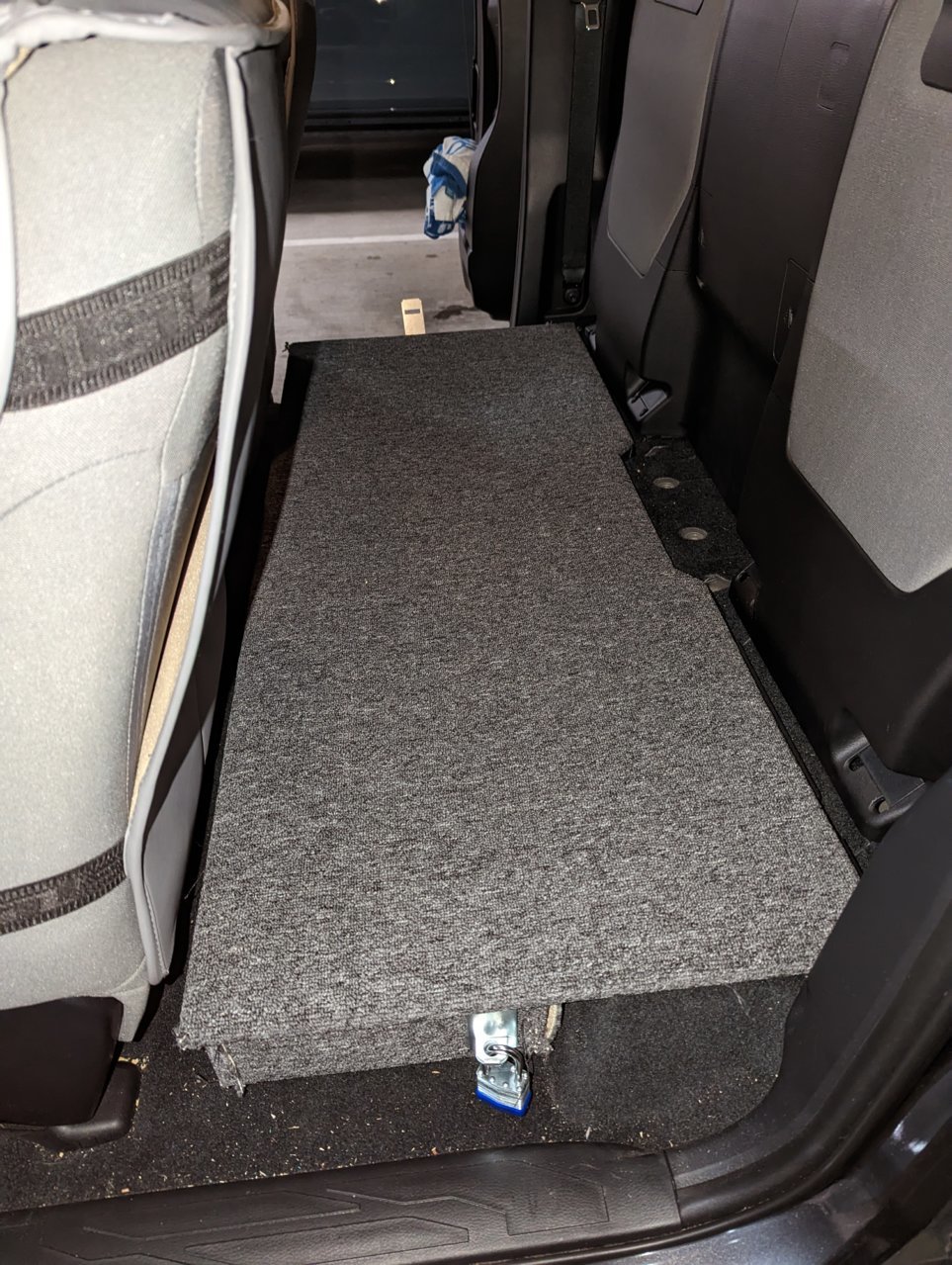

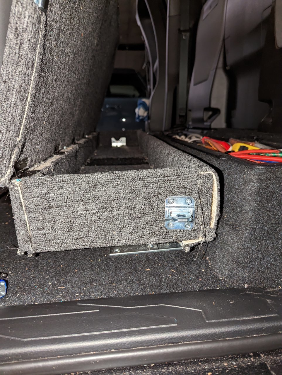

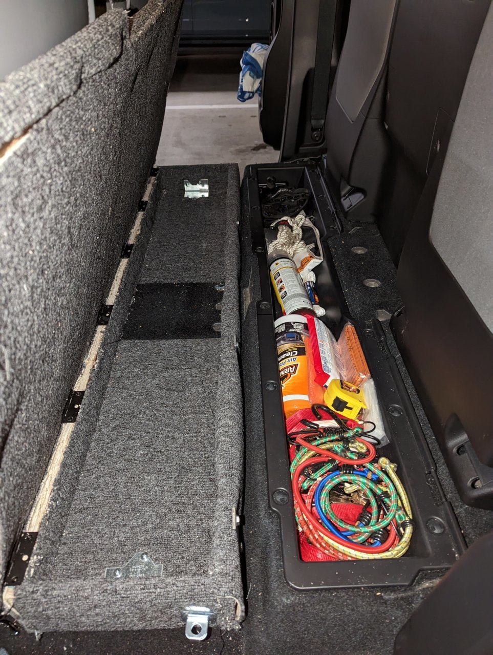

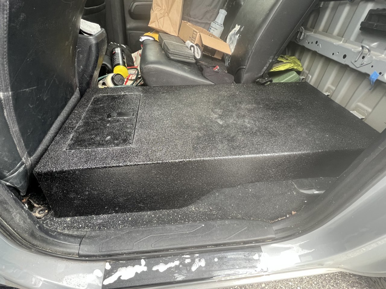

    I finally got around to building mine. I wanted a secure place to put long guns that is out of sight. I live in an urban area, so I go out to the forest for target shooting. There are a bunch of great hiking spots along the way. Unfortunately, it is not uncommon for smash and grabs to occur at trailheads since thieves know you'll be gone for a while, and there aren't really people in the parking area for most of the day. I can fit a couple of long guns in there and lock them up.
    I used six inch L brackets as the legs to elevate the storage compartment to the height of the drive shaft hump in the middle to provide a flat surface which is the perfect height for a level lid going over the top of the storage compartments that Toyota built into the SR.
    The seats still have enough space to move all the way back and fully recline.
    I'm happy with it. I just wish I could have found an exact match for the carpet. Oh, well. Close enough.

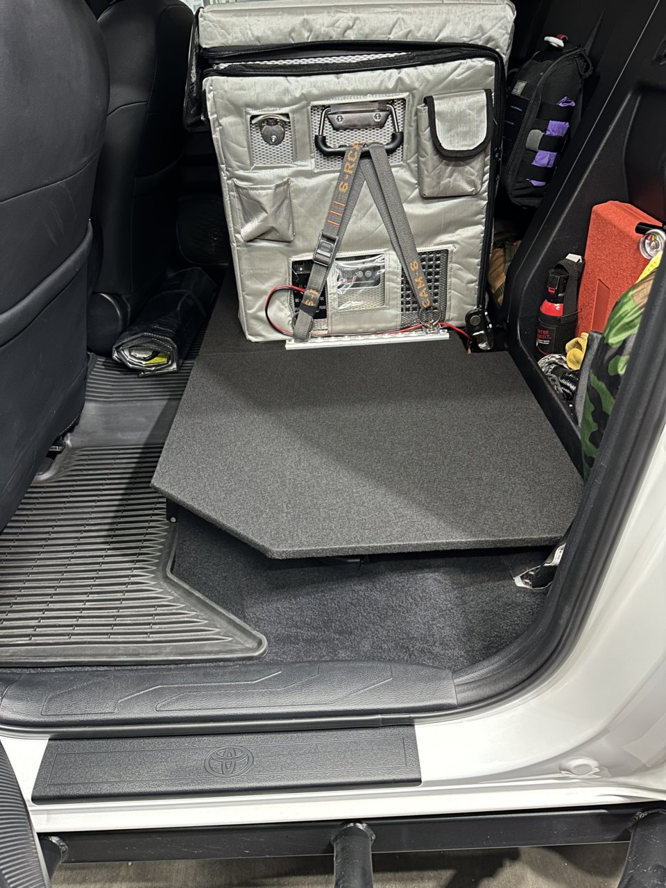

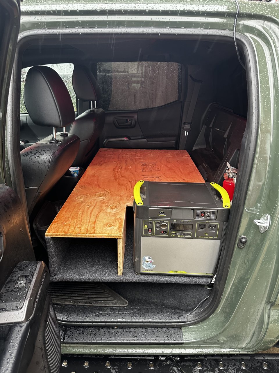

    In the works few modifications and the carpet left…. D716E02A-28DF-4C7F-A4A6-D92DBBD46AE1.jpg

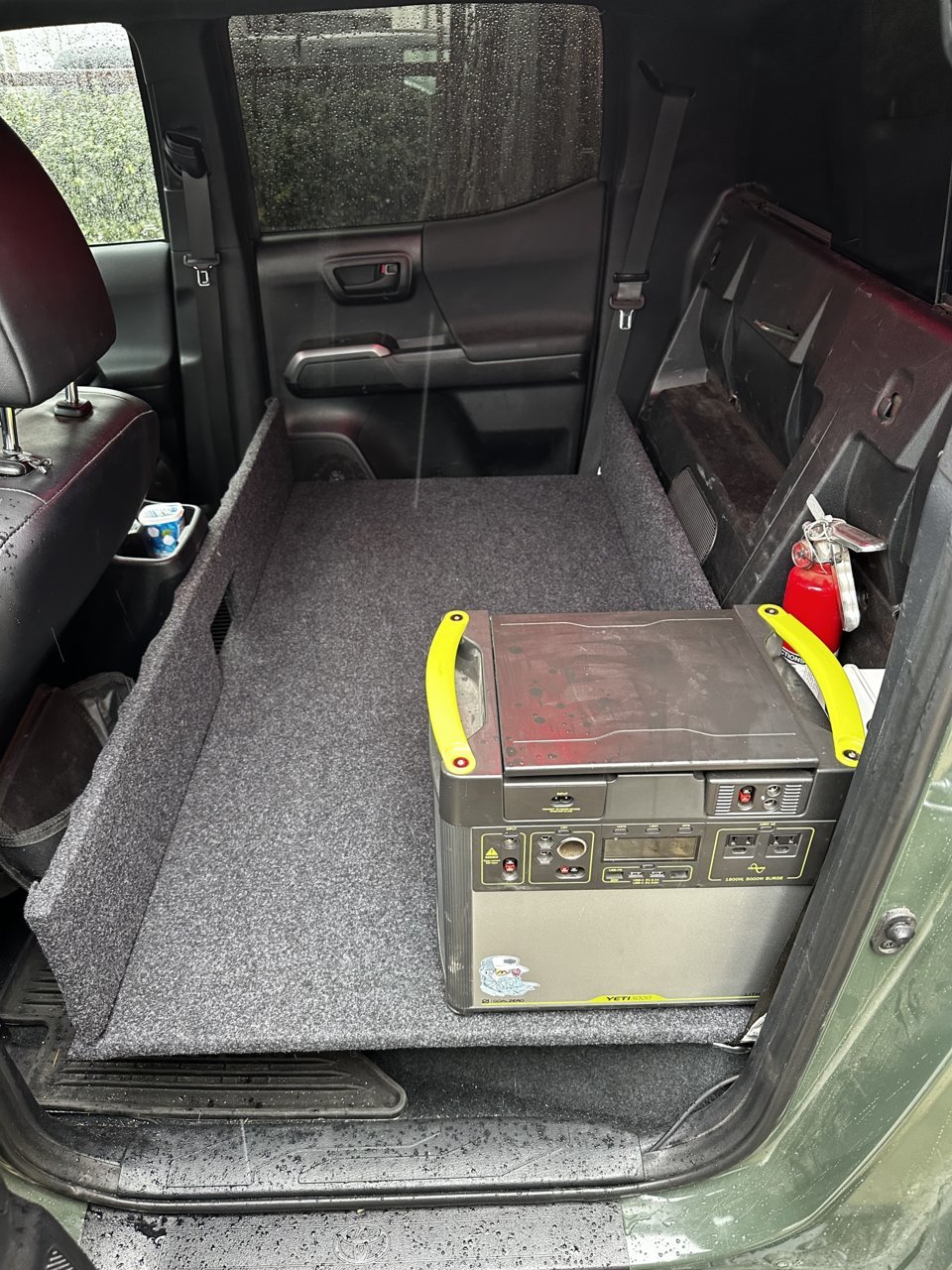

    Finally got around to doing the 40% side...

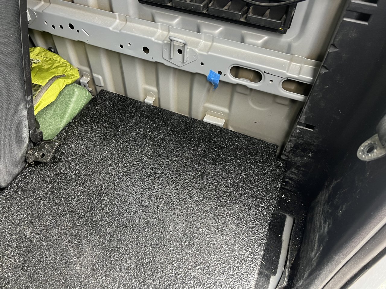

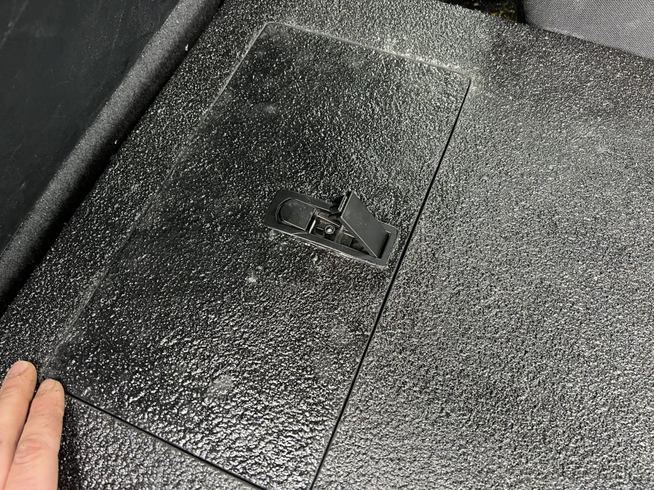

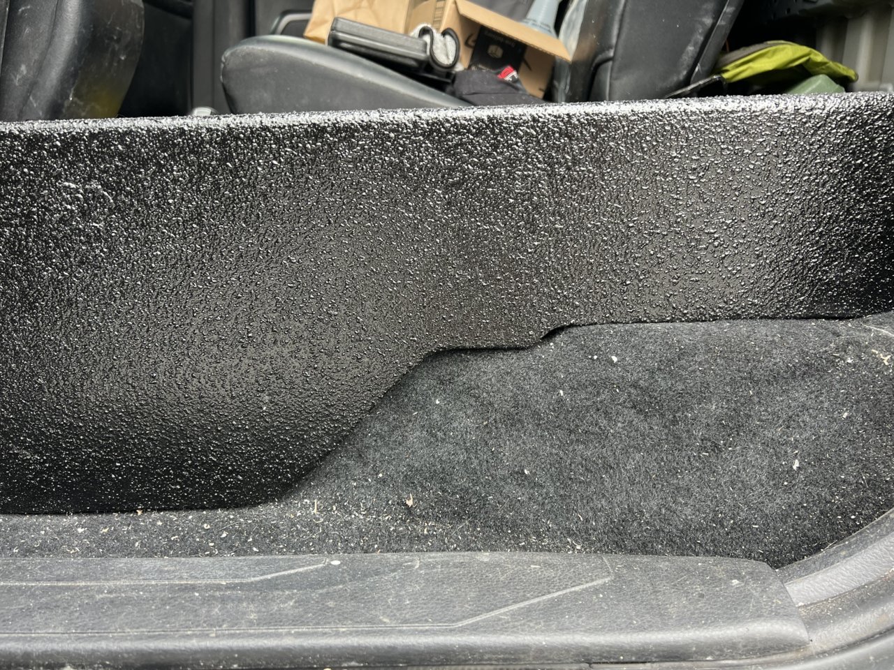

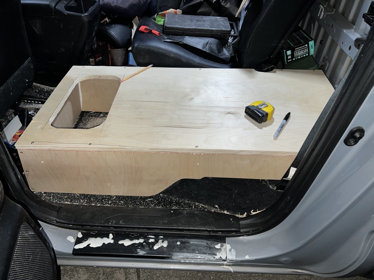

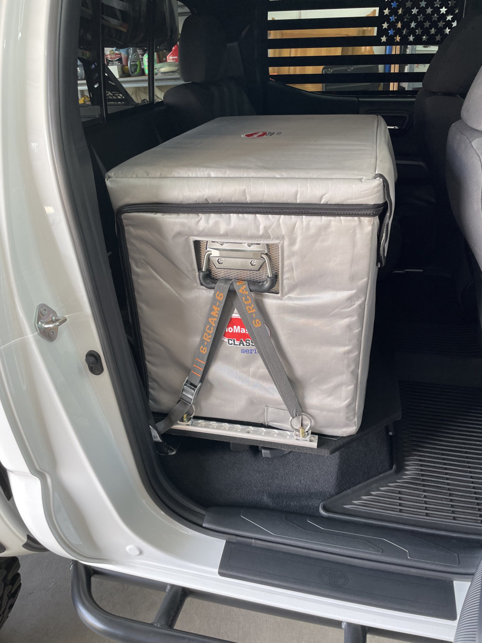

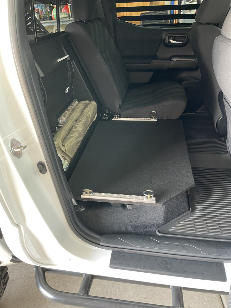

    Here’s my humble contribution. I have a 4 year old so deleting the whole thing wasn’t an option, and I like him sitting behind the passenger seat so I can hand him stuff and see him better.
    anyways, the project cost me $130-ish all in. I went to Home Depot to buy a sheet of half inch ply, and they had a 3/4” sheet of Baltic birch with a smashed corner.. instant 75% off. I used herculiner from autozone, and the latch from Amazon. The rest I did with a combo of table saw, router table, palm router, counter sink bits, and titebond 3. I only took one picture of the progress (it was FREEZING here this past week)
    Any questions feel free to ask.
    ::ETA:: the finish on the bed liner looks a lot better in person, I need to blow it off with some compressed air, the variation in color is sawdust.
  12. Mar 16, 2023 at 8:12 AM
    #672
    BlarBlarjosh
    BlarBlarjosh Well-Known Member
    Jun 28, 2019
    #297745
    320
    Josh
    Southern California
    I cant tell if the sawdust is because you do a lot of wood working or you routed some of that in place. Either way, looks good man.

    I didn't install latches originally, as I'm waiting for my climate change (moving across the country) to make sure I don't have humidity swelling issues. That said, I like how those look, do you have the name or the link so I can find them on Amazon?

    these are the ones, pretty nice for the price.
    WJSKDQ 2PCS Compression Latch Lock Powder Coated Zinc Alloy Adjustable Lever Hand Operated Flush Lever Marine Applicable Door Thickness: 0.04"-0.94" Grip Range https://www.amazon.com/dp/B07QV7PP9P

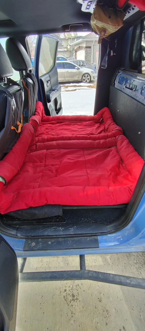

  16. Mar 25, 2023 at 4:15 PM
    #676
    Jonnyfive5
    Jonnyfive5 Active Member
    Mar 27, 2020
    #323121
    37
    2019 Tacoma 4x4 Trd sport
    Quick and easy! Everything for the dogs.
