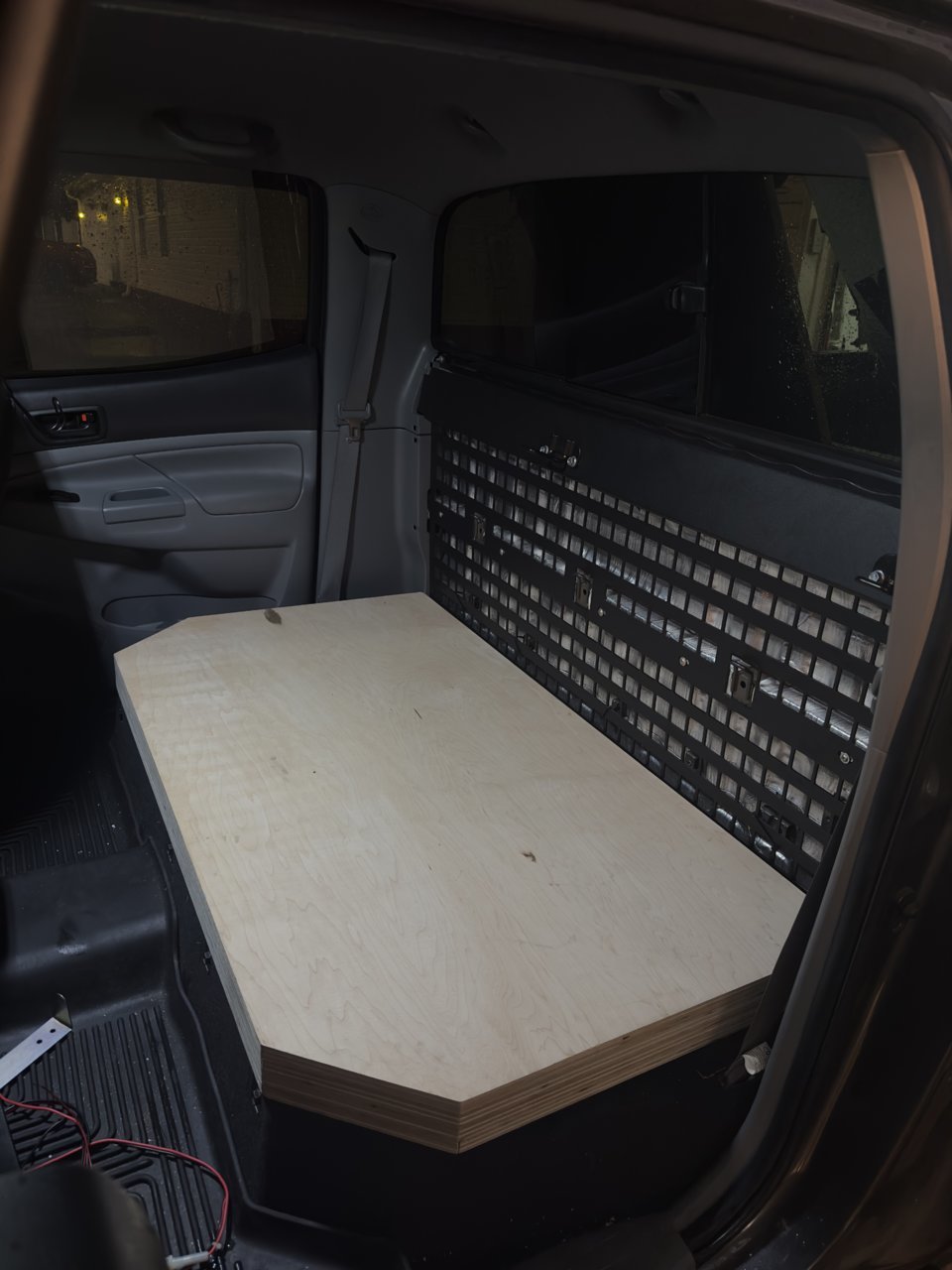

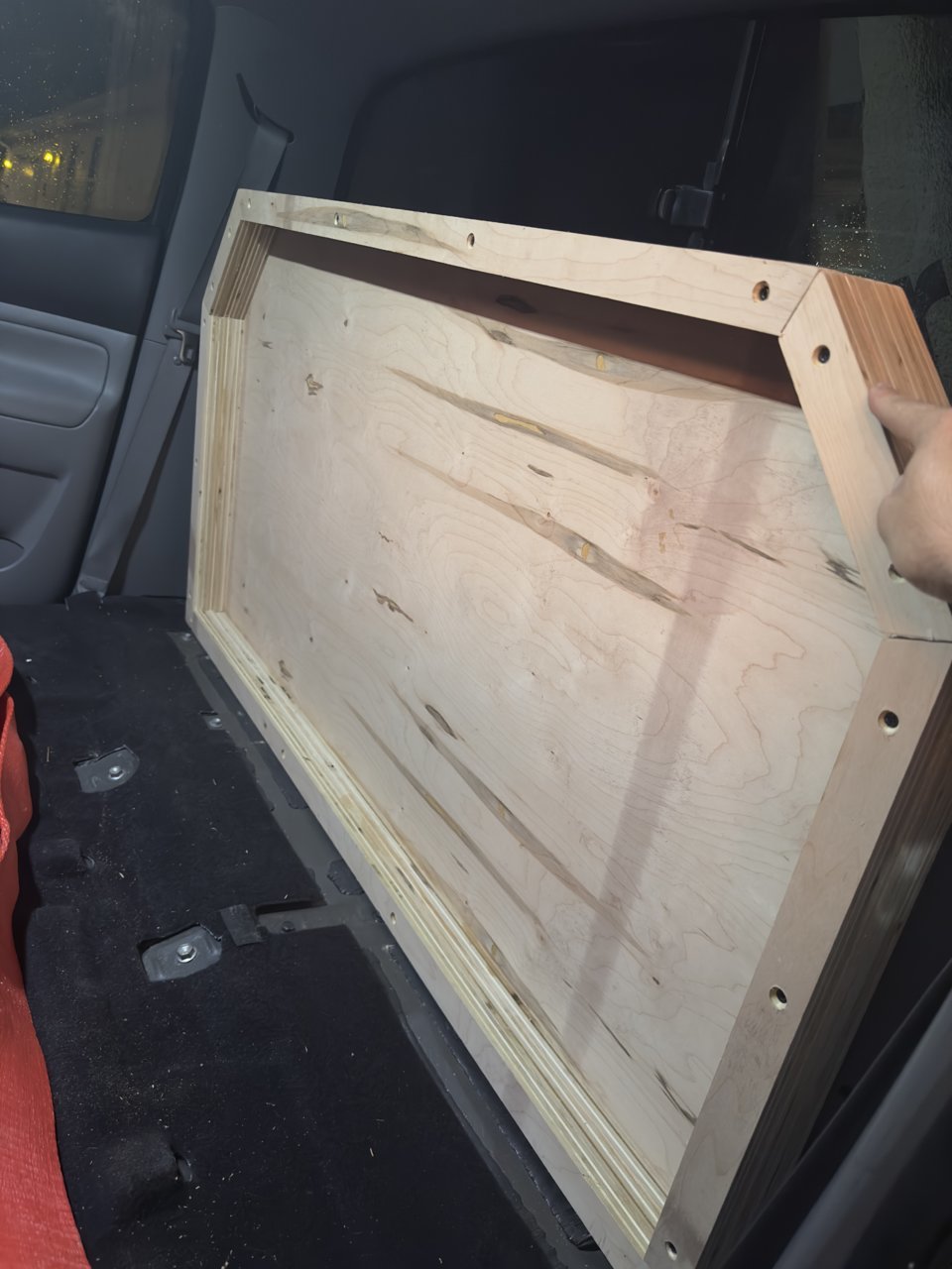

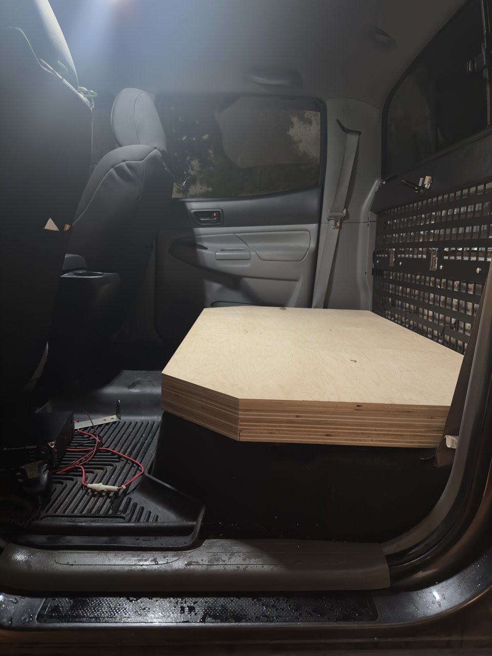

    Stock as all get out.
    Small progress on my rear seat delete
    3/4 inch maple plywood
    cut 1 1/2 inch x 3/4 inch (x3 stacked) furring strips to raise the height, gonna do some further testing to see if I’ll need to add some down the middle for strength in the mid section. Trying to avoid it so I can as much storage space as possible underneath. Next will be to cut out x2 cubby holes with latches.
  15. Jul 26, 2023 at 9:43 PM

    anyone have any6 tips on how to cut clean access holes?

    Plunge cut with the circular saw was my method. Make sure it's lined up correctly or it may not come out square, like mine failed to do. Router might be another way, but use a guide of some sort.

    whats a recommended gap to account for carpet?
