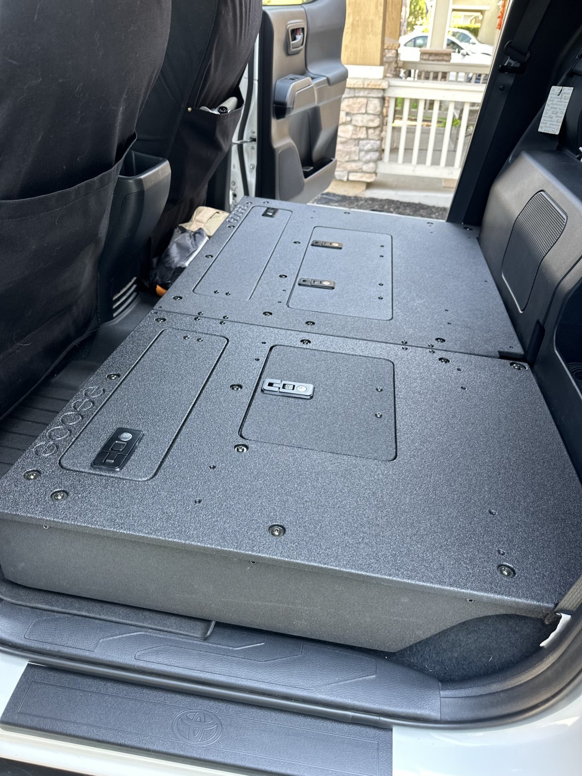

  1. Oct 20, 2023 at 6:12 AM
    #761
    71tattooguy
    71tattooguy Well-Known Member
    Dec 19, 2018
    #276275
    5,883
    Dino
    Petaluma , Ca (707)
    2019 DCLB TRD OFF- ROAD

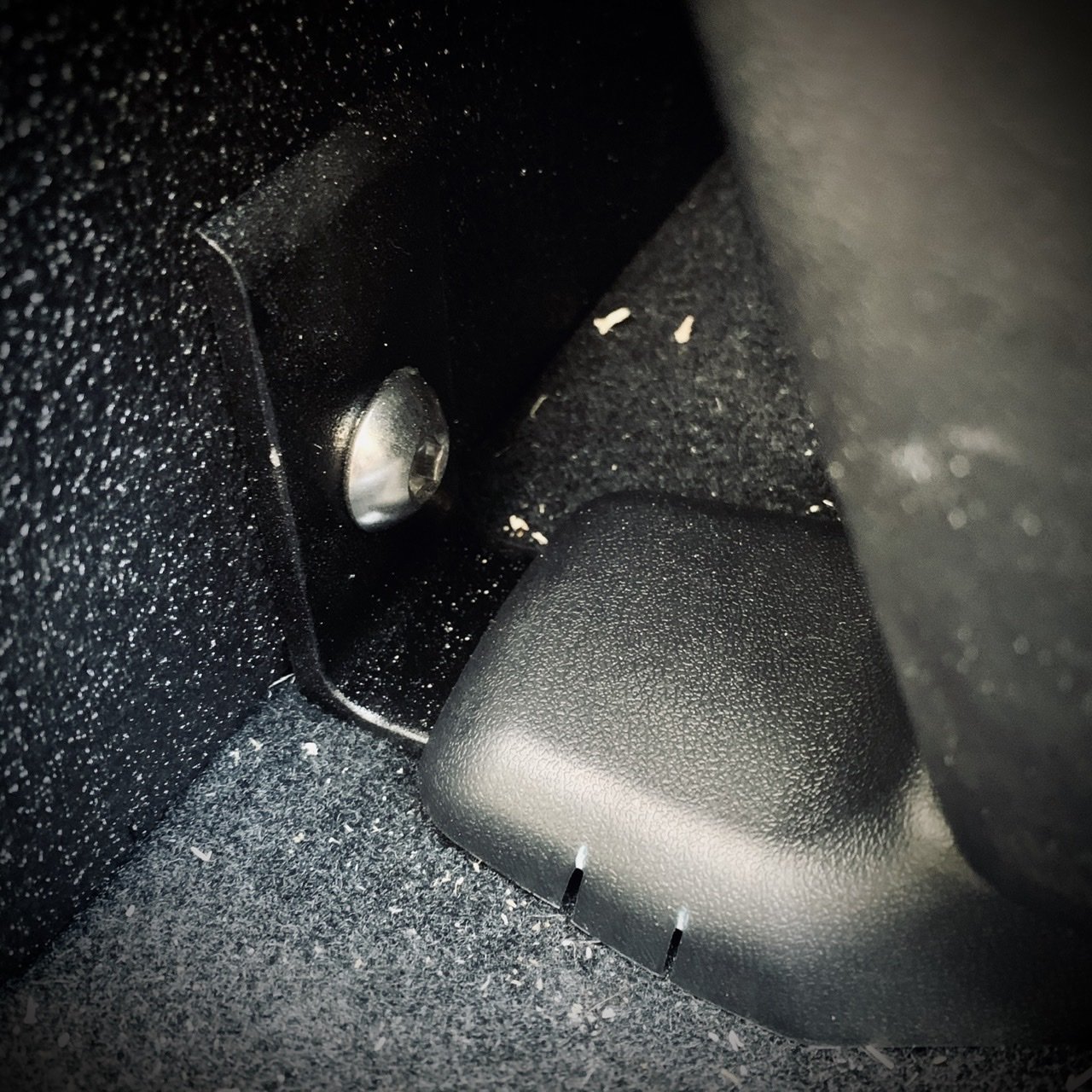

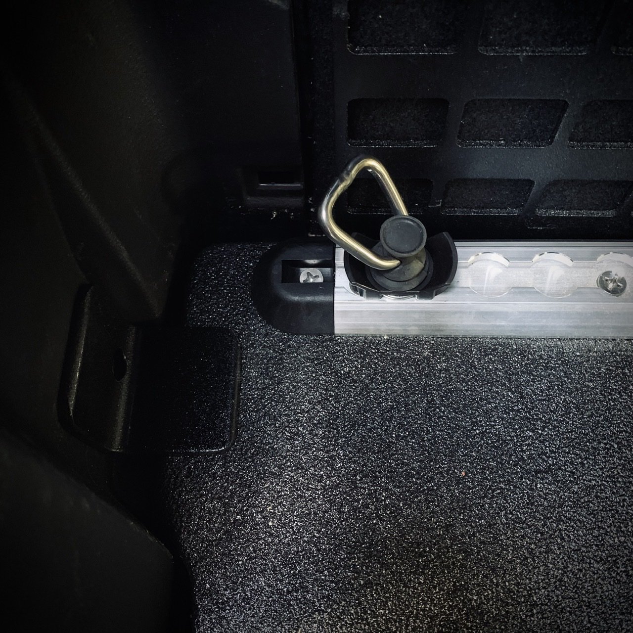

    Kings 2.5” front and rears from Accutune / ICON RXT LEAF PACK black badges doors and tailgate / method 315 / 255/85/16 Yokohama G003 / magnaflow exhaust , axle dump / meso int delete kit / meso led map lights / dome lights / wheelers front super bumps / accutune Flip kit with spacer and new bumps / Cali raised fog light pods / Cali raised ditch lights / RCI FULL SKIDS / SLIDERS / RCI rear bumper / rigid backup lights / tuned on 4.88’s

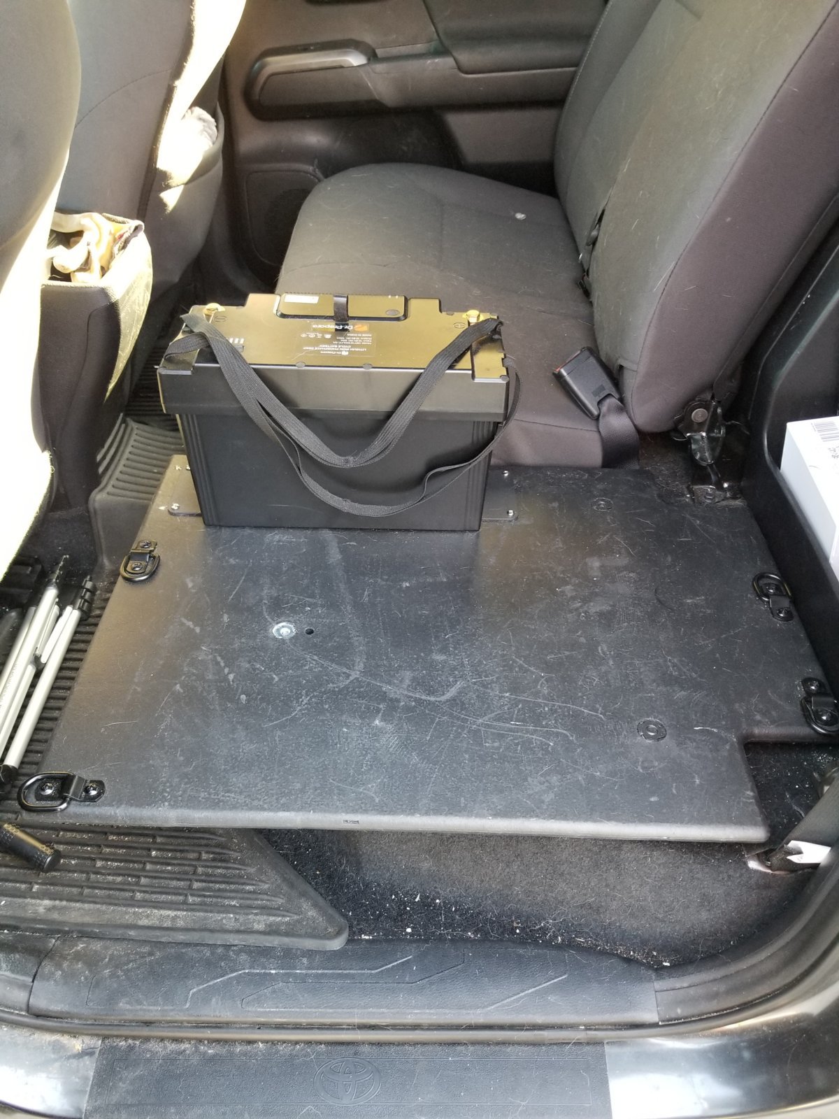

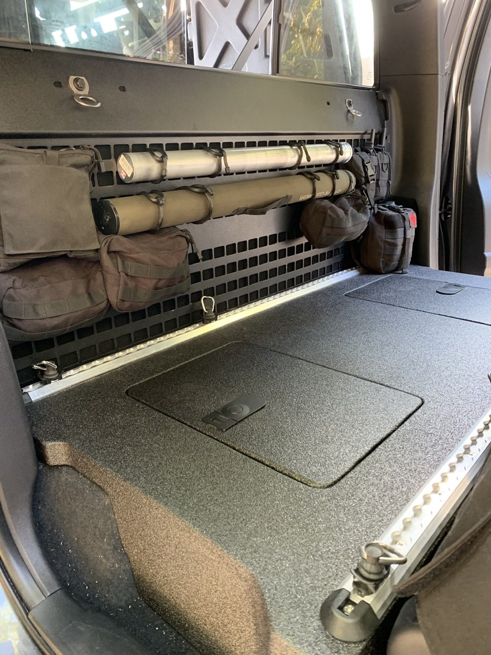

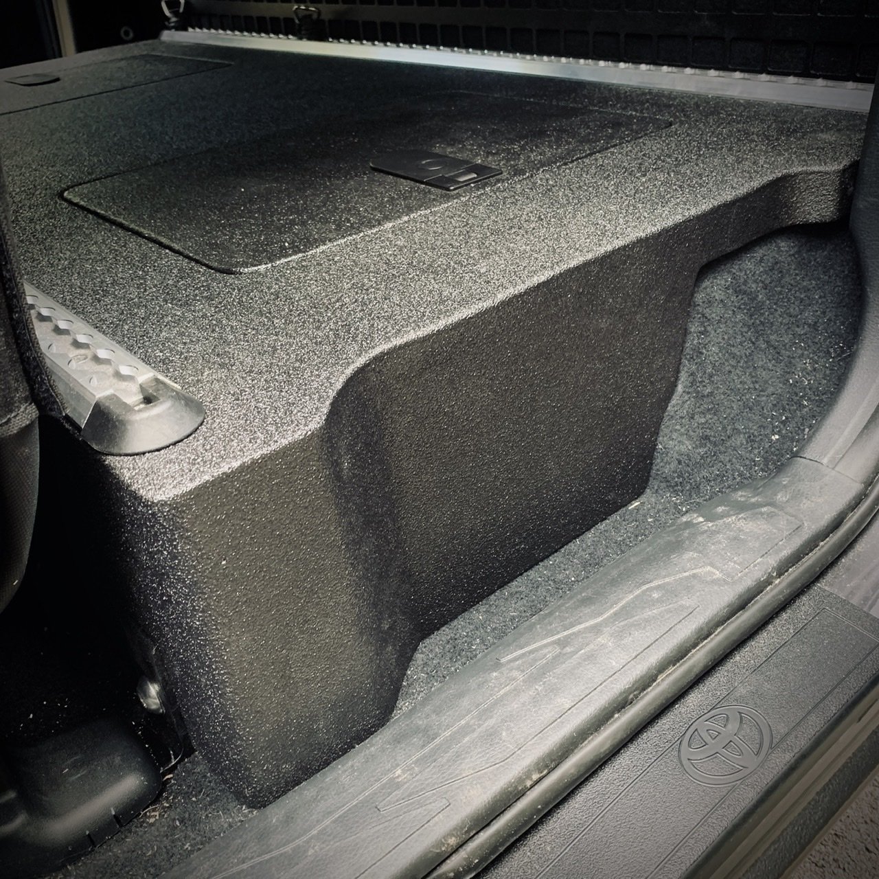

    Goosegear great craftsmanship worth it IMO. Easy install. Rear seats stored In garage

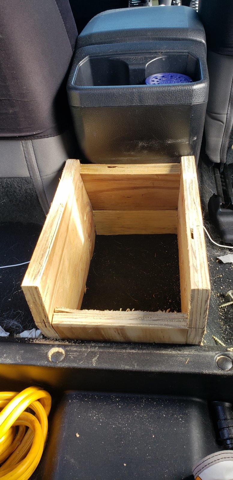

  4. Oct 23, 2023 at 4:31 AM
    #764
    infantry317
    infantry317 Well-Known Member
    Aug 15, 2019
    #302280
    149
    Minnesota
    2019 Tacoma TRD OR
    None yet

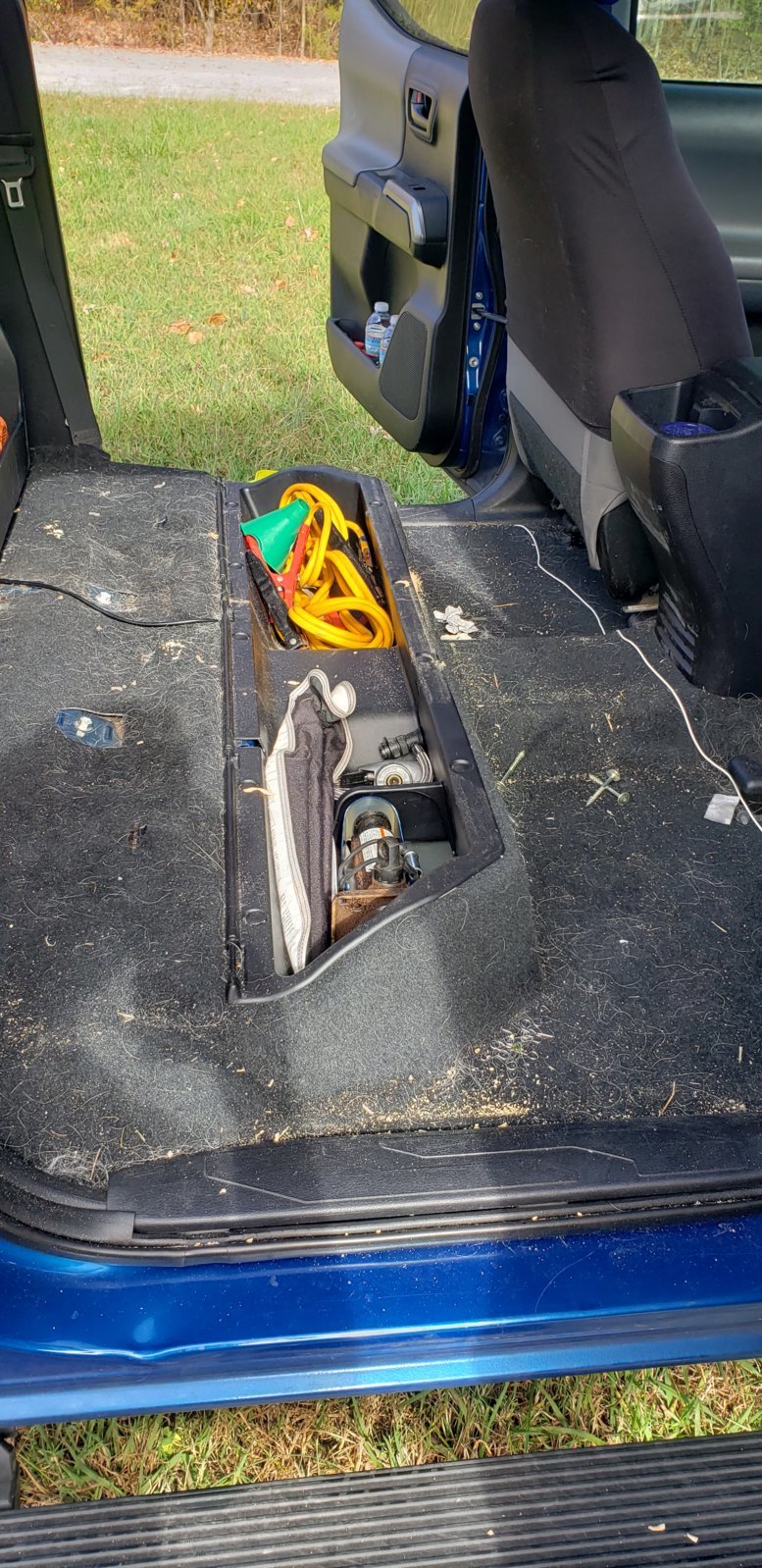

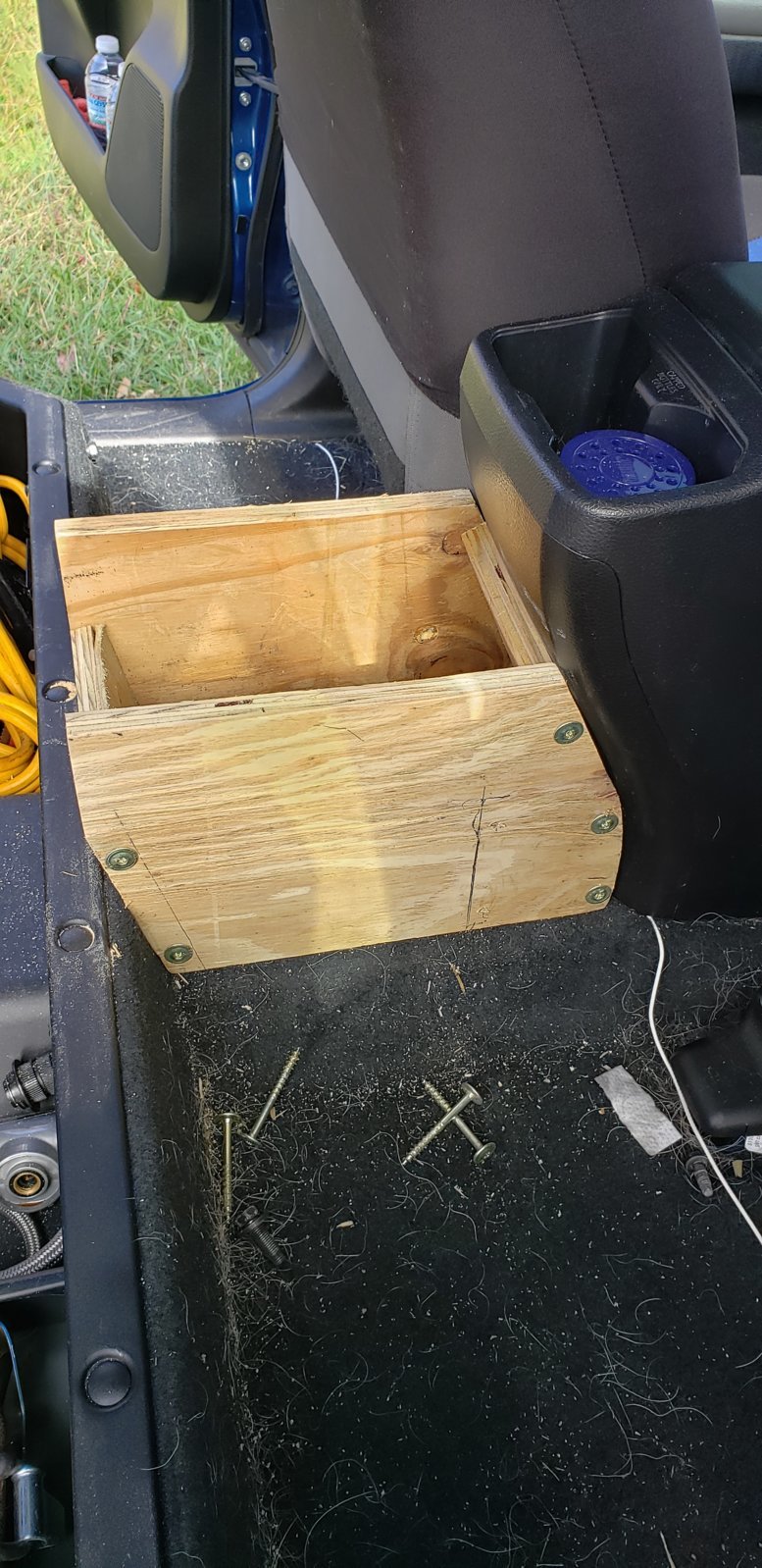

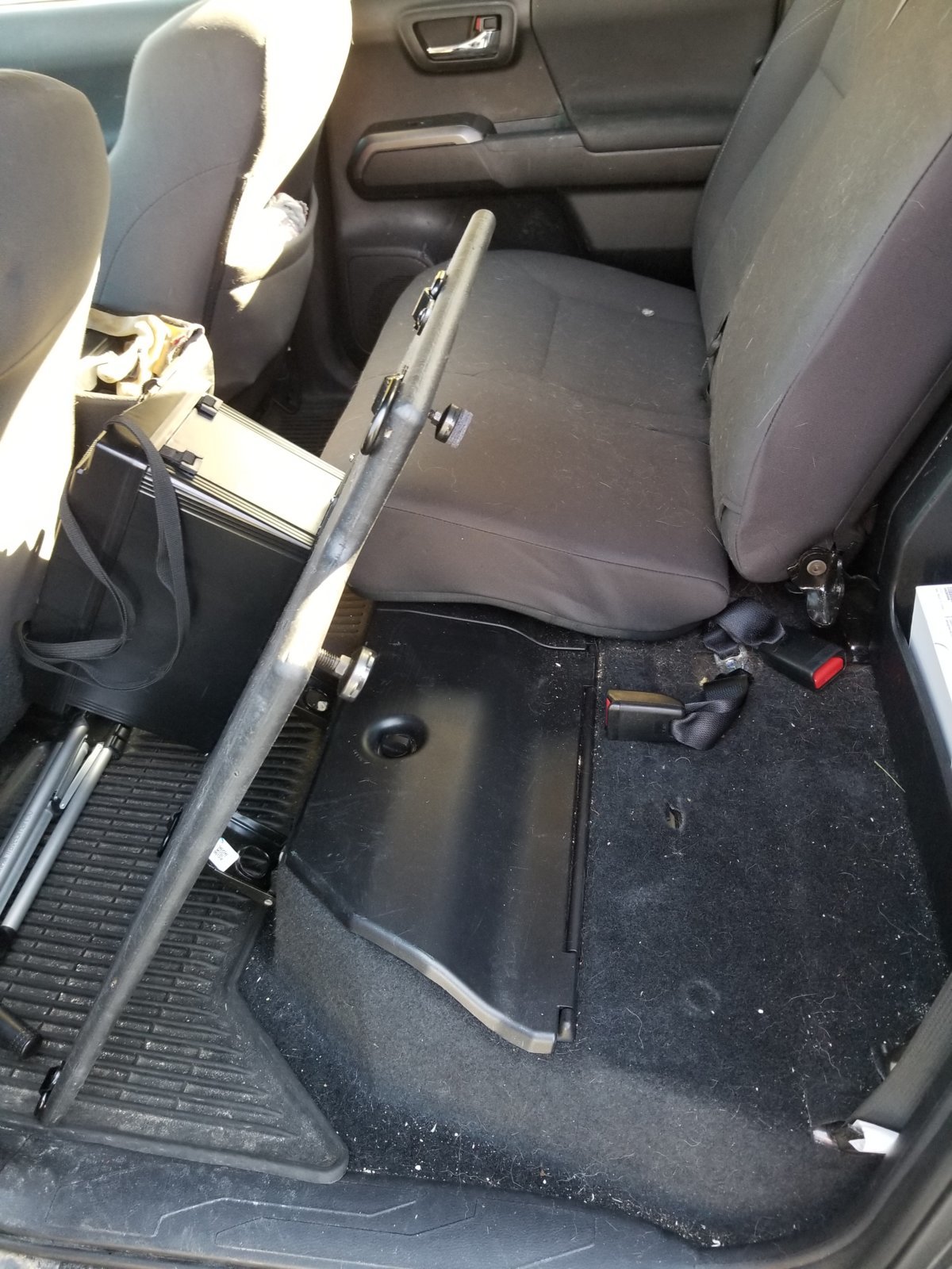

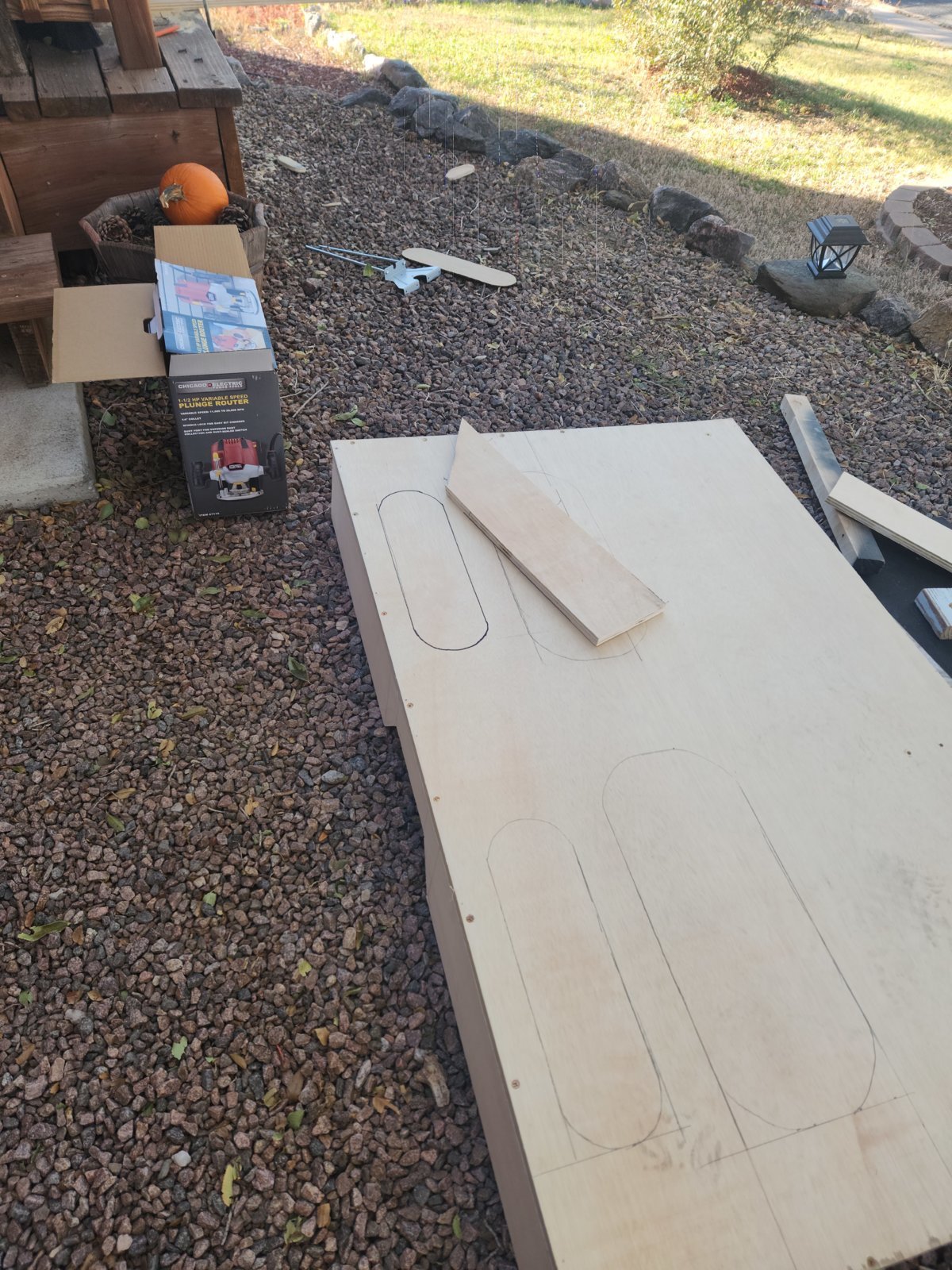

    Here is my driver's side delete for a Dr. Prepare and Setpower AJ40 fridge. I'm pretty happy with it for a first attempt. 20231022_151120.jpg 20231022_151137.jpg

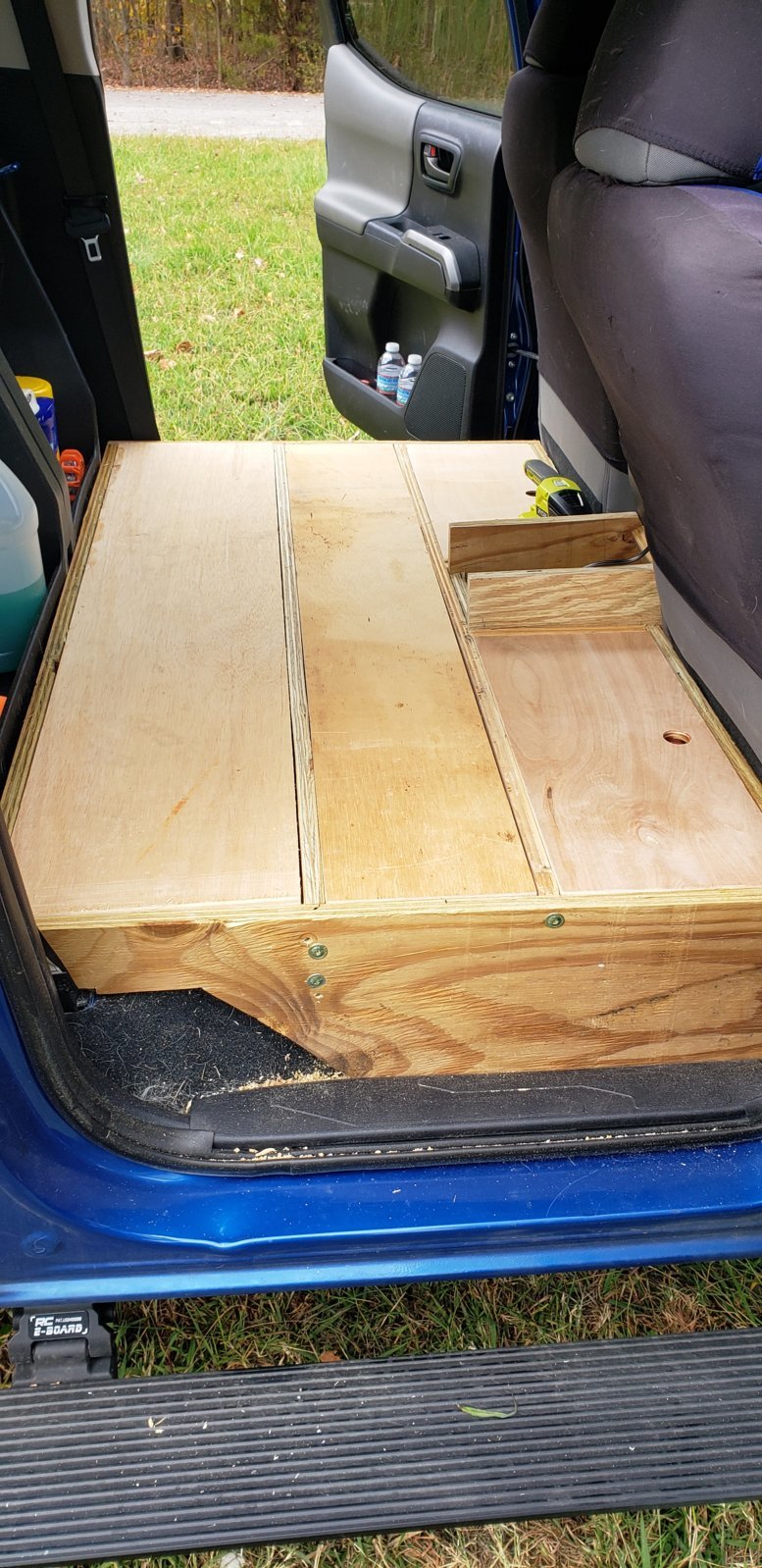

  5. Oct 28, 2023 at 2:12 PM
    #765
    Seabth
    Seabth Member
    Oct 19, 2023
    #435833
    7
    Bart
    2016 toyota tacoma sr5

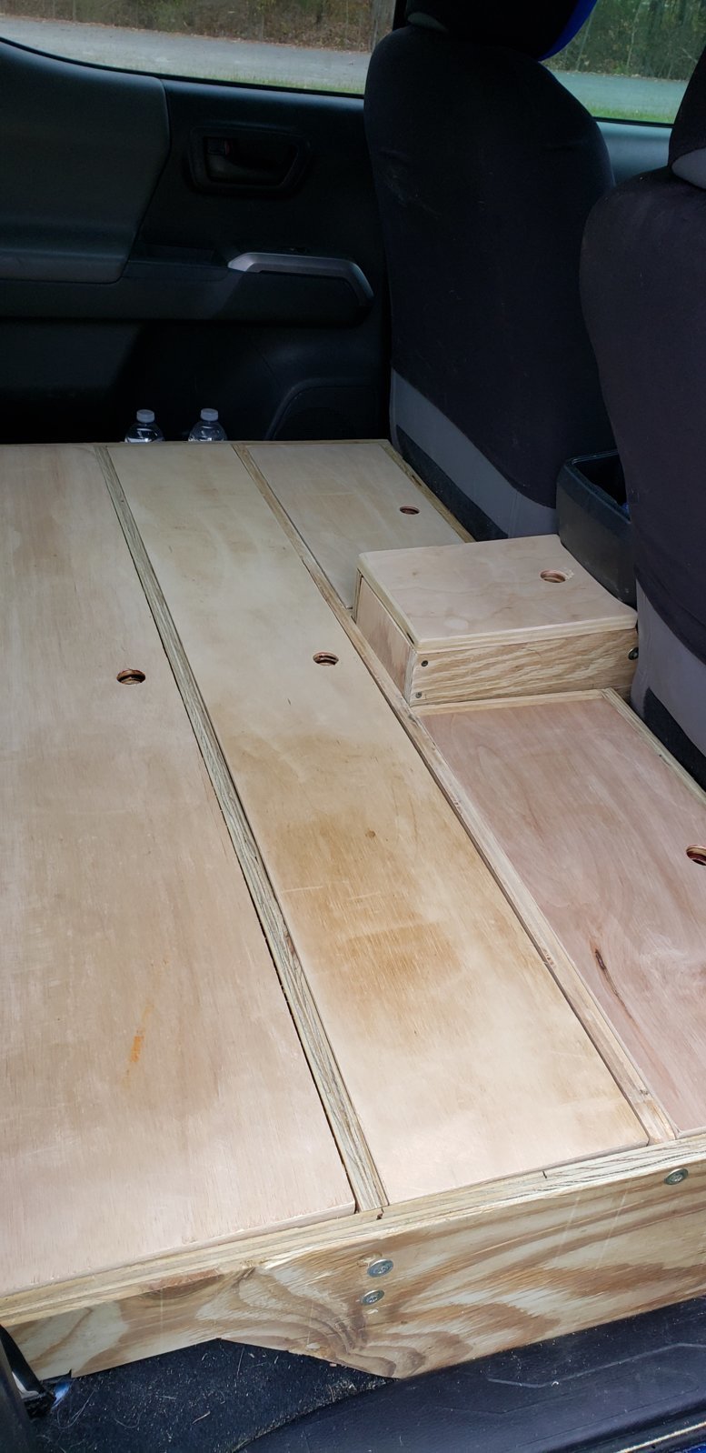

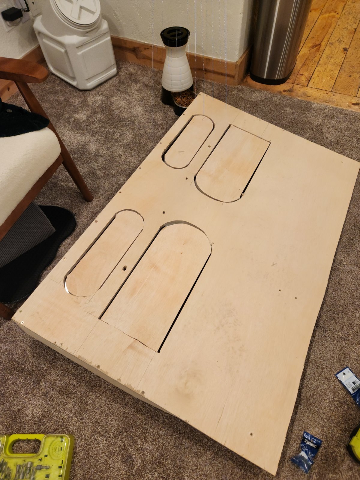

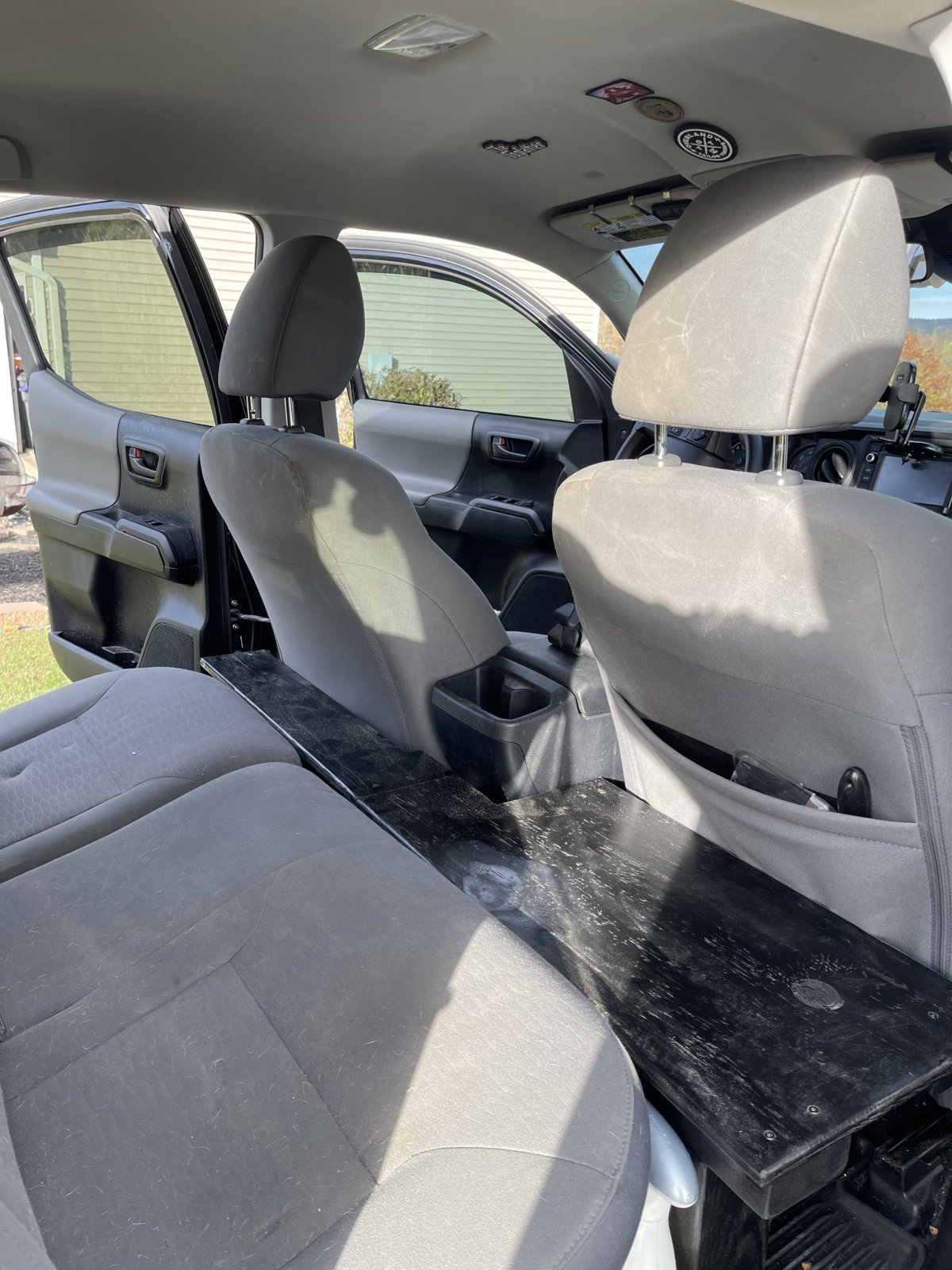

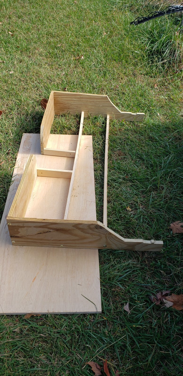

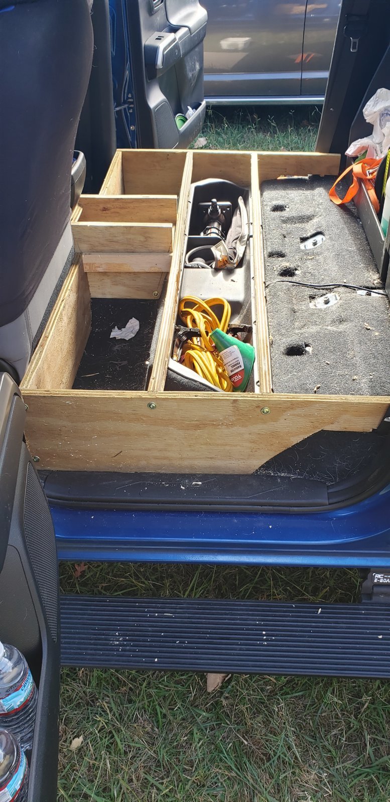

    Well here is my version of a rear seat delete. All made from scrap i had left over from other projects. Still have a few things to do on it, but it getting there.

  7. Oct 29, 2023 at 9:41 AM
    #767
    Seabth
    Seabth Member
    Oct 19, 2023
    #435833
    7
    Bart

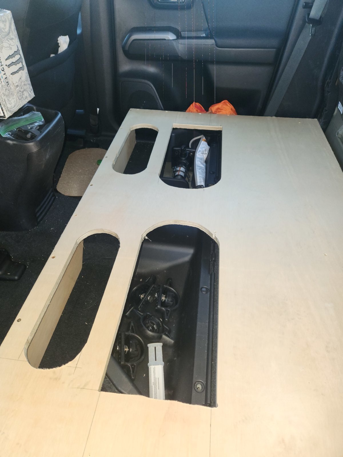

    All done except for the coating, think I will use herculiner

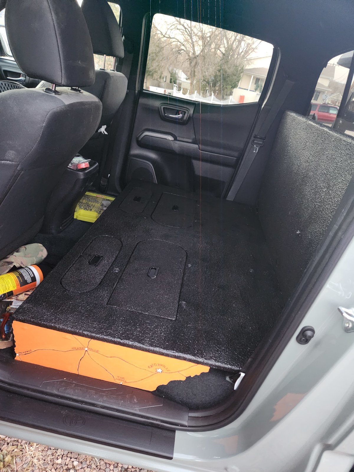

  13. Nov 20, 2023 at 4:50 AM
    #773
    ETXTacoma
    ETXTacoma Someone gave me a plasma cutter.
    Feb 12, 2016
    #177942
    16,307
    Steven
    Tyler, Texas
    2014 DCSB Tacoma TRD OR

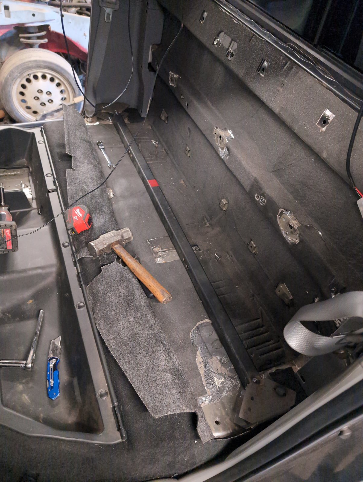

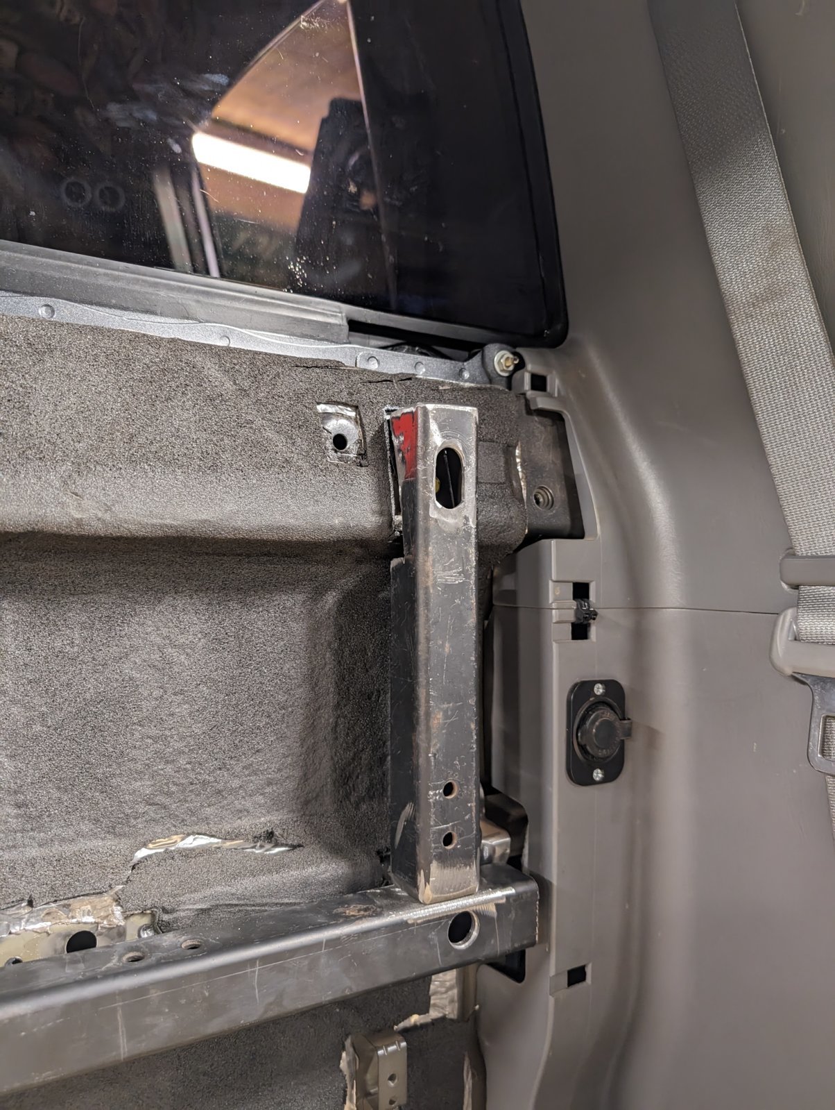

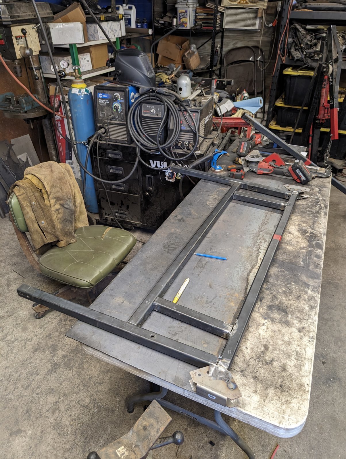

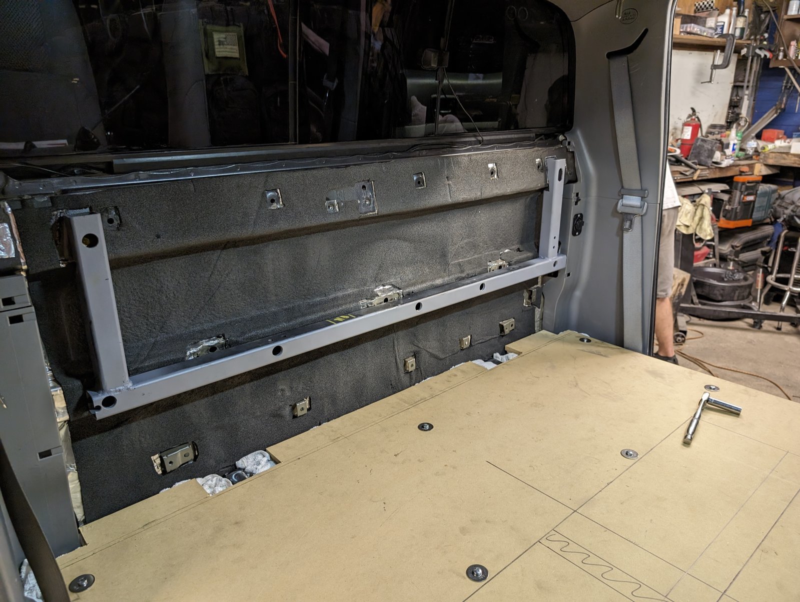

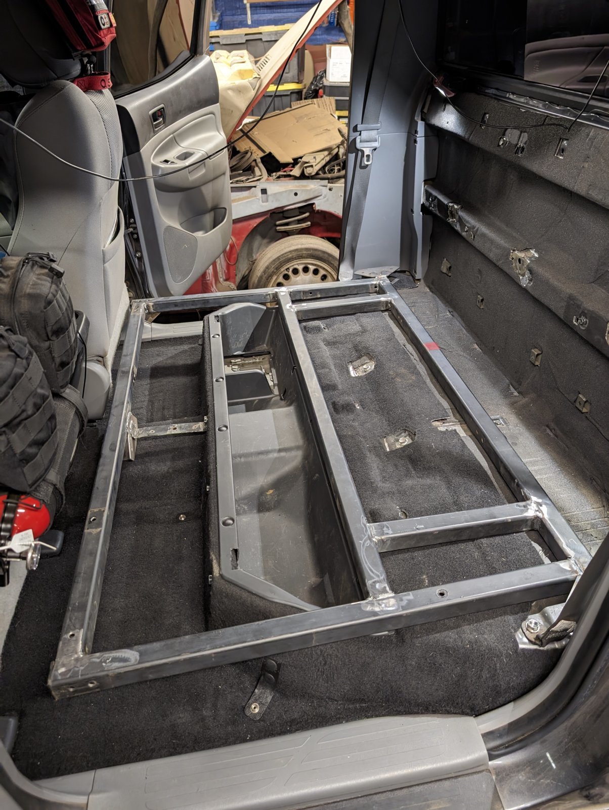

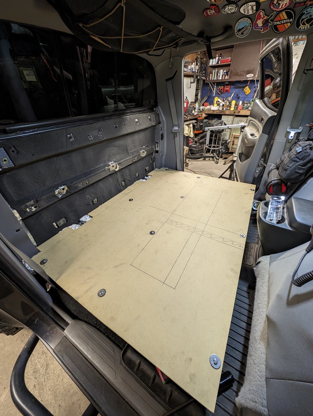

    Here is my rear seat delete project I have been wanting to do for a while.
    I wanted something that was secured to the truck in a way that I knew that it would be hard for it to come undone in an accident or side collision.
    I also wanted something that floated in a way instead of needing walls to help support it so that I could easily access the sides of the floors instead of needing larger access doors on top.
    Finally I wanted something that when I add in the tie downs for a cooler or storage boxes that they would be secured to the frame for added rigidity and strength.
    It is still a work in progress, but should have the floor built out today besides the cosmetic stuff like the carpet and future addons like the tie down points, under seat storage access, some lighting, and more.
    Insulation will be added in the open areas between the deck/wall and the truck floor/wall for sound absortion as well.
    Will be working on the wall section today hopefully as well.

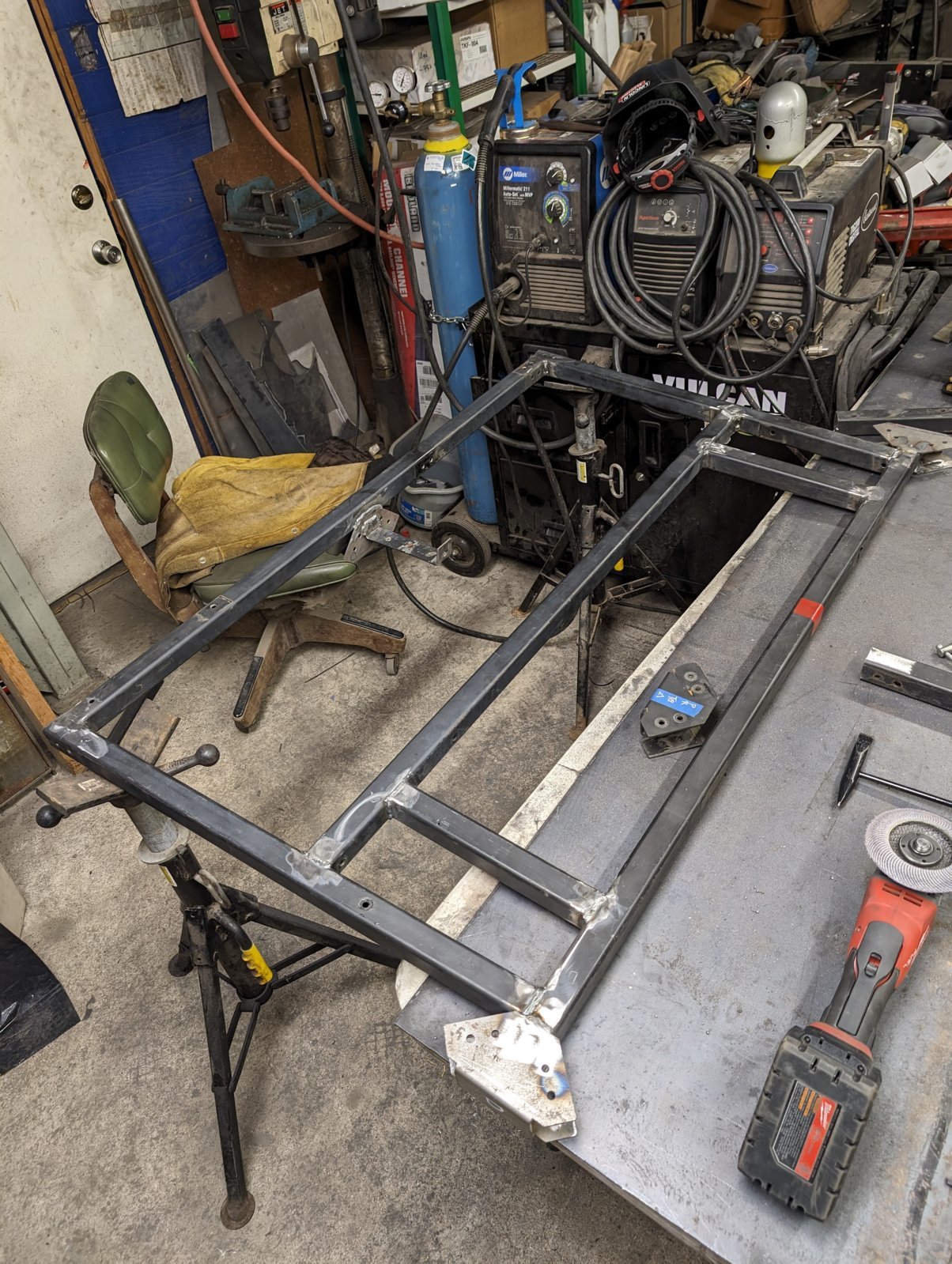

    Built out of 1.5" square tubing and some leftover brackets I had for another project.
    It is secured to the trucks floor using the seat bolts at the rear sides and the middle seat bolt. I am able to stand on the corners where it floats without it flexing as well as shake the entire truck with it.
    Decking will be MDF and will be secured to the frame using Rivnuts.
    Wall will be built in a similar manner and secured at 6 attachment points.

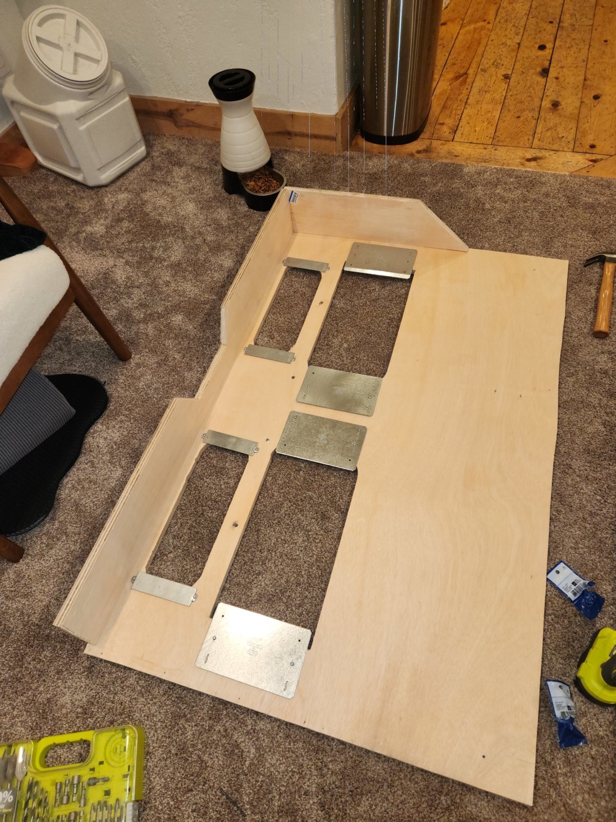

  16. Nov 20, 2023 at 7:02 PM
    #776
    Spaceman3645
    Spaceman3645 New Member
    Nov 12, 2023
    #437367
    2023 Lunar Rock Tacoma TRD Offroad

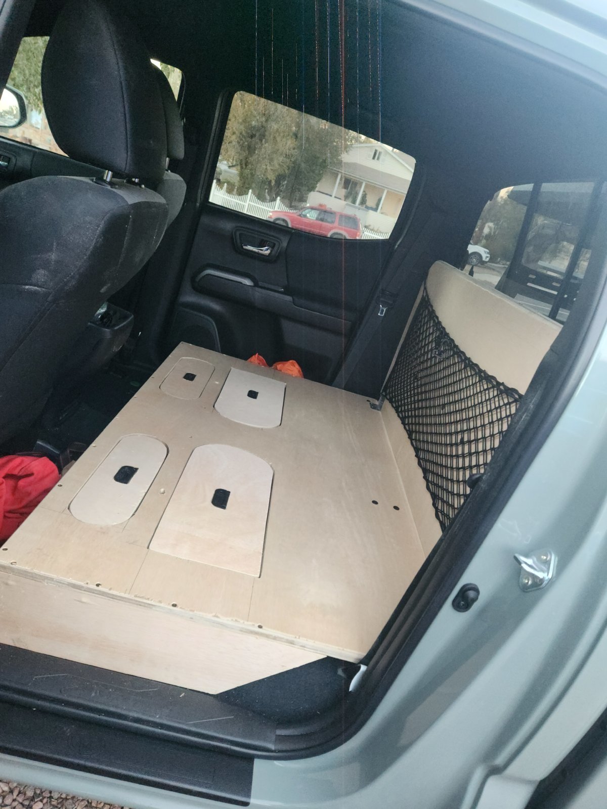

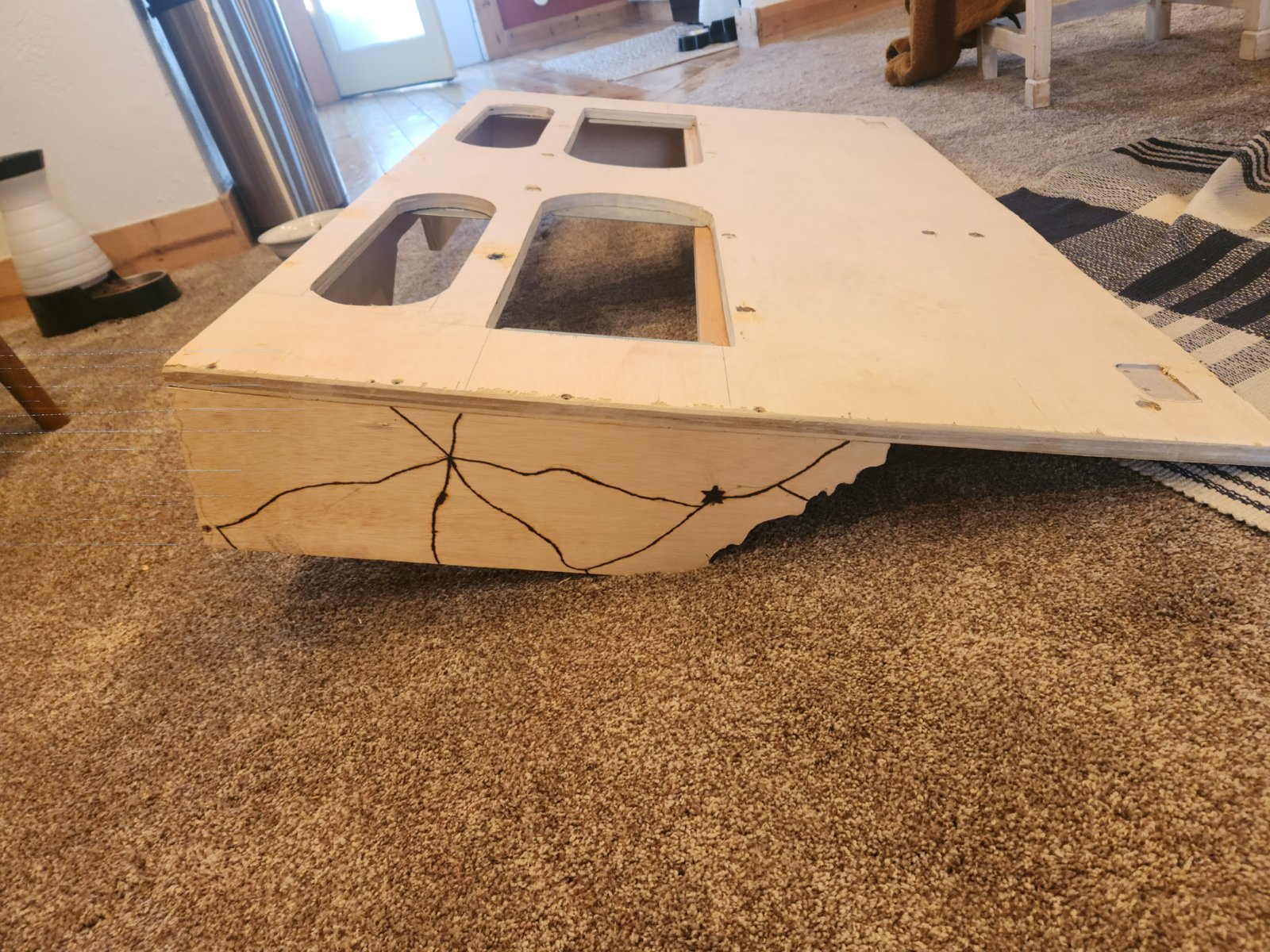

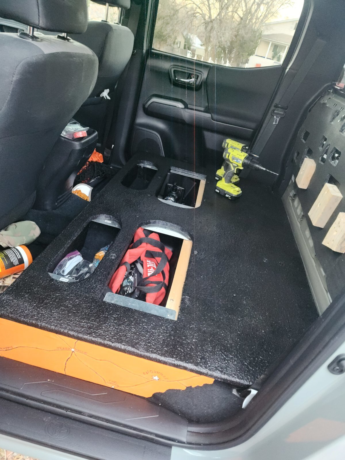

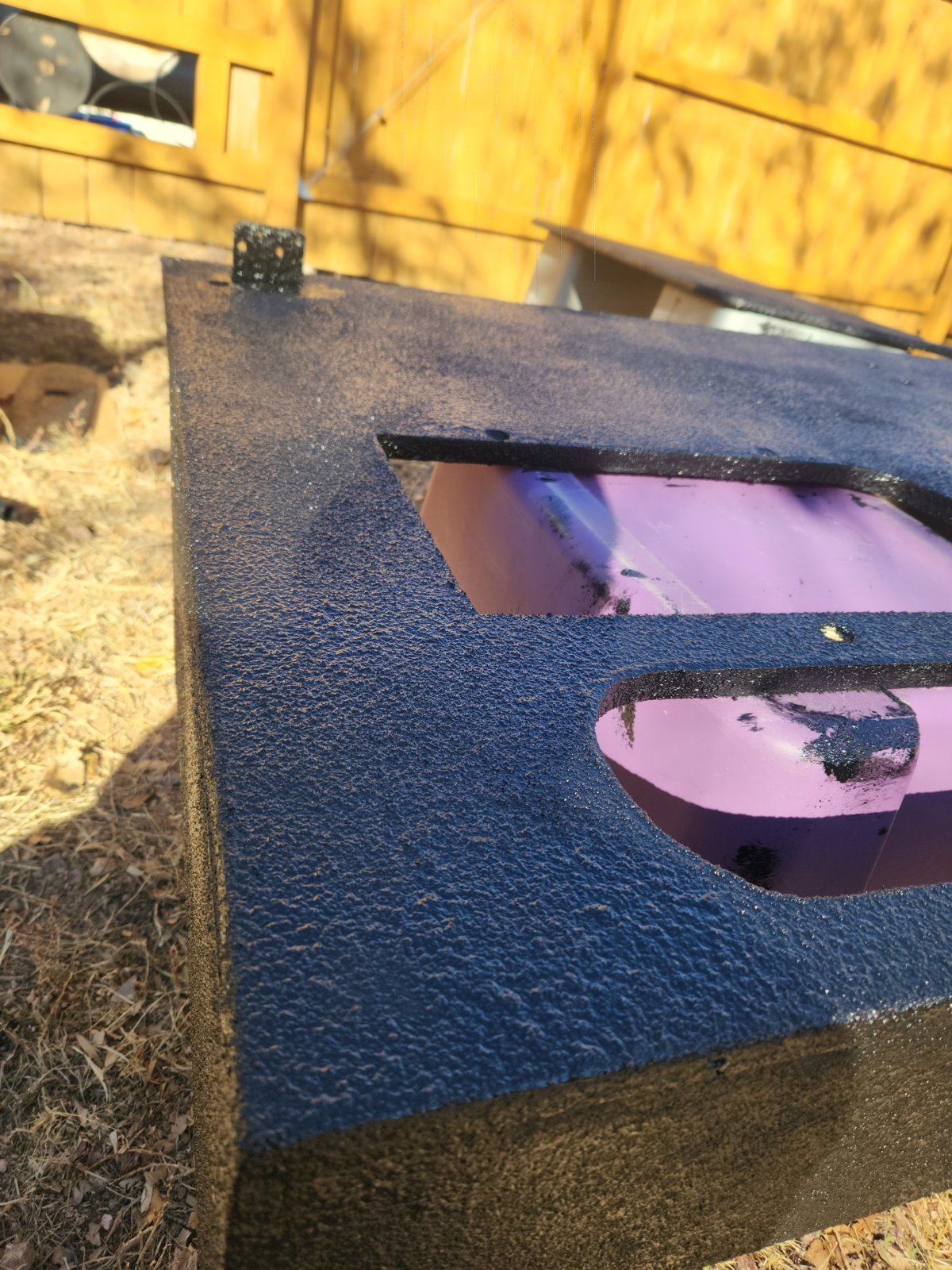

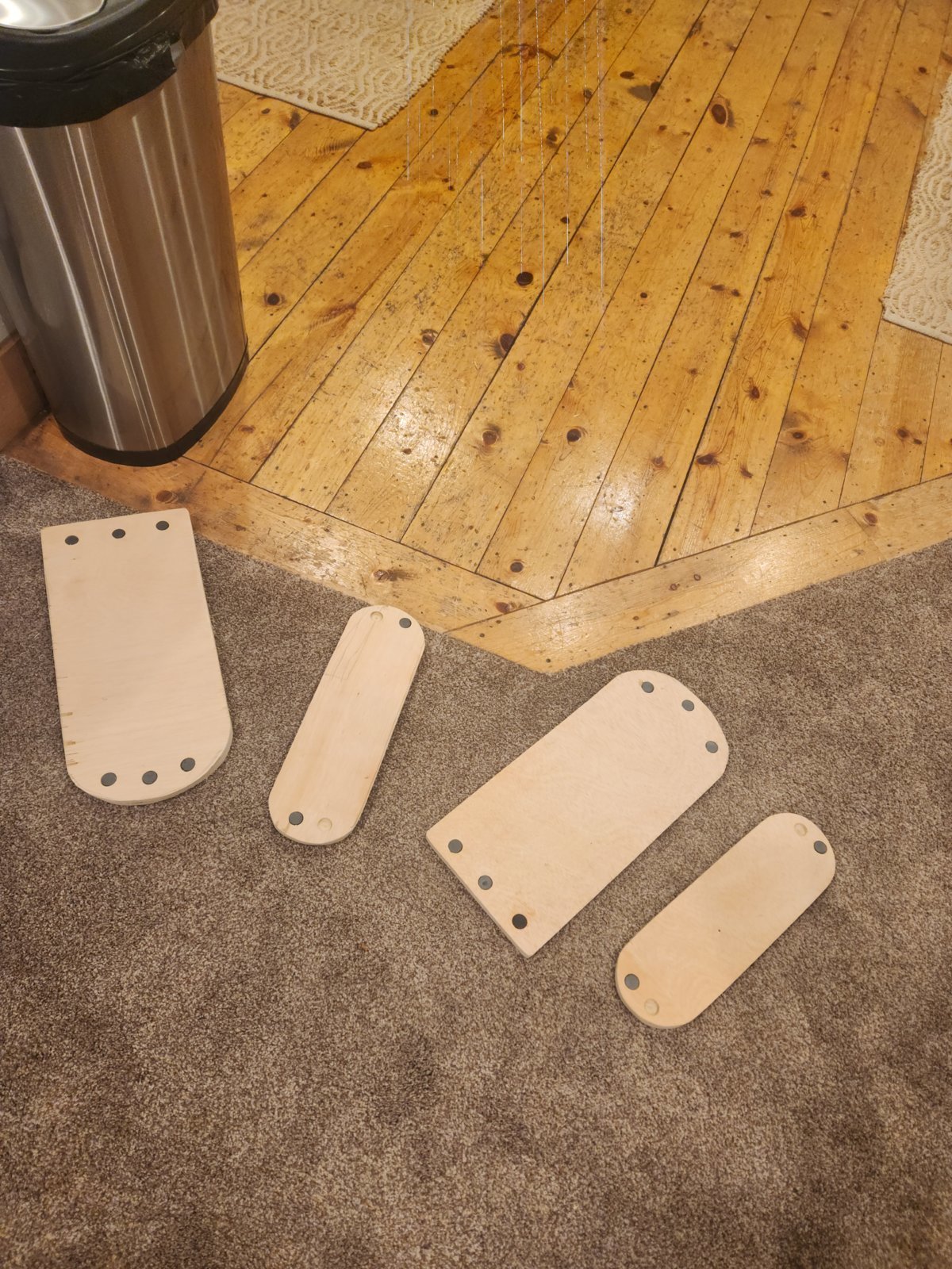

    After looking and wanting that goose gear setup I opted to design my own based on some of the awesome here. Cost was only about $220 vs buying the rear sear delete setups on the market.
    Mounted scrap 2×6 to factory bolt holes and screw the deck to those.
    Kept the plastic tool box liner and just cut a small hole to attach the nut on the bolt coming thru. Used magnets to keep the lids in place. Finally used herculiner roll on bed liner. Super sturdy and happy with the result

    Okay, the map idea on the side is really cool!

    We made more progress on the setup yesterday.

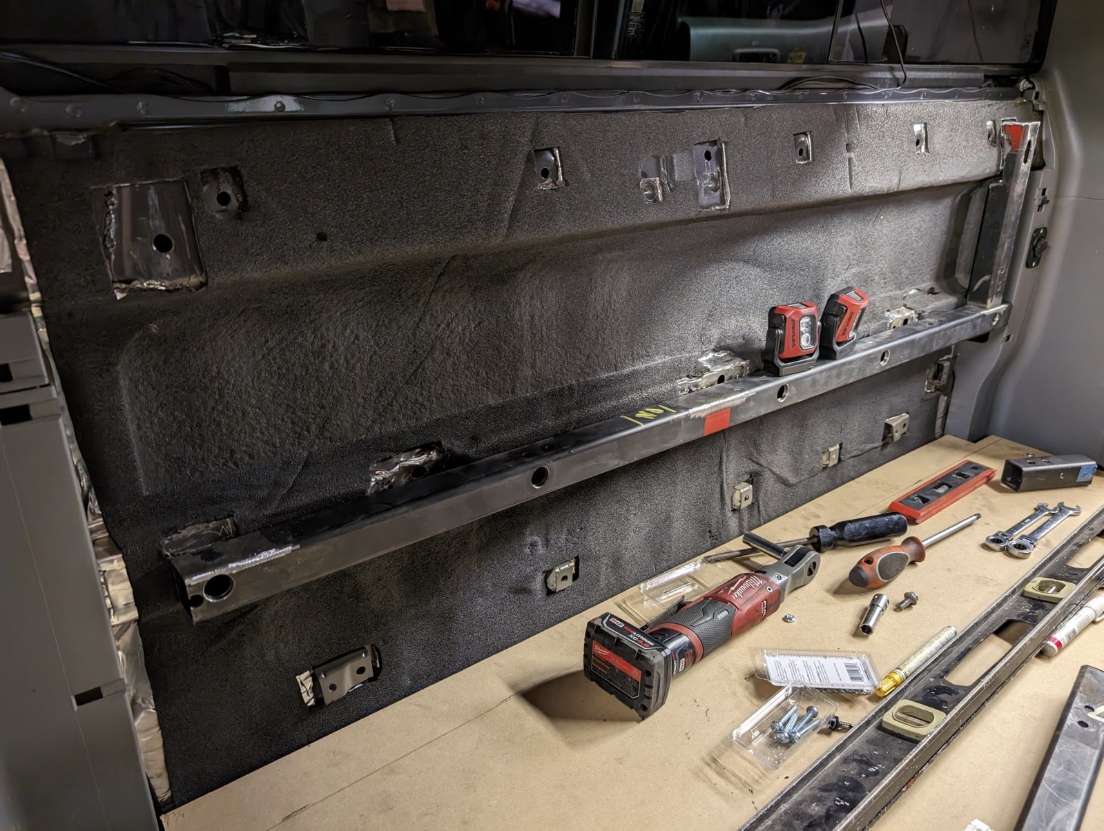

    Decking holes lined up perfectly to the rivnuts in the floor frame so that was a win. Went ahead and drew out where the under seat storage is so I can design how I want to access that storage area but am still working on that.
    Between the floor deck and the trucks floor the sound absortion material I am using are old cotton towels I found at goodwill. Same thing will be used for the back wall spacing.
    The back wall frame is built and we went a little overboard on it... same 1.5" square tube that is attached to the plastic cubby bolt holes, then ran vertical supports up to the seat latch bolt holes. On the passenger side we added in a matching rivnut in the wall to match the driver side. Vertical supports go the DJ fabrication treatment and work perfectly. Once those got made we tacked it together and then welded it up, primed it, and put it back in.
    Next up will be getting the back wall cut, adding rivnuts to the wall frame and test fit of the back wall.
    Then doing the under seat storage access, adding carpet, lighting, and a few other touches.

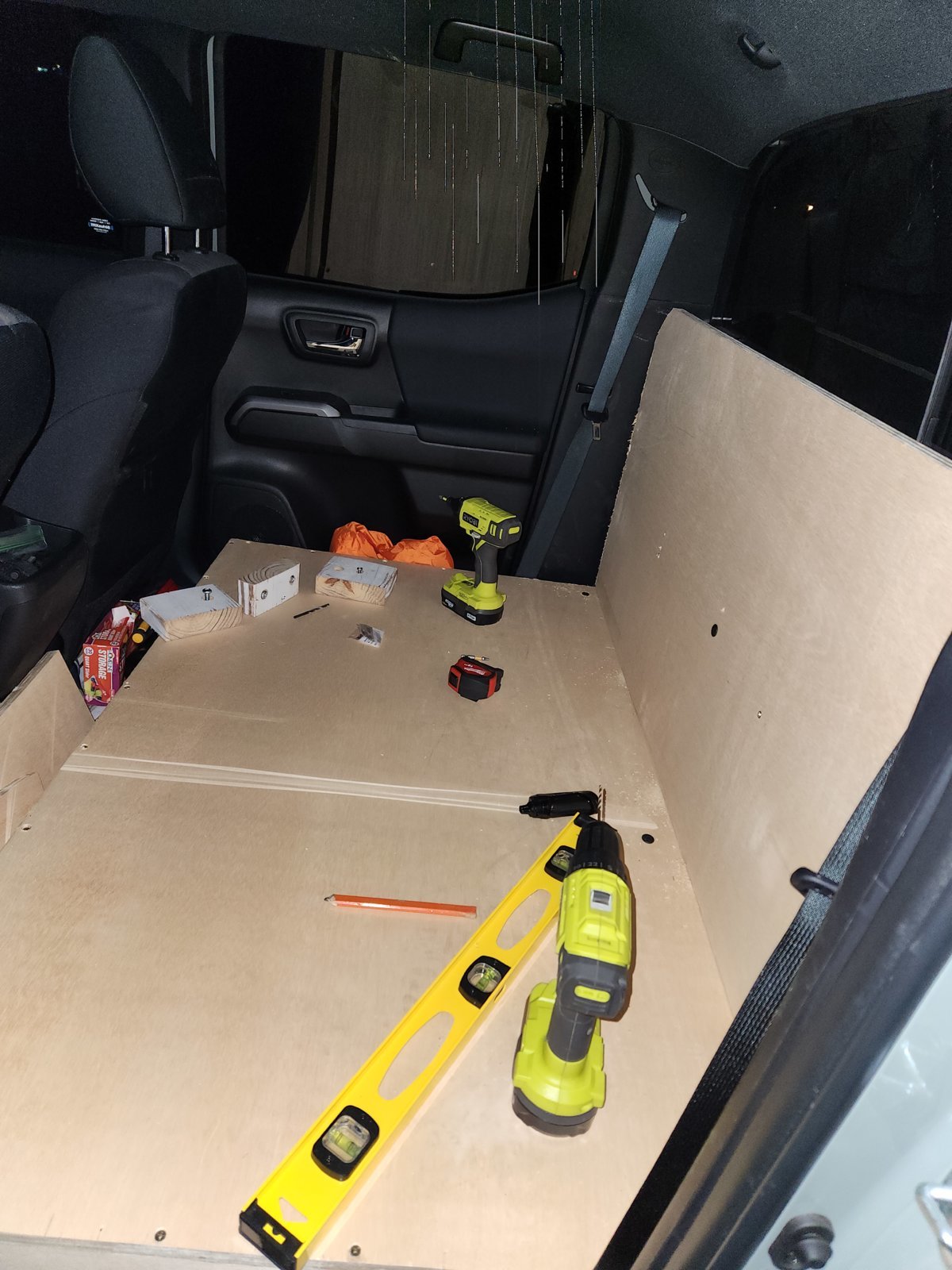

  20. Nov 22, 2023 at 4:24 AM
    #780
    ETXTacoma
    Feb 12, 2016
    #177942
    16,307
    Steven
    Tyler, Texas

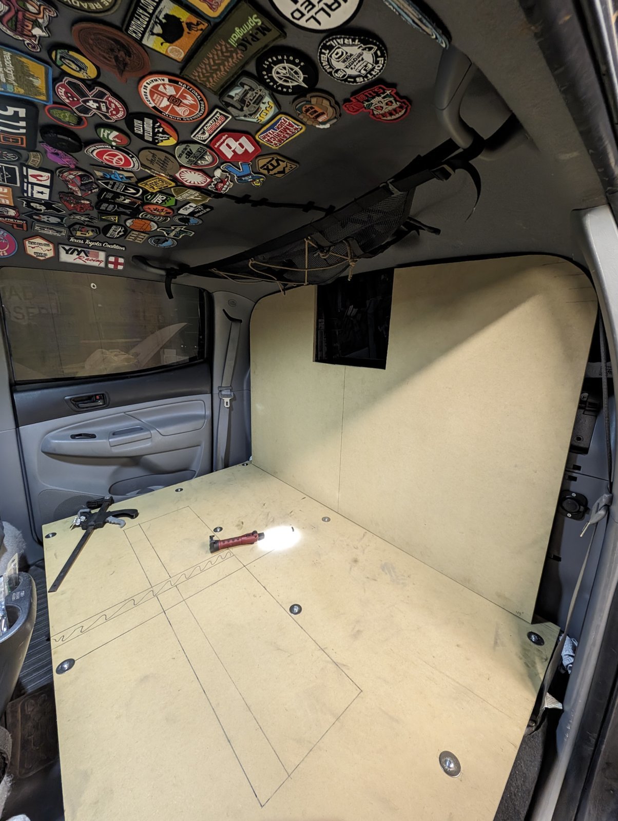

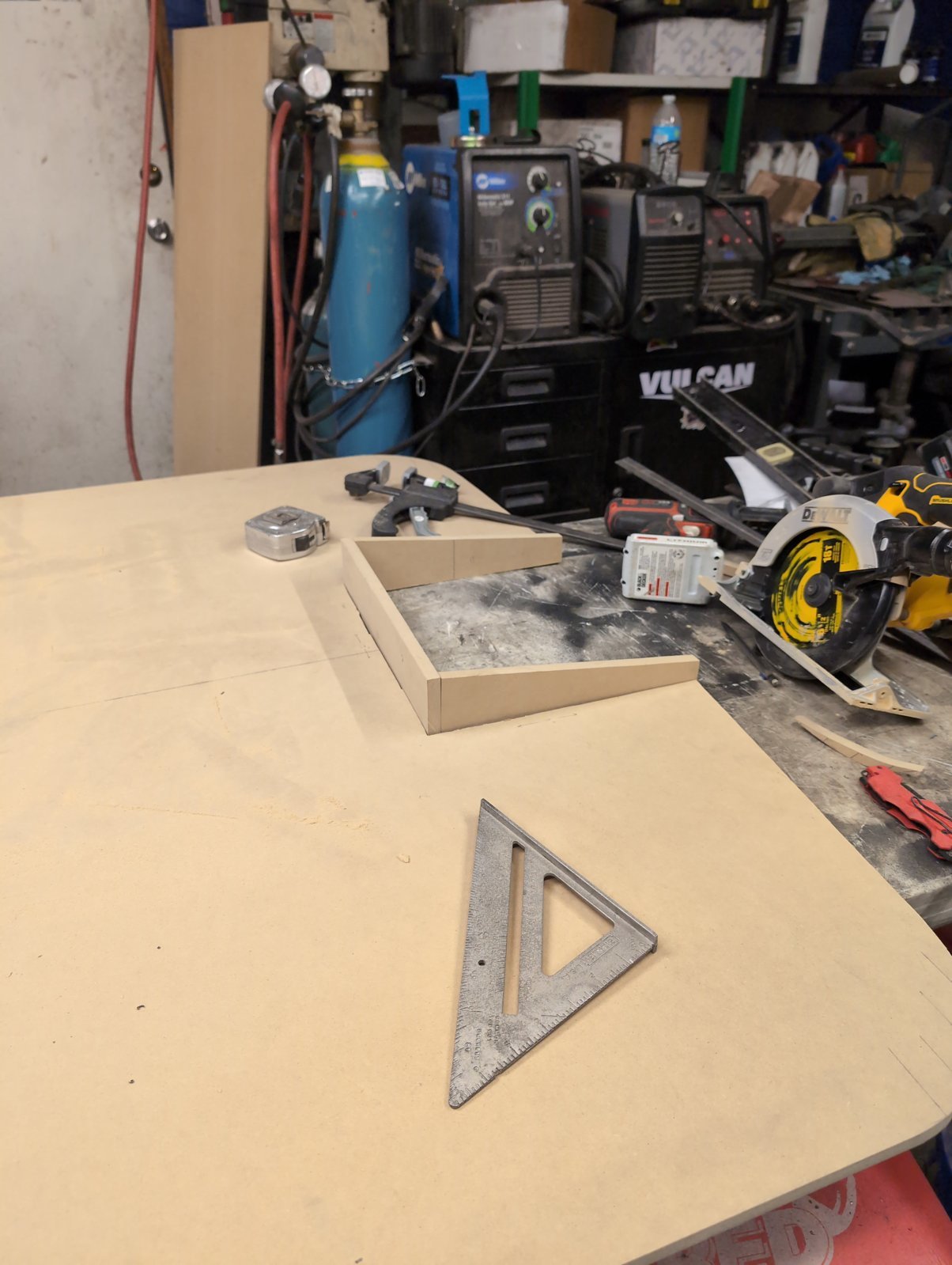

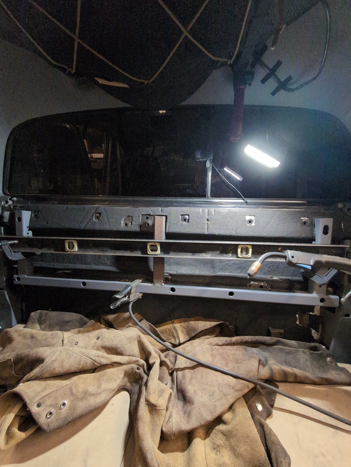

    Added in a center support yesterday. It is not tied in with the truck, but is just there to help support the wall once it is up.
    A ton of measurements later, a couple pieces of cardboard, and a lot of cutting, more cutting, and more cutting...
    The back wall finally fit to some degree. I have some more revisions to do to the sides as I have some plans for outside wings of the back wall to be independent from the rest of the wall. Since I will be having power outlets on the sides that I'd like to be able to access or work on if needed without taking the entire wall down.
    Quickly did some cutouts for the rear window so that the gap between it and the wall would be somewhat filled. Will need to glue and put that together still. Got to a stopping point, so will hopefully be back at it today maybe.
