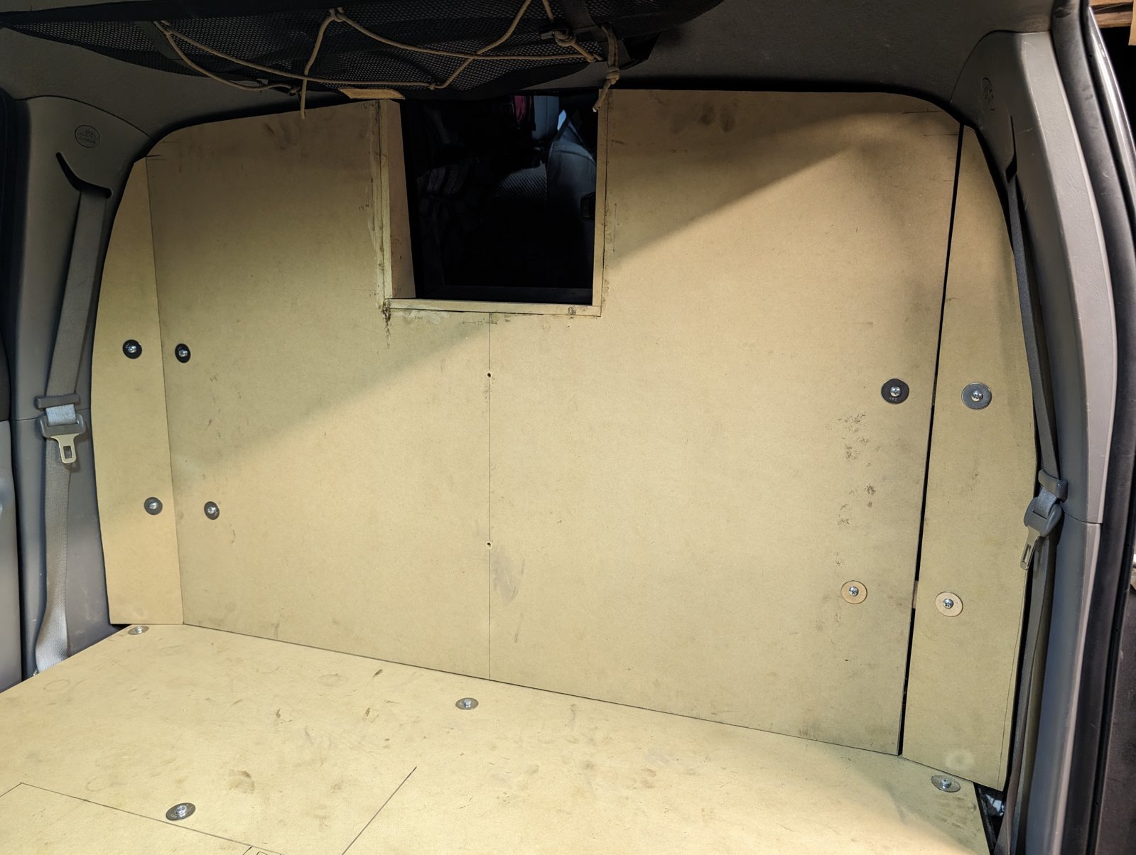

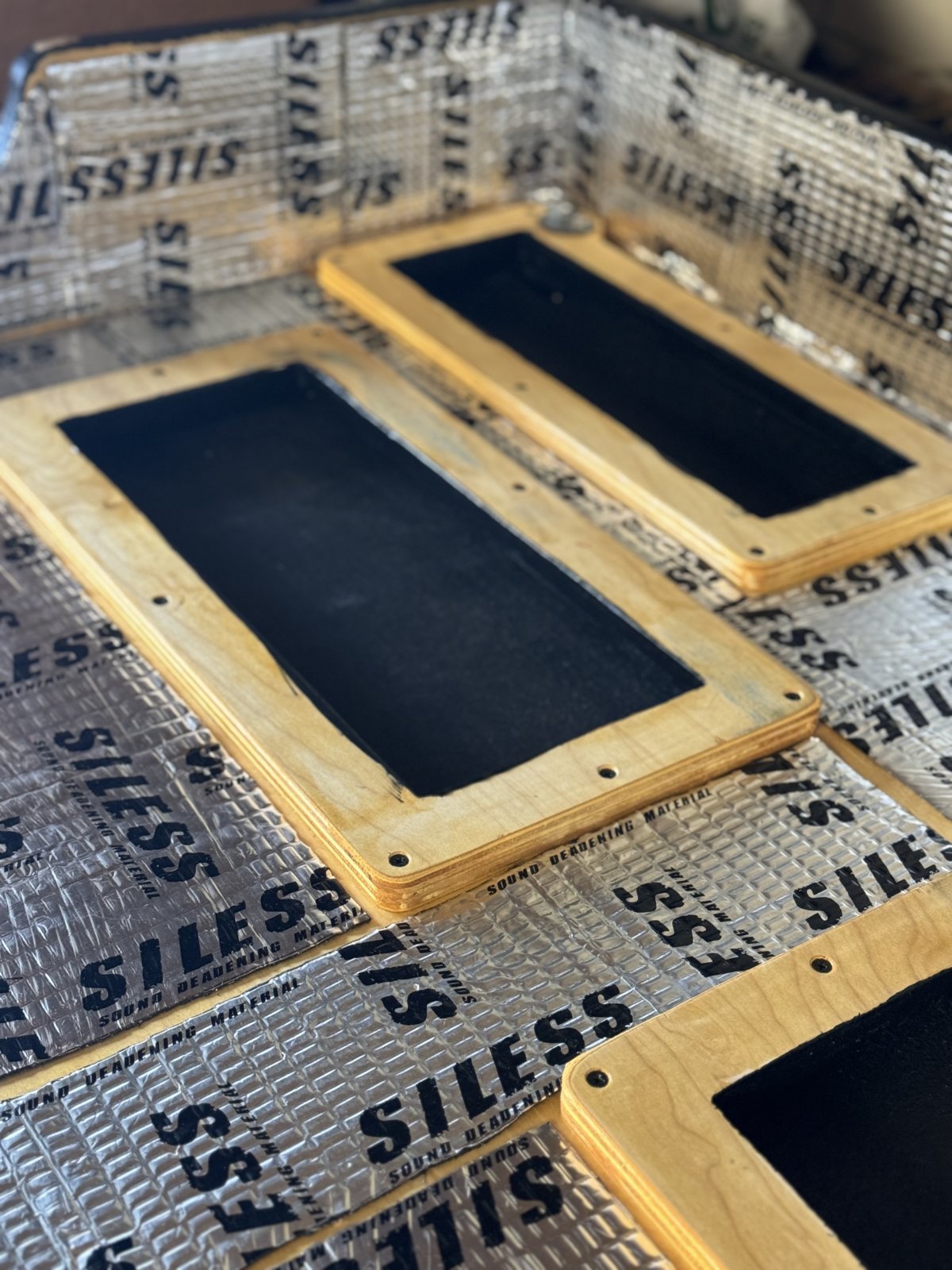

    Was able to get the center of the back wall finished out yesterday and attached.
    We then started on the sides of the back wall and decided to do them at an angle instead of flush with the center section. The drivers side will also be where a few 12v power sources will be located so that piece I wanted to be easily removable.
    Next step is to remove all the wood and make sure everything is insulated in the dead space, figure out the floor storage access doors, seal the MDF, paint it some in a few areas that won't get carpet, carpet it, then add in the 12v lights and power outlets.

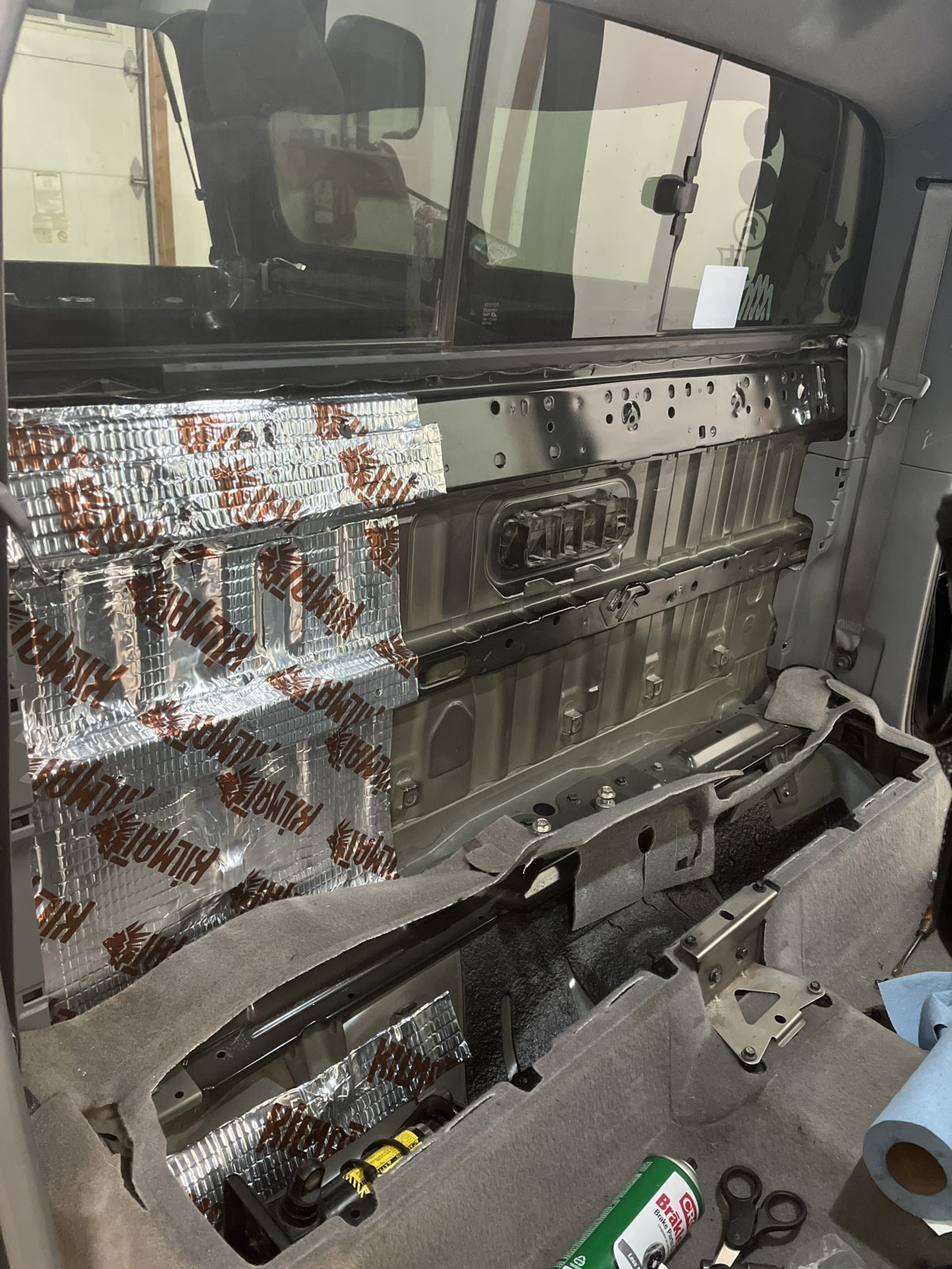

    Finally got my life together and installed some sound deadening on my rear seat delete and rear wall of my cab. It only took me 2.5 years. I didn’t get wildly obsessive with it but I’m sure anything is better than nothing.
    I also noticed a hole in my floor. Looks factory haha

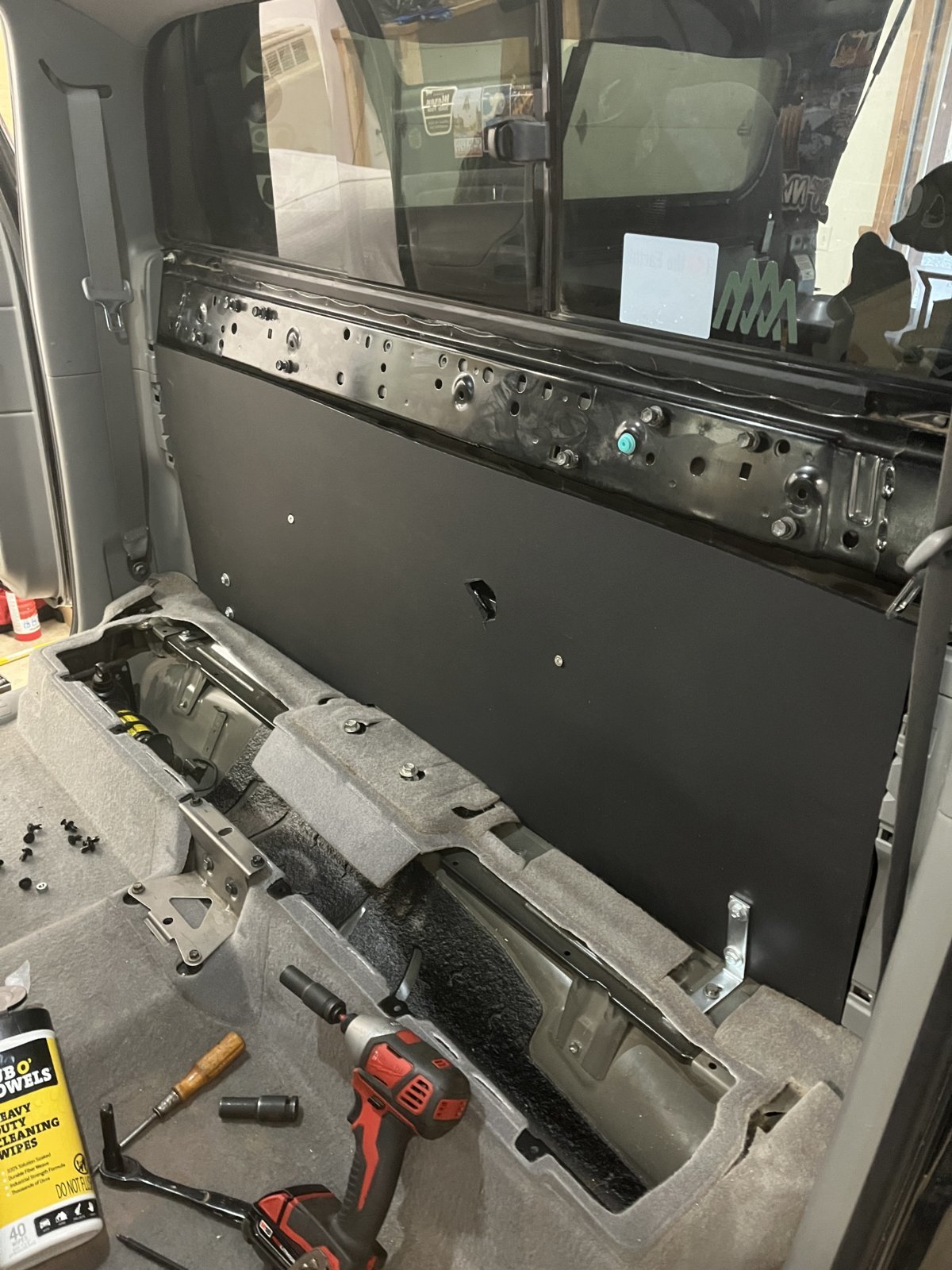

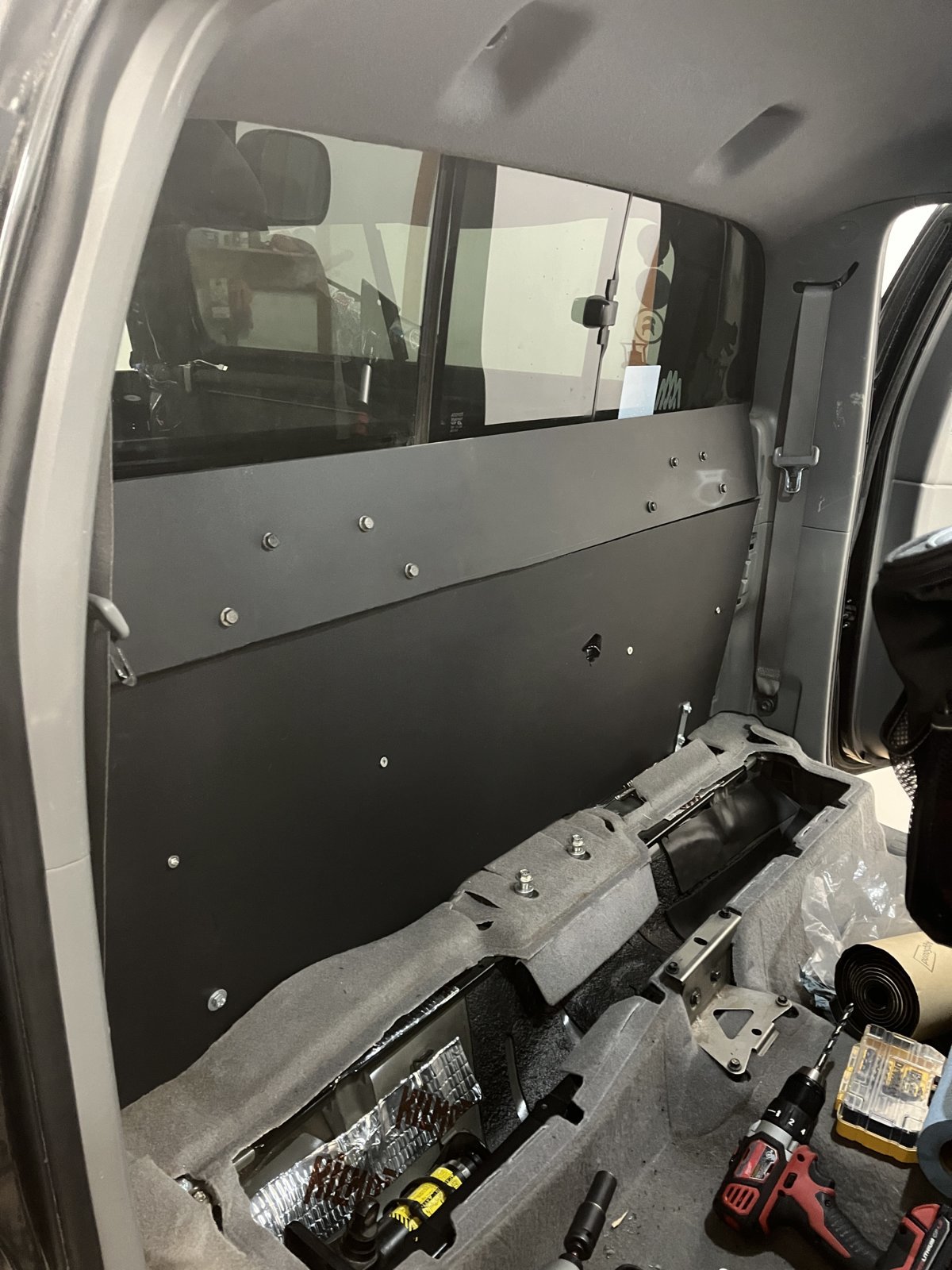

    Adding progress pics and finished product (so far). Went with killmat, then foam, then 1/4” king starboard (way cheaper than the 1/2in solution early in this thread). Haven’t driven it yet with this setup. Drove with just the bare metal and boy that was bad. Excited and nervous to try it. I imagine I will take it apart again and add more sound deadening. That vent is really a PITA. I cut it up but I doubt that will help.

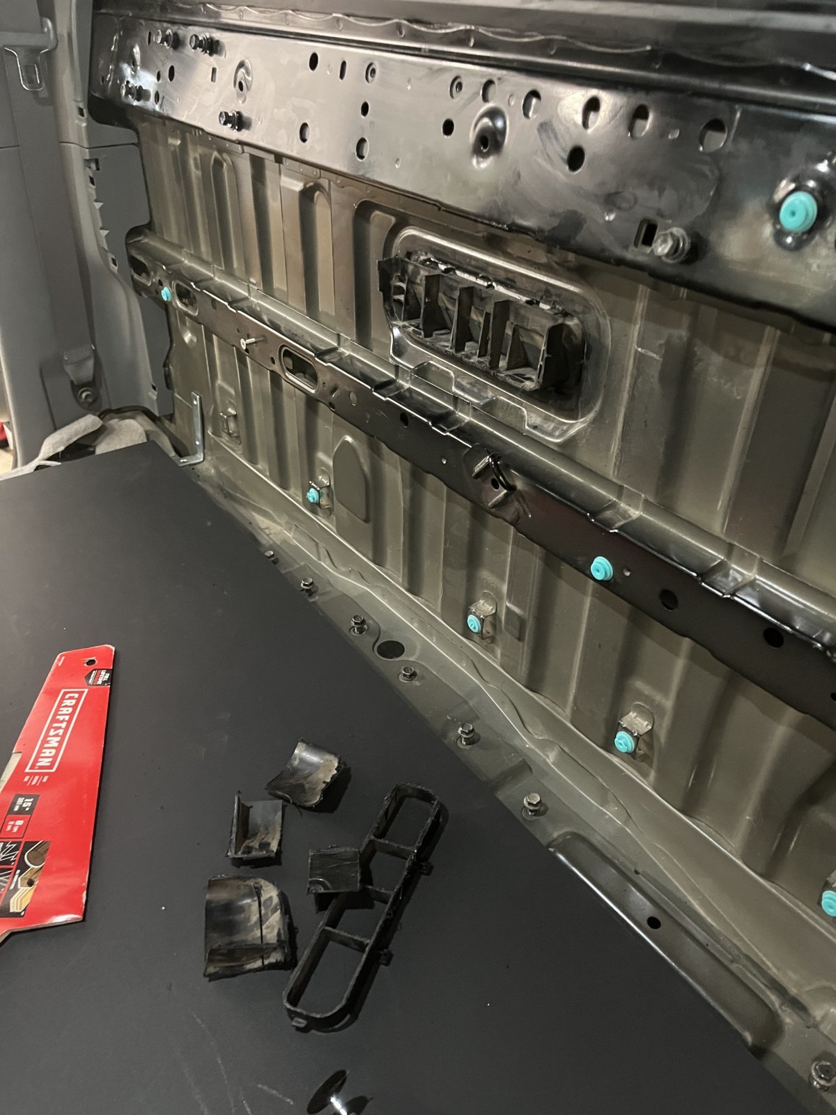

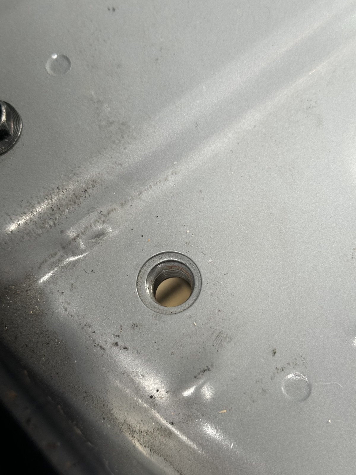

    12
    2009 Tacoma Double Cab Barcelona Red
    Hi Gomer, I found the proper holes in the cab floor to bolt down the platform against the back of the cab wall (the three holes in a row), but I’m not totally sure about these four. Maybe they mount the platform where the plastic trays are clipped in to the steel floor of the truck? What kind of hardware did you use there (or maybe I’m looking at it completely wrong).
