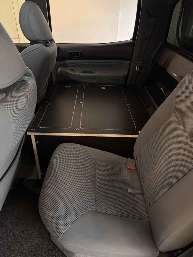

    If you're going full on permanent delete, I saw a couple that take out the metal storage that the front of the seat anchors to. They had drawers in there and were able to keep a lower profile for the dogs getting in and out. I'm thinking about that as the Taco is gonna be around for a while and it's usually me and the dog.

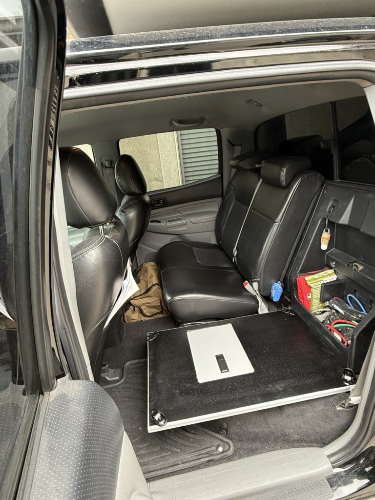

    Very nice!
    Do you get enough space to be able to open that up very easily?

    It clears the back wall easily enough. It could use something to hold it in the open position. Gas struts would be overkill, so maybe a strap or prop rod.

    I'd like to maximize my deck (obviously) forward while using the seat hinge. I'll probably take the lid off the cubbies so the degree of pivot is not an issue. I'll bet a prop like hood uses would work.

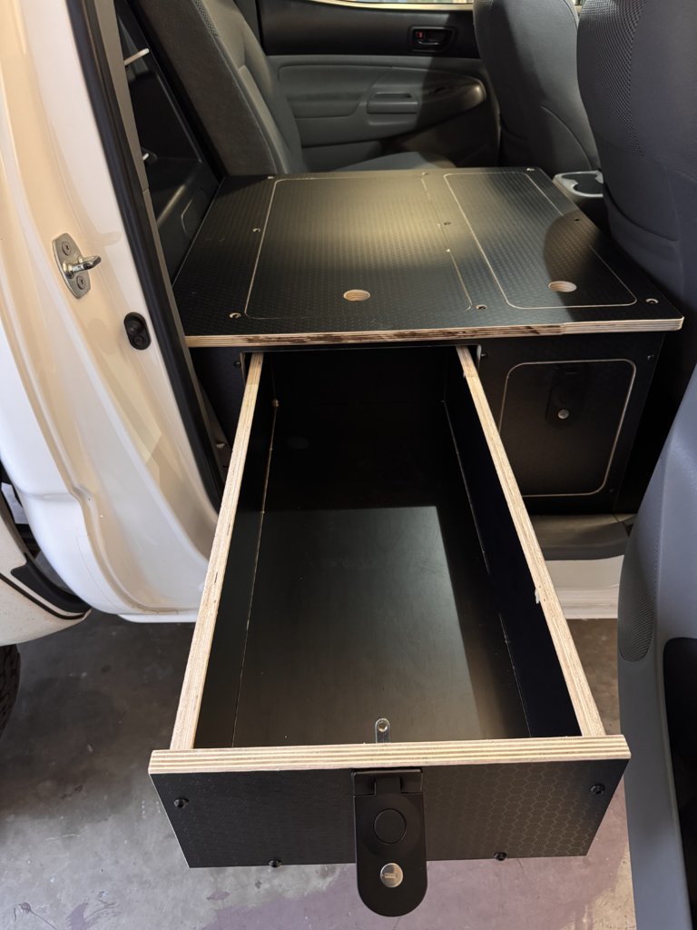

    Well...
    Guess, I am going rebuild the rear deck once this is finished out...
    But have a Goose Gear Fridge Slide and some Milwaukee Packouts ready to mount onto the rear seat delete 2.0 setup.

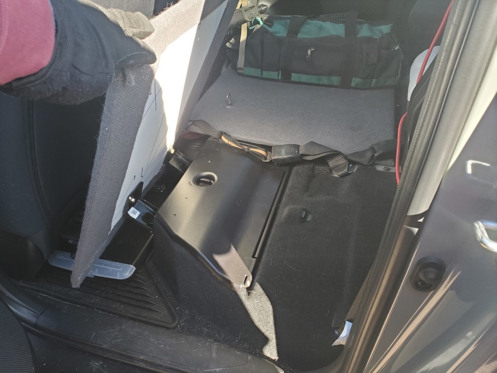

    2023 tacoma off-road

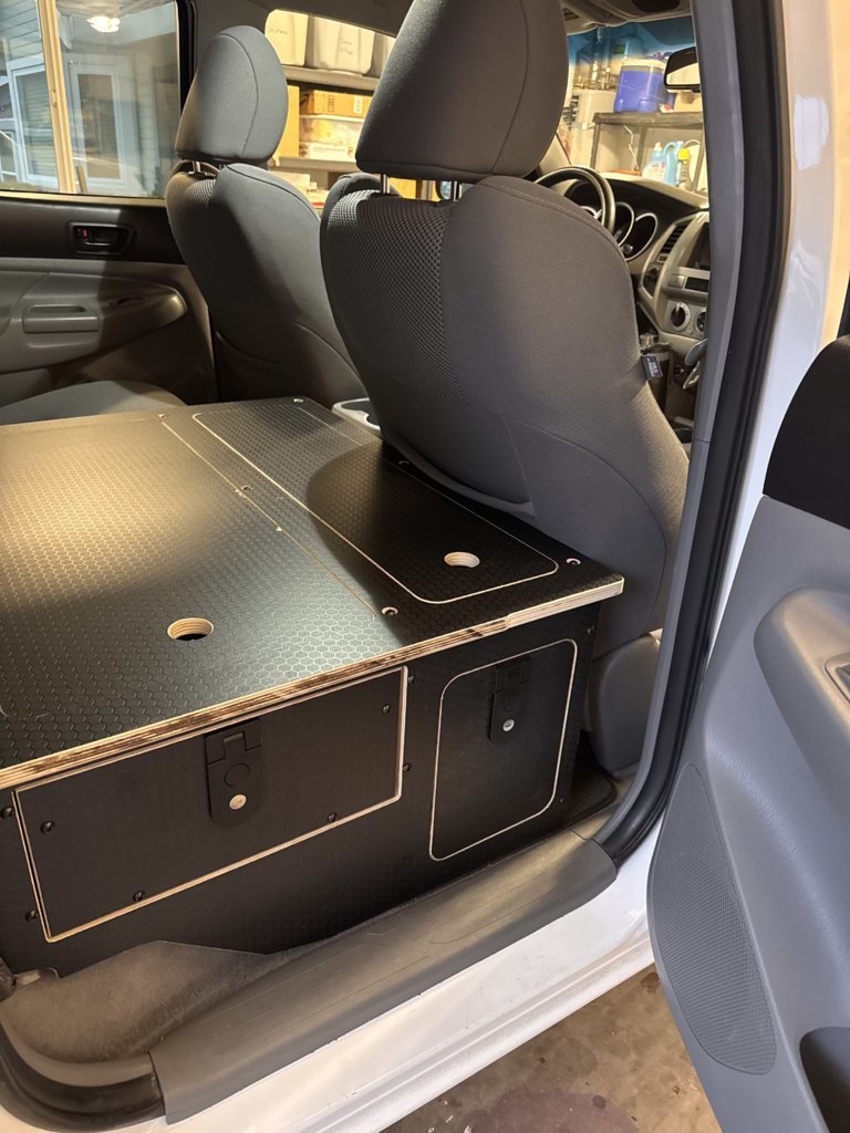

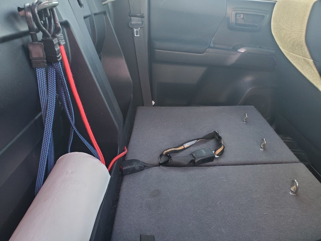

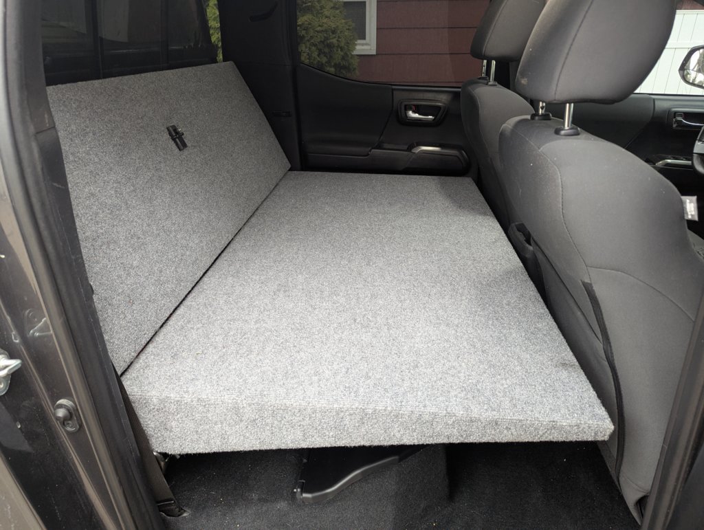

    Pretty easy seat delete. Removed back seats, replaced with some marine board that I covered in speaker carpet. Used eye nuts and bolts/washers to secure it all to the factory seat brackets. I did this last year, wanted to save all the measurements and what not so when I finally got around to posting I could share those, but, I had to reset my laptop in the meantime and lost all the info.
    20250226_151647.jpg 20250226_151658.jpg 20250226_151730.jpg 20250226_151744.jpg

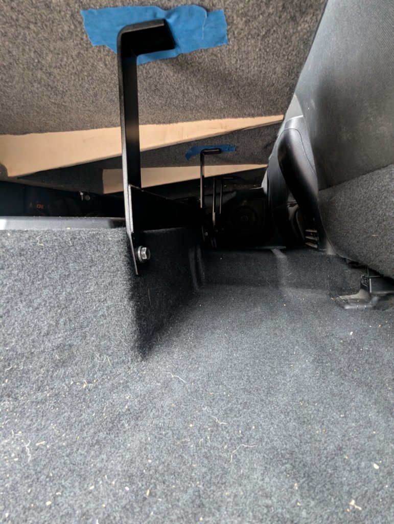

    I built this aluminum one 3 years ago. I pretty much sold it at cost after about a year, hopefully the guy who bought it is still enjoying it.

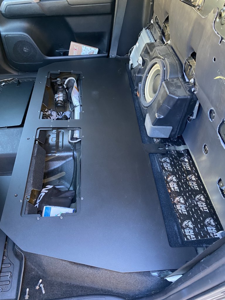

  11. Mar 25, 2025 at 1:33 PM

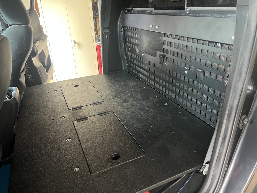

    2014 DCSB trd off road

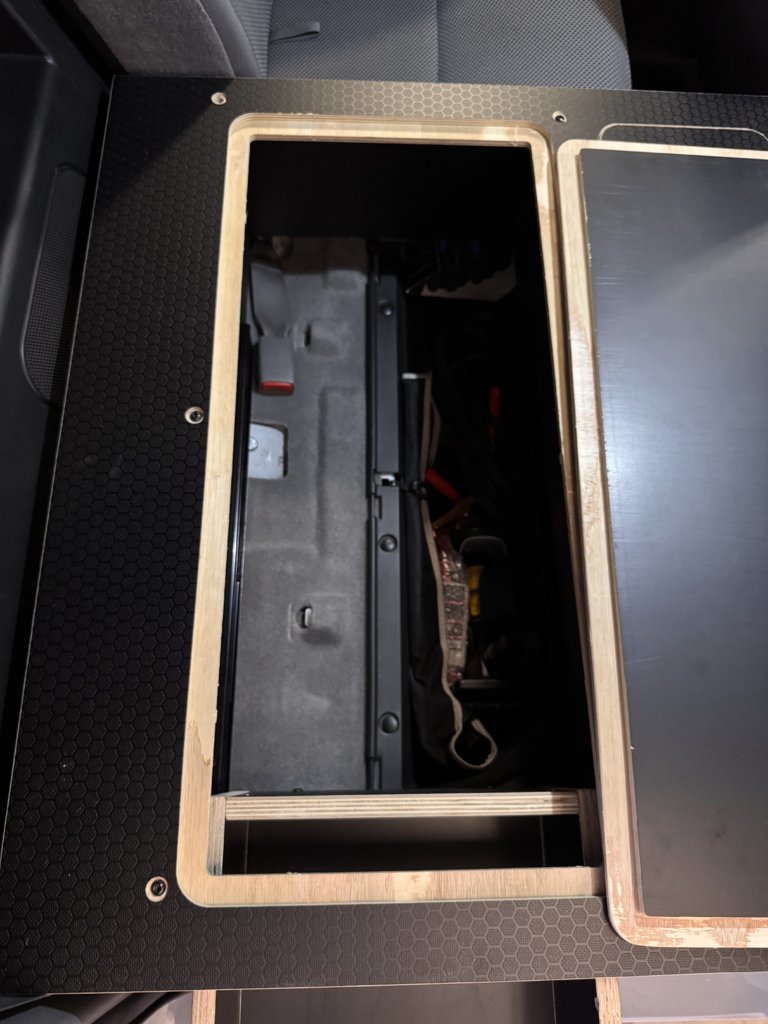

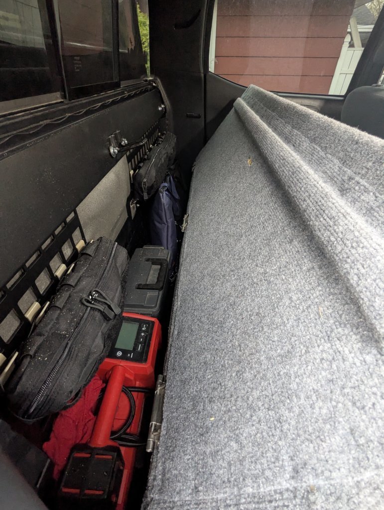

    After having this bolted in all last season I’m finally getting around to putting the finishing touches on it this year. Fresh paint today, had to take pics. I’ve got a southco latch for the door, kinda matches the gfc. I’ll post again once it’s installed.

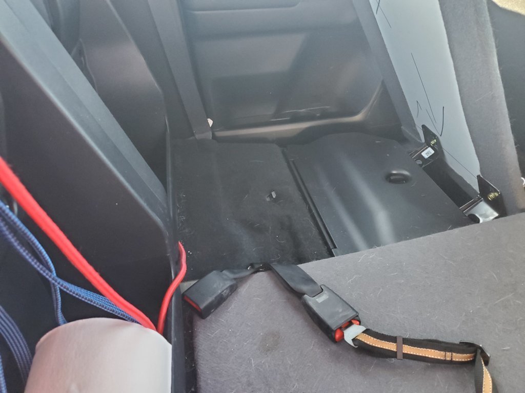

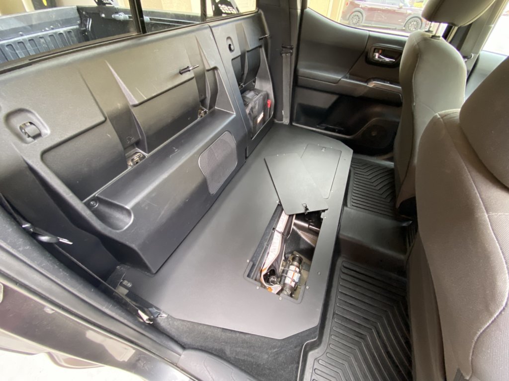

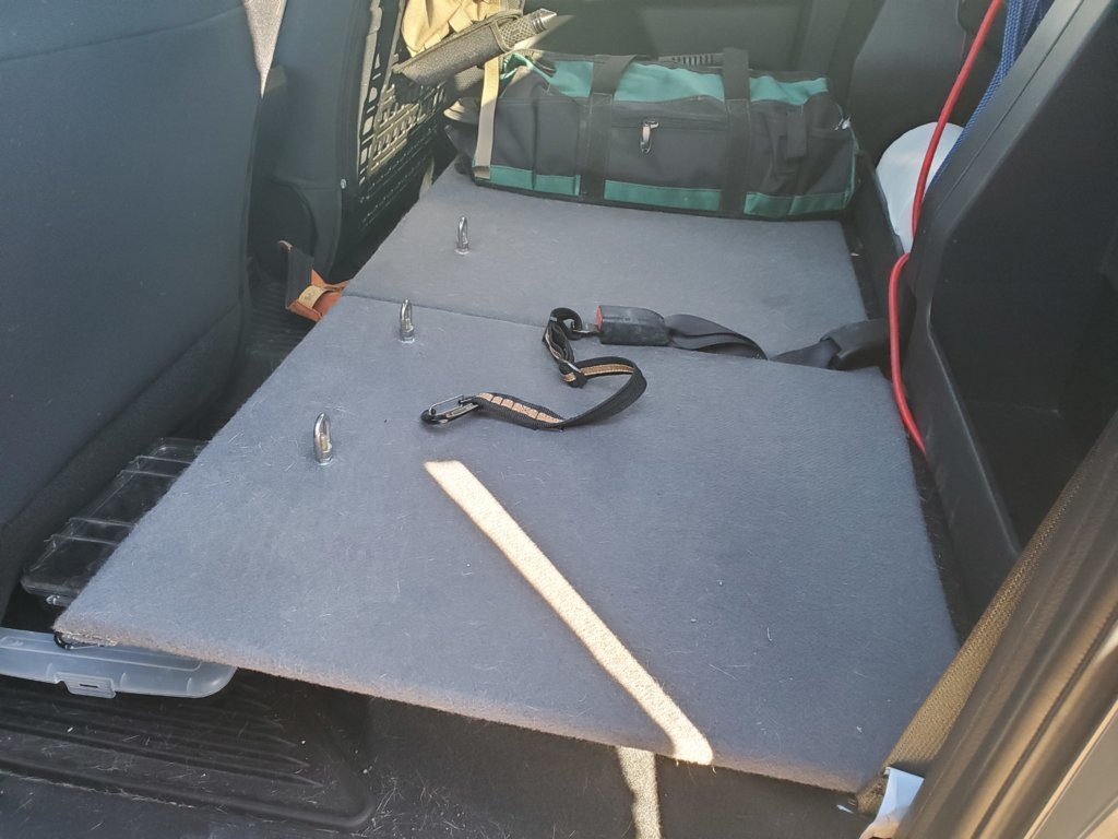

    Just made a rear seat delete platform that can easily removed so if I need my rear seat it takes less than 5 minutes to put it back in.

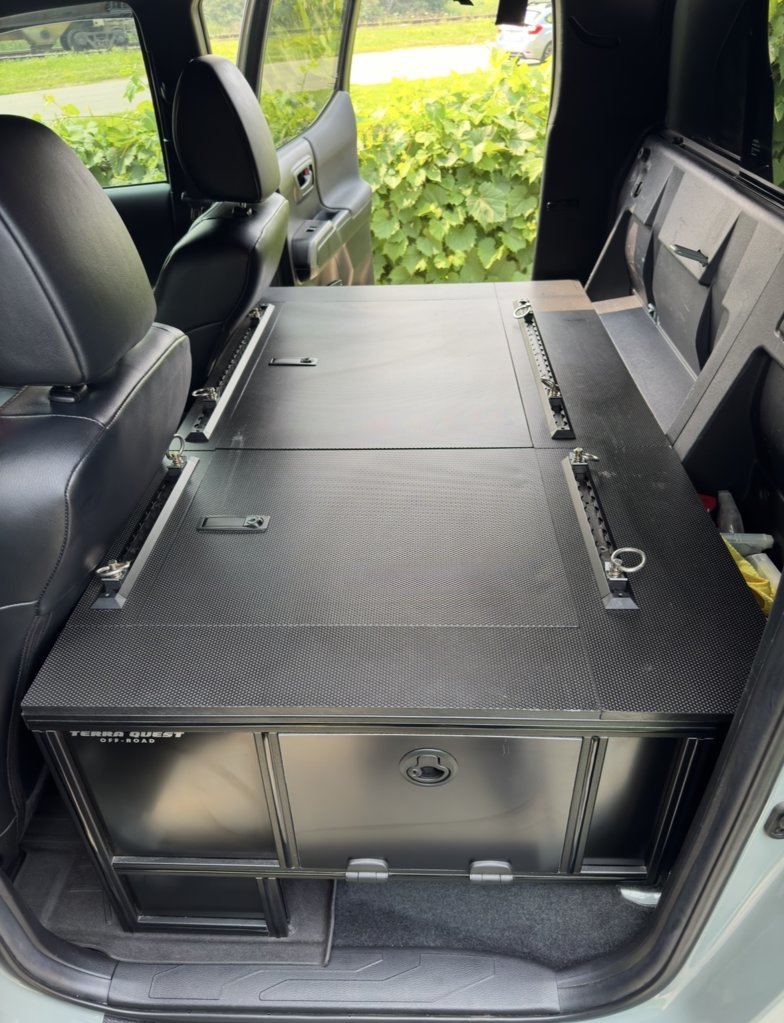

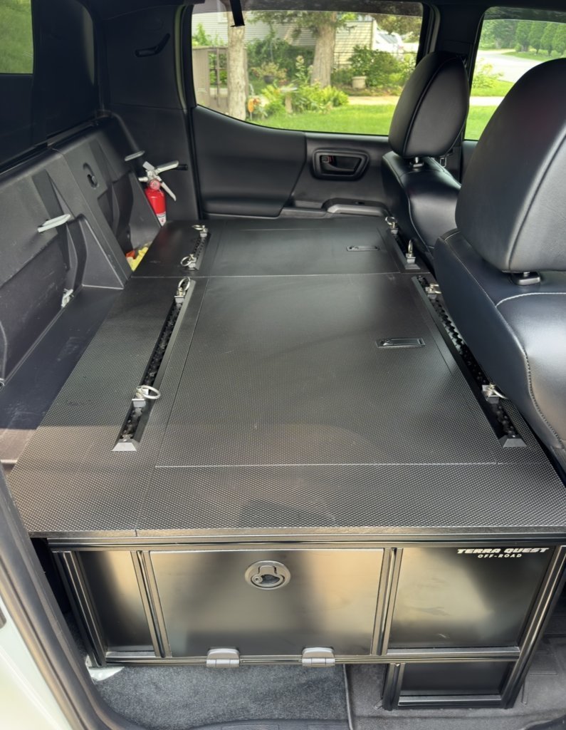

    2011 TRD Off Road Double Cab Short Bed

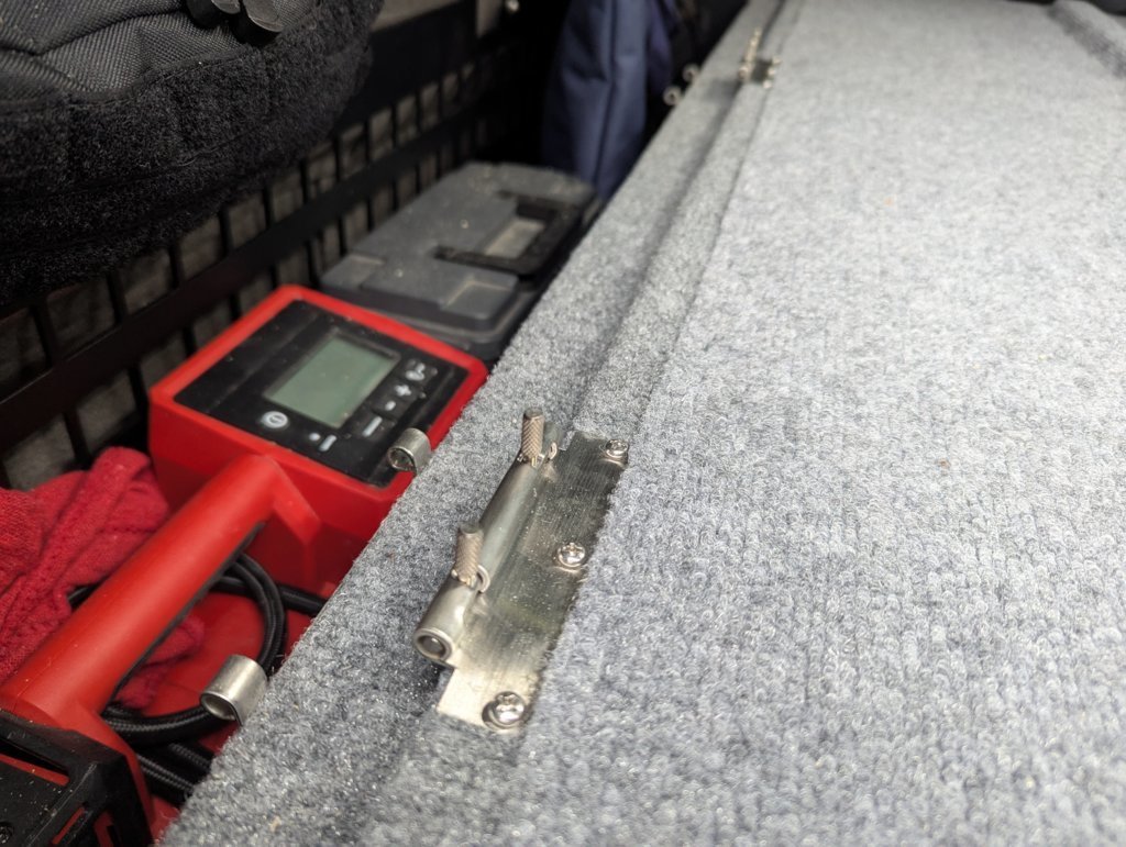

    Got my 60% side delete from SHW Offroad installed. As a reminder for 2nd gen owners interested in this, it’s designed for the 3rd gen, but fit with some minimal trimming.
    They’ve made some changes to the design recently, so it no longer wraps around the cup holder portion of the center console. Their website still shows the old design and no mention was made of the change, so there was some obvious confusion once I started laying out the pieces to assemble. The good news is that this change allows for the front seats to have more rearward travel than with the previous design.
    They’ve also changed the finish, and it doesn’t seem very durable, to be honest. There were multiple chips in the finish upon opening the shipping box, and after a few days of very careful use, more of the finish has chipped off around the edges. Also, one of the pieces didn’t get fully milled out where the hardware installs, so that took some extra work on my end.
    If you’re a 2nd gen owner who is interested, you’ll have to use a table saw to trim about an inch or so off the edge closest to the door panel, as it sticks out too far. Luckily, the portion that sticks out seems purely decorative, and won’t affect the structure.
