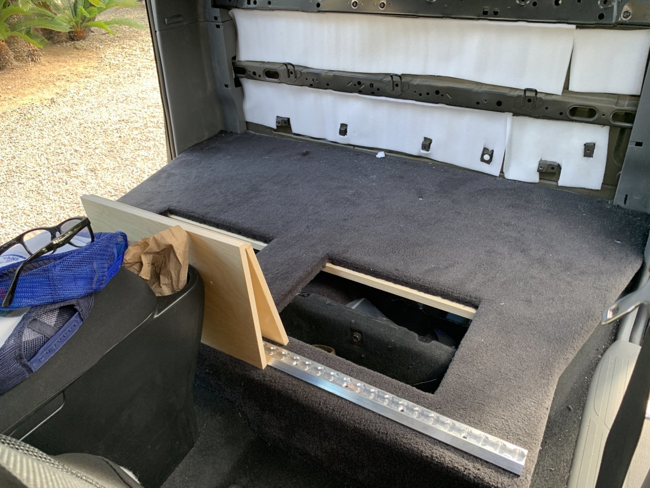

    yes..ill get some pics together asap!!
    i am finishing the butchering of the auto carpet today...trying to not cut my fingers off....

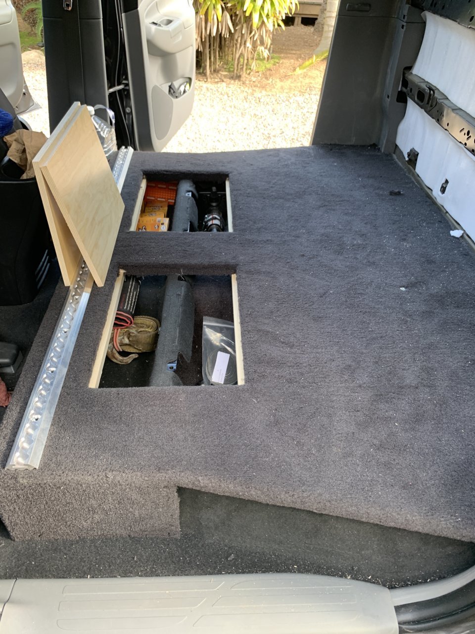

    latest efforts....

    yes//the cut outs are finished-wants positive about sizes-but I'm hoping these work..

    Very Nice build .. but a bit confused u took out a box to build a box ? There is already a box under the seat why not just take the seats out and use the box . unless your using the deck for other items . But overall awesome job .

    well-fist off the area is not flat-i wanted to keep my frig there...so the platform-makes the whole area more usable to me-My dog also loves to hang there-and its much better then him ruining the seats-which can be returned to normal in about 30 minutes-or 2 beers time.The insulation with the foam behind the wood panels-is much quieter as well-keeps the road noise down.I split the two areas so i have access to the "stock" storage area-and the new space as well.Thanks man!!!
