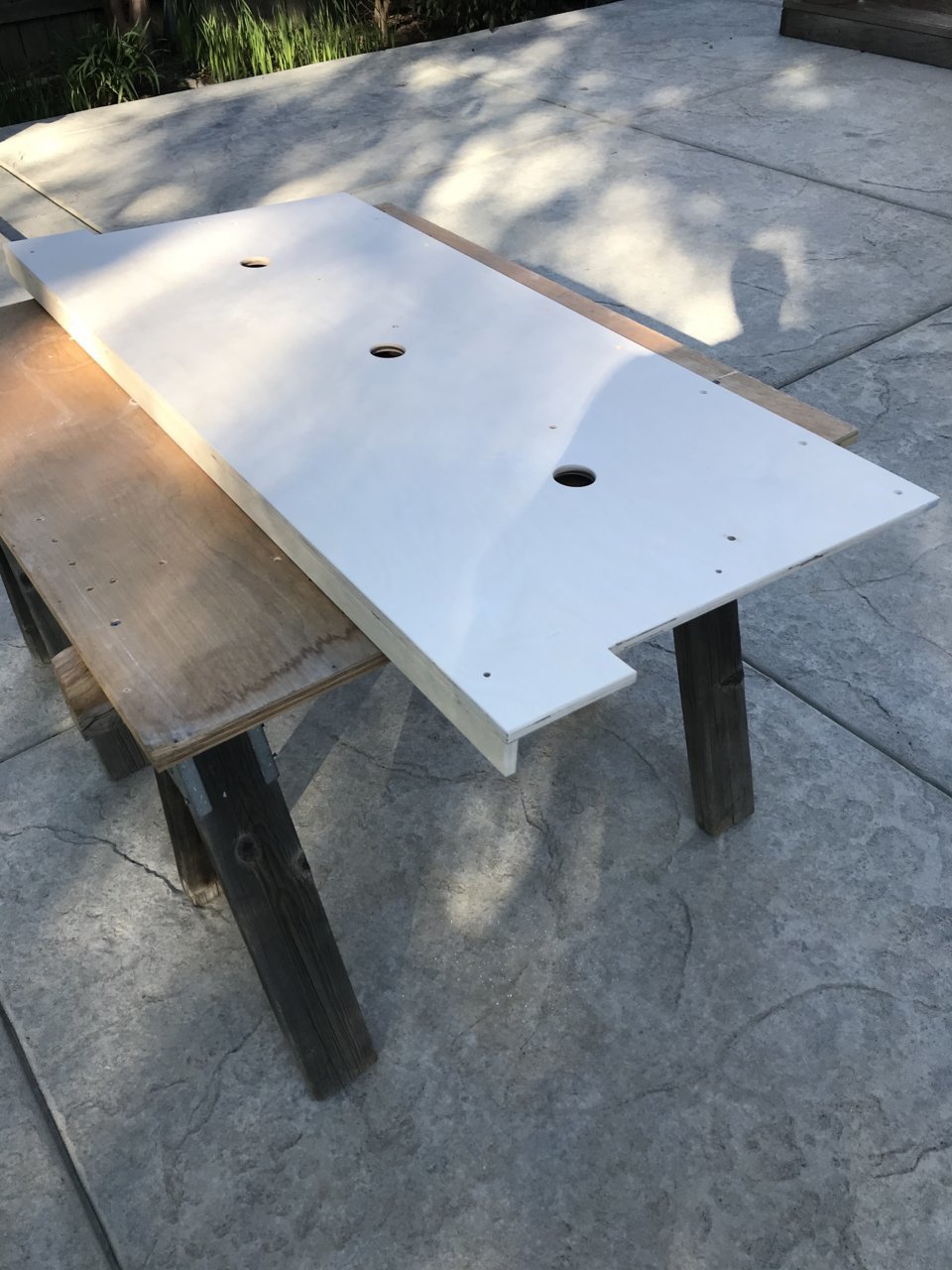

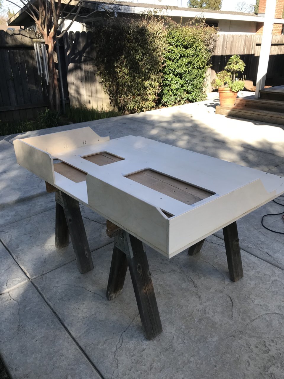

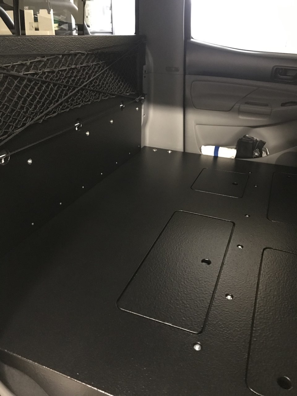

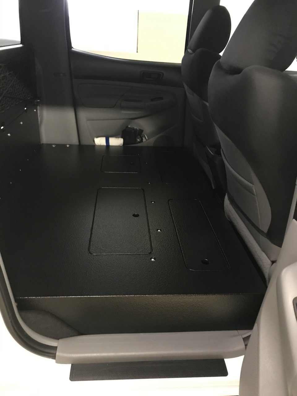

    E91E14B3-7E0B-47D8-95FD-3DFDA00AE3AA.jpg 20324FAA-54C7-433F-88DC-F38131484696.jpg 7FAD3438-2259-49C4-967D-F69A2B572CF4.jpg CFBA82C2-41B9-49F6-AFB8-F9612C0429A2.jpg E96A9FD2-20F3-4947-96C5-D81B1FBEC270.jpg Finally, almost complete. I still need to mount some anchor points or l track, maybe both. But it’s mounted in the truck for now.
    Thanks OP and all you for the motivation.
    I really liked the Goose Gear kit but didn’t like the lead time that came with it, so I pretty much copied the design. It is a one piece platform which is what I wanted.
    Fun little project. It was my first experience using Monster Liner
    and that stuff is awesome!

    Looks great.
    L-track if you don't need a smooth surface. T-nuts from the underside if you do.

    Thanks, I’m thinking about changing up the fridge so waiting on mounting points. Some L-track is in order though.
    Thank you. It was also my first time using a router.
    Thank you!
    Thank you as well!
    The room back there is incredible!

    Well you’re in luck! I still have the template I made and the measurements on some sticky notes. It would be rough enough to get you started. I was getting ready to trash it all.
    If anybody is in the Sacramento area you are welcome to the template.
    Give me a bit and I’ll take some pics and PM them to you.

    I will post them here then. Stay tuned. It’s nots much LOL. Just scribble on paper. I’m old but it works for me. The trick is laying out the holes and bracing underneath. You wouldn’t think 3/4” ply in this size would deflect but it does.
    I’ll get it posted for you all soon, selling a house and in the process of packing and loading shit that I don’t need.
