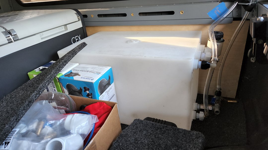

    I have a 15g tank in the forward PS side (this is an early designing phase picture):
    The pump/actuator is mounted to the bed side in a sort of floating mount style:
    For my actual use, I'm not sure the actuator is actually needed/useful.
    The PEX line runs to the back of the bed where it connects to a coiled hose. I have a toggle switch to turn power on and off at the back, as well.

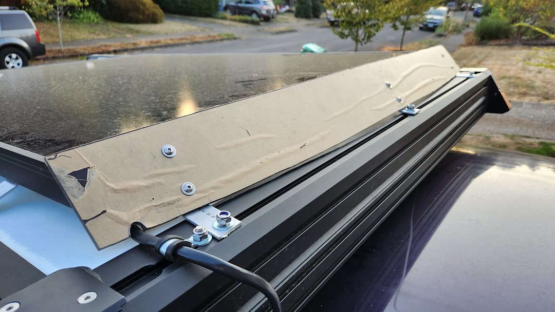

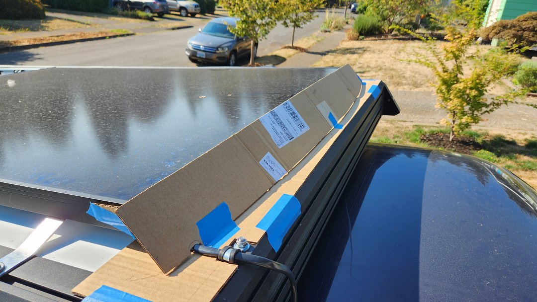

    A little fine-tune, finishing work in the solar panel category.

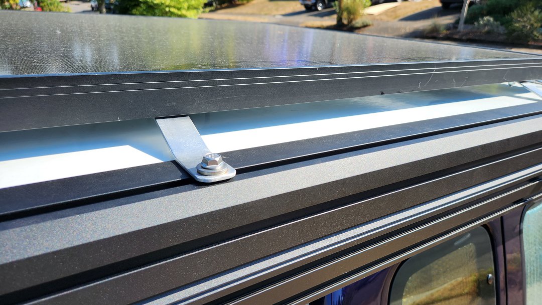

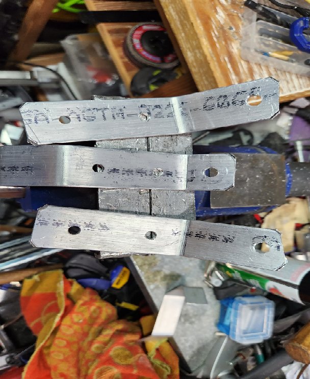

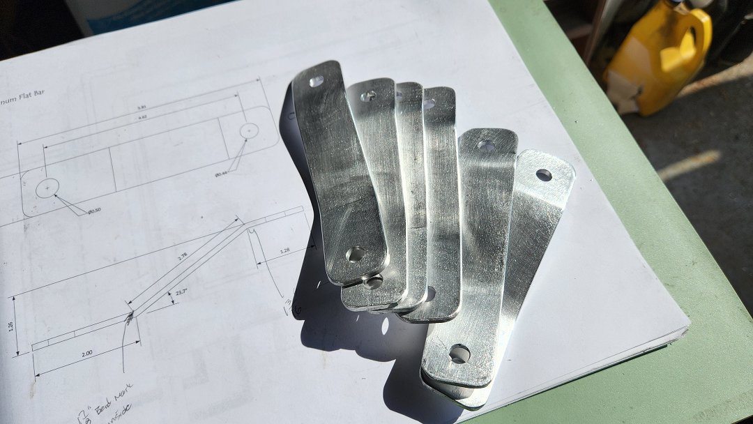

    1) I felt I made the steel brackets a little tall, plus noticed after coast trip the brackets were already showing corrosion and corrosion transfer onto the camper. So, I made some new brackets from 6061 aluminum flat bar.
    I am much happer with this mounting:

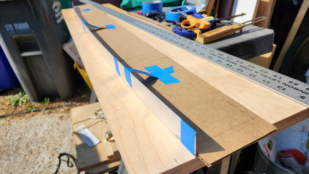

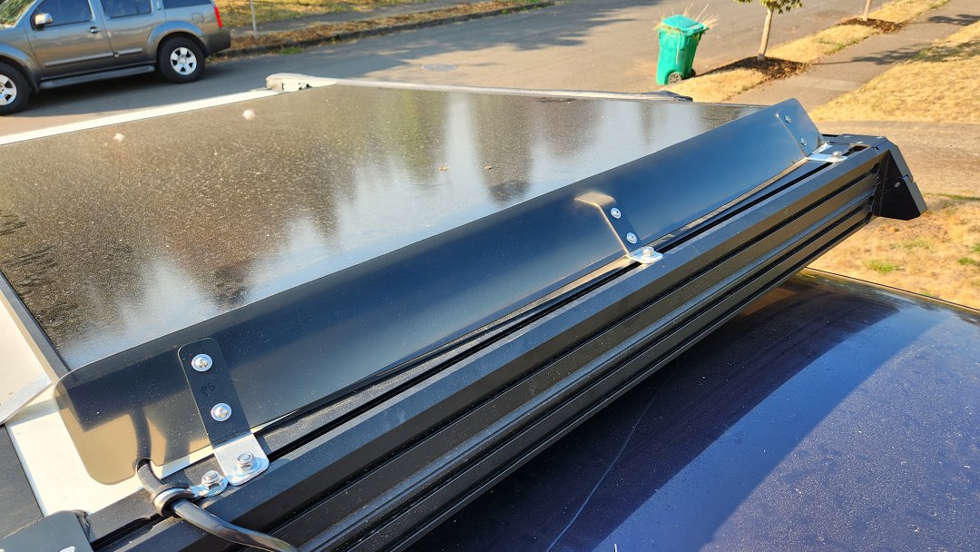

    2) I had been thinking about adding a fairing in front of the solar panel for a while now. I had not seen any ready-made ones that I liked, so finally decided to make my own version. Not so much for aerodynamics, but as a protector for the panel to guide obstructions over the top.
    I placed cardboard on top of the camper to be able to draw on, and cut a preliminary shape for the fairing.
    (Note: The initial bottom curve was made using the hood shield curve.)
    After position and curve were satisfactory, I needed to trace the shape onto a piece 1/4" plastic I had (would have preferred opaque, but this translucent piece is what I already had). The edge of the template was not smooth, so I stepped back to think about how to deal with this dilemma. Fortunately, I had a thin length of flat bar, so I taped it to the template and, voila', I could trace a smooth curve.
    Once the plastic was cut, I designed each of the 3 mounting brackets, one-by-one, to fit the curve and lean angle I wanted, and to clear my solar panel cable.
    With fitment work done, I cleaned up the mounting brackets.
    I will run this for a while and see how it goes, and see if any fine-tuning adjustments are needed. I may go and buy an opaque sheet of plastic later on.

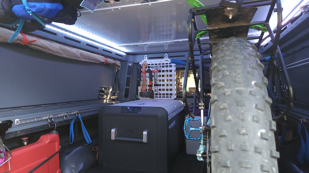

    Added an LED light strip circuit to the camper.
    Lights off:
    The strip circuit runs from PS side to the rear, then to the DS. Lights on:
    These are programmable, but the feature I was looking for was the remote/phone app control and ability to change color.

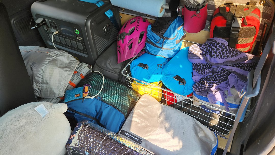

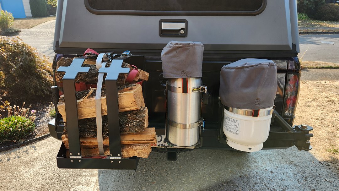

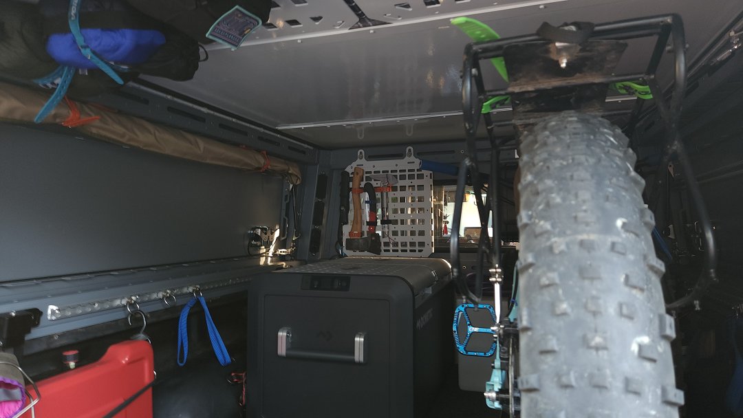

    Just back from a 2-night trip, home just ahead of the rain. Testing the use of individual storage pouches as a flexible storage solution. Also, that big, wire basket is a Wald bike basket in temporary service. By separating out gear/clothes, there is a fair amount of storage space without encroaching on nor affecting the performance of the power station.
    Also, since I wasn't going to be super remote, rather than carrying gas, I used the carrier to haul some firewood. Unfortunately, the wood never left the carrier as there was still a fire ban due to our drought season.
    Also, the truck looks good at sunrise:

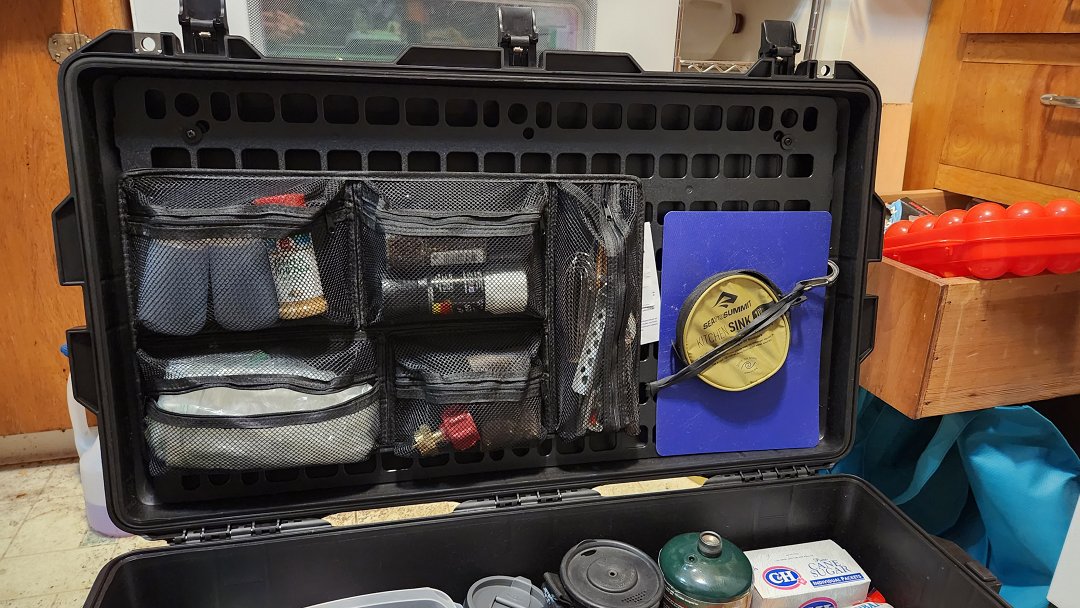

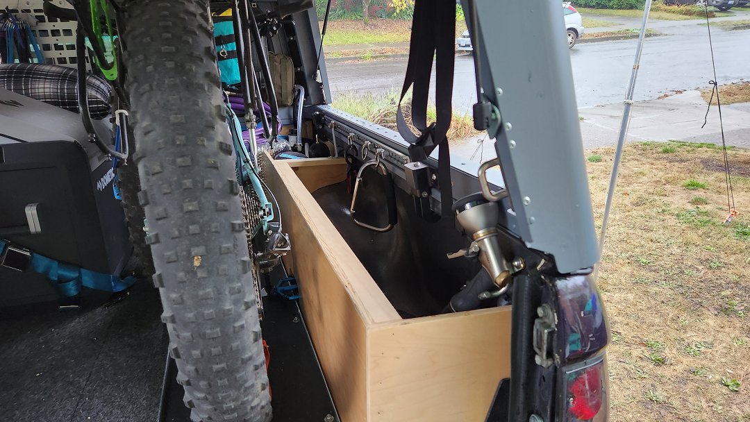

    My aging brain failed twice to order the right lid accessory for my Pelican 1615 "kitchen" case, so I modified the panel one to fit, then attached the other pouchy one. I'll run some shock cord to allow me to attach additional items.

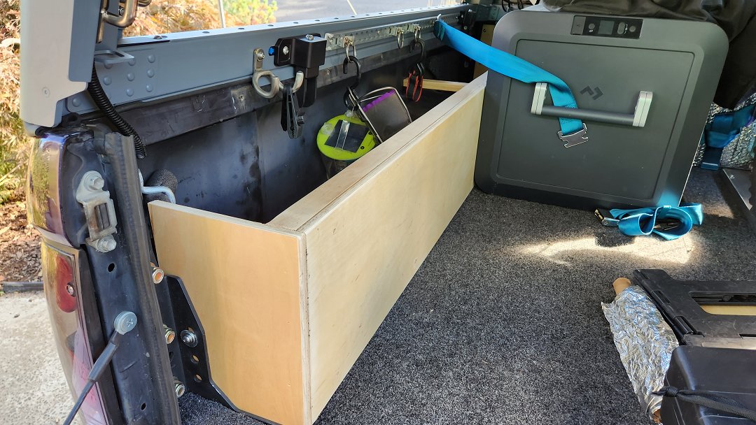

    To help with clutter issues, I took some left over wood pieces and put together storage zones on both sides of the truck bed.

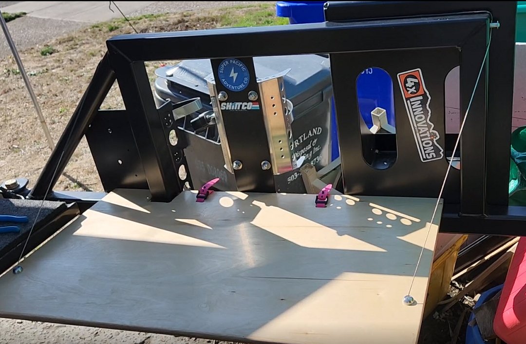

    I also made a few improvements to my "temporary" swing arm table, using shelving cable hardware.
