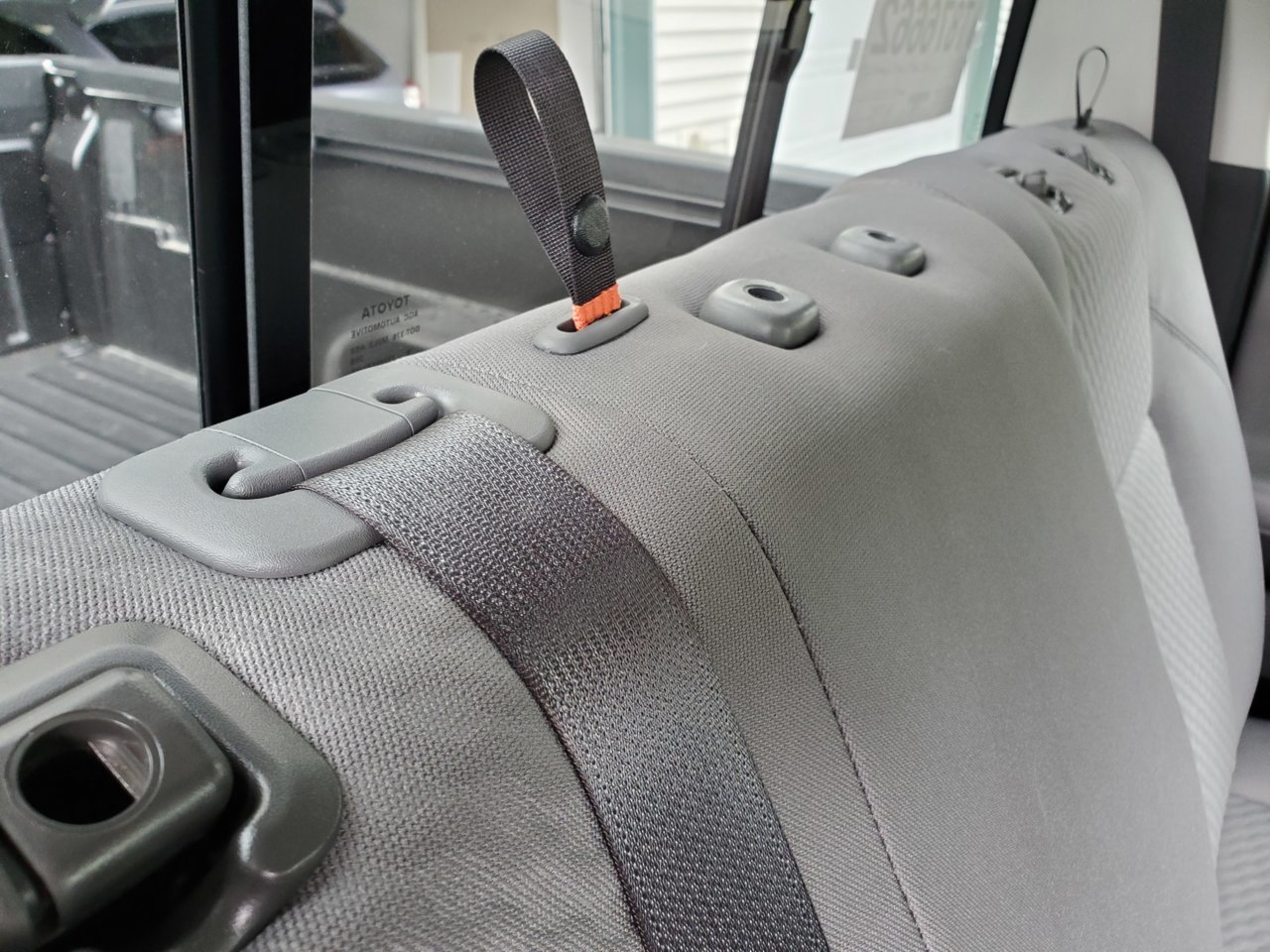

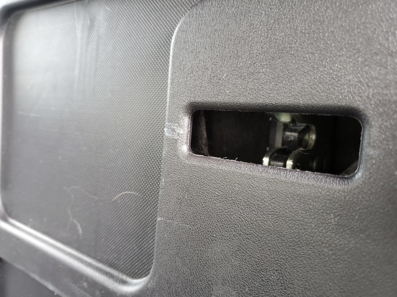

    I got mine to latch. I leaned the seat forward to access the latch and cycled it manually. Then pulled the release tab. After two or three cycles it was functioning properly again.
    Pics of issue for reference.
