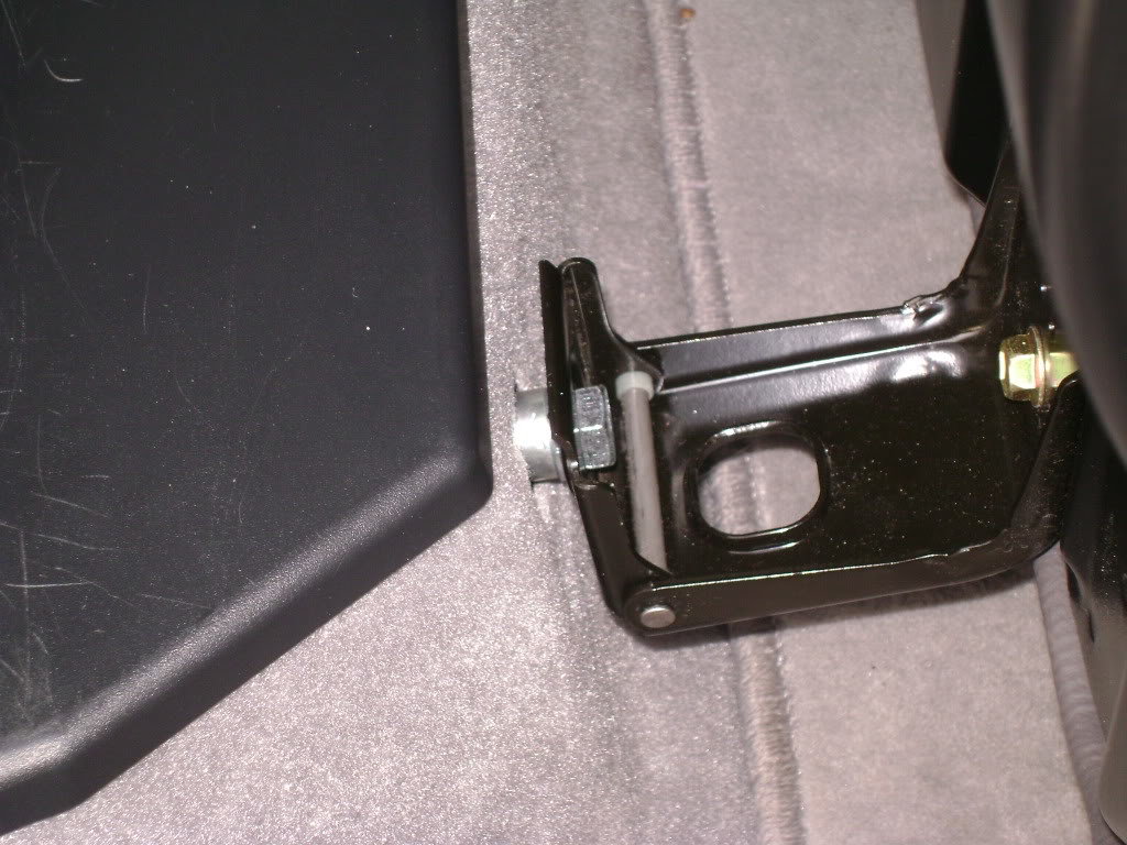

    I moved the seat bottom forward 1/2", and the seat back 3/4", using 3/8" spacers and longer 10X1.25"X45 bolts. The trick however, is extending the U-brackets bolted to the back of the truck which lock the seat backs.
    I picked up some 5/16" round bar, and extended my brackets 3/4" by cuting and tig welding. Cleaned up the welds a little, primed and painted them black. Havent uploaded any pics yet to my photobucket, so I just uploaded a single pic and attached from my pc.
    Keep in mind the brackets dont have to be extended at all, as the seat backs still lock in place with the stock brackets even after being moved forward ...however I require a clean 3/4" additional clearance top and bottom for my application.

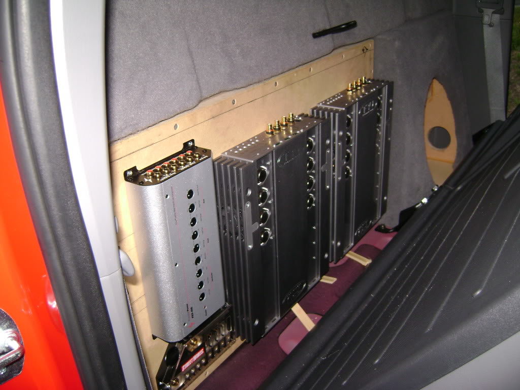

    Here are a few more pics...I also notched the center seat bracket to allow additional clearance for amps.
    The used the paint sticks to help keep the rack in place for pics, as I havent secured it yet...these are all in progress pics.
