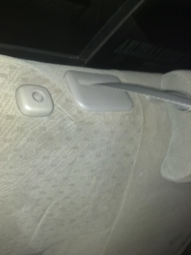

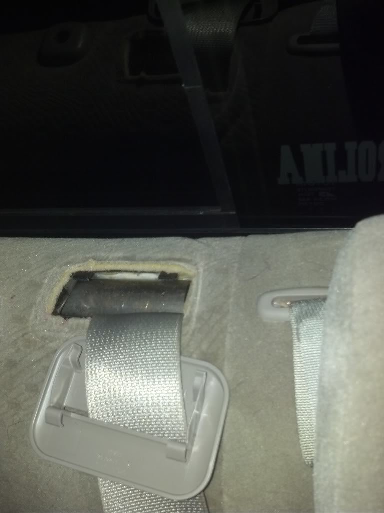

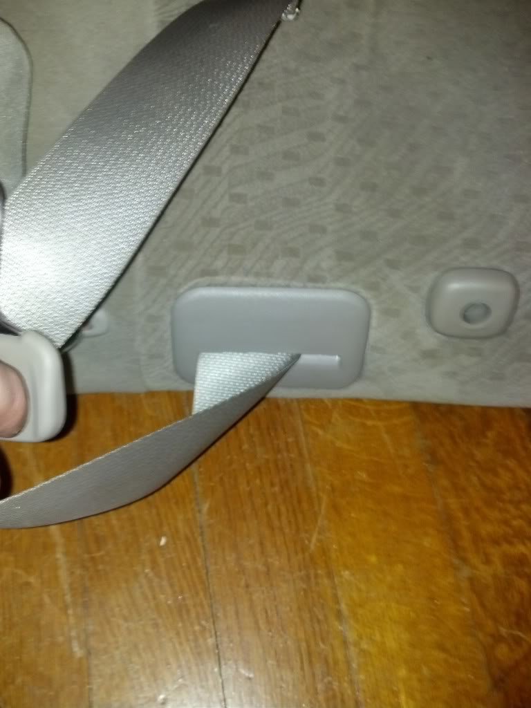

    So my gf somehow got the seat belt doubled over twisted and stuck...while trying to fix it I pulled the guide out of the seat...i have tried to get it backing place the only way that it looks possible...(clip the hinge in fold it down and try to push it rearward) but I can't get it to go...on several attempts approximating 2 hrs I cannot get it back in...I'm thinking I gotta pull the seat and the upulstry to fix it...or if anyone knows a better way or if this something that is covered at the dealer for free since this is a "safety restraint"
    Pic:

    should it look like the one next to it?

    No...its the only shoulder belt in the truck like that...it should look like this but flush...

    You can also see that the discoloration is on the side pieces. Not on the rear tabs. That would seem to me like you are not pushing it far enough forward before pushing down. The way the rear clips are made they will flex while you push down then snap out to secure once its down below the clips. Make sense or you still need a video of someone pushing on the cover?

    I looked online a little and it looks like the two back clips clip under the two black metal pieces sticking out then the front should pop in :notsure: just trying to come up with suggestions

    What I was saying is it looks like those side pieces are turning white from flexing. So those may be getting in the way, or hitting something to keep it from snapping all the way down correctly. Either way your doing something wrong, it should just snap in and does not require disassembly of the seat

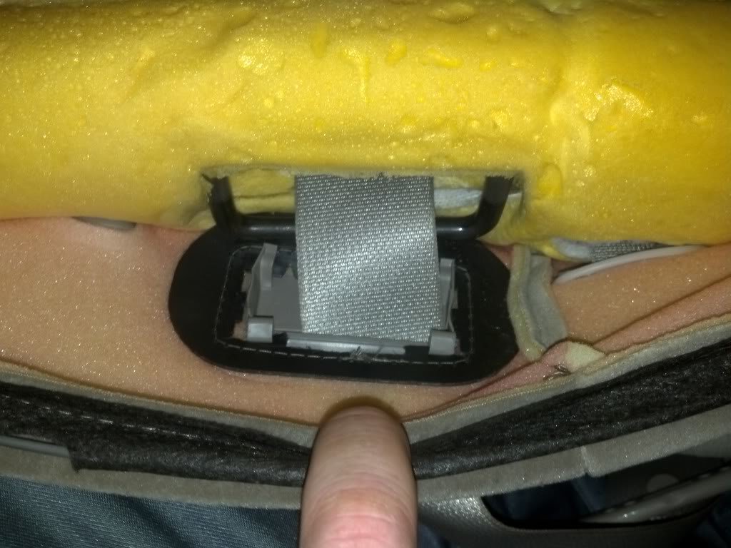

    There is a firm plastic piece sewn to the under side of the cloth, which is what I thought the cover should clip in to, but upon further inspection I'm betting it actually clips right down to the metal, and the plastic piece is just a space filler.

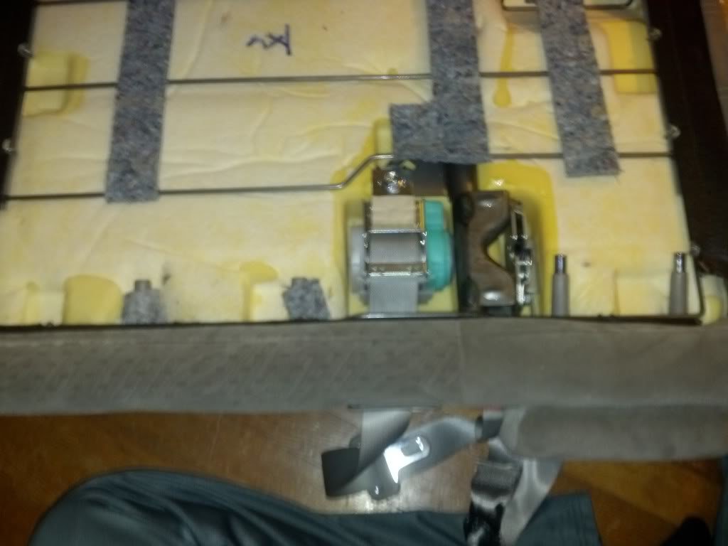

    Guide popped out:

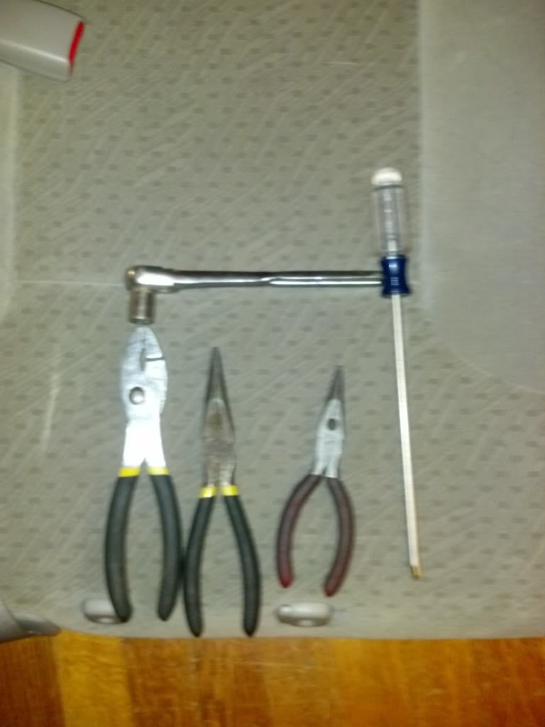

    Tools I used to fix it (2 needle nose pliers, 1 reg pliers,phillips screwdriver,14mm socket):

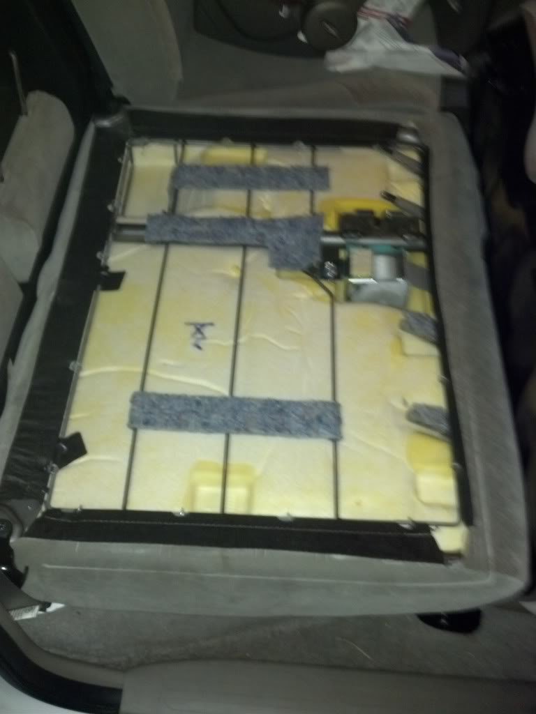

    I removed the seat:
    fold seat up
    remove 14mm bolt holding seatbelt to floor
    fold back seat down
    remove 2 covers (1 on each side of seat near hinge)
    remove 2 14mm bolts
    *note i had already removed the rear cover which has 3 phillips head screws 2 behind the corner covers and 1 in the center

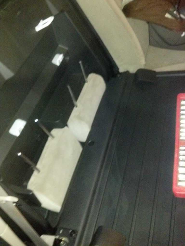

    seat back removed (remove the 3 phillips head screws lift up and slide down):

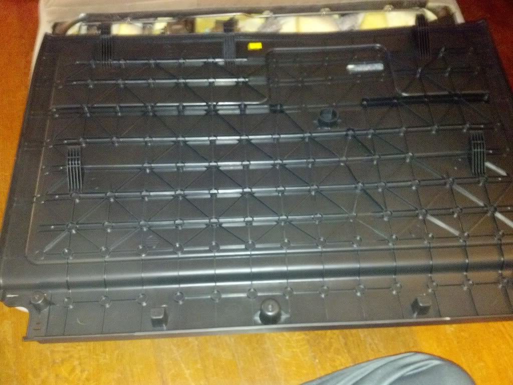

    this is what the panel looks like:

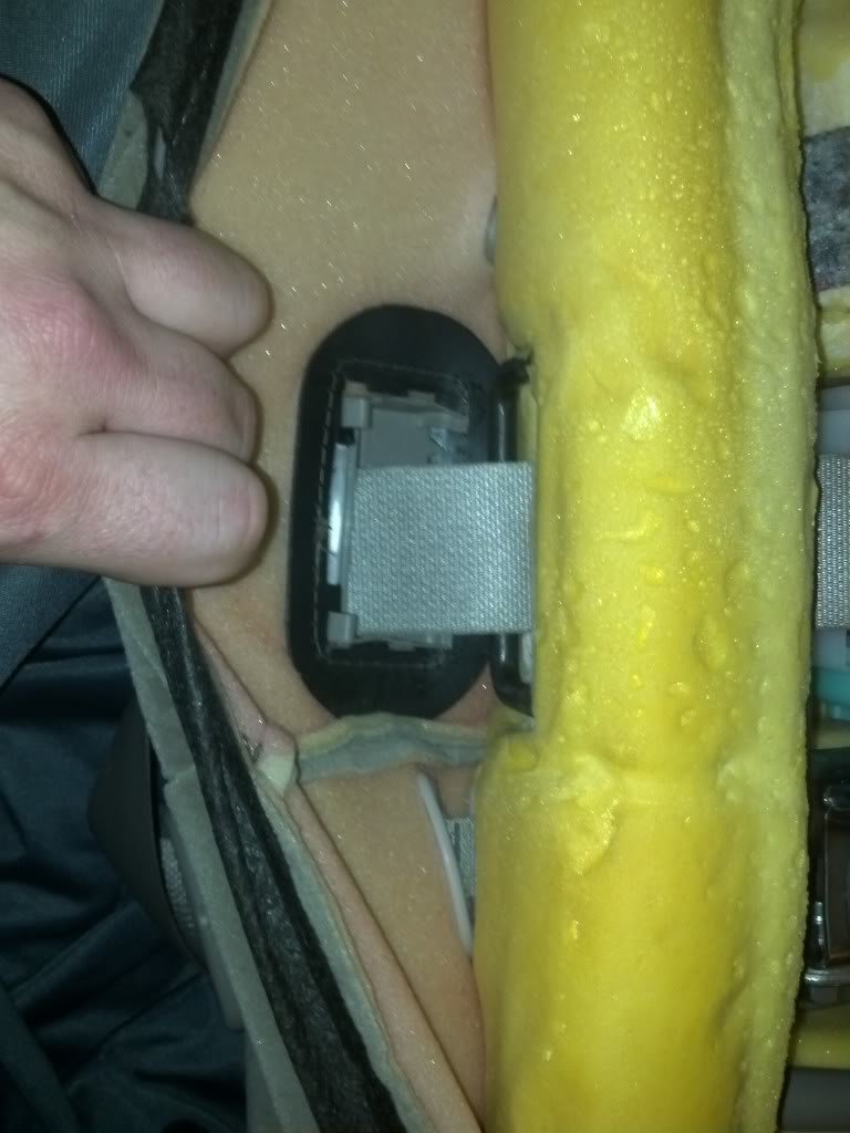

    removed the 5 hog rings using 2 needle nose pliers:
    material pulled back and guide installed:
    put everything back together:
