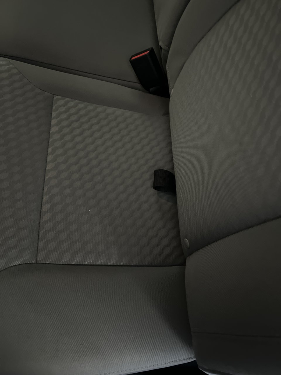

    Just a little DIY...took a nylon strap off an old soft side cooler...cut it 15 inches and folded it in half...secured it with a screw and VIOLA

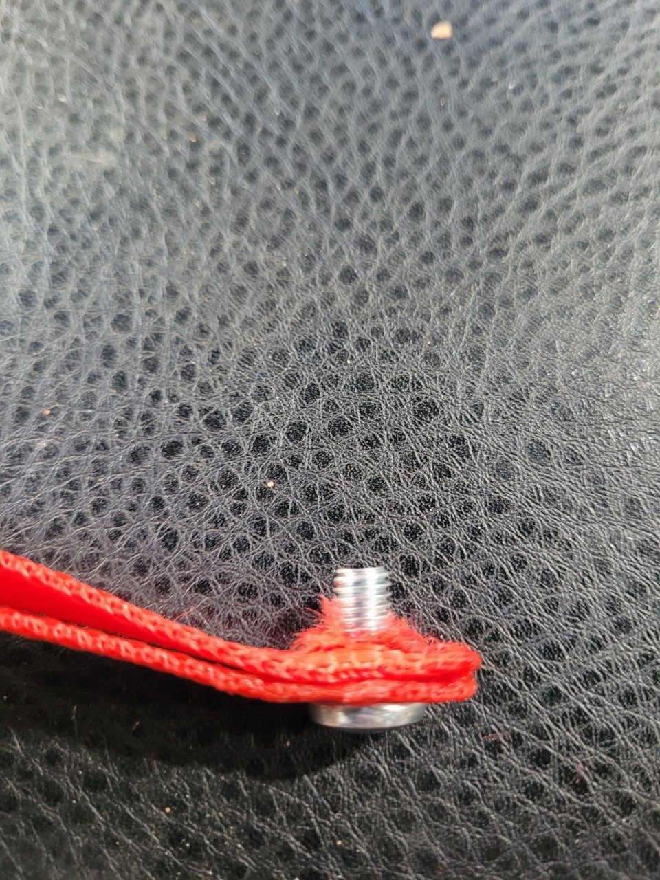

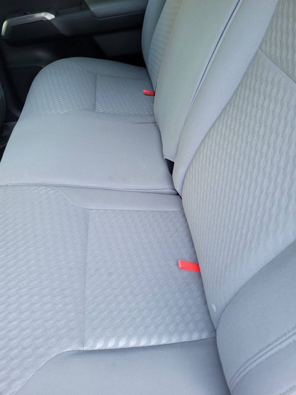

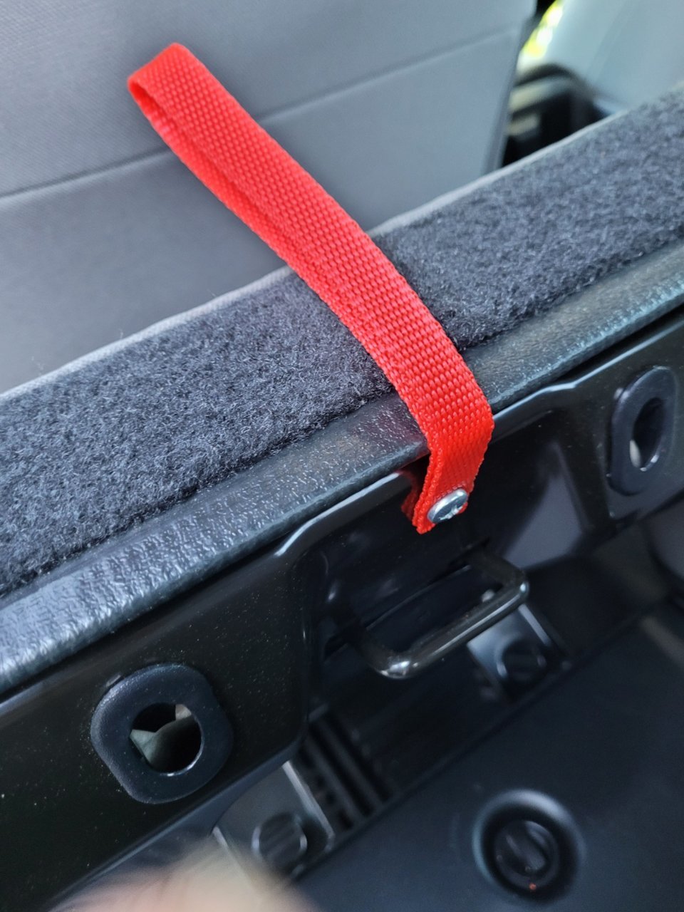

    I used leftover M6 bolts from a TV mounting kit, and bought 15' of 5/8" red strap from the dollar store for $1.50 (dog leash). I cut two 14" pieces, poked a hole with a punch, and carefully made the hole bigger with a blade of a scissor. Once the bolt was fed through, I used a lighter to seal/tighten the fabric.
