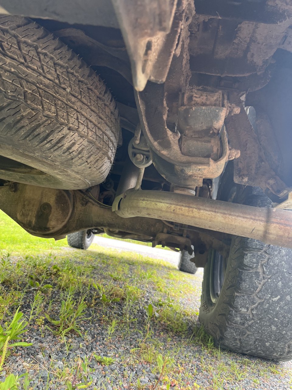

    So I've been driving around with the passenger rear shackle hanger for the leafs bent inwards about 2 inches for about a month. In order to get my truck aligned and get new tires, I need to fix or replace the hanger. the problem is this:
    I can't order it OEM
    I can't order aftermarket to where I live in Canada
    I have no idea how to effectively bend it back into place
    The prices in the US are $500-$1000 for a pair (they won't come singular), and that's before our taxes here, the dollar exchange, and the shipping and handling fees, even if I could find a place to ship them to me. Anyone got any ideas? I'm at a total loss here, and confused as to how I am unable to buy an important truck part here in Atlantic Canada smhR.jpg

    The hanger is bent inwards towards the spare wheel under the truck from its original position, causing the leaf springs to sit partially twisted

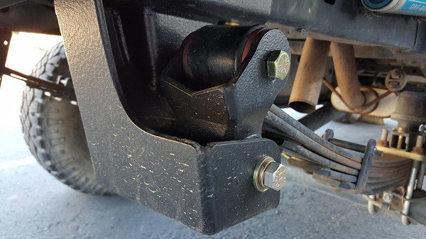

    I guess the pic may have been misleading in the OP. That pic is just for reference from Google images. I still have stock hangers, and can't even find Rago or other makes for hangers here, nor will they ship here. I'm at a loss on what to do. Not even sure if I'd be able to bend them back lol

    I guess it’s actually bend outward, not inward. Not sure if you guys can tell from this picture. I live in Nova Scotia Canada, so American shipping is spotty up here

    Yup, I was like “ how the fuck you bend a fabbed hanger” @zippsub9 seems to be your best bet.
