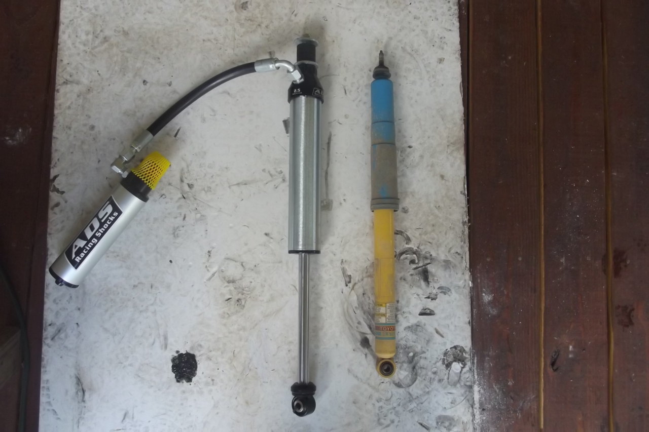

    probably not now that you point it out, probably more like 26", if you look at the length of the stock OR Billy's (in the pic) they are like 24.5" so the ADS is likely 26"?

    Still waiting on ADS, but just found the stock shock is 22.94". Just eyeballing that pic puts the ADS around 25.5"-26"

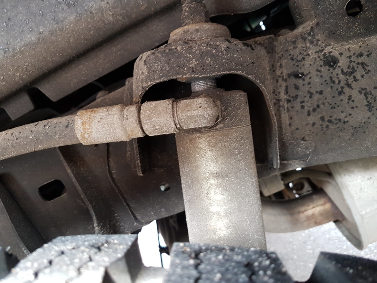

    Ya that's how it is for mine. But on a hoist at the shop I deal with it dropped more
    Regardless this is what over extending did to my Fox lol
    It's since been repaired and the mounting eyelet on the bottom was changed to get me more length .Limits up travel but since I'm all slow speed crawling I just needed the droop.
    With the longer eyelet I'm now about 5/8" too short to match Dakar.
    Haven't had an issue since the shock was fixed .
    Even the shop I deal with we werent sure if this was defect as it's only one side that broke and the other has been checked numerously. Never had an issue so maybe it was just defected from factory not enough thread lock and it came loose and broke . Or the over extending broke it .or mix of the two.

    Not sure I’m seeing it. It pulled the rod out of the top more?
