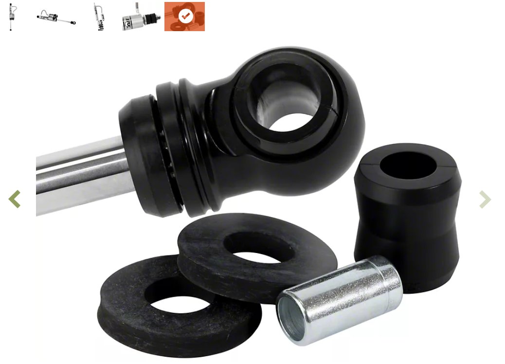

    Got my shocks and they were like this -
    Went through another vendor and bought the appropriate bushings, replaced them, and as easy as that I replaced my rear shocks as it was a 10 minute job.

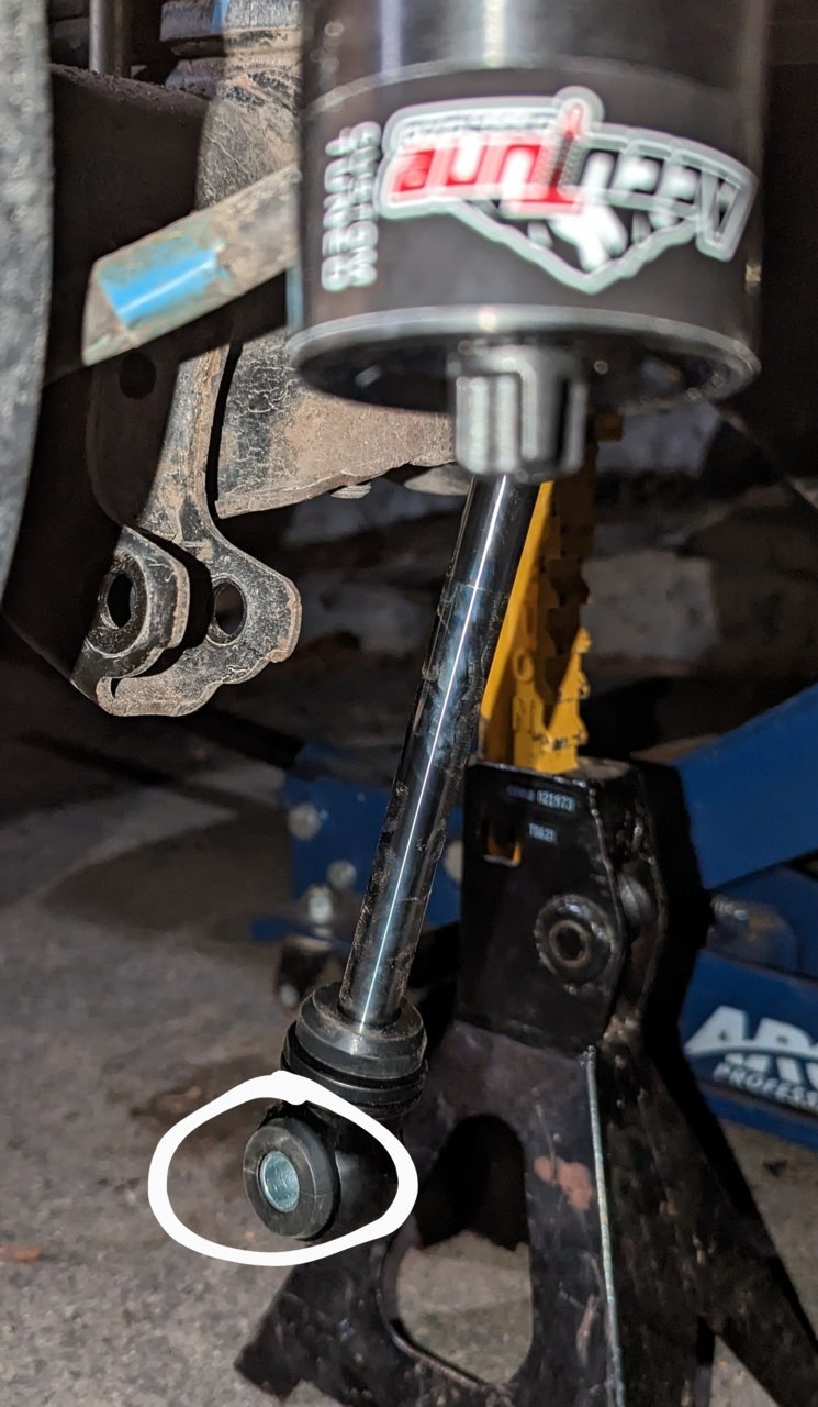

    The circled piece made it where the shock mount was too skinny for the shock. If I understand what you're saying I can possibly just buy the appropriate bushings and it'll fit?

    Google search shows what your vehicle needs; did you look it up?
    Coincidentally enough my old Tacoma needed the same hourglass bushing as well.
    Simple enough to replace.

    Called accutune, they said sometimes Toyota over torques the lower shock mounts and they get pushed together. Accutune recommends taking a razor blade to the bushing as they say this happens all the time. I'll work on it today, thanks accutune!

    Nice, was completely wrong myself on this one. But hopefully helpful for a 1st Genner that comes across this based on what I shared.
    It's interesting that a little clean-up doesn't allow the fitting of said bushing into your shock mount.

    I’ve had that issue with a few fox shocks. The inner sleeve is usually the correct width so I just sand down the bushing a bit so it fits properly.

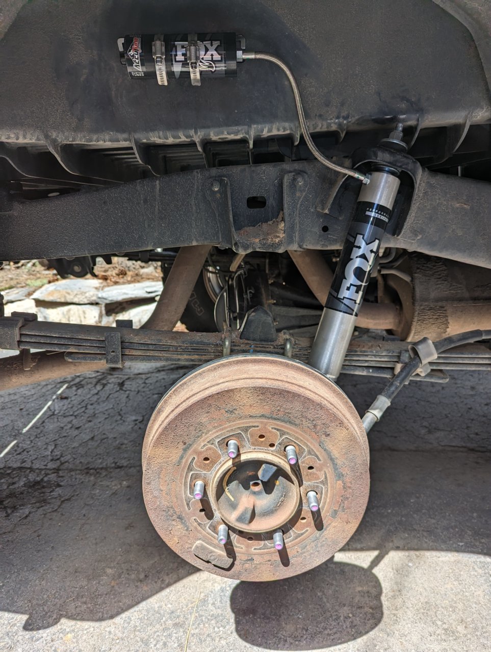

    Got it installed

    That’s an interesting place to mount the reservoir.

    Pic from inside the bed?

    Not the prettiest, I'm going to cut off the end and throw a nut on it

    Oh no you didn’t!!!!! I have the same rear shocks. I’d probably remove the resi and mount it on the frame like they’re designed.

    Meh it's alright. No performance differences lol

    Until one falls into one of the rear wheels.......

    If I put a locknut on the back of that bolt it's going no where. Tire doesn't rub either
