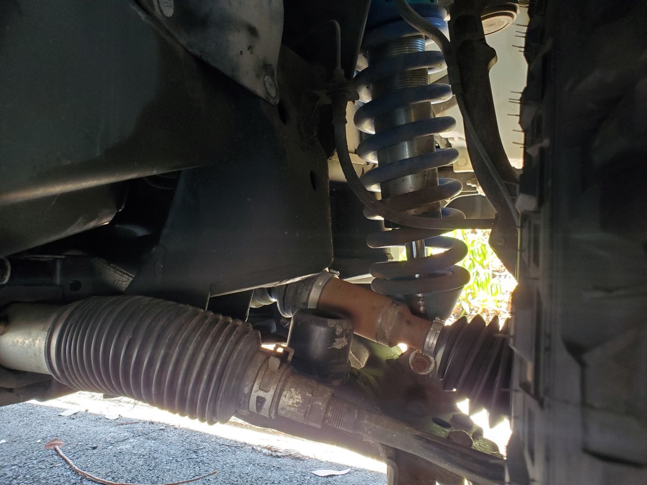

    The Wheeler's Super Bumps I used -

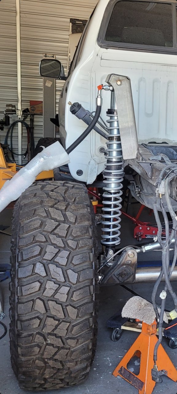

    These are longer than stock shock absorber replacement :anonymous:..... they fit and function just fine.... bought them from Amazon :rofl:

    Lol... when I decide to finish my 1 y/o project

    Durobumps are definitely nice; use them both front and back and dropping off rocks and ledges sre crazy soft and cushioned -

    Not to thread jack, but how did you like the fox 2.0s?

    Loved them when I ran weight in the back; they're the universal shocks that are half to an inch longer than the pair made for Tacoma's
    I'd pull them off and put in my Bilstein 5100s when it was time to run without the RTT and bed rack.
    Loved the flex paired with the Dakar's.

    That is a whole lot of yota you got going on there 02hilux!!! Bad-ass!!!
