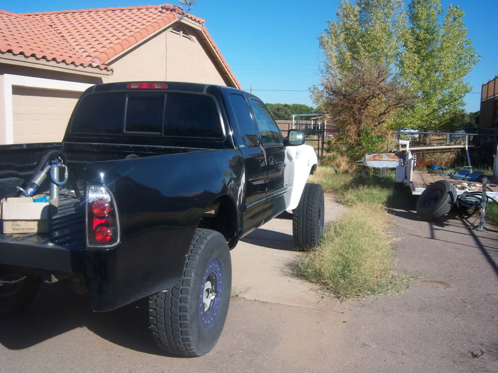

    100_1791_132bee2a33a96da1d7b88fed6c802f04a94dd57c.jpg hey guys i have a question.
    about how the tabs are built on the rear hoops, how bad is it to run that kind of a setup, and why?

    ^^^^^^^^does no one know if it is harmful to run the rear shocks in this position?^^^^^^^^^^

    yes it is because the shocks articulate front to back so the way they are pivoting on this is terrible! as you get air or articulation form the rear axle, the assembly moves towards the front as the rear gets higher, IIRC it motion is like /
