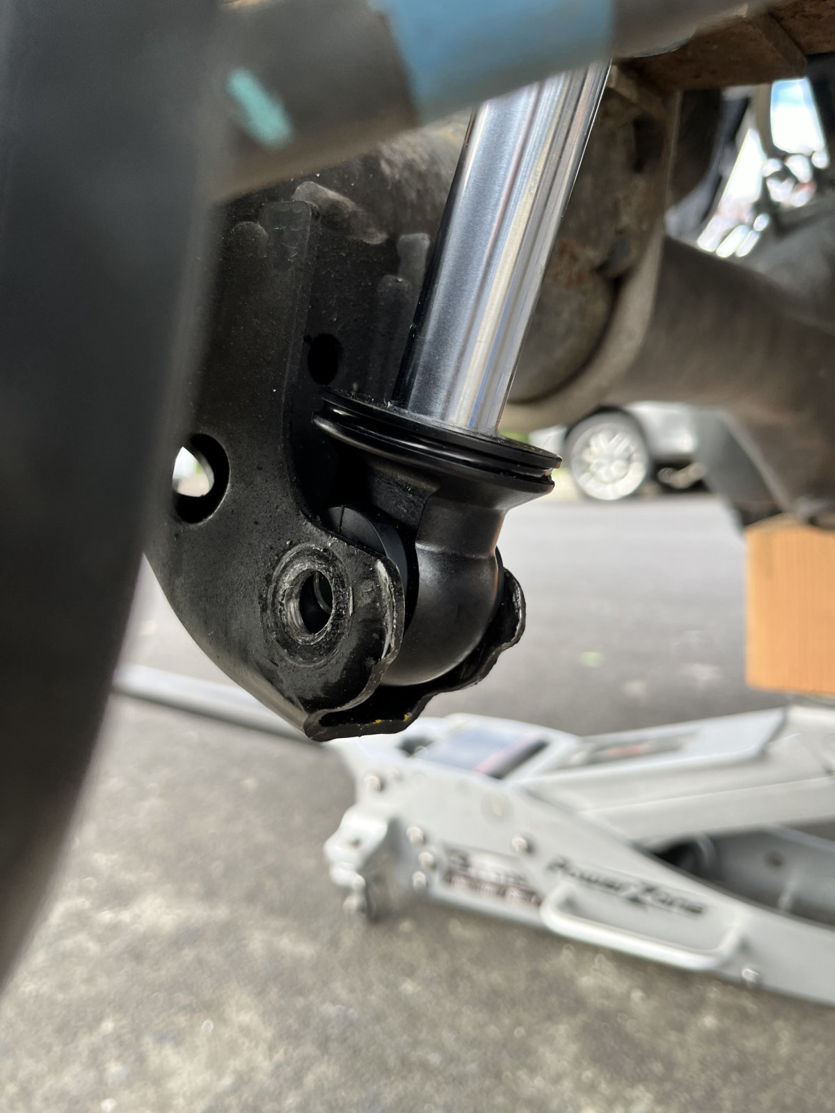

    Strap worked like a charm you bunch of geniuses. Now the problem is the bushing on either side is so large it wont decompress to the level of the eye. When I jacked up the rear end it just compresses the shock lol

    If you have some silicone paste or any lube hell even dish soap pop it out and lube it up and pop it in again?

    Gonna have to trim that bushing.

    I'll try to apply a thinner cylinder to the eye to see if it will line up. Will keep your posted. Thanks again

    Absolute insanity boys. 2 screw drivers, mallet and an allen wrench later I managed to align the eyelets. The bushing on the medial aspect of the bracket was bulging through by a lot honestly. Used a dremel burr to cut the excess. I have no idea why fox's 2.5 bushing are so large for this application. Compared to my previous 2.0.Looks like theyre twice the size on each side. Anyways end in sight. thanks for all the help again.

    I'm aware of the bottom bushing being much wider (like you experienced) on the 4Runner rear shocks compared to the Tacoma's; people often buy 4Runner shocks to put on their Tacoma or vice versa.
    You got the correct shock right?

    For what it's worth, I installed the Fox 2.5 PES a couple years ago now. Believe I was one of the first to get them. Ran into the same issue with bushing rubber being too large and had to shave off a small layer with a razor for them to fit (even after spreading the shock mount apart with a brass drift to make it wider and lubing the hell out of them, just wouldn't fit otherwise and always rolled up the rubber). My leafs were able to fully droop out making it easier to line up because when they were brand new there was no way to force the shock shaft upwards with any amount of force.

    I have the same ones and had the same issue with the bushing being tight. Accutune confirmed Fox makes them larger like that. A rubber mallet got it in place but a little lube could help slide it in. I don’t remember having the problem with the length though.

    where was this post a couple weeks ago struggled to install my kings and ran into the same problem I used a 4x4 on top of my Jack and lifted the cab secured it with Jack stands and rear tires just in case. I was full droop at that point and I was able to get the shock in but I had to file down the mounting points so that rear shock could slide in, used a screwdriver to align it to the hole and success.
