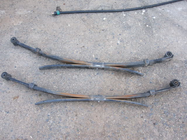

    Alright....so I flipped my helper spring and that gave me 2" of lift....I put in 2" lift blocks...my stock shocks have zero travel now....what have you guys used? I bought a set of rancho rs9000 for another truck but the collapsed length is to long? $100 down the drain but oh well....need some advice.

    What do you mean by "helper spring"? You have aftermarket spring packs?

    I think he means the overload spring? I have never heard of someone flipping this and giving them lift... but I just ditched the whole setup

    I believe hes talking about the very bottom leaf on stock springs. It's curved downward to help the suspension when bottoming out. turning it upwards would add a little more carrying ability and therebya slightly increased height.

    Issue with that is it adds strain on the leafs in places not originally intended. Thst could be a big problem after enough abuse

    Yeah thats what i assumed he meant too, the bottom, fat overload spring. I too had never heard of anyone doing this. It seems it would render the spring pack useless. Its not even really a spring, but more of a secondary bump stop.

    That is what it sounds like. However that would result in horrific ride quality. The overload is designed to flex minimally, whereas the spring pack is designed to flex. By inverting the overload, you are making it so the spring pack won't flex and that will make your truck ride like an unloaded dump truck. Awful.

    OP, take a decent photo of one of your rear spring packs, showing the 'flipped helper'. It sounds like you did a really horrible thing that should be un-done.
