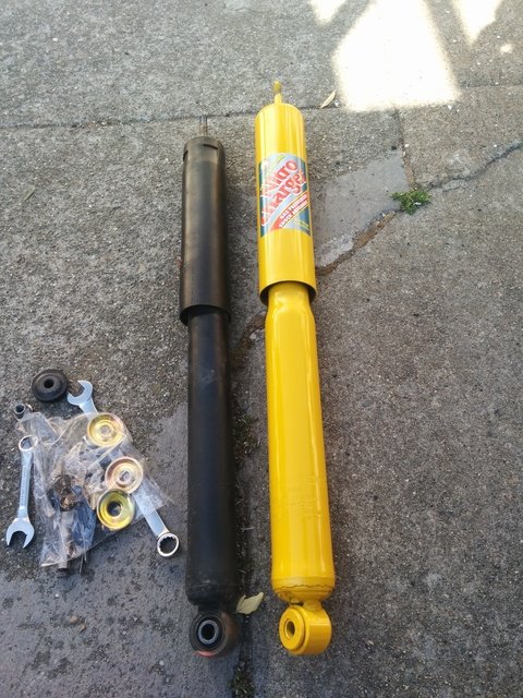

    Ordered OME N182s from wheelers, as tundra shocks have eyelets on both sides.
    For some reason, I thought rear tundra were similar to tacoma shocks (stud and eyelet).

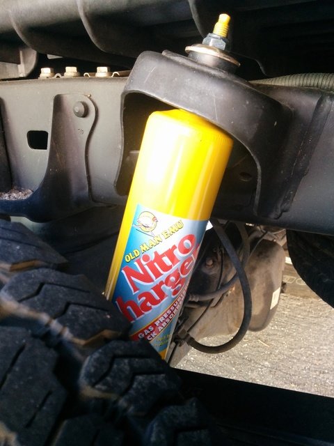

    New shocks are in.
    I think that was the last Suspension related item...I think :)
