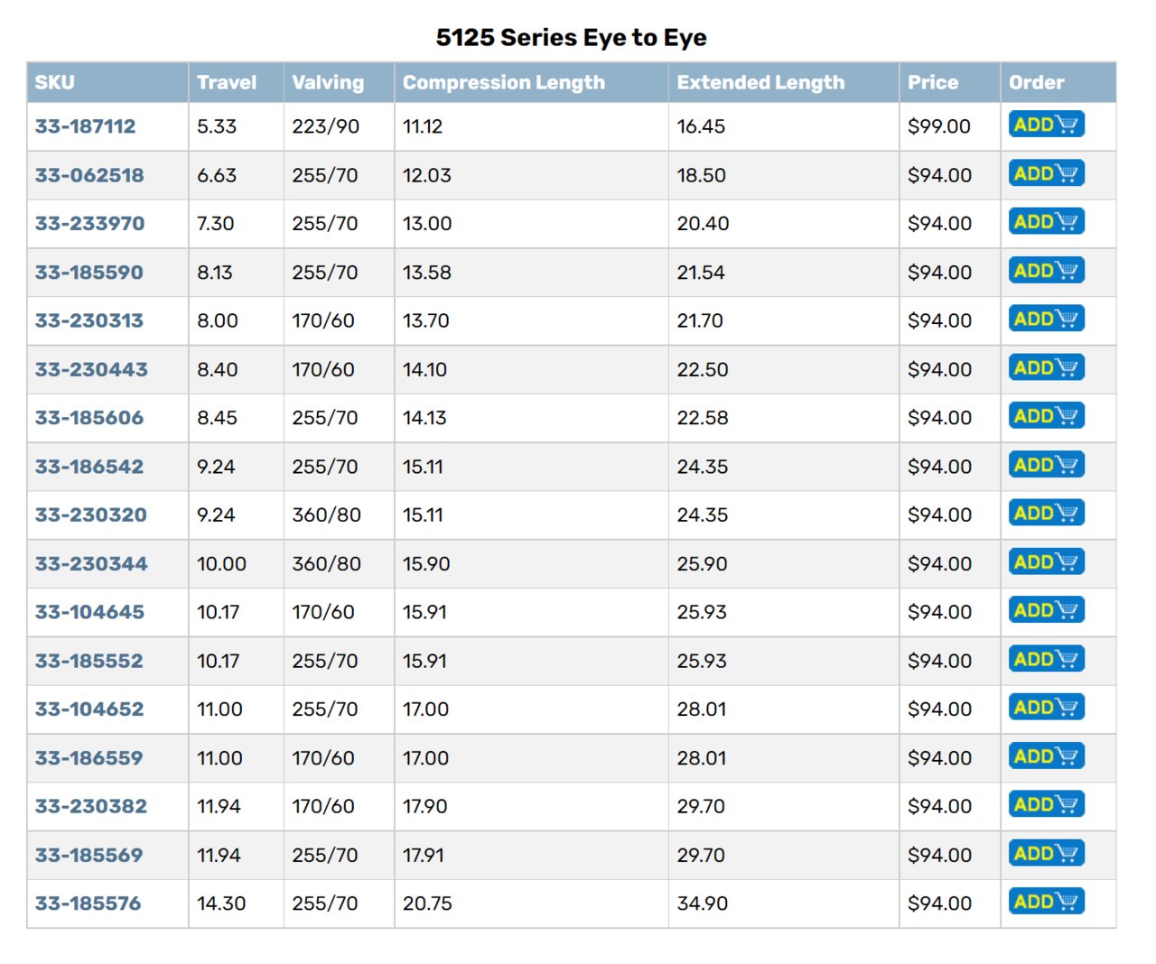

    33-247717 is the 5100 series shock for our trucks. That was what I installed on my truck 2 years ago. The shock you have on there now is a 5125 series shock. See this chart:
    You might notice that the 5125 comes in several different valving options. Depending on how you use of the truck you might like a softer or more firm shock in the rear end. I came across this thread a few weeks ago and swapped out my 5100s for the 170/60 valved 33-230443
    https://www.tacomaworld.com/threads/stiff-rear-end-after-lift-you-got-the-wrong-shocks.471164/
    For my uses I like the softer valving better, someone who drives on rough roads might like the 255/70 valving better.

    What site is that chart on? Wondering if they have one for 5100 series that shows same details.

    https://www.shockwarehouse.com/site/bilstein_5125.cfm
