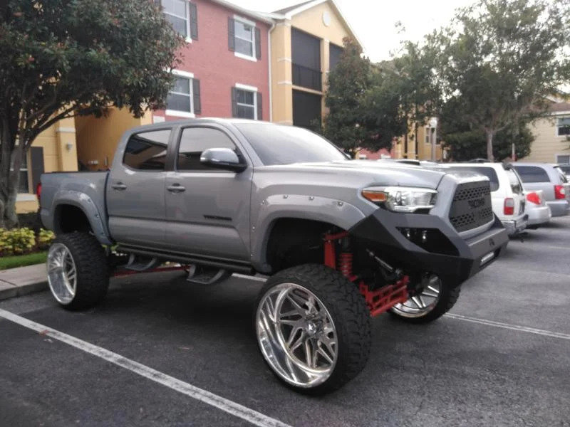

    post pics of the lift please. I need a good laugh.

    Its actually just a cinder block between leafs and axle :boink:
    And OP, who's that in your profile picture? 99% sure its not you. :popcorn: @4x4Runner
