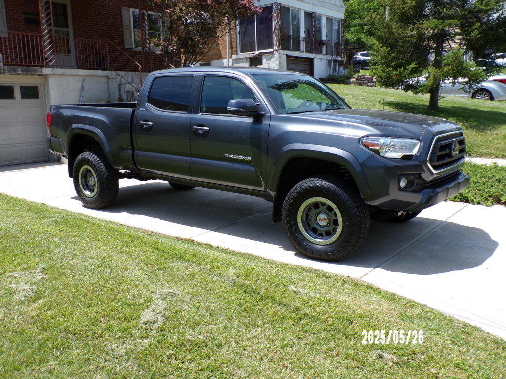

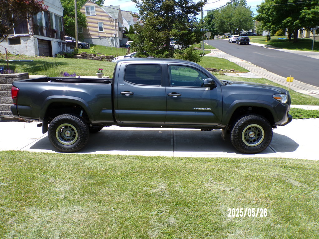

  18. May 27, 2025 at 3:40 PM
    #18
    Orphanbrg
    Orphanbrg [OP] WTF Just Happened?
    Apr 23, 2025
    #469972
    35
    Rick
    Erlanger, KY
    2022 Tacoma SR5 DCLB MGM
    Eibach Stage 2 Archive Garage MD 265/75R16
    Well here it is, worked on it all weekend. Thanks for all the input!
    Eibach Pro-Truck Stage 2
    Sway Bar Relocation Blocks
    ECGS Clamshell Bushing
    Archive Garage "Erikson" Medium Duty Springs Opt 3
    Bilstein 5125
    Nitto Terra Grapplers G3 265/75R16
