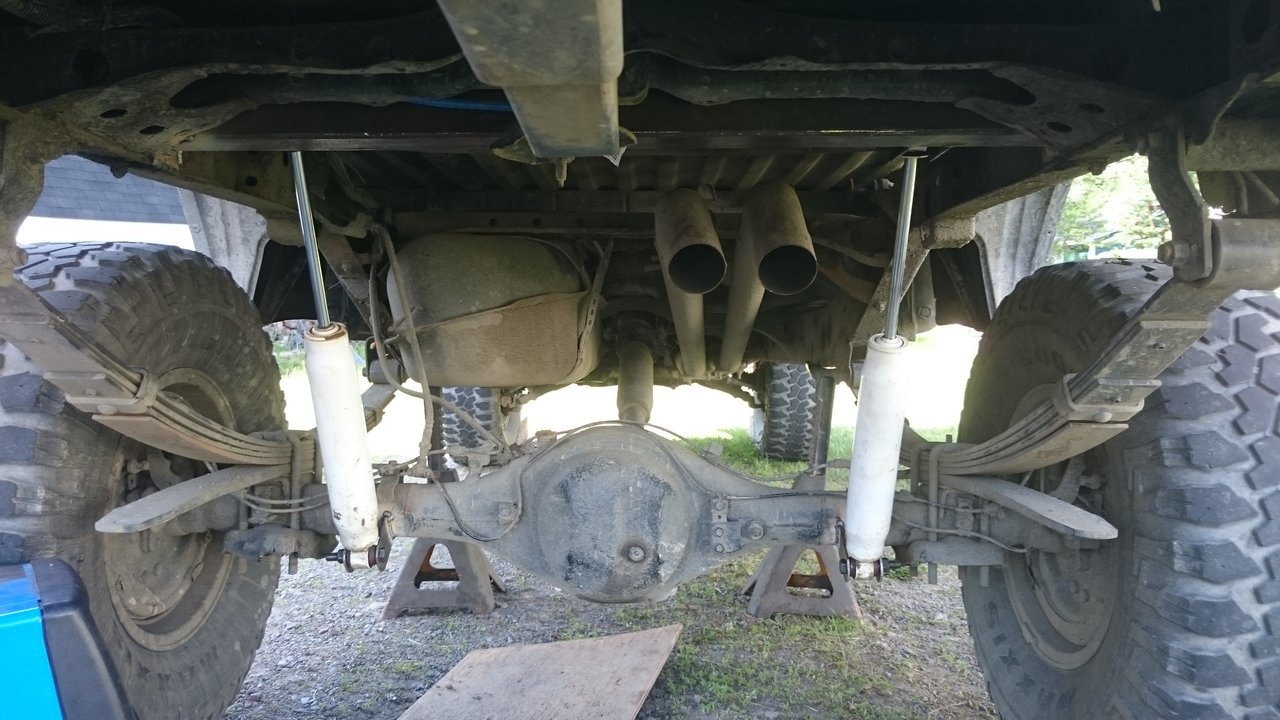

  10. Sep 11, 2017 at 3:50 PM
    devinzz1
    devinzz1 Well-Known Member
    Jun 28, 2014
    #132892
    6,997
    devin
    lewisporte Newfoundland
    2023 aclb trd or mt
    icon stage 10 kit, toytec 1" bl, 35" general x3s, 17x9.5 procomp wheels, locker anytime mod, s&b intake, blackhawk 2.1 tune,
    this took 2 hours and scrap steel was free.
    no i didn't break the packs down and cycle the suspension. i made sure the shocks weren't topping out at full droop and was planning to relocate bumps if they bottomed out. luckily the 10" stroke shocks worked out perfect with the stock bump location
    snowboard704 likes this.

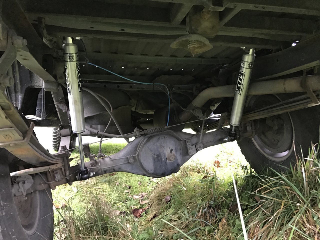

  15. Sep 11, 2017 at 6:04 PM
    Laxtoy
    Laxtoy Dog is my backseat driver
    Feb 14, 2015
    #148610
    1,352
    Maltby, WA
    99 3.4l 5 speed 4WD 2023 Limited DCLB 4WD
    Fox 2.5 DSC resi CO's w/ 700lb King Coils, Camburg uca's, T-100 rear leafs, 13WL Tundra brakes, 1" 4crawler body lift, 295/75/16 Hankook MT, Ruff Stuff u bolt flip, 10" Fox LSC resi shocks turned back on custom mounts, home built rear high clearance bumper with dual swing outs, Diode Dynamics SSC2 Pro rear floods, Skid Row front and transfer case skid, home built transmission skid, Mercerfab sliders, home built front bumper, Badlands Apex 12k winch with synth line, 4.56's, ARB rear locker, home built rack with CVT Mt. Shasta, eBay snorkel, Sierra LEDs 20" dual amber/white light bar, Diode Dynamics SS3 Max amber fogs, Mini D2S projector retrofit, Blue Sea ML-ACR, dual Odyssey PC1200's, 100 watt solar panel, 20 plate heat exchanger/home built shower kit
    I put my kit together from Ruffstuff. http://www.ruffstuffspecialties.com...t_Code=R2121&Category_Code=toyotaminitaco4run
    U bolt flip kit
    http://www.ruffstuffspecialties.com...y_Code=shockbracketstabs&Store_Code=ruffstuff
    There stuff is absolutely bomb proof. Shock perches welded to the axle tube and up top to a 1-1/2" x .120 wall square tube above the frame rails stuffed up about a 1/2" below the bed. Helps if you have a body lift, I run an inch so I have extra clearance.
    I have fox 10" rear shocks, still hardly get all the travel out of them. Still get a lot more travel than I did at the stock mounting points. I pushed them as far out as I could to keep the stock spare tire location, I can still get a 35" if I wanted, though I made a custom mount for that too to clearance it up another 2-1/2"
    IMG_4012.jpg Ride height after a leaf pack rebuild
    Kittenmittens4U likes this.
