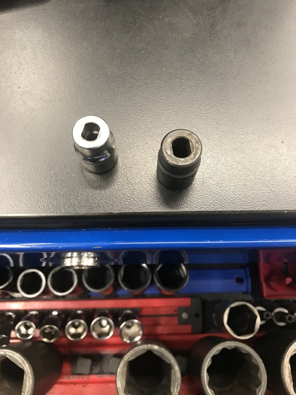

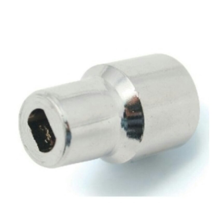

    Cut off wheel. There is actually a special socket for the top of that shock to hold it still.
    Liftbear[OP] and taco2010trd like this.

    That’s it

    your new Bilsteins will use an allen wrench to hold
    until then vise grips
