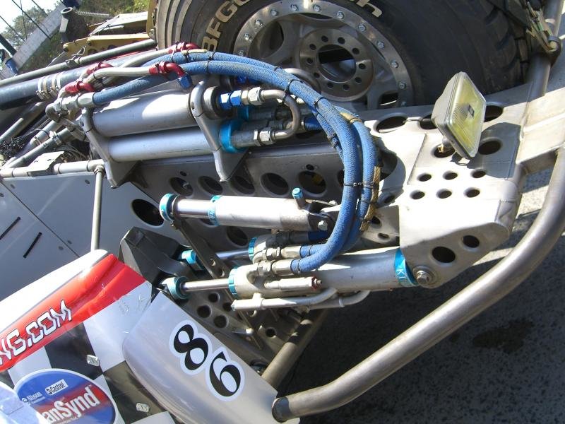

    Orientation doesn't matter on resi shocks. Lots of pro guys run them upside down and sideways with cantilever setups.

    In your case, you don't want to run the shock upside down off the axle because its easier for a rock to dent the shock body and cause more damage to internal parts, rather than a nick out of the shock shafts.
