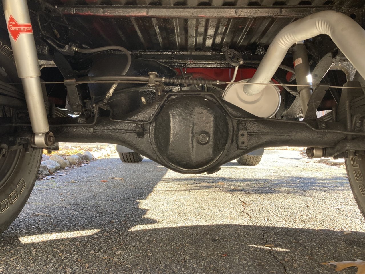

    My rear shocks are doing the clunk. They are only 8 mos young. Verified correct ones. This the 3rd? set over the past couple of yrs. I thought it was due to having munroes, however now I have KYB gas adjusts & my truck was happy for a bit.

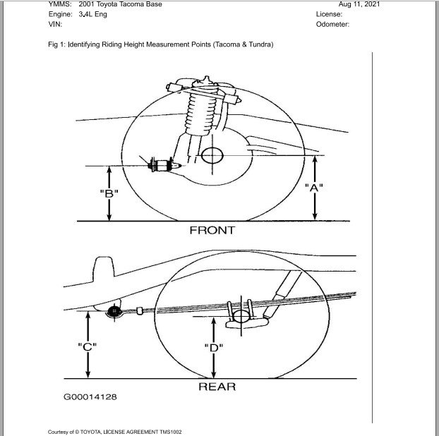

    Shock measurement on a flat surface, underload, left is 15” & right is 18”. Now I know that due to the varying angle thing there should be a slight difference, however 3” seems excessive. KYB’s are 13.98 compressed & 20.98 extended.
    Also, my ride height is 3.4”on the right & 2” on the left. However, front leaf spring eye to ground is the same-ish on both sides - 12” - left, 12.25” - right.
    my ride height should be 1.73 rear, 1.61 front
    & if it’s of any significance here, my front ride heights are low. Around 1”.
    The nuts on the leaf spring bolt brackets are uniformly tightened.

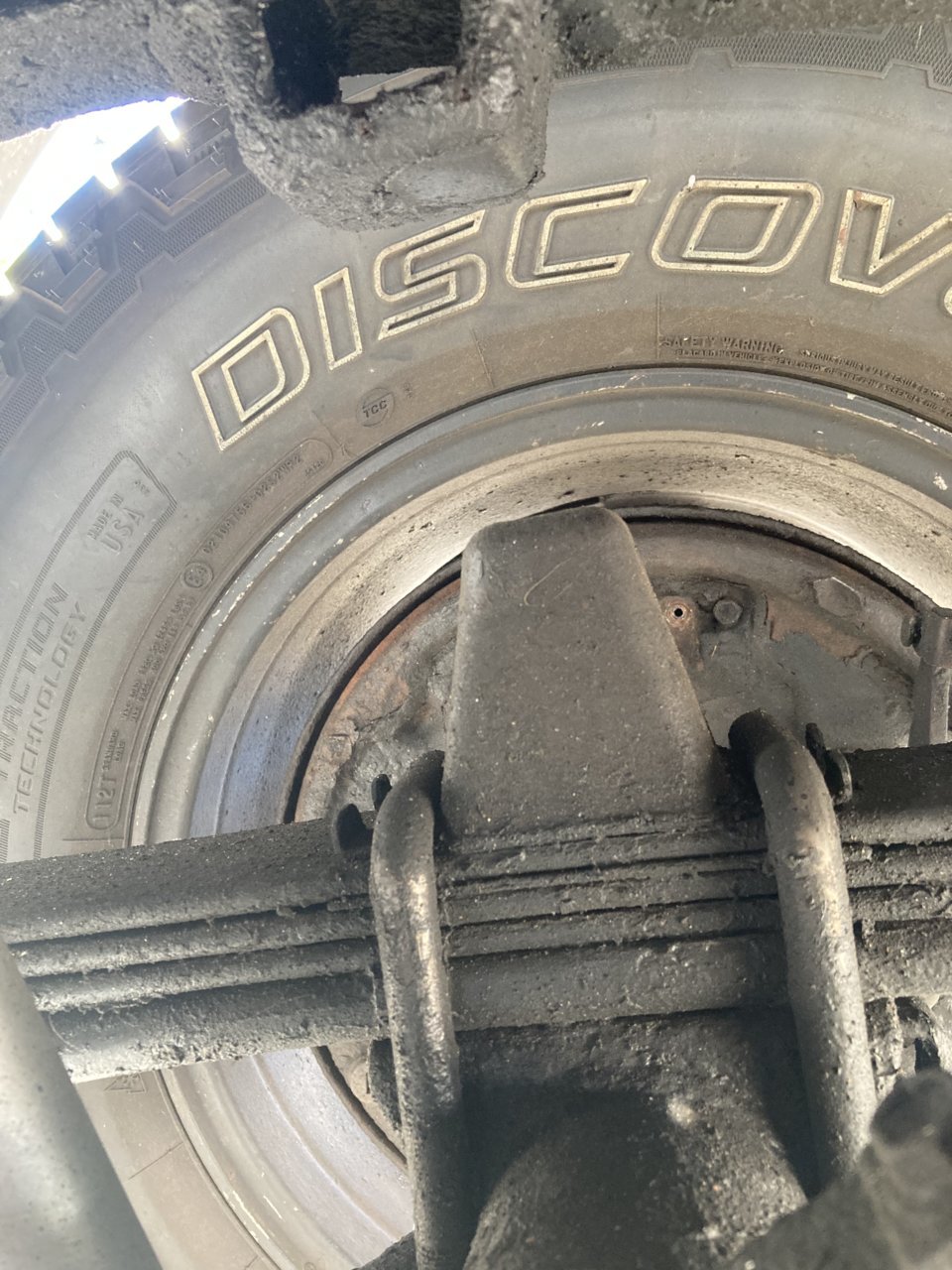

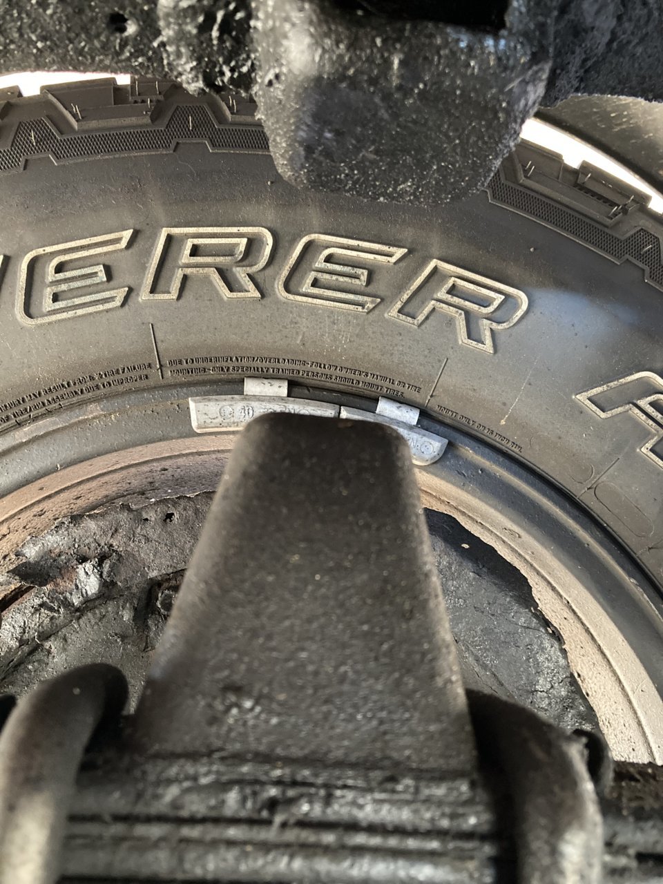

    The other weirdness is where the bump stops are sitting.
    Left
    right
    It is almost as if the rear axle is pushed back 1 or 2 inches or some such. This would cause the leaf spring perches to not center, which would also cause the left rear shock to be too compressed & the right to be overextended = uneven ride height numbers & burning through shocks.

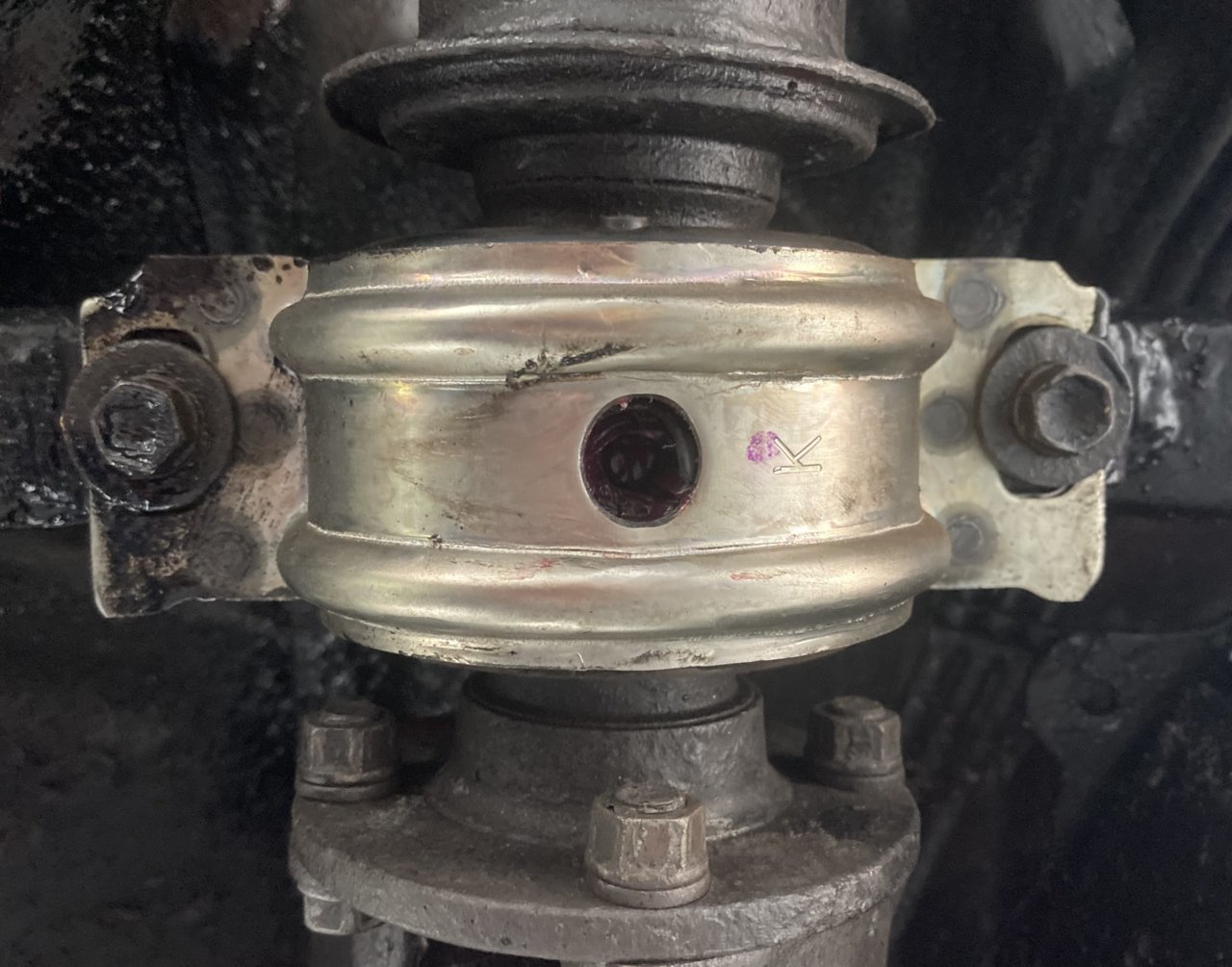

    I also have been getting a mild cyclical vibration, which I have read can be from an improperly angled driveshaft. I do have another thread on here in which I questioned the angles & was informed they were ok. I installed a new center support bearing, which was somewhat needed, but changed nothing as far as the vibe. This was before I started putting all of this together. (Shocks, both bump stops, etc.)
    Other than an axle angle adjust, I am at a loss. However that would change the driveshaft angle & I am told that is ok.

    Is your carrier bearing good to go?
    Driveshaft, any and all points greased/lubed?

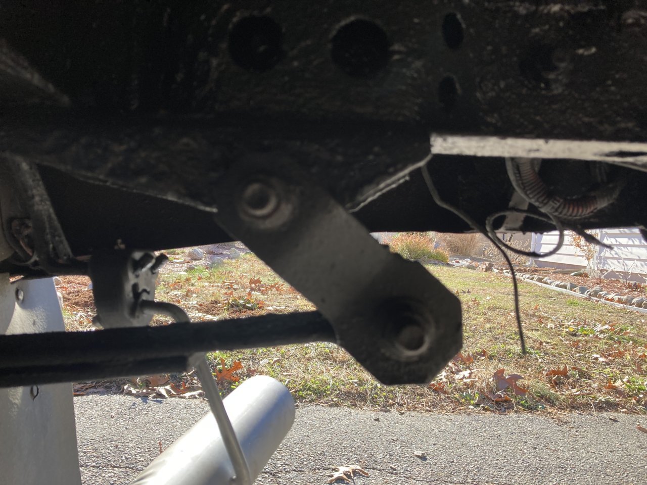

    Just a thought, did you check the leafs and shackles really good? I had a clunk in the back of my 01 TRD it is was a broken leaf in the spring.
    Also, you are aware the right and left rear shocks are supposed different lengths?

    KYB is one that doesn’t differentiate between a left & a right. They self adjust.
    bushings are still in good shape.
    To me it’s more that something is causing the perches to be off, back too much so to speak. If you think about the way our shocks are positioned, this could cause the right shock to shorten too much & the left to lengthen too much.

    I could be wrong but from your 1st picture it looks like the leaf springs need to be replaced... looks like a negative arch. Also... have you checked the u bolt torque?

    lubed not long ago. Certainly can do them again.
    carrier bearing looks good.

    shackles look ok, although I am not educated on proper angle.

    Not that it matters a whole lot but that center bearing does not look like it's perpendicular to the prop shaft.

    Shocks won't cause uneven drive height as they only dampen your vehicle ride; coils (front) and leaf pack (rear) support weight and will determine how your vehicle sits.
