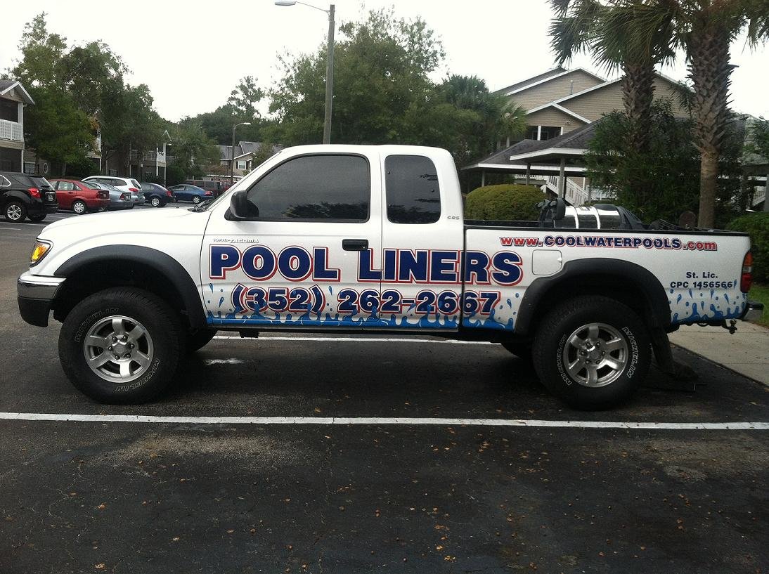

    I jacked up the back of the truck until the fenders were level. Does it look okay like this, or does it look like too much lift for these tires?

    Incorrect, 5100's come in different sizes too. You have to check the serial number to make sure you have the right shock on the correct side. IIRC, its
    BE5-6252-H5 (left side)
    BE5-6253-H5 (right side)
    Its not a huge issue for road driving but could become a headache if you are trying to flex the rear suspension.
    As long as you dont flex your rear suspension, you are ok. Take it back to the dealer and tell them they installed it wrong. There is a snap ring on the front shocks that is used to raise the front end. Have then put the ring on the lowest setting and you will return to stock height. Your not the first member that had this happen with a dealer install.
    As for your rear shocks, only an issue if you are hard core offroading. Im have the same issue as you do but opposite. My lift is too high for the 5100's yet Ive not had any issues.

    I got 3" on stock tires and it looks acceptable (ish). This doesnt look too bad, but like I said, I would take it back an have the guys install the shocks correctly.

    IMO, these tire do not look too small for the lift.
