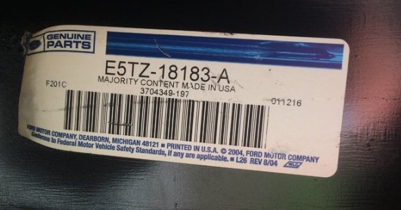

    Anybody know the Ford Part Numbers for the shock towers we need? Thanks in advance!

    Rattletrap66
    Rattletrap66 (ノಠ益ಠ)ノ彡┻━┻
    Aug 25, 2014
    #136901
    23,784
    Frank
    Tampa, FL ☜(゚ヮ゚☜)
    2014 TRD Off Road DCSB
    ╭∩╮(ಠ۝ಠ)╭∩╮
    Stryker420[QUOTED] likes this.
  8. May 25, 2018 at 1:39 PM
    #28
    Stryker420
    Stryker420 Well-Known Member
    Apr 6, 2017
    #215523
    673
    Benedict
    Mooresville IN
    2012 Tacoma DCLB
    Thanks! I just ordered 2 @ $19.42 a pop. What a deal. But from my experience, FOMOCO parts are stamped ultra low quality steel. That's why Ford had to go Aluminum and then realized galvanic corrosion is a thing. These towers are getting stripped, cleaned and then shot peened. Then I am going to coat with zinc primer and paint with 5 coats of rustoleum. Frankenstein truck is happening!
