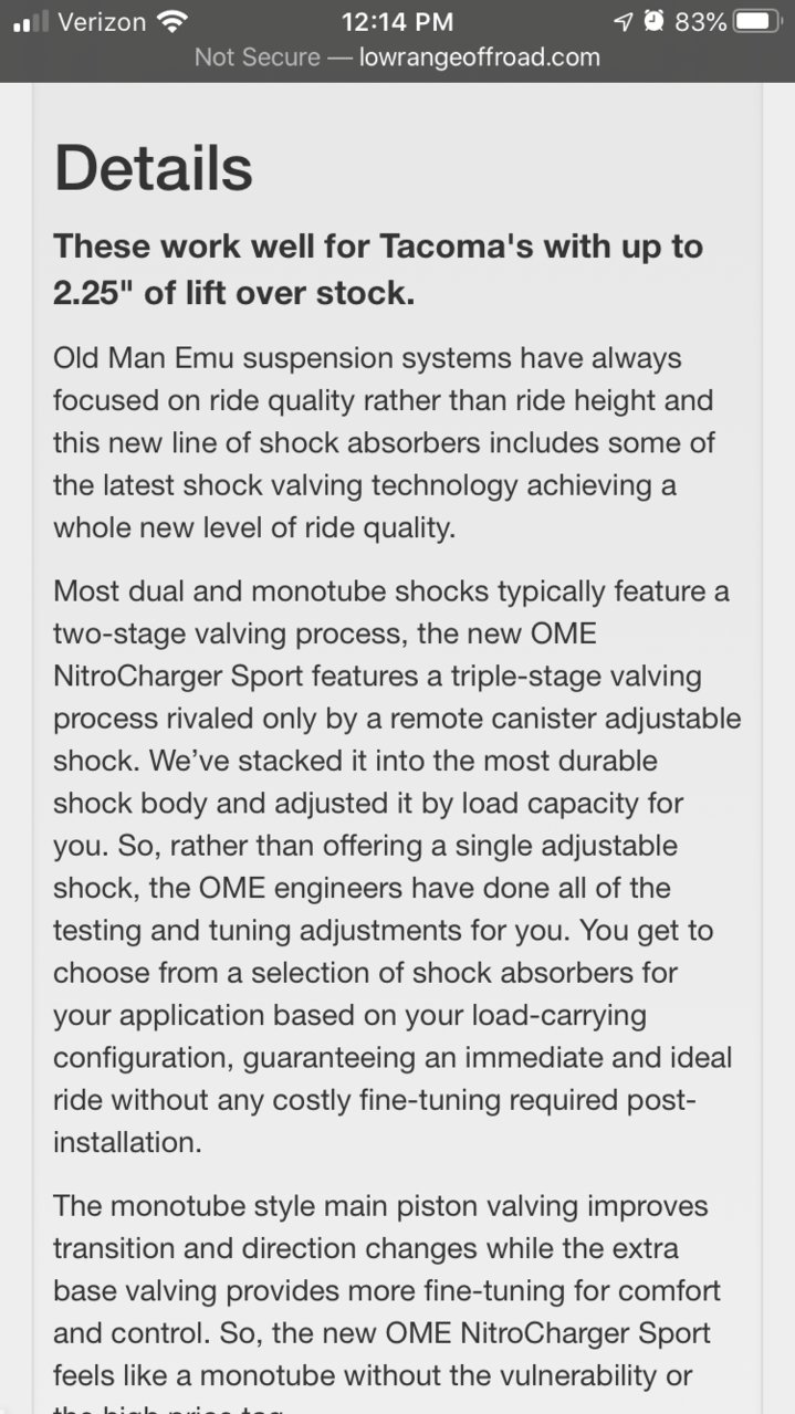

    Does anybody run these? Wondering if they will work with a Toytec 3” lift.

    Icon makes a 2.0 rear shock that works with up to 3" rear lift

    4 run, 2 don't
    This is something you could've easily figured out within 5 seconds; I take it that's why no one bothered to answer.
    As you see above, @BeLance89 has answered your question
    I will add that if you're going to take your truck off pavement at all, invest in a few supporting mods as well such as;
    Diff drop (if 4x4, for anything over 2" and you'll have crazy axle angles), bracket for your brake proportioning system, extended rear brake line, and even taller than stock bump stops to prevent from bottoming out your shocks.
