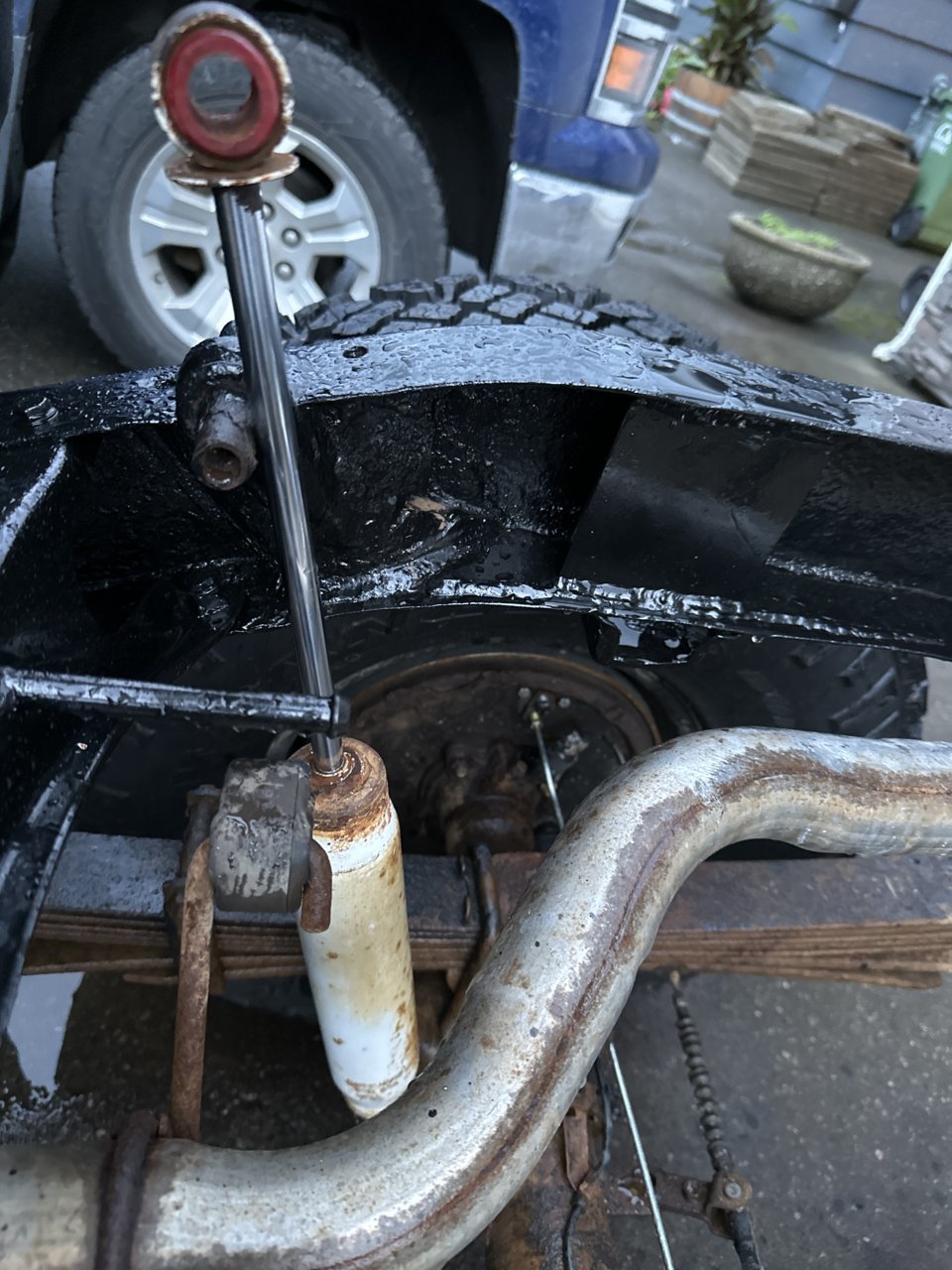

    image.jpg I am not sure if these are the right shock size because when I install the old one on the bottom fully extended it sticks out

    Holy fucking hidden rust
    Those shocks look to be a good 5 years overdue for replacing
    You still failed to help us help you as @Andy01DblCabTacoma asked if you had a lift or not.

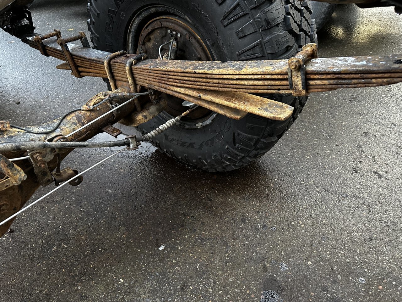

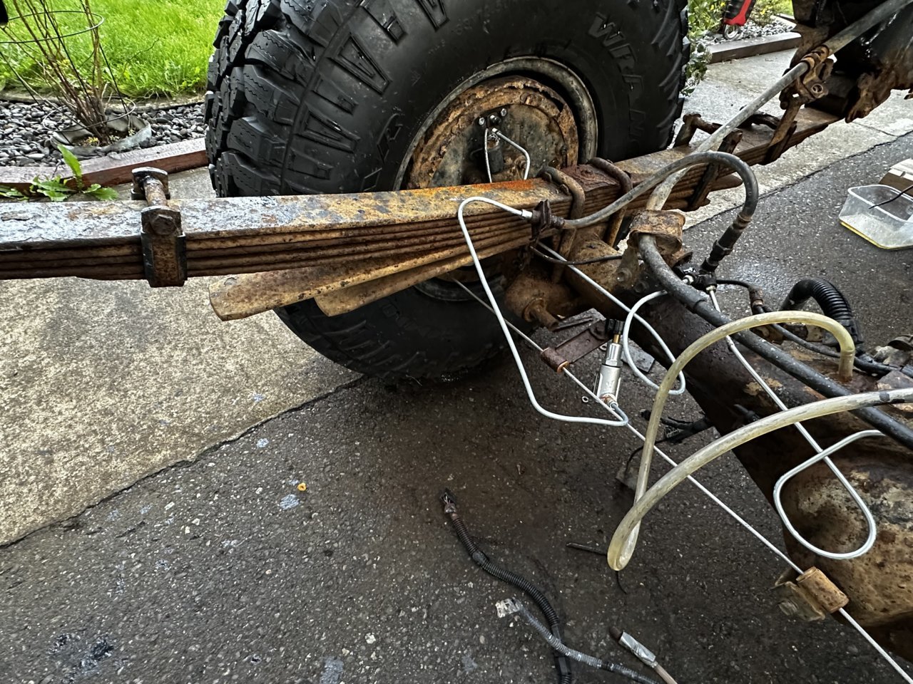

    Pictures of the entire rear leaf pack setup
    Tomorrow of course since it's night already
    We'll get you sorted out

  12. Sep 27, 2023 at 8:29 AM
    Trp04
    Trp04 [OP] Member
    Sep 26, 2023
    #434324
    11
    Travis
    Od green 2004 taco 3.4 v6
  13. Sep 27, 2023 at 8:30 AM
    Trp04
    Trp04 [OP] Member
    Sep 26, 2023
    #434324
    11
    Travis
  14. Sep 27, 2023 at 8:31 AM
    Trp04
    Trp04 [OP] Member
    Sep 26, 2023
    #434324
    11
    Travis
    I am hoping to install new leaf spring in the future I am just not sure when
  15. Sep 27, 2023 at 8:39 AM
    Kwikvette
    Feb 27, 2019
    #284735
    80,336
    Fresno County
    4 run, 2 don't
    They're rusted as shit, but they look stock.
    I'll have to go through my old pictures and compare leaf packs though first...

    I thought it was stock but I ordered the stock blistien shocks and they were too short. Like it was about half an inch from the mount

    Personally I'd be pulling wheels off and replacing those drums and more.
    That stuff is already transparent.
  18. Sep 27, 2023 at 8:45 AM
    #18
    Kwikvette
    Feb 27, 2019
    #284735
    80,336
    Fresno County
    4 run, 2 don't
    I'd pull off the entire rear axle and get rid of all that rust, then coat it.
    I've seen posts about rear diffs leaking and no, they don't have a rear cover as it's solid and sealed up on the back end; 3rd member comes out the front side.

    Not stock- OEM is 3 + overload. These are after market - I think OME Dakars?
    But yeah... shocks are the least of the concerns here, the back plates on those drum brakes are doing their best impression of the Titanic.

    No wonder they look familiar, I ran OME myself.
    That rust though :puke:
