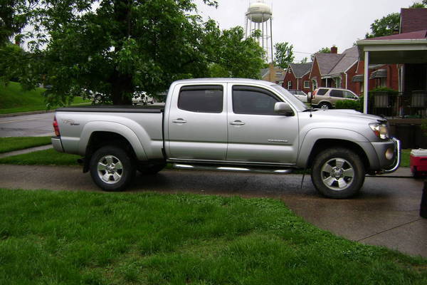

    I just did my rear 2inch AAL from Toyotec, I think I got almost 4-5 inched of lift total. I'm planning on doing 5100's in the front set at 1.75, so I'm expecting the foward rake.
    This was before.
    This is after.
