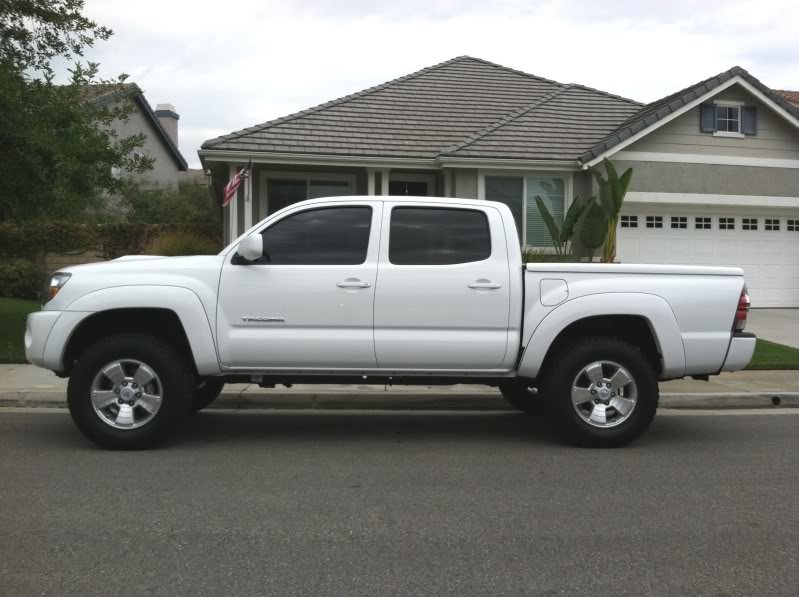

    Hello, I am new to this thread, I have a 2011 Tacoma DC Sport. I recently replaced all 4 shocks with new Bilstein 5100's and have them set at 2-1/2" in front. I also added BFG 265/70R17 Tires on my truck. This was done about 2 months ago and the truck has had time to settle. I recently bought a fiberglass tonneau cover for it and the added weight I have noticed the rear sitting lower. The front fender bottom sits at 38-1/4" and the rear fender bottom sits at 36-3/4". What solution do you recommend without messing with the quality of the ride. Thanks

    You set the front Bilstein's at 2.5''? I think you need a 2'' AAL to balance it out and new UCA's for the front if you do that or a 1.5'' AAL if you have received the rear leaf TSB.
    Although, I'm not sure, wait until a more experienced person comes on and corrects me. ;)

    1 1/2 AAL Should set level and only a slight bit stiffer ride.

    1.5 will still have some Bro-lean with any weight in the bed (his fiberglass tonneau)

    The tonneau cover is probably about 75lbs I am assumming, not to much. I didnt really notice the front being so much higher until I took my taco on a road trip and everyone was flashing me thinking I had my brights on. I appreciate all the info. The rear suspension is completely stock with the exception of adding the 5100's. No TSB

    Just ordered a 1" rear block kit from Toytec (thanks for recommending them Macgyver). The guy on phone said 1" block should be very close based off my measurements and if not, I might have a slight 1/4" to 1/2" bro lean. Thanks for all the advise

    Installed my 1" block this morning and now my Taco is just shy of being completely level. Block2-1_289b7bb06ad0ca2f5dd6afae3d44f86529c5d553.jpg

    Still looks way nose high...but that's just me. I like a little bit of rake. There's a reason pickup trucks have rake, so when you put weight in the bed it doesn't look nose high.

    Yea woulda gone with the inch and a half aal in your case... But it looks dead on with no payload. Nice lookin ride

    No TSB, I dont carry loads, I just carry my fire gear when I work overtime and use the bed from time to time to carry the stroller and baby stuff. It might be a 1/2" shy of being level but I am glad I went with the 1" block vrs 1-1/2" and have it sit higher in the back since thats the reason I replaced the shocks with 5100's

    you may be level if you get the TSB rear leaf pack with that 1" block

    Lose the block and go with the Icon 3 leaf AAL. Awesome ride quality and you can get 2" of lift by leaving in the overload leaf or 1.5" by removing the overload leaf.

    I dont have the TSB, I have a 3 leaf rear.
