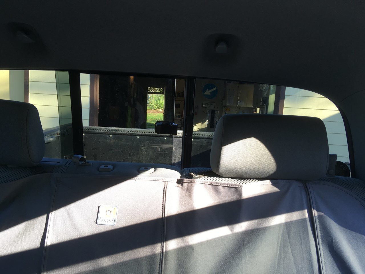

    I have a DC, so it's great!
    And, it's almost invisible behind the rear headrests.

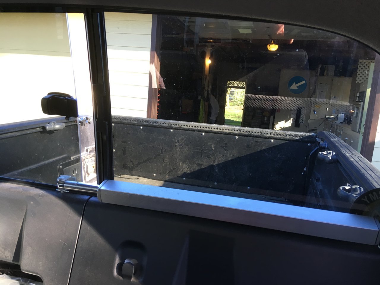

    I'm not sure if there is a "new and improved" way of doing the mod (I did mine many moons ago) but-
    I just propped the latch in the "open" position with a black rubber cone washer, like used in kitchen faucets.
    I double-sided sticky taped the mounts, for the ram, to the stationary and moving glass panes. I used outdoor 3m 20# hold tape, IIRC.
    Wire it up to a DPDT switch, done.
    Exactly once, I had to replace the sticky tape, only on the ram/stationary mount. You may have to do it more often if it is the sun/heat more than mine. At that time, I thought about using epoxy for the ram mounts but decided that it wasn't necessary. (I have used clear epoxy to mount other metal pieces to glass, so I know it would work)

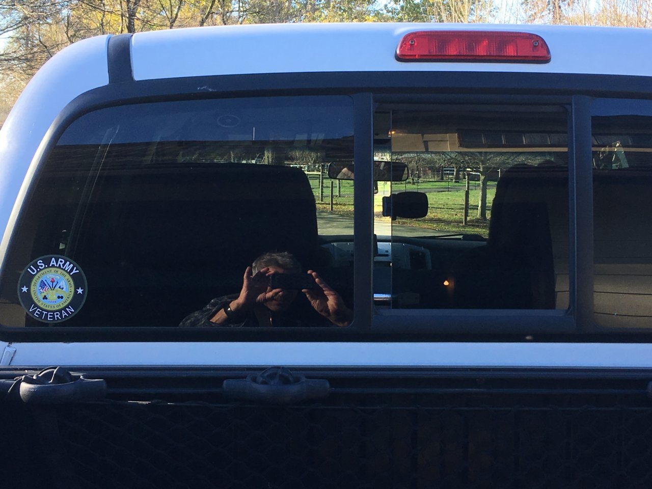

    Here's pics...
    From the back- you can just barely see the chrome actuator rod at the lower edge of the window.
    From inside
    From inside, behind the seats
    And, I guess I'm also using a zip tie on the latch, along with the cone washer.
    playdixie, mikkydee and grizquad like this.
