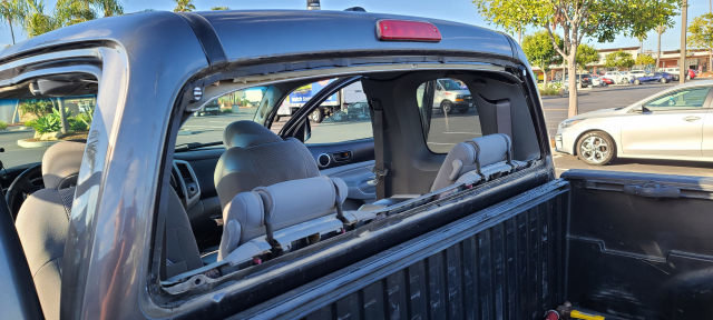

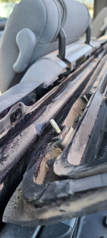

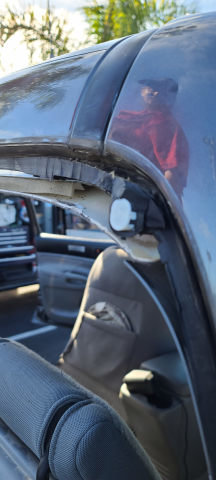

    And as someone who watched his rear window being replaced by the glass guy, it's a complete PITA.
    The bolts are behind the interior plastic on the bottom. The clips are kind of a pain as well. They use a really strong adhesive that will probably make you bend up the window frame.
