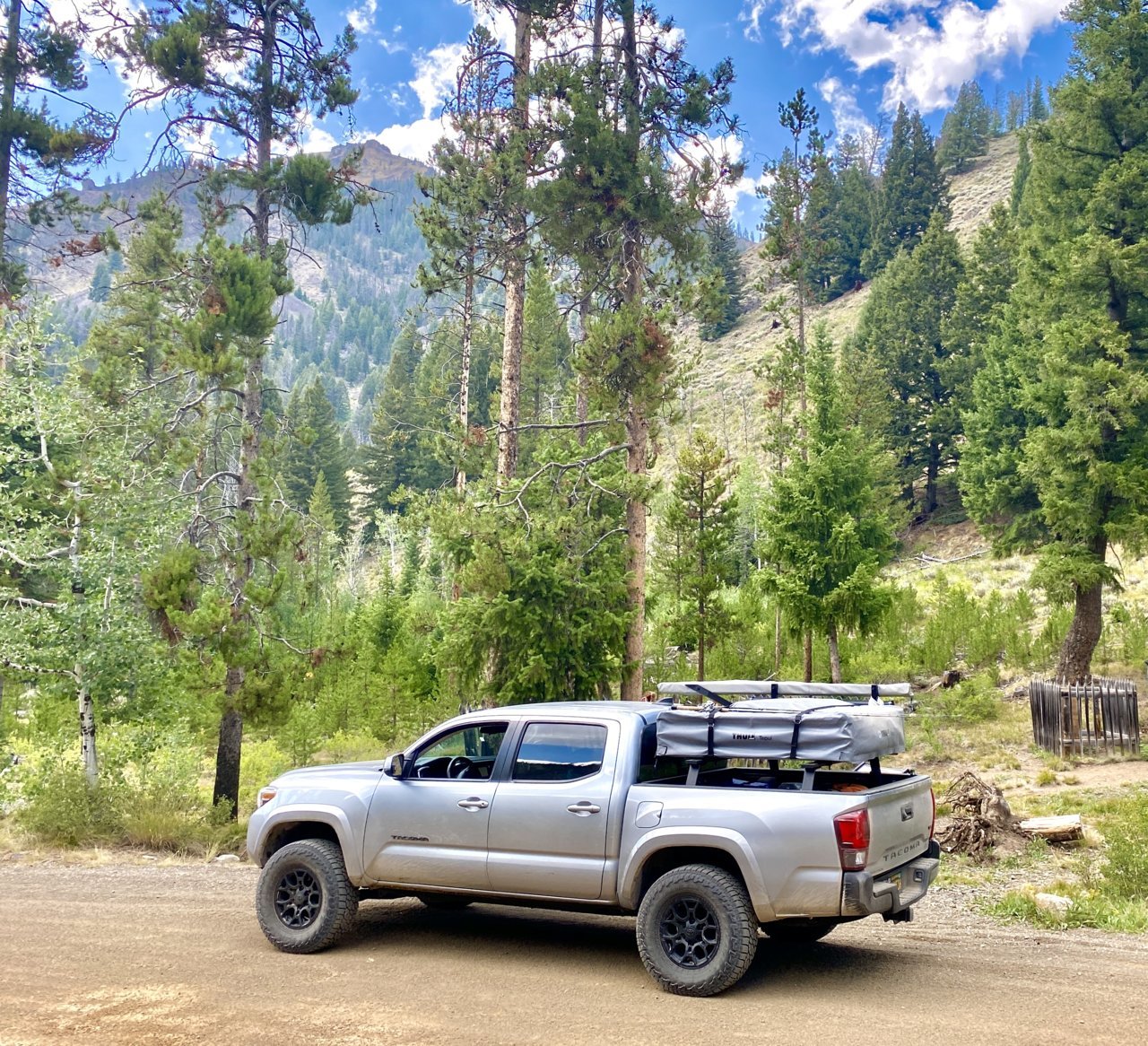

    I don't know how much you weigh, but get two people to stand in your bed and take a look at your springs. Temporarily it will be fine I think...I had 1" blocks for a bit and it was fine, but I really didn't/don't off-road...just forest roads and desert roads. My RTT is 130+ pounds and have lots of gear too. The stock leafs are a joke and almost flat with nothing in the bed. I swapped the 1" blocks for a Icon 3 leaf progressive AAL and it was a huge help. Actually gave the leaf some bend in the correct direction. Everyone will suggest a full leaf pack replacement, but that is a lot of cash. In my experience as a non-offroader/weekend warrior dirt road camper, you'll be just fine with an AAL.
    Pic is my truck fully loaded (with AAL) on a 2 week trip.

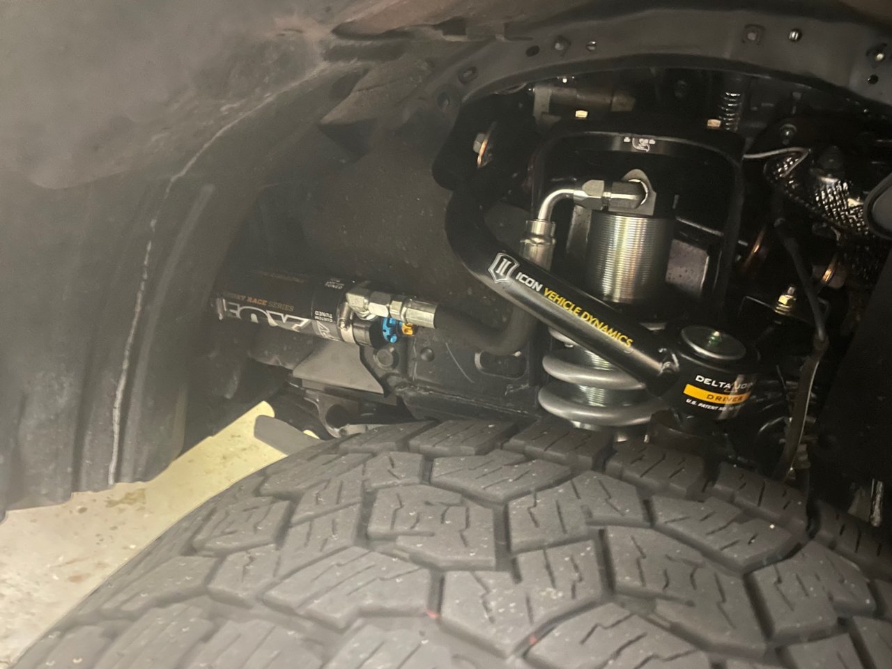

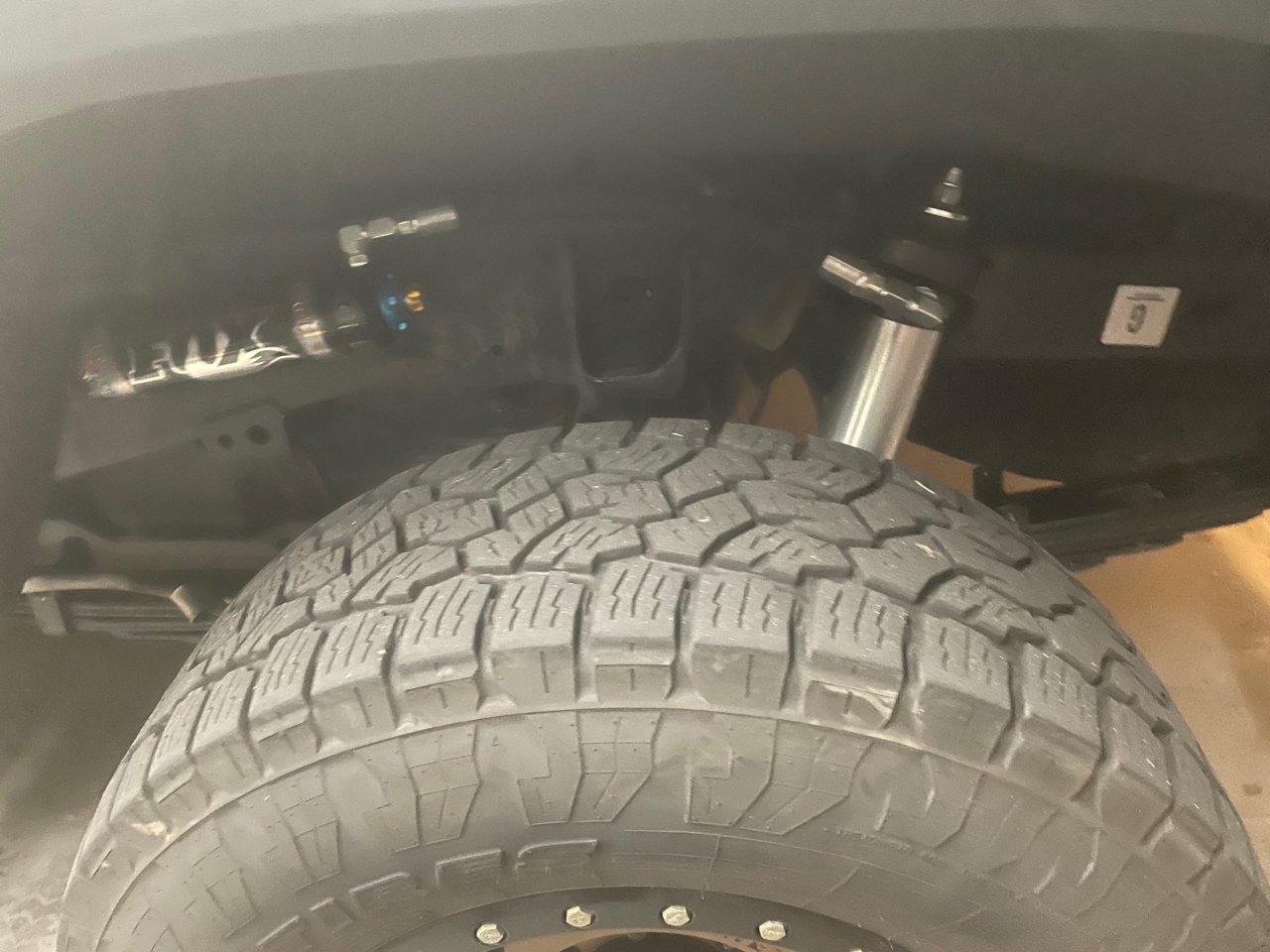

    Fox 2.5" DSCs, installed by @Speed Freek
