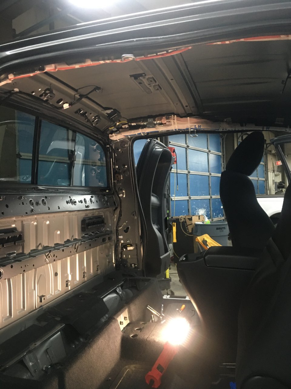

    Hate stereo sound coming from behind? Can’t figure out how to use that pesky fader. Well do I have the mod for you.
    Not to mention MPG will go through the roof with the weight savings alone.

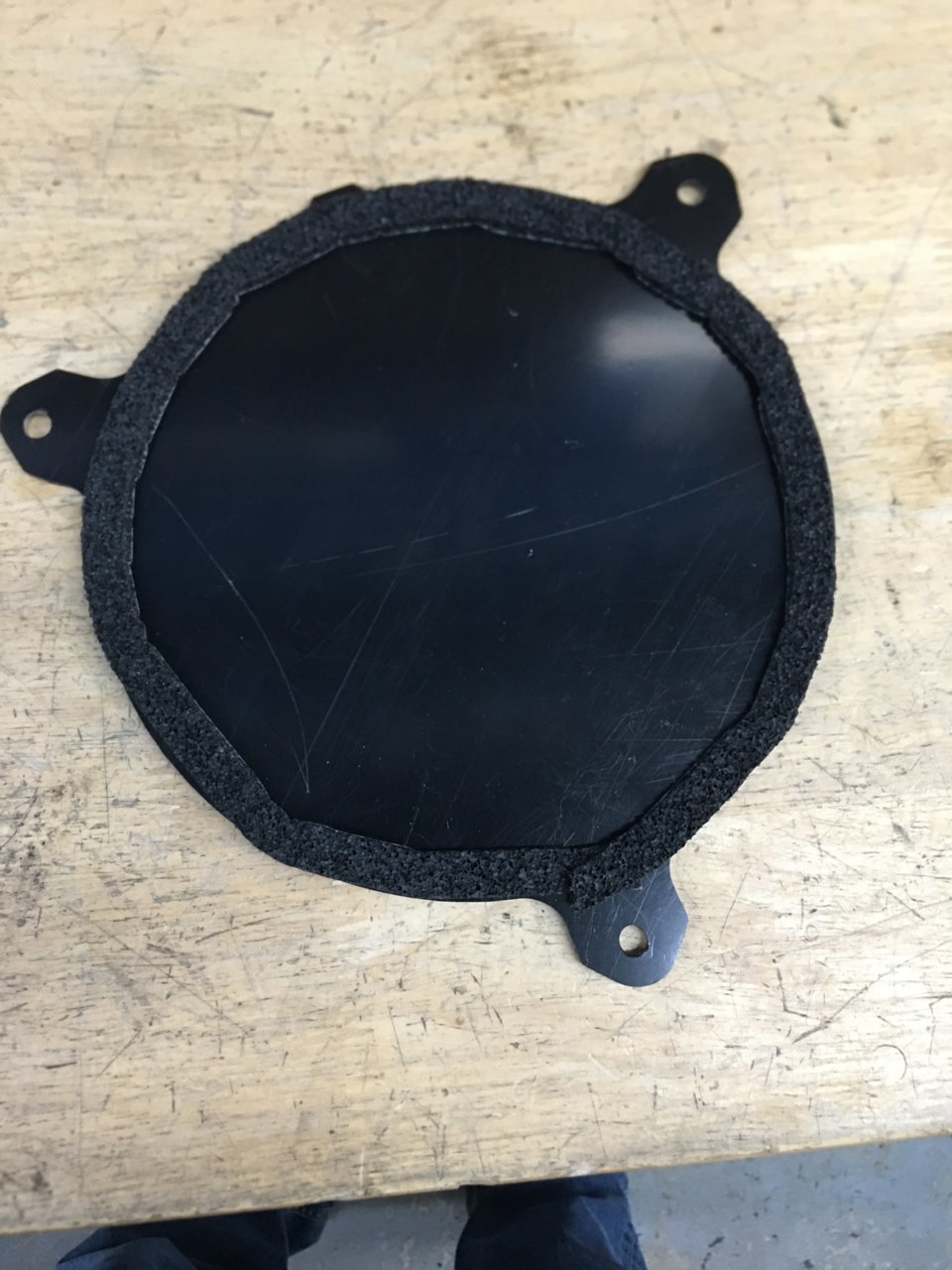

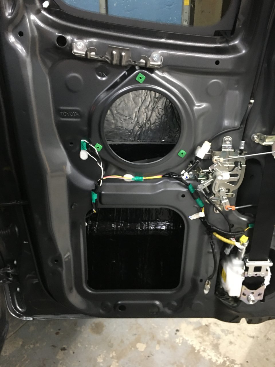

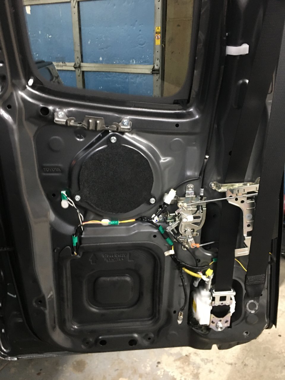

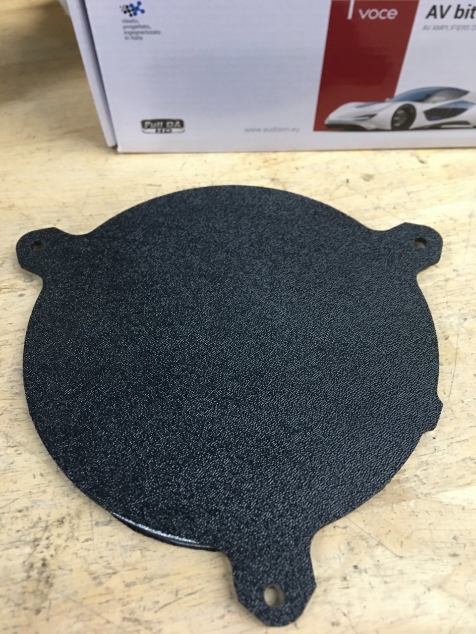

    I’m actually about to start on a nice little stereo install. I’m not using rears and was in the rear doors sound deadening. Better to go ahead and remove the rears and make a abs plate to cover the holes rather than allowing the unused speakers to act like a passive radiator for road noise. Rear doors feel a lot more solid now too. I’ve completely sound deadened the entire truck minus the front doors. I’ll do them when I’m installing the fronts. I have to finish everything else first though. Just started on electrical.

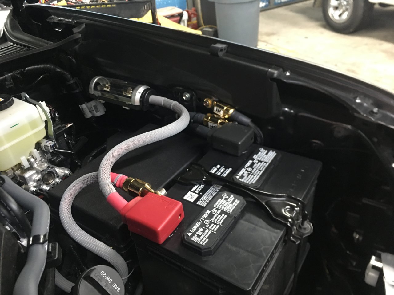

    that cable management is really neat. I need to clean mine up haha

    Thanks. You’re right down the road from me. You’ll have to check it out when I’m done. Right now I’m pulling up to the scene with my ceiling missing.

    With Sound Deadening in the passenger door you might as well make a sticker that says, "Don't slam the GD door."
