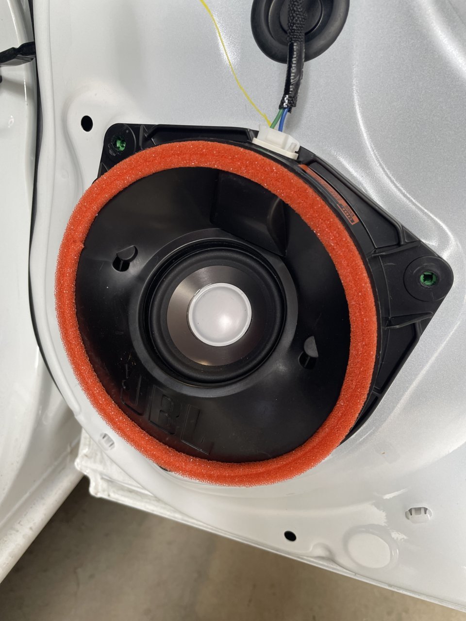

    I just changed all of my JBL speakers.
    I had no rear speaker sound either.
    When I removed the rear speakers I was very surprised as they have a 6 inch speaker installed but the actual speaker is only 2.5 inches across, the rest is just fill. As soon as i saw the rear speakers, it all made sense. The new full 6 or 6.5, cannot remember, Reference Speakers sound great. I get sound from the rear with using lower volume than before the swap. My sound system came alive with just new speakers.

    interesting! Do you have any pictures of the stock rears? What did you upgrade to as I know the JBLs are a special resistance.

    Stock head unit and yes the picture above of the rear speakers is sad but does explain the poor sound.
