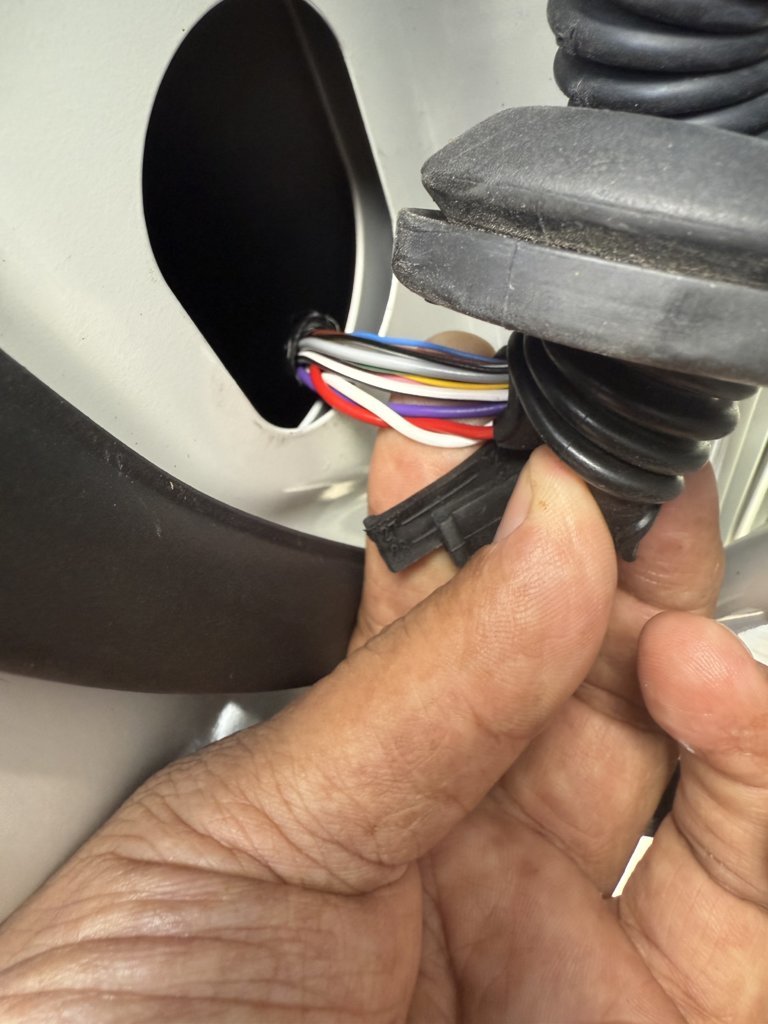

    What color are the wires right before the rear speakers, I’m trying to install a Hideaway Kicker Subwoofer and tap in to the speakers wires right before they go inside the door, but I removed the rubber wire and there is so many wires inside and they don’t look like speaker wires… Does anyone knows the wire gauge and color feeding the rear speakers?
    Thank you in advance….

    A pic of the door connector would help with changes in year, if any.

    I’m just going to throw into the conversation here, tapping the rear speakers in a Toyota for signal is not very good. Toyota gimps the reaf speakers by st least 6db, making them all but useless. If you want to test for yourself, Center all controls in the headunit, put the volume where you like, and listen front and rear. It’s really annoying.
    For your sub, tap the front mid bass in the door, you’ll thank me later.
